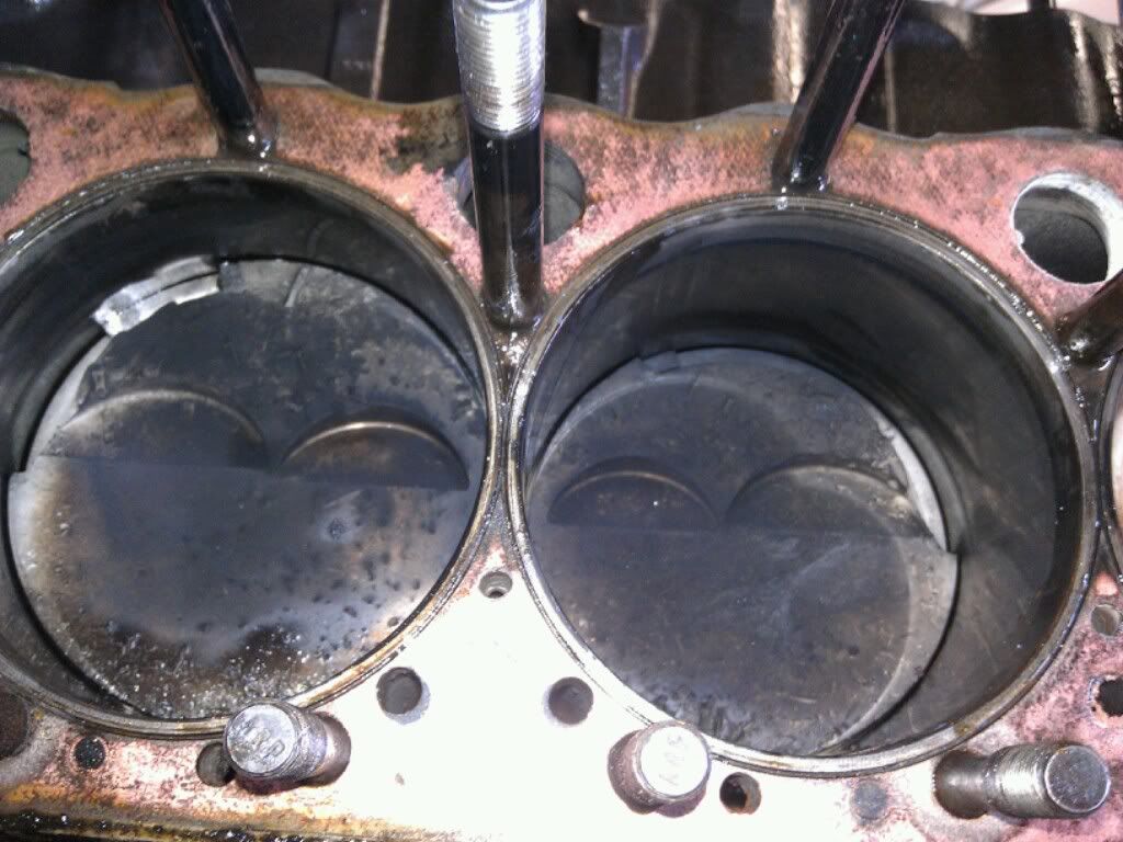

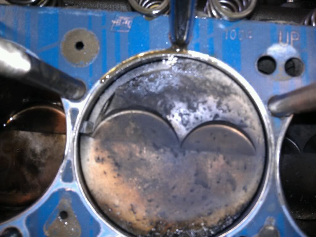

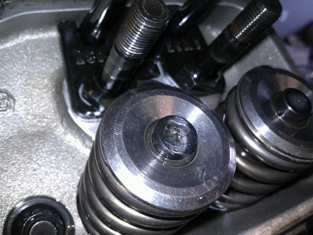

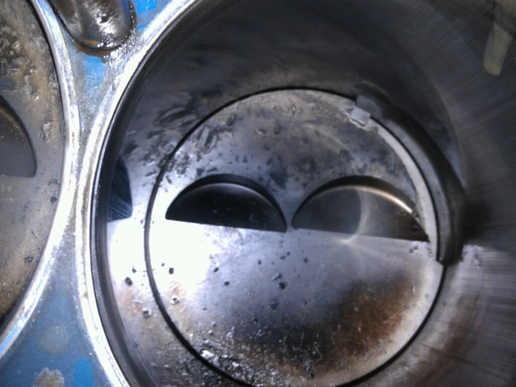

Well after a successful RTTC for me personally and the car, we are even happier and shocked at just how bad the motor was effed up on day 2... we knew it wasn't good but the final score was this:
4 broken pistons
3 bent valves
I'll just let these pictures do the rest of the talking.
http://i236.photobucket.com/albums/f...hoto_002-6.jpg
http://i236.photobucket.com/albums/f...hoto_003-4.jpg
http://i236.photobucket.com/albums/f...hoto_004-8.jpg
http://i236.photobucket.com/albums/f...hoto_005-4.jpg
The block is actually in decent shape and was only bored .020 over so it's good life left for someone, just not me. Will be figuring out what parts are for sale and what might be reused (if any).
I'll just say I don't plan on being "underpowered" with this next motor. :woot:

Sorry that happen. It looks like a nitrous eng gone wrong.
Vegas69 04-06-2012 06:57 AM
Nice work Gordon:D Your tune had to be way off to break that many pistons. My guess is your nascar exhaust caused your engine to go lean and that was your overheating issues. The decibel level kept you from hearing the extreme pinging noise. ha ha The piston debris bent the valves. It's a miracle that you didn't spread that thing all over El Toro.

Sieg 04-06-2012 09:38 AM
Nice work Dave! How are the heads and are they going on the new motor?
FWIW - Todd's assessment sounds about right.
GregWeld 04-06-2012 10:02 AM
Fire the tuner dude!

How much total timing did you have and what gas? Kinda hard to tell in the pics, that lil half moon shiny area in the valve pockets is where the valves were hitting

Didn't think about the boom tube causing a lean condition but that makes sense. We shoulda thrown some race gas mix in the tank like we do at track days, but then then it wouldn't be a "street car" for RTTC. :lol:
In all seriousness, it was not too bad of a result. And I knew I was on borrowed time for awhile. We hoped the pistons were the only real damage and the heads are being disassembled/inspected now but besides the valves didn't look too bad.
36* usually.... 91 octane usually and for RTTC.....
