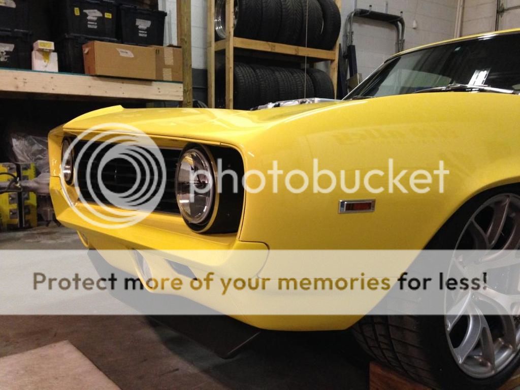

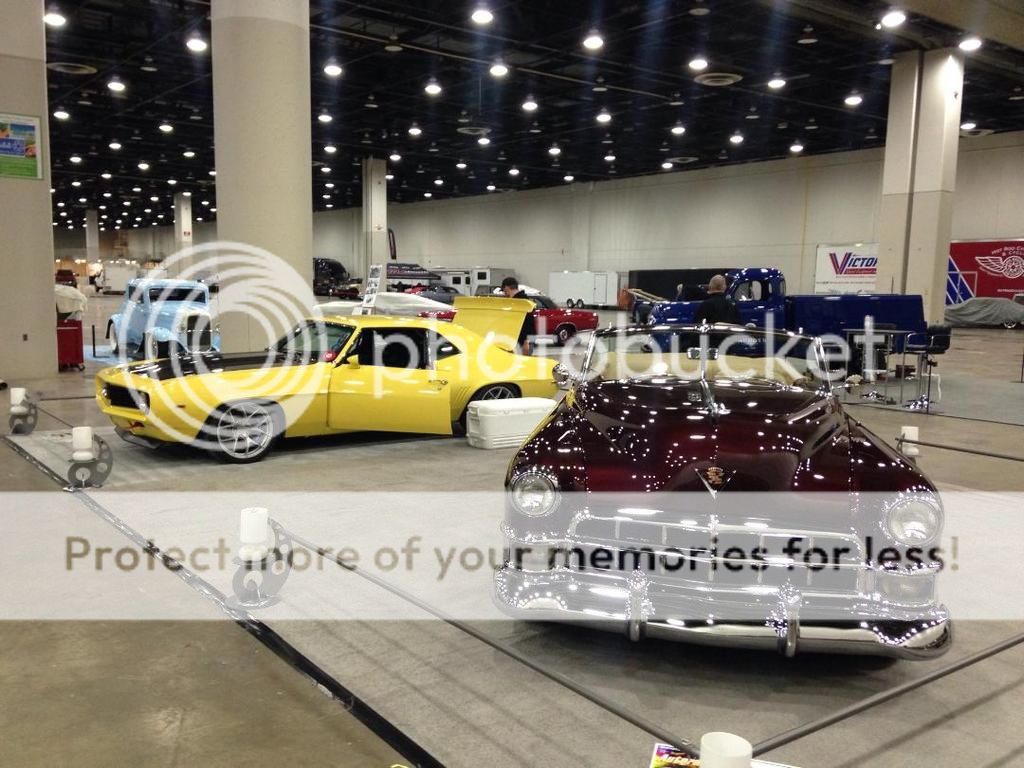

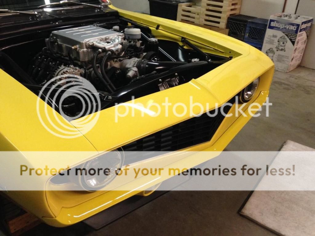

Stielow 02-25-2016 04:29 AM
It is Feb. in Michigan and that means another Autoramma.... Matt at Sled Alley did some tune up on Jack Ass and has it ready for the show.
We updated the car with a Marquez fiberglass Endura front bumper to replace the orginal Endura front bumper. We saved about 10 pounds of the nose of the car and after some tune up it fits good.
http://i439.photobucket.com/albums/q...pssuiavmq7.jpg
http://i439.photobucket.com/albums/q...psz4xllr4x.jpg
Matt loaded Jack Ass and the Caddy into Autoramma last night so if your are at the show stop by and say hello. The Caddy is a very cool car.
Jack Ass was in the show in 2008 and this is it's return as Jack Ass 2.0..
http://i439.photobucket.com/albums/q...psgl2v9f2n.jpg
Mark
