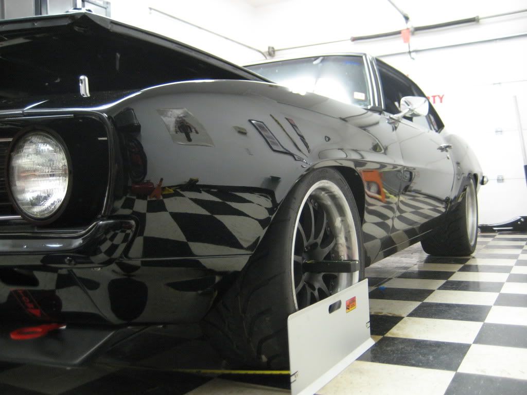

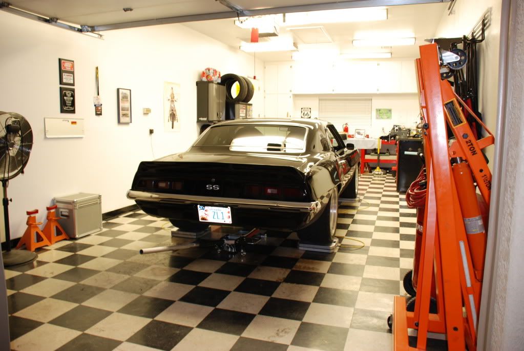

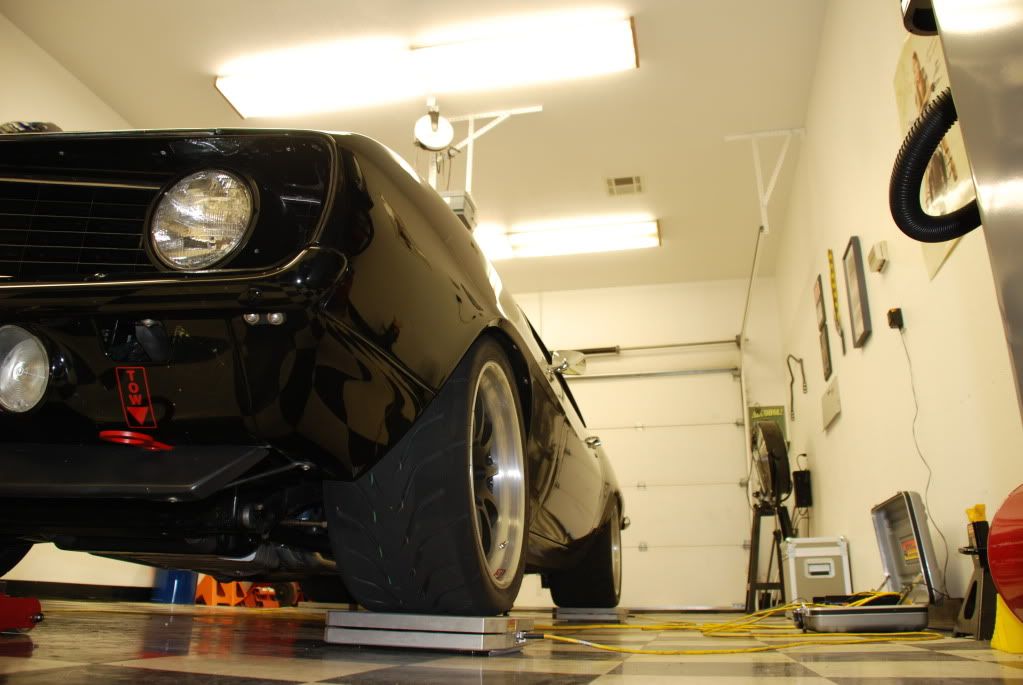

I changed out the springs 6, 9, 12 months ago and never corner weighted the car. A friend and client in the SCCA was nice enough to lend me his scales again. The good news is she's lost about 44 lbs since I last scaled her. At first I thought the scales had a problem. I knew I'd lost 16lbs with the flywheel change, but where the hell did the rest of the weight go? It's the brake change. I lost a considerable amount of weight and rotating mass when I switched to my floating caliper set up. Since the front brakes overheated in the speed stop challenge and the rear fluid was brand new, I still feel that it was a good decision. Buttonwillow may change that but I doubt it. Anyway, lowered the rear of the car about .25" before I scaled it. I've put the car thought hell and back and my indicators showed over .25 to spare. I ended up needing to sping the RF coil over up 4 full turns and the LR 2 full turns to get a PERFECT 50/50 cross weight. :D Car's lower than ever, has more meat, and no rubs that I'm aware of. :thumbsup:

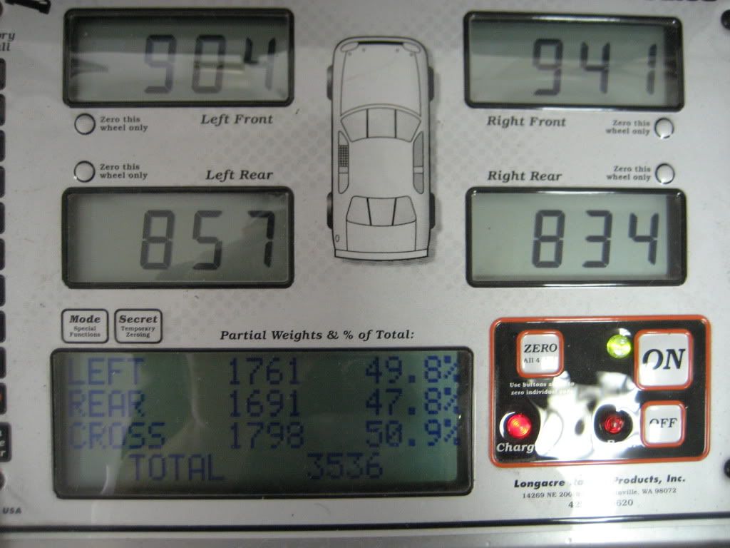

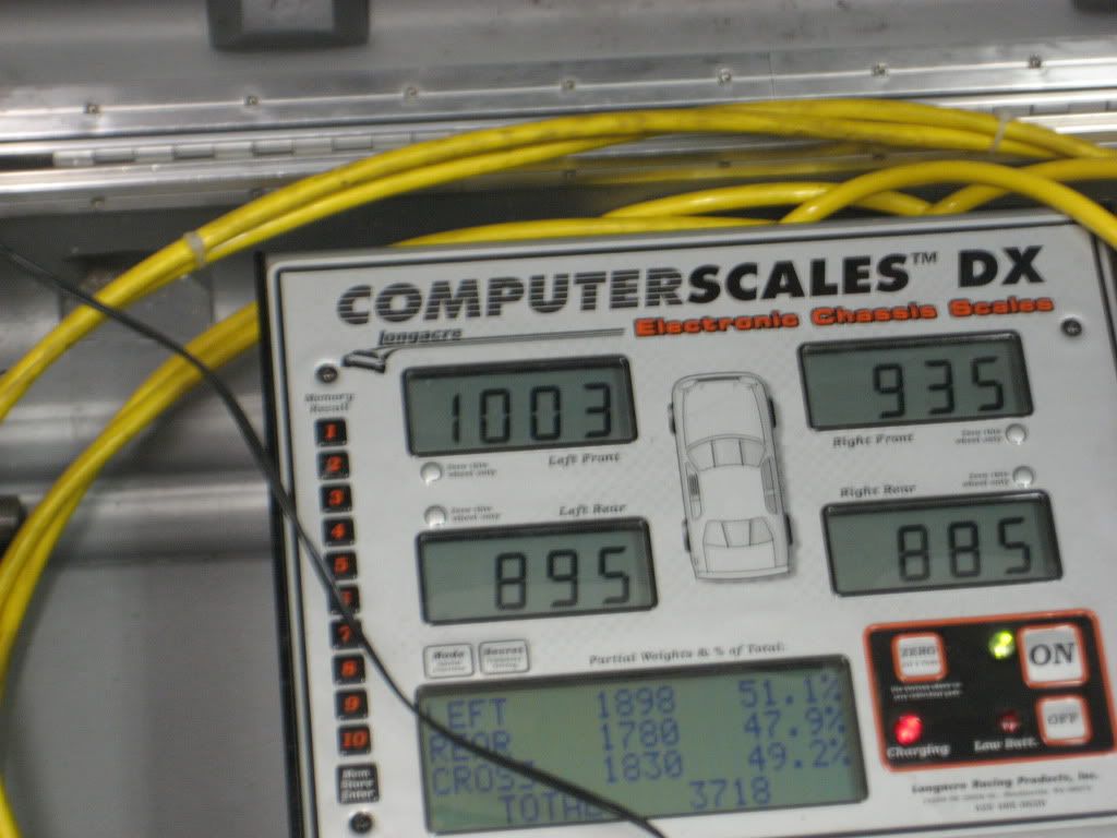

This is how my corner weight started...(Me in the car)
http://i200.photobucket.com/albums/a...1969/014-2.jpg
After multiple adjustments: (Me in the car) Two more gallons of gas..(Full Tank)
http://i200.photobucket.com/albums/a...1969/029-1.jpg
