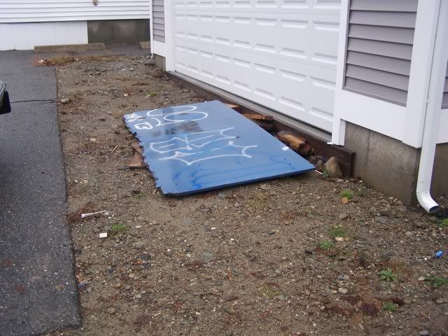

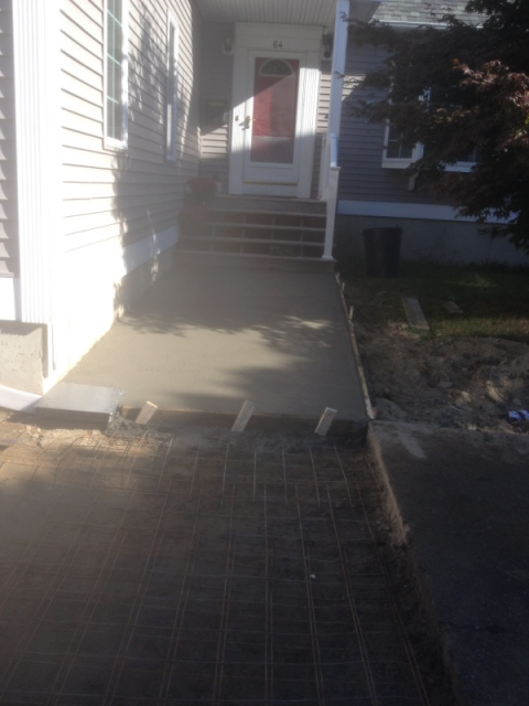

When I built the garage it took all my funds and fixing around the building went unfinished. Well this week we put the concrete in front and around the side and back. When I built the house the builder paved where he cut to put the water service and sewer, which promptly sunk. It was like that for many years until now.
This is what we drove over
http://i172.photobucket.com/albums/w...s/000_0948.jpg
Now for the work.
http://i172.photobucket.com/albums/w...ps4195dc66.png
Before I retired I was a construction laborer and a grade forman but that was five years ago. Boy do I remember why I had to retire !

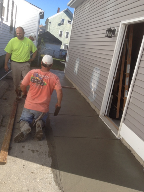

We got a machine and dump truck and I was on the shovel again, and got it ready for the concrete placement.
Here are few pictures of it going in. I put a small catch basin and I'm putting a Flo well to catch water from the down spout. so the side walk won't be covered in ice all winter.
http://i172.photobucket.com/albums/w...ps7aac836d.png
http://i172.photobucket.com/albums/w...pse27f43af.png

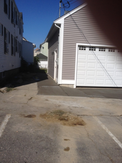

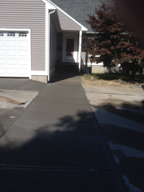

And the finished product.
http://i172.photobucket.com/albums/w...ps8d6b65fd.png
The part closest in the picture is where it was sunk in.
http://i172.photobucket.com/albums/w...psdf7dad36.png

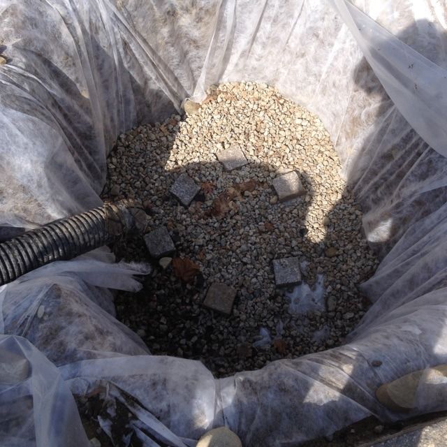

Well I finally got the dry well for my down spout for the garage in this weekend.
Here's the catch basin going in when we did the sidewalk.

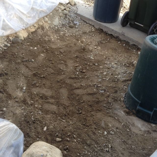

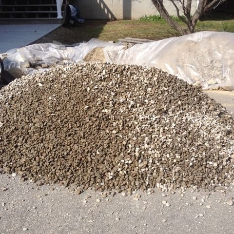

Here is what I used for the dry well.
http://i172.photobucket.com/albums/w...psoynodlgq.jpg
I dug a hole 4'x4'x almost 4' deep for it. Its been a long time since I used a pick and shovel, it took a little over 4 hours to dig. then I lined it with filter fabric, put small pieces of granite for it to rest and some 3/4" stone.
http://i172.photobucket.com/albums/w...psiisl8r4d.jpg
Ordered 2 yards of 3/4" stone ( which was supposed to be washed but wasn't!) to back filled it trying not to get too many fines in with it.
http://i172.photobucket.com/albums/w...psazsmx8cc.jpg
http://i172.photobucket.com/albums/w...psazgonodc.jpg
