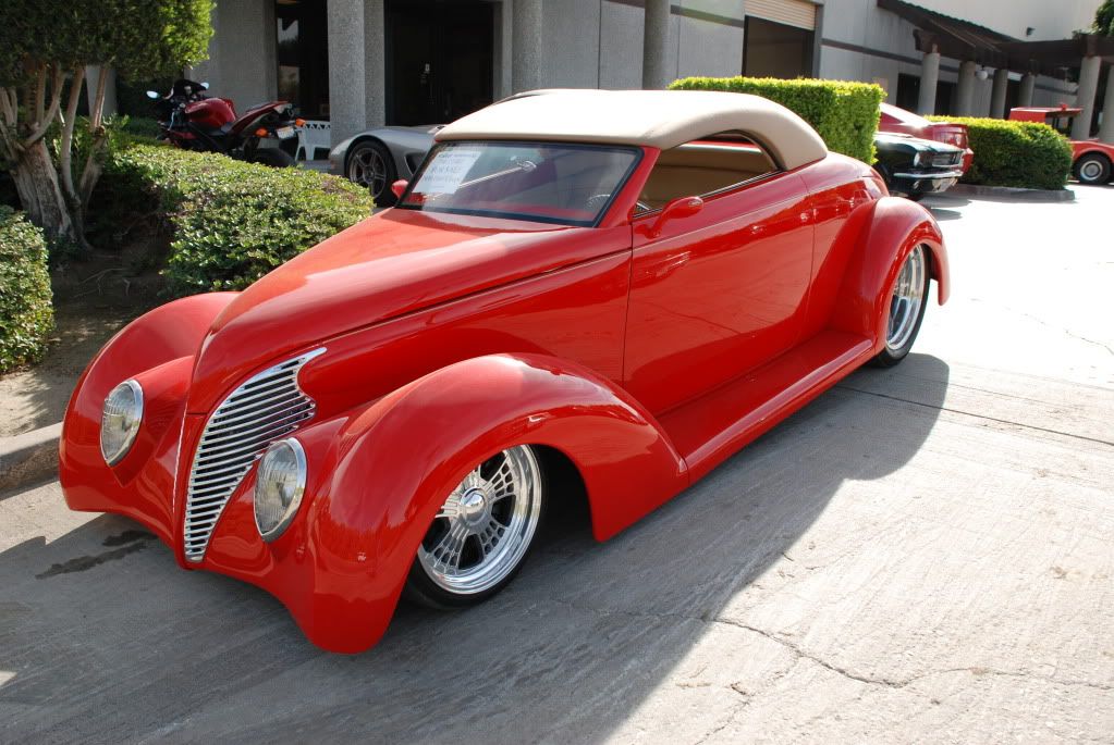

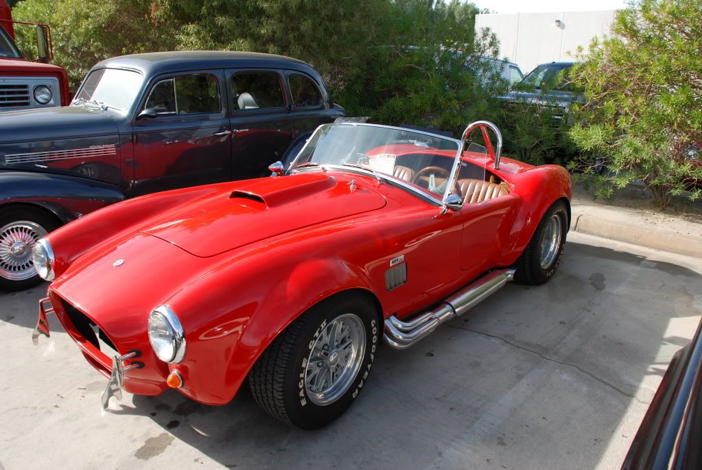

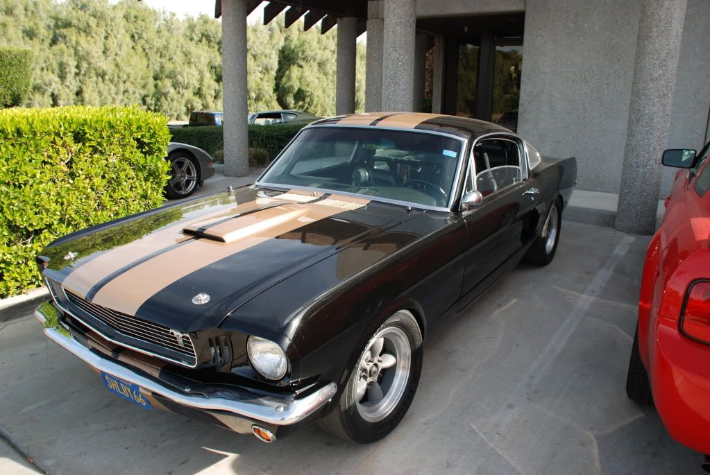

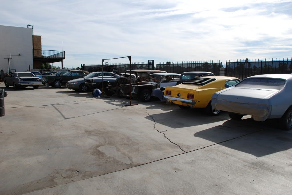

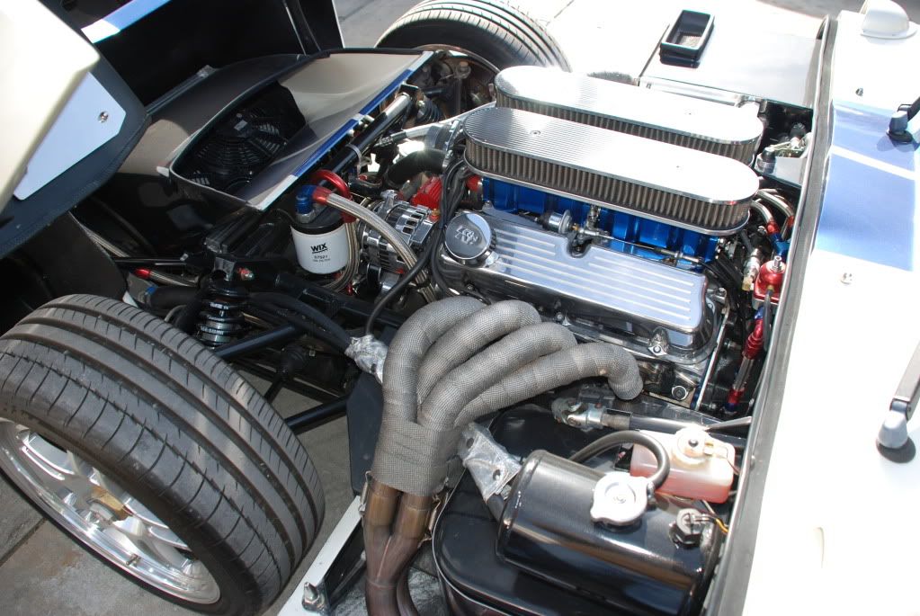

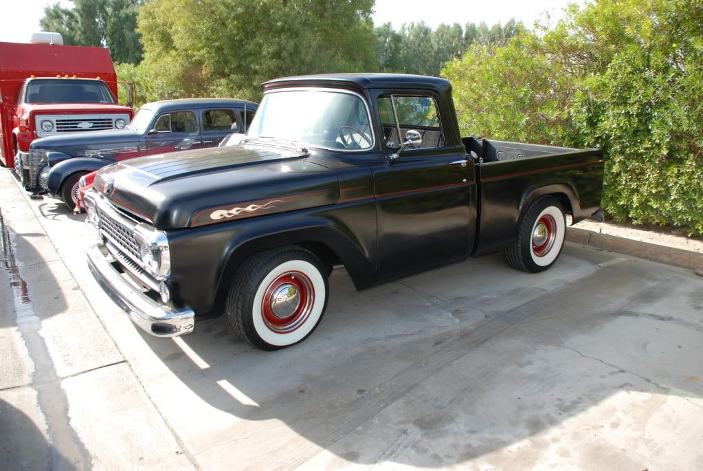

While I was there I snapped some photos of some of the cars scattered around. The mustang is a real shelby. They had just fired a 70 cuda with a monster engine and tunnel ram. It was 80's pro street but cool. Here are a few photos.

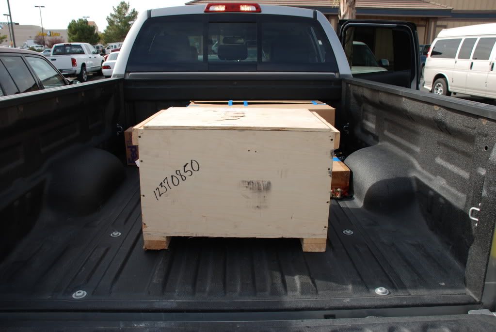

70rs 12-17-2009 09:31 PM
Uh.....you went to pick up a box? Nice teaser there!:mad:
There are a lot of cool cars there! Like Toys R Us for big kids!
Flash68 12-17-2009 09:33 PM
Cool cars but I don't like your games either!
To hell with what' behind door #3, I'll take what's in the box! :woot:

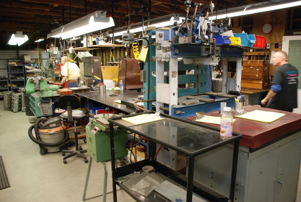

Vegas69 12-17-2009 09:40 PM

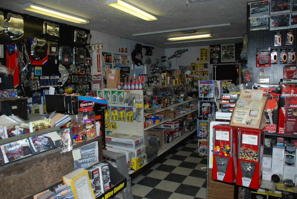

After my 3 hours excursion I pulled in Hesperia, Ca. Not the prettiest place on the planet. I wasn't sure what to expect. I pulled up to Pettis Performance and it had Mom and Pops written all over it. I had a good feeling the minute I pulled in the driveway. The best machinist I ever found back home was in his 2 car garage full of equipment. Anyway, I walked in the front door and it was motor head heaven. This place has been around since 1973 and you talk about parts and machines! The place was packed but immaculate. Rare for a machine shop. The first thing they did was have a worker unload my truck and inventory my parts. They I got the grand tour. After that I went and watched the final dyno pull on a 565 Big block. How does 925 hp sound naturally aspirated? It's going in a Jeep sand rail....:_paranoid The guy was beside himself. It made peak power at 7200 but the curve was flat as a board to 7800. Once that was done Jason and I looked over all my parts and he took some more notes. That shop is a well oiled machine. If the motor sucks I just have bad luck. :rofl: Eat your heart out....
Who doesn't want this speed shop in your home town?

GregWeld 12-17-2009 09:42 PM
I didn't see the little crank handle on the box - you know - the one you wind and wind and then all of a sudden *** Boing *** the lid springs open and out pops the weasel!
No DOUG -- Not your weasel = or your bowl cobra either!
Nice box - nice cars -- note the first "whatever it is" with the blue stripes has a BLUE Imagine Injection unit sitting in the engine bay -- SWEET!!
Vegas69 12-17-2009 09:43 PM

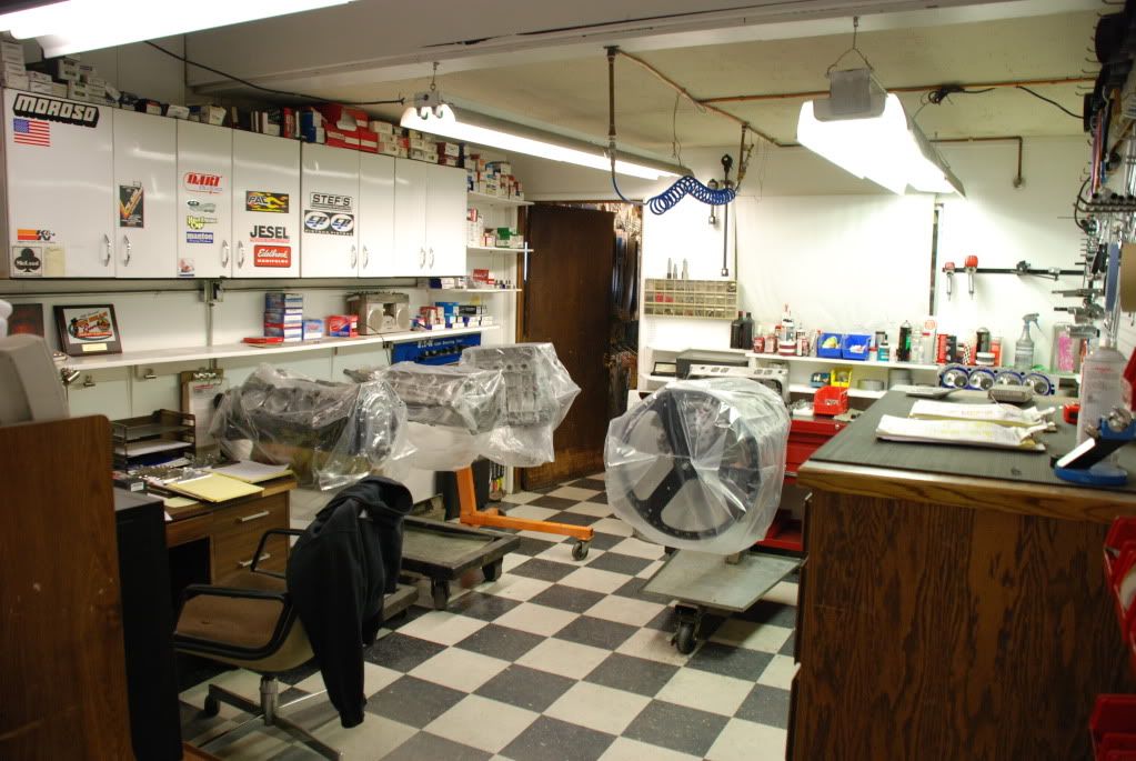

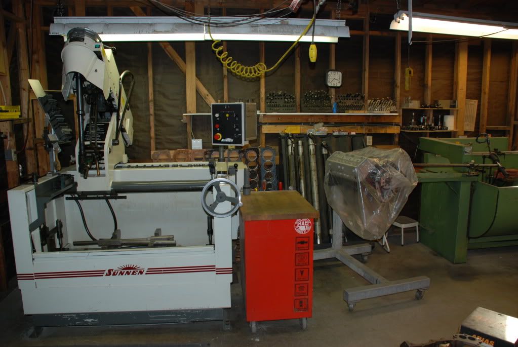

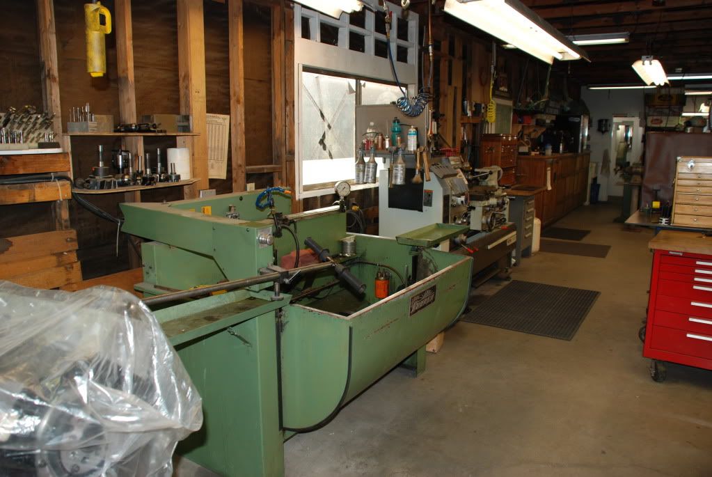

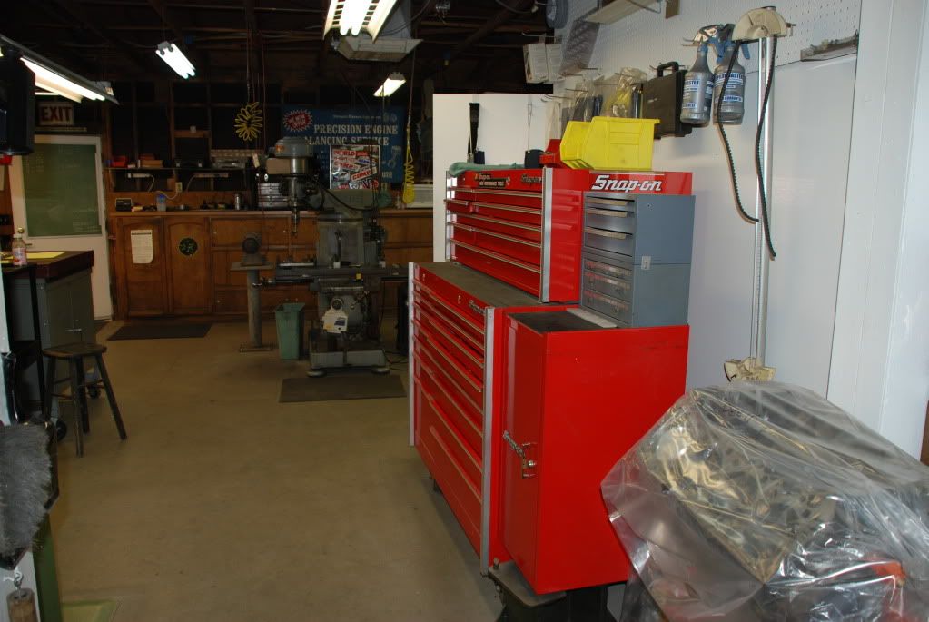

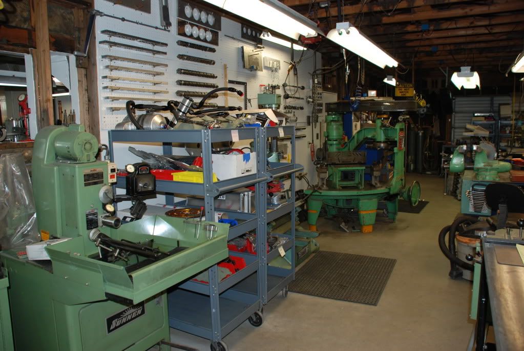

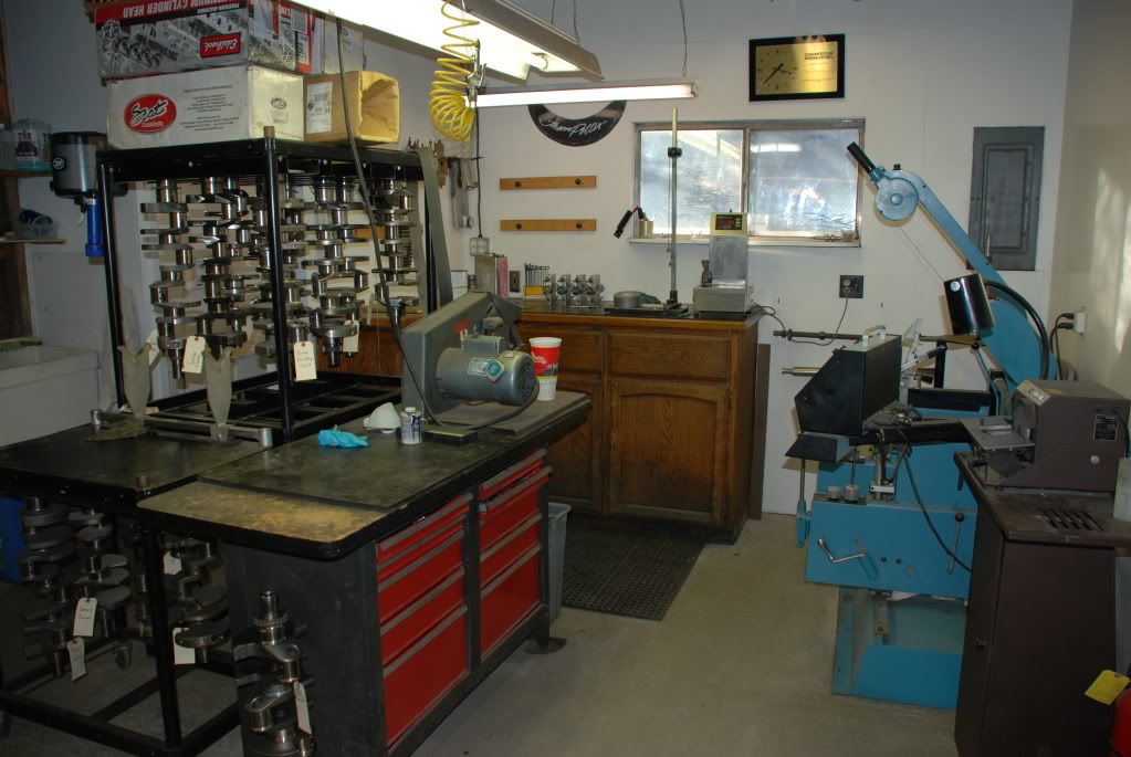

The shop was well laid out and CLEAN. Every machine you can imagine. Most were from the 60's and 70's. Quality equipment....
http://i200.photobucket.com/albums/a...oadTrip026.jpg
http://i200.photobucket.com/albums/a...oadTrip027.jpg
http://i200.photobucket.com/albums/a...oadTrip028.jpg
http://i200.photobucket.com/albums/a...oadTrip029.jpg
http://i200.photobucket.com/albums/a...oadTrip030.jpg
http://i200.photobucket.com/albums/a...oadTrip031.jpg
http://i200.photobucket.com/albums/a...oadTrip032.jpg
ironworks 12-17-2009 09:44 PM
Good thing you guys have careers, cuz you guys would make horrible detectives. All the info to know needed to know what is in the box is in the back of the truck. Seriously. Does he have to give you x ray vision to know what is in the box.
So Randy walker owned the contents of the box? That guy hauls ass, I think he won a season championship this year.
Vegas69 12-17-2009 09:44 PM
When I look at a engine shop, I want to see a seperate assembly room.

Nice work Todd. I have a feeling you are in good hands. And yes Rodger, I need Xray vision. Now I feel even more stupid for missing whatever is supposed to be in front of me. I am pretty sure it's a shortblock but I want the details.
ironworks 12-17-2009 09:58 PM
Nope even better....

70rs 12-17-2009 10:05 PM
:lol: Ok give me some help here. I just went and checked casting numbers just to double check any part of the number on the box. I give up.
I know this is entertaining for some. Like teasing a fat kid with a fat slice of chocolate cake. :rofl: I gotta know what's in the box.......:willy:

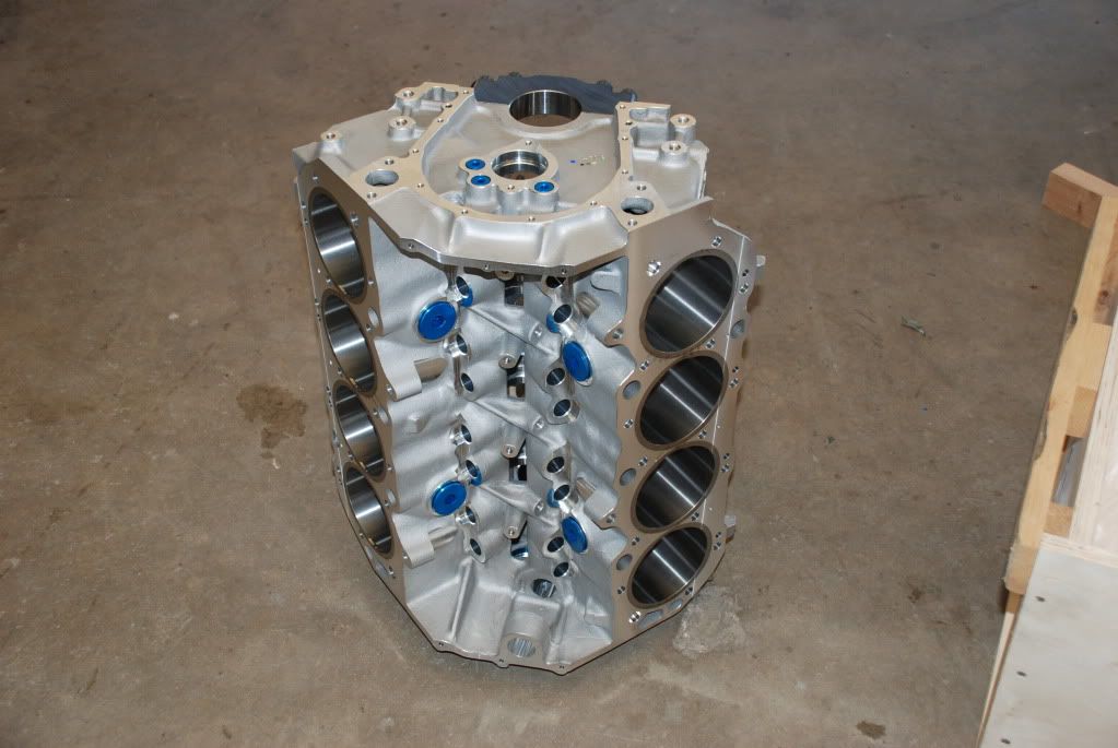

Vegas69 12-17-2009 10:05 PM

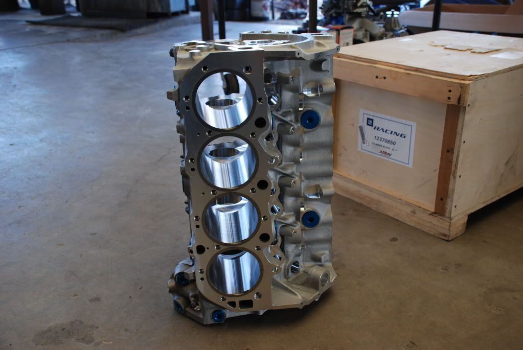

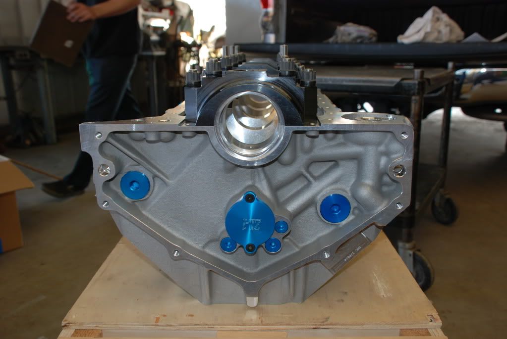

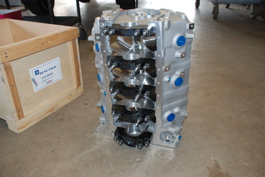

I ran across this really cool block while I was over there....:D
http://i200.photobucket.com/albums/a...oadTrip017.jpg
http://i200.photobucket.com/albums/a...oadTrip019.jpg
http://i200.photobucket.com/albums/a...oadTrip020.jpg
http://i200.photobucket.com/albums/a...oadTrip023.jpg
GregWeld 12-17-2009 10:08 PM
That makes a grown man WEEP!!
EEEEEEEEHHHHHHHHHAAAAAAAAAAAAAAAAAAAAA!!
70rs 12-17-2009 10:09 PM
NICE!! That will do the trick!:thumbsup:
ironworks 12-17-2009 10:16 PM
That is so awesome Todd, I'm happy for you.
The number on the box was the part number.
http://gmperformancepartszone.com/al...50-p-6079.html
70rs 12-17-2009 10:20 PM
What is max displacement for one of those?
GregWeld 12-17-2009 10:25 PM
4.300 bore - MAX
4.375 Stroke Max
Bore x's pie - times stroke times 8 -- 473 cubic incheroos

GregWeld 12-17-2009 10:30 PM
Eric -- It's a 427 block from the factory... 4.240" bore... jus like they made 'em back in 69 for the world famous, ultra rare ZL-1 Camaros....
Only Mo' Betta!
:cheers: :woot:

Vegas69 12-17-2009 10:36 PM
The max is 508 cubic inches. It will be a 489 since my SRP forged pistons are in good shape. Just need a polish. At the end of the day, I decided that this made the most sense for my car and my application. This ain't no drag car. :D That's another project! I'll have some updates with all the trick parts and machining..........
70rs 12-17-2009 10:41 PM
Does it require a re sleeve to get it up to 508 inches? I ask because of the max bore and stroke advertised on the web site that Rodger gave a link for.
