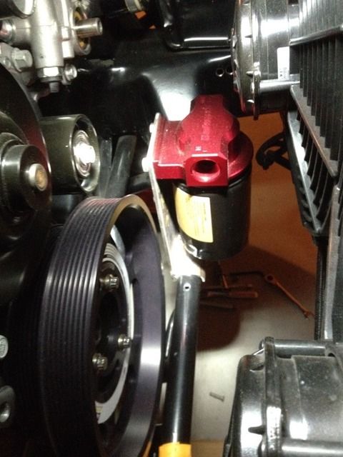

Yesterday we installed the Hamburger remote oil filter mount on the frame right behind the radiator. I will be running the -12 oil lines to the filter then to the in radiator oil cooler and back when I make my order for my hose and fitting, soon I hope.
http://i172.photobucket.com/albums/w...psl3yp8lgl.jpg

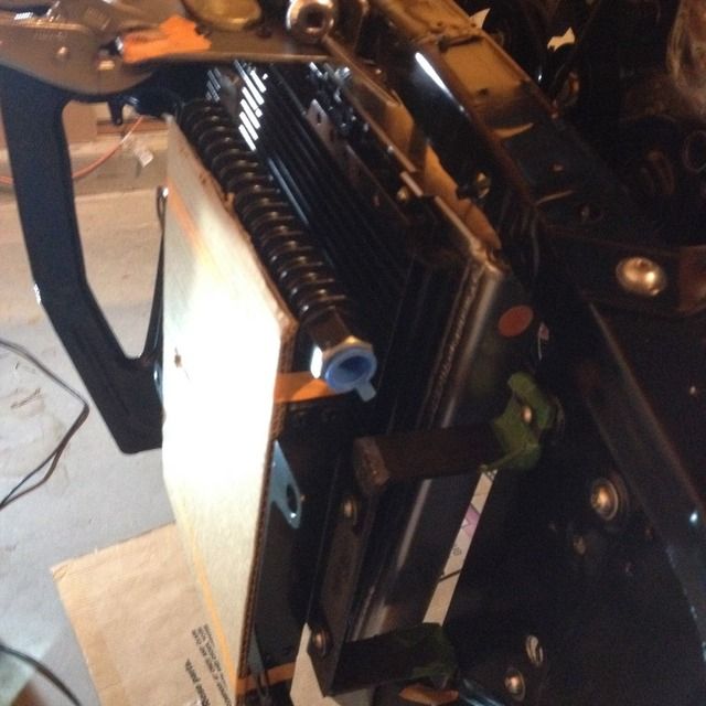

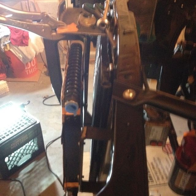

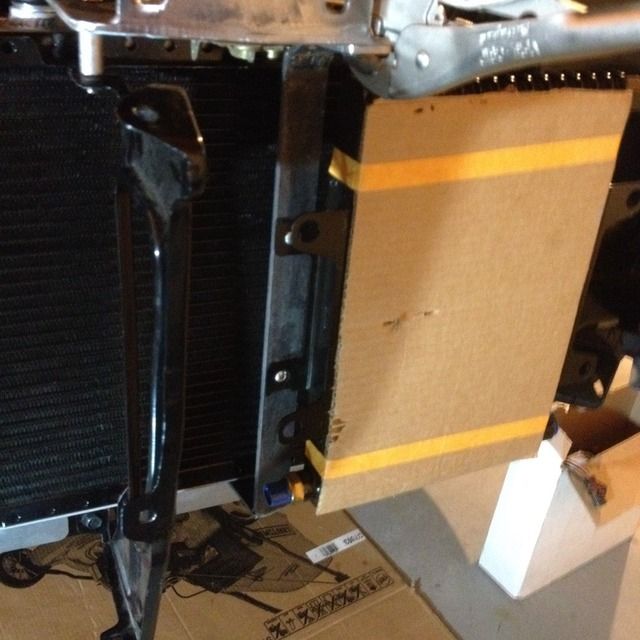

The next thing to try and stuff in there is the trans cooler in the white box in the bottom of the picture.

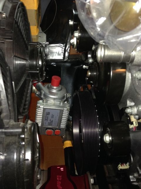

We tried to mount the intercooler pump but it didn't work out too well, the hose that goes to the heat exchanger was going to interfere with the radiator so we're moving the bracket.

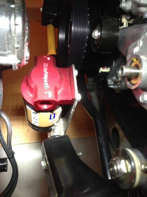

Not much progress this week, we had to move the remote oil filter because of my mistake. The fitting for the oil cooler stuck out further than I remembered and the mount had no room for the fitting. we made a bracket to mount it on the front bar Mike installed to replace the smaller front cross member on the sub frame, then made a bracket for the intercooler pump. I have no welder so everything has to go to Spaceman's house to be welded.There's more room than appears to be.
(Heavy little sucker)
http://i172.photobucket.com/albums/w...psl3oyifat.jpg
The remote oil filter from here
To here.
http://i172.photobucket.com/albums/w...pssbrqi0b2.jpg
http://i172.photobucket.com/albums/w...psbxwsmli7.jpg

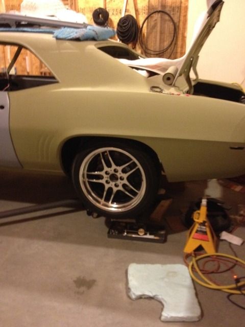

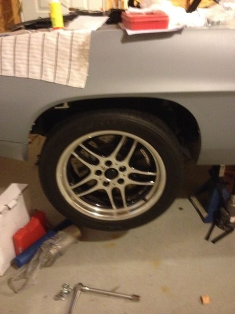

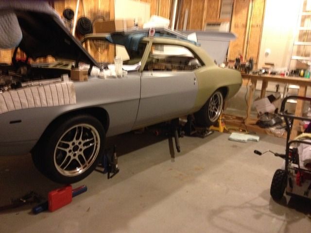

I also got the spacers I needed to put the BMW wheels on the back so now I'm all set for rollers to move the car. with my rear width I used 2" spacers.
http://i172.photobucket.com/albums/w...psses1xhlw.jpg
http://i172.photobucket.com/albums/w...ps9xpowr6v.jpg

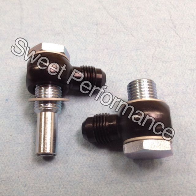

I got these fittings for my hydraboost.
http://i172.photobucket.com/albums/w...psx9hgohyx.jpg

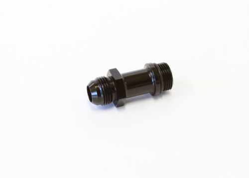

This is to drop the rear hose fitting on my oil cooler line so it can run one hose above the other along the oil pan.
http://i172.photobucket.com/albums/w...psx4pw69rr.jpg

Little update on some small progress. We made up some brackets and got the trans cooler mounted. I started to clean them up and ready to be coated. I also finished the mounting platform for the intercooler reservoir, I had the basic set up, but now I have the mounts figured out.
I also got word that my XRP fittings and hose are on their way and should be here on Thursday. BUT ! I leave Friday morning to go to Portsmouth Va. to check out houses for my daughter and her family. My son in law is in the Navy and being stationed there to work at the hospital (corpsman) but can't get time off from where he's at now to go see the houses before his transfer in April. Which I will be driving from San Antonio Tx to Va. with them driving one of their trucks while they drive the other one. I've done almost as many miles for his enlistment as they have lol. I had a great time driving from Mass. to Tx. with my grandson and daughter last August to get them there.
http://i172.photobucket.com/albums/w...psntwamur3.jpg
http://i172.photobucket.com/albums/w...psol2ozauh.jpg
http://i172.photobucket.com/albums/w...psbfyx9txy.jpg
I need to glue a piece of Neoprene rubber to my intercooler mount to protect the tank, any suggestion's on which spray glue to use 3M super 77 ? The tank shouldn't be that hot.
