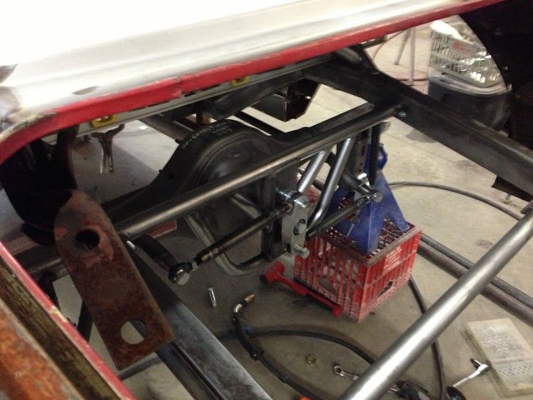

Time to put all of these pieces together
http://i1138.photobucket.com/albums/...ps39128182.jpg
http://i1138.photobucket.com/albums/...ps41dfbf92.jpg

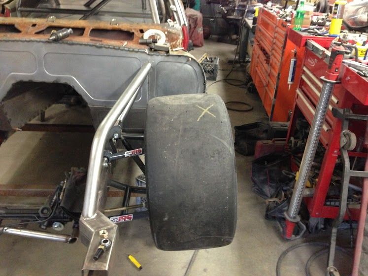

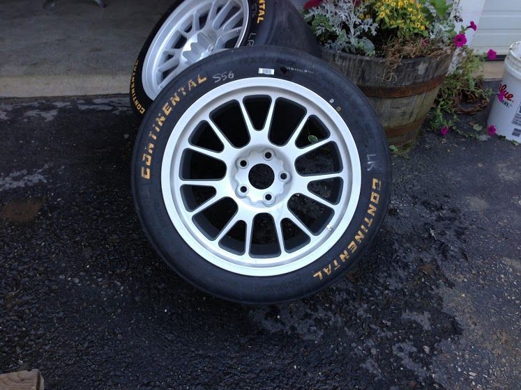

Payton King 09-06-2013 08:41 AM

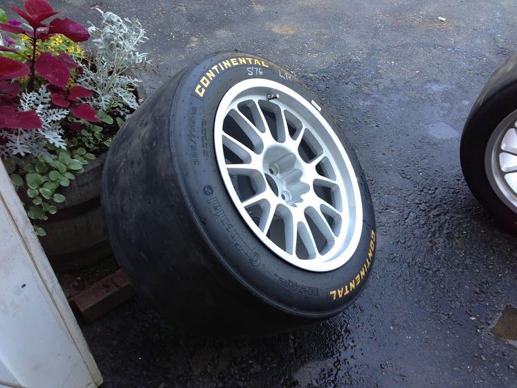

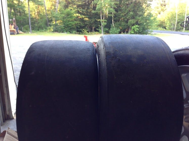

And get the tires mounted up
http://i1138.photobucket.com/albums/...psc3aaf6ae.jpg
http://i1138.photobucket.com/albums/...ps5aeeda45.jpg
Fronts are 18x12 with 680x325 slicks rear 18x13 710x325 You can see the height difference
http://i1138.photobucket.com/albums/...psc564daea.jpg

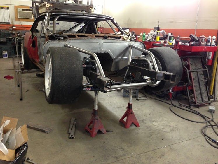

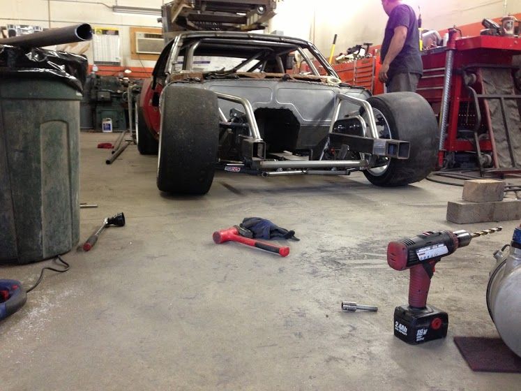

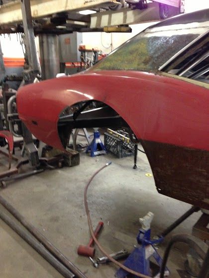

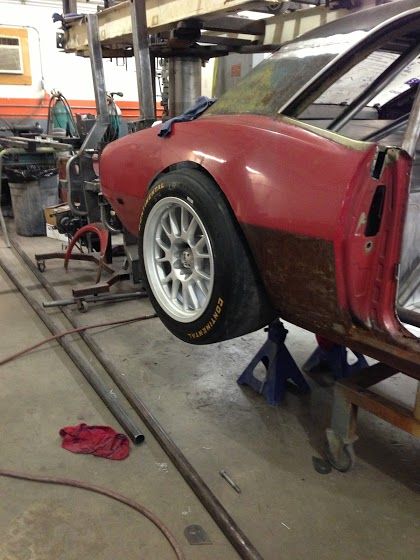

Payton King 09-06-2013 08:45 AM
The car is lower and wider than stock
Jake cut the quarters to make it a roller.
http://i1138.photobucket.com/albums/...ps0a708e0f.jpg
http://i1138.photobucket.com/albums/...psa1016ec3.jpg
http://i1138.photobucket.com/albums/...ps4ce1352e.jpg
http://i1138.photobucket.com/albums/...ps7a6eefbb.jpg
plenty of room inside
http://i1138.photobucket.com/albums/...psa020e99a.jpg

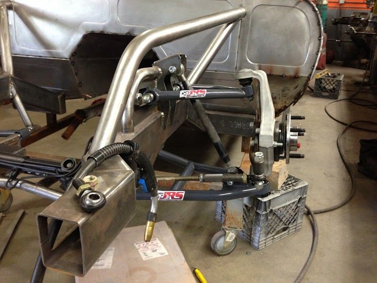

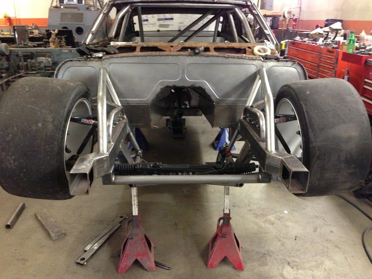

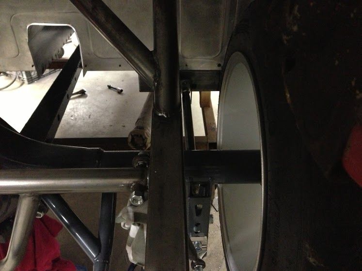

Payton King 09-06-2013 08:48 AM
Fronts bolted on
http://i1138.photobucket.com/albums/...ps2465bc58.jpg
http://i1138.photobucket.com/albums/...ps38714412.jpg
http://i1138.photobucket.com/albums/...ps391ec47c.jpg

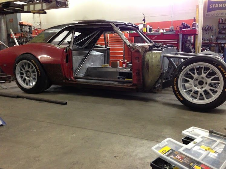

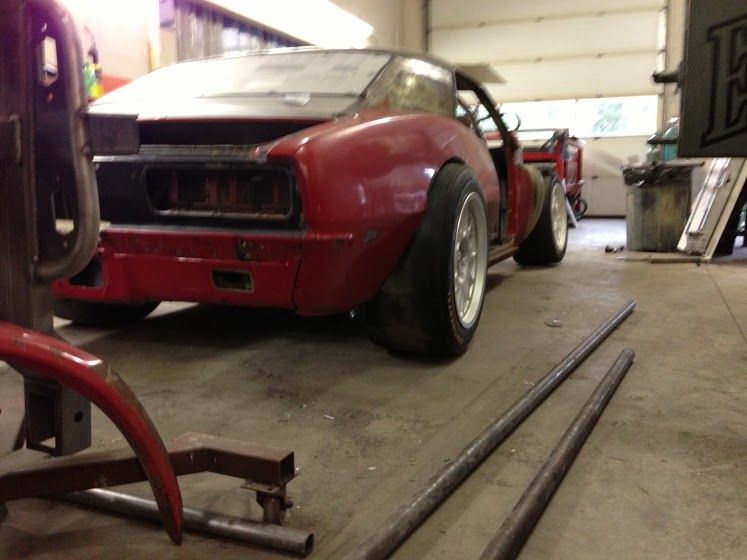

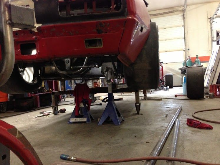

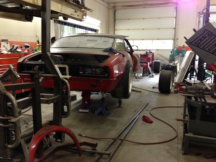

Payton King 09-06-2013 08:52 AM
on the ground
I am leaving Sunday to go and bring it home. Here it is as a roller. 46.5 inces from drip rail to ground at ride height.
http://i1138.photobucket.com/albums/...psefa0557d.jpg
http://i1138.photobucket.com/albums/...ps5ebf6c3b.jpg
http://i1138.photobucket.com/albums/...ps9fdc7c95.jpg
http://i1138.photobucket.com/albums/...pscccf36db.jpg

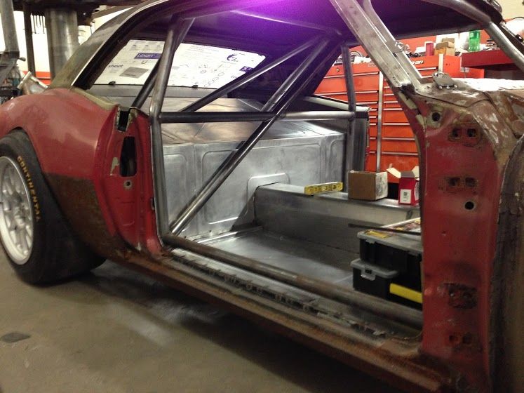

Jay Hilliard 09-06-2013 09:00 AM
Looking good. What is the plan for door bars?
Payton King 09-06-2013 09:29 AM
I left them out for ease of working on it
I have an X bar for the passenger side and NASCAR style on the driver's side.
