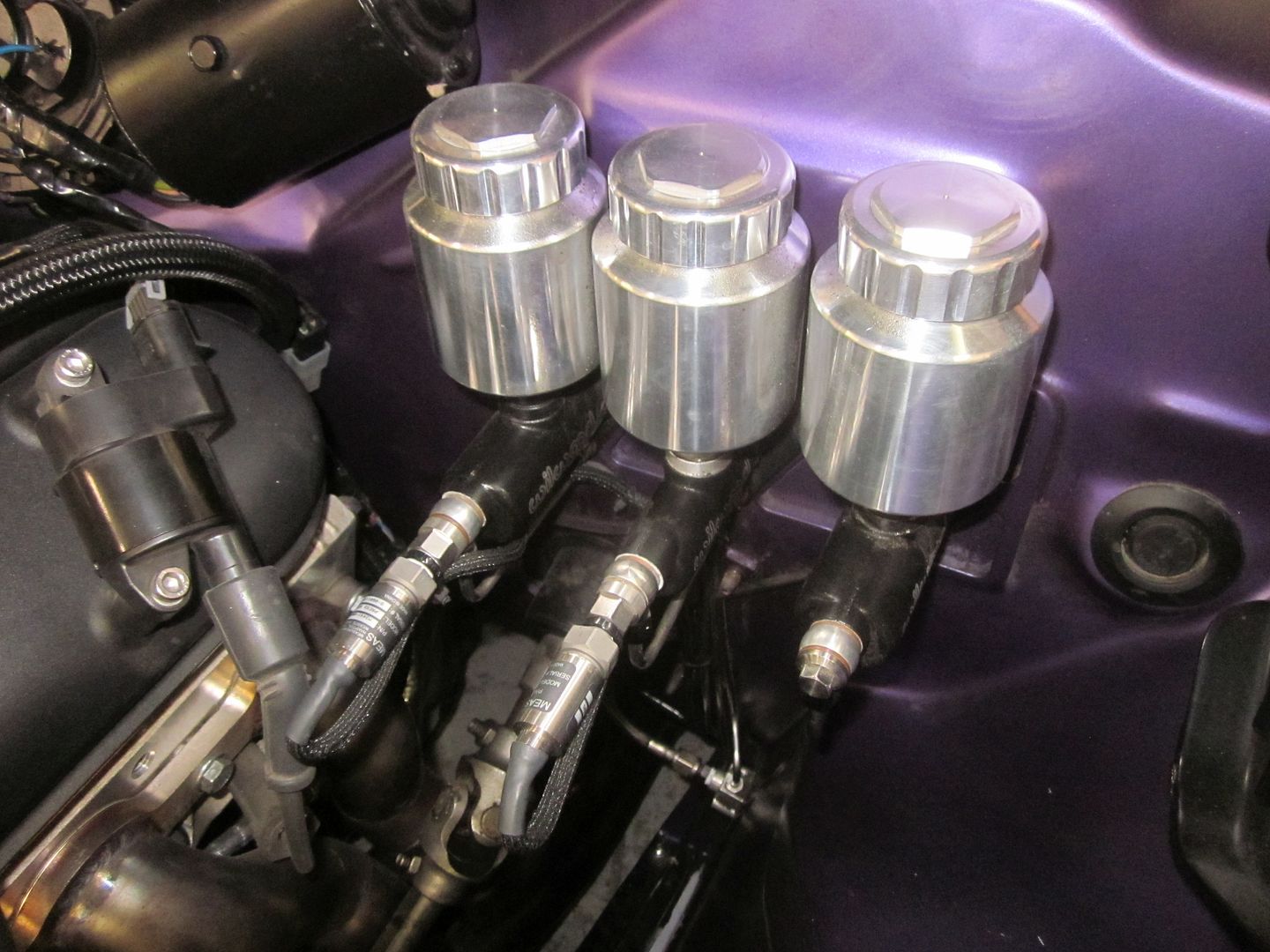

Cris@JCG 04-09-2014 04:47 PM
We have no brake issues with the Challenger! The brakes work good but want to make it easier to drive on the road course.. The Booster is not a band aid but an enhancement to improve on driving smoother & deeper into a turn to scrub off some speed.. Glad to see that your brake system works good for you on your Mustang..
Working for a brake company for 10 years.. I thought I knew a lot.. but when I started driving myself is where I finally realized that I had still much to learn.. Danny has taught me what it takes for brakes to survive a road course.. brake ducting, brake fluid, & most important brake pads.. Heat is your enemy on brake systems & deflection of components.. I continue to learn something new every day.. Karl is a pretty damm good driver & if I can improve his lap times with power brakes.. Then that is what he gets!
Everybody has different experiences or opinions with brakes & just like any other product that does not meet my needs or requirements.. I just take matters into my own hands! Sometimes manufactures make components so that they can be used in many different applications & the level of performance is not the same from one application to another.. I like components specifically to what my intended use is for ..
BTW- We have a full Aim Sports Data Acquisition that gives us brake bias readings..

Cris@JCG 04-10-2014 07:31 AM
Karl has chicken legs! He needs all the help he can get.. :D
Originally Posted by GregWeld (Post 546050)
Your build - your customer.... Not saying you shouldn't do whatever you feel like doing. Just saying that power brakes shouldn't do anything for you except to be able to run the pedal with your little toe instead of your big one.
I would find that my feet are way too busy to be trying to modulate a power brake let alone trying to trail brake one... but it's not my car. If I was only going to drive it on the street -- and I wanted a girl to drive it... then I'd put power on it. LOL :action-smiley-027:
We are currently running Hawk Brake Pads! The best improvement we could have made to stop the car plus running Castrol SRF brake fluid.. The brake fluid is expensive but all forms of racing is expensive..
I played with differnet bore sizes on the master cylinders & got them better for the manual setup..
