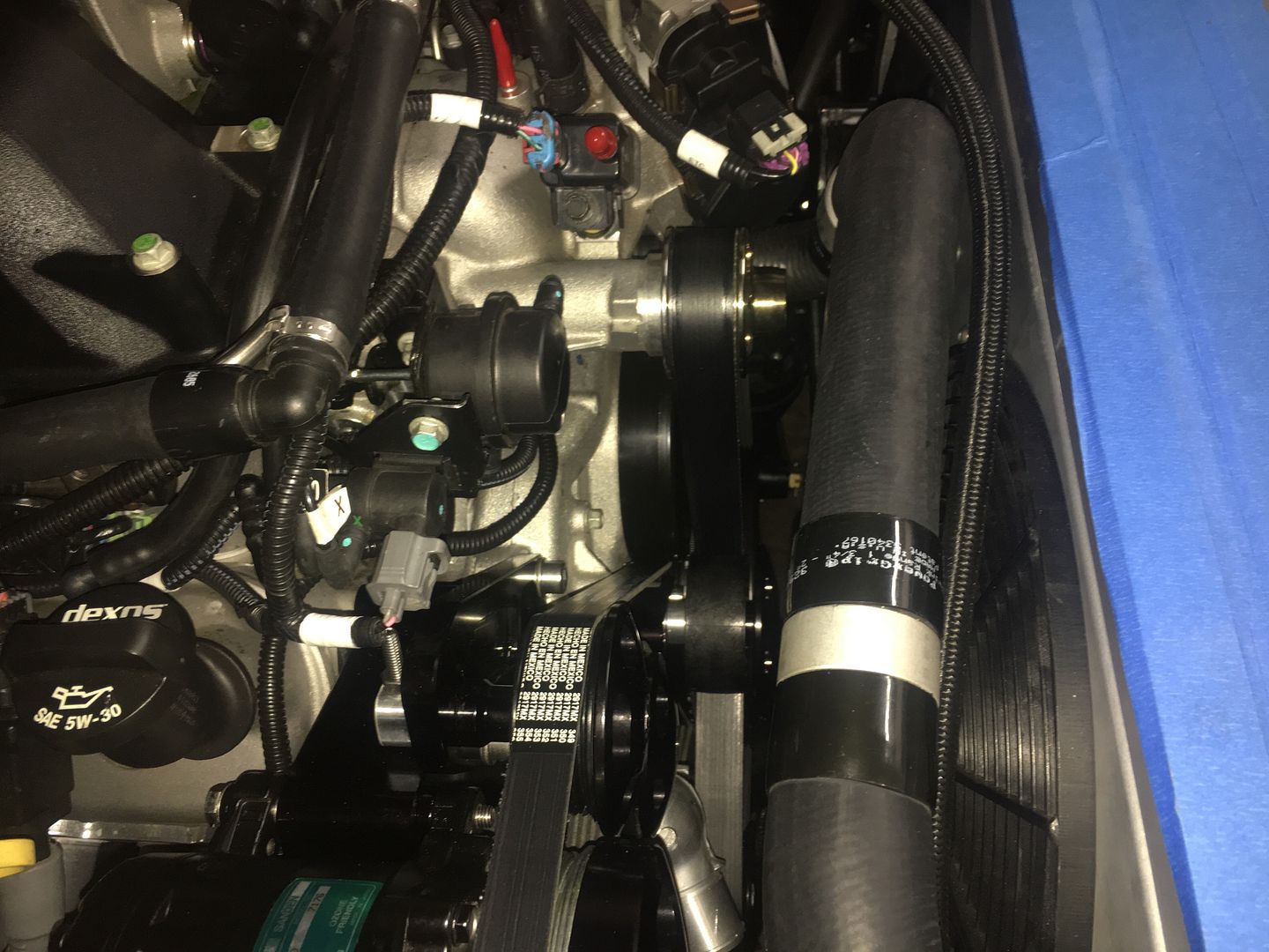

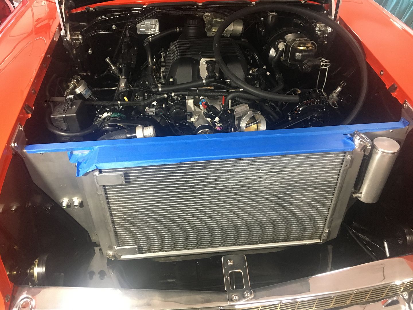

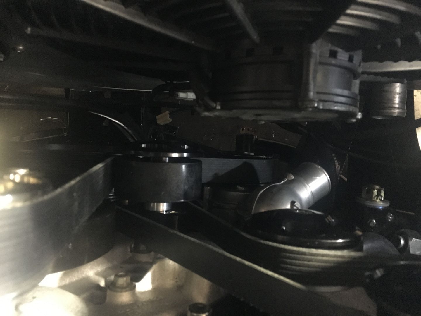

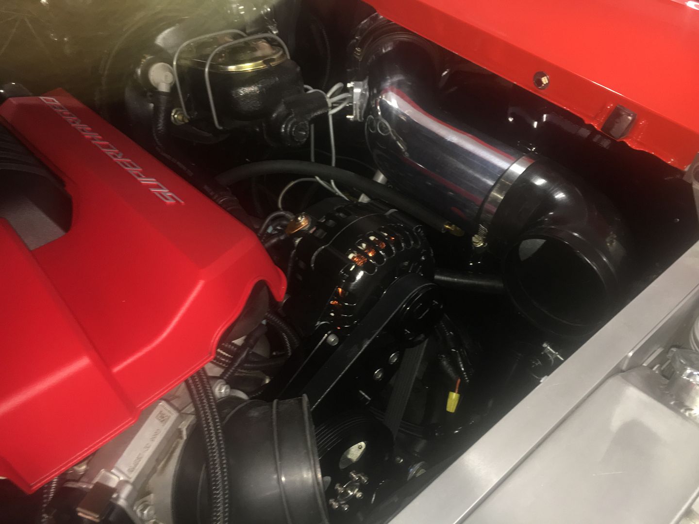

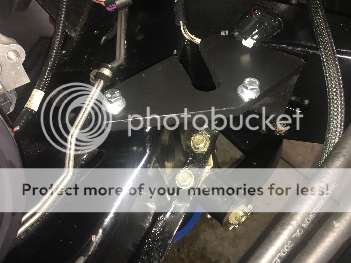

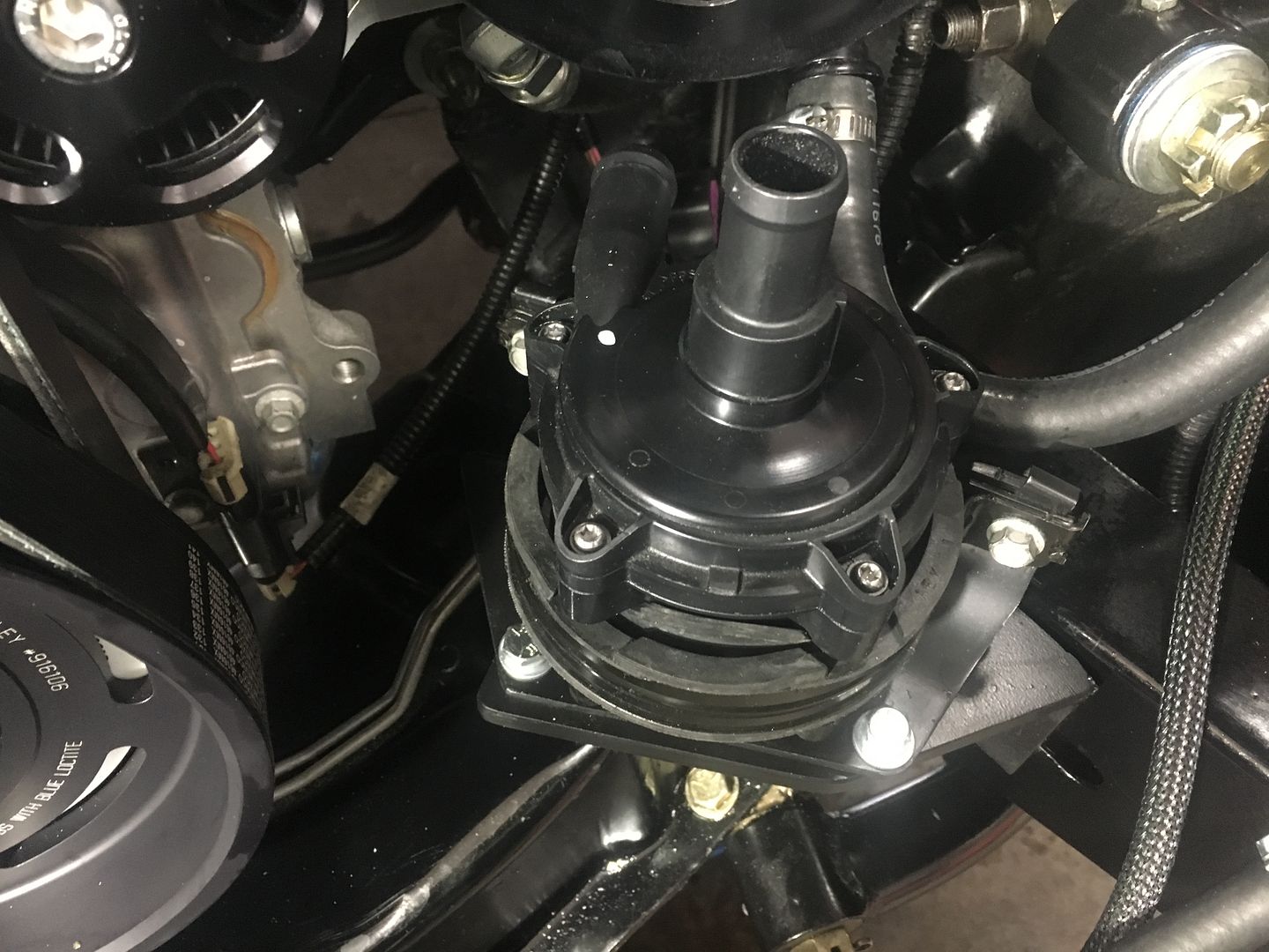

Just about finished with the install..... Great Unit very well engineered.... But with the components in different positions I had to move things around to complete the install..... Had to reposition and remake a mount for the intercooler pump....... reposition the power steering reservoir...... and make new radiator hoses (my most favorite thing to do.... LOL).....Then I have to make a new air inlet tube and reposition the GM fuse panel........ But....When it is all said and done I now have plenty of clearance to the front of the engine..... It was worth it all just in the comfort of knowing I can get at the front in case something happens while on the road......
New intercooler pump mount https://i13.photobucket.com/albums/a...d/IMG_4590.jpg http://i13.photobucket.com/albums/a2...d/IMG_4592.jpg Radiator going back in http://i13.photobucket.com/albums/a2...d/IMG_4594.jpg With the Concept1 setup in the fan motor was hitting the Tensioner......Lot's of room now..... http://i13.photobucket.com/albums/a2...d/IMG_4595.jpg http://i13.photobucket.com/albums/a2...d/IMG_4611.jpg |
Getting close and looking good!

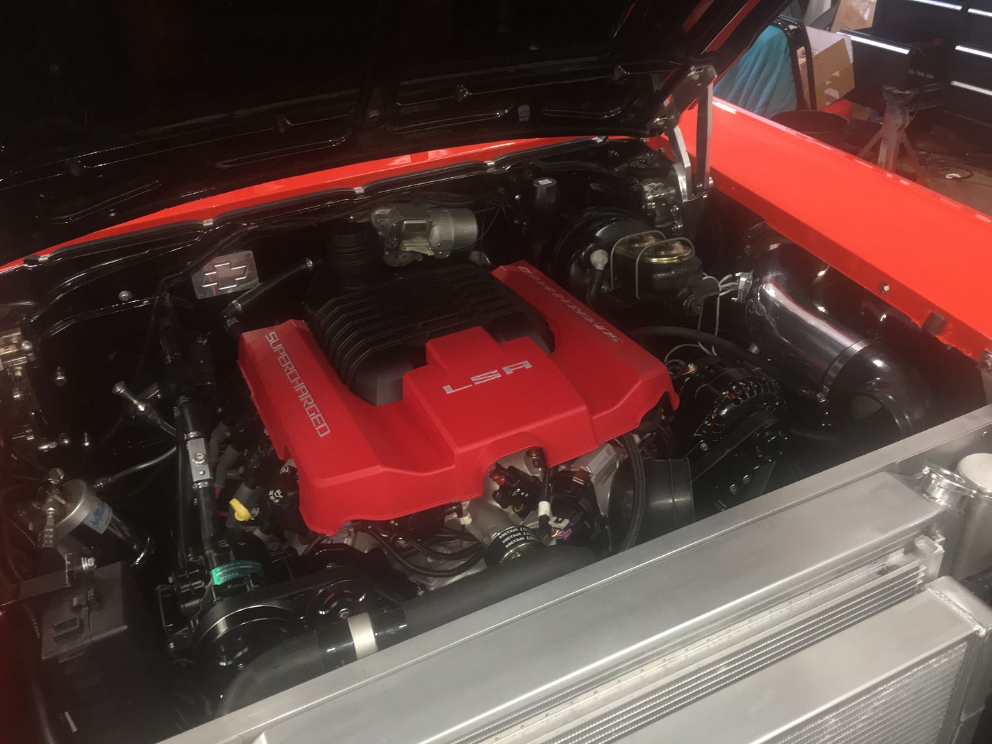

Compared to the old set-up...
There is all the room in the world to access the front of the engine now...

This picture isn't up to date, but the upper and lower hose's are in.....Filled with coolant.…now I have to wait for a 45 Degree elbow to show up so I can finish the new Air Inlet Tube in it's new position...… Then off to Frame-up to get the new A/C hose's made...…. Then we just need to get the front seat back from Tracey Weaver and we are ready for the Road Tour...…
