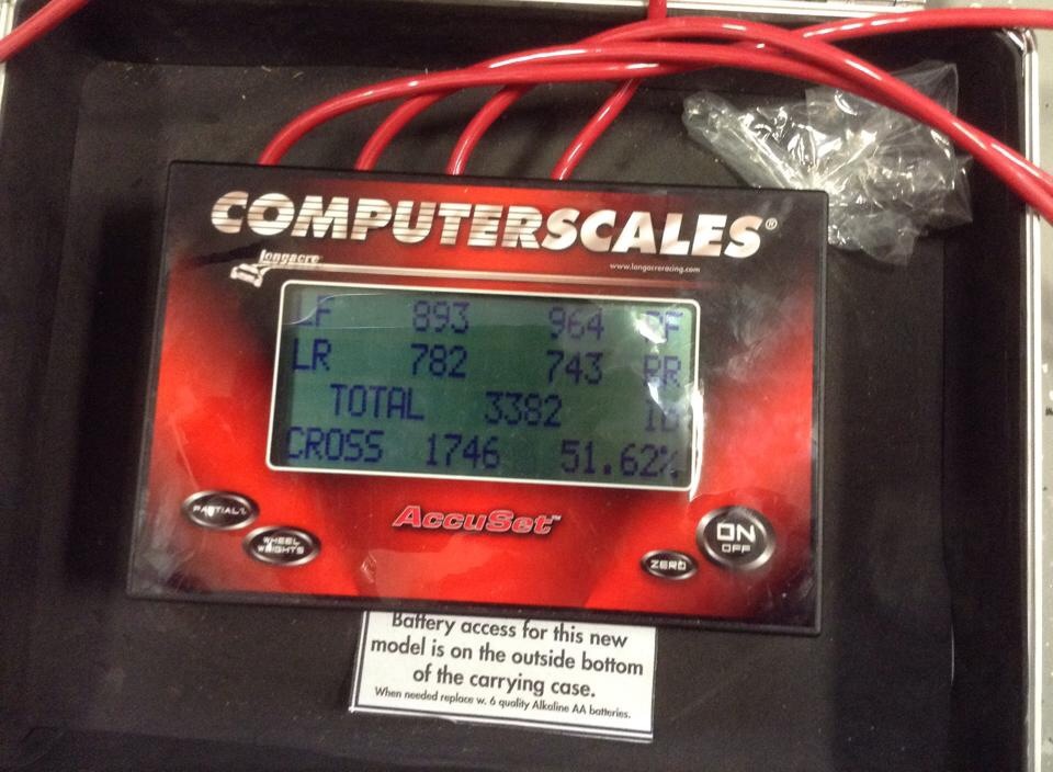

Stielow 10-04-2014 06:18 PM
1 Attachment(s)
Attachment 81990
We scaled the car today. It was close to my estimate of 3350 lbs. We hit 3382 lbs and around 51.6 front weight. This car is over 150 lbs lighter than Red Devil and is up over 150 HP. Over all I'm happy with the way it turned out. This car is a tad heavier than Mayhem but the weight bias is a lot better. The better weight distribution and the down force should make the this car faster than the last two.
With the added cooling on this car I'm happy that the front mass was as low as it was. The engine cooling system holds 4 gallons and the intercooler system hold another gallon. So I have 40 lbs of water under the hood.
The car has A/C, dynamat and a full sound system. So it is a car you could take on Power Tour.
Mark

Sieg 10-04-2014 07:57 PM
Impressive number considering the level of components under the skin of this car.
Did you weight the metal vs carbon body panels?
