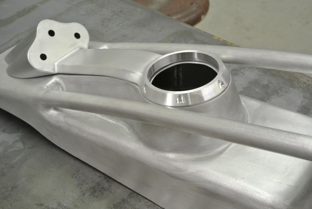

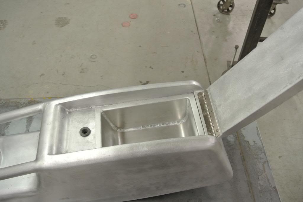

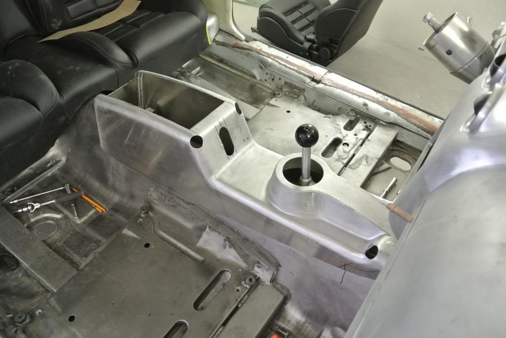

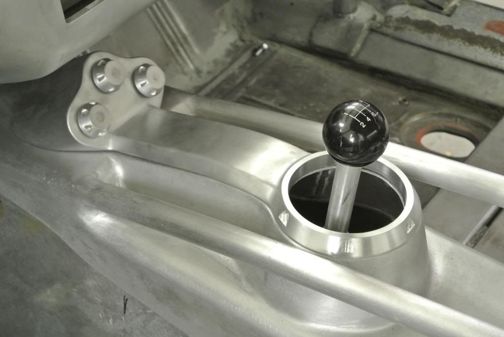

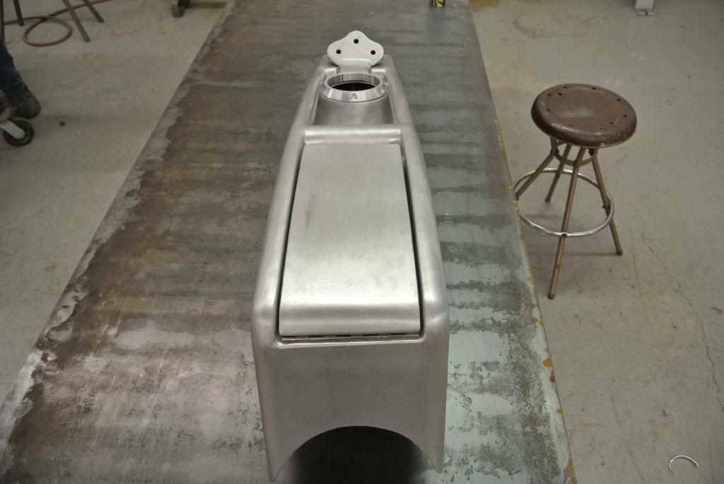

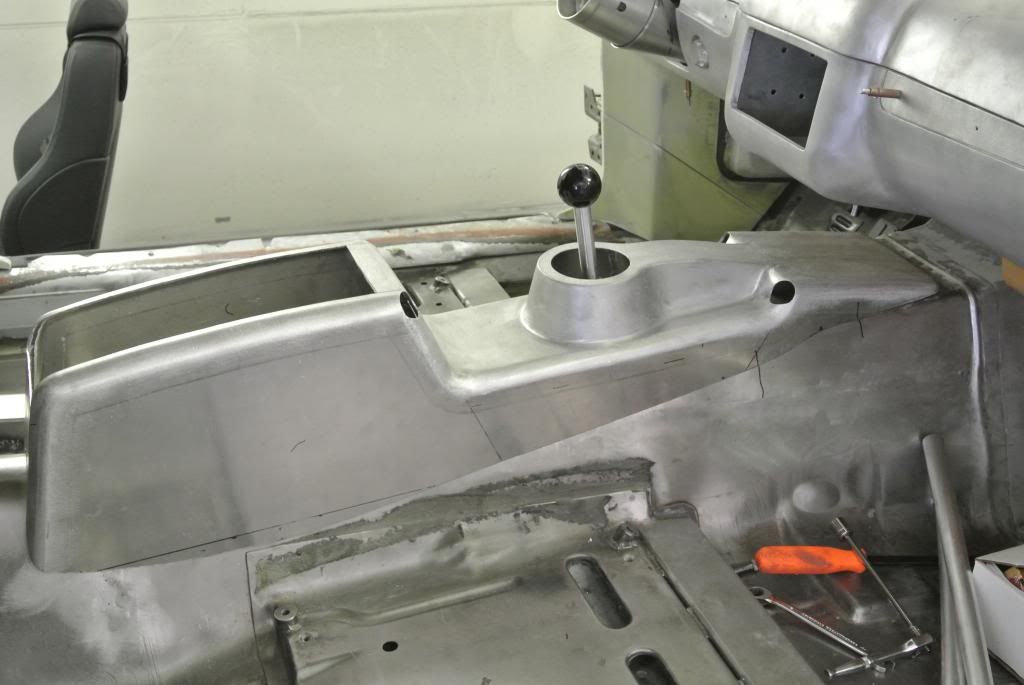

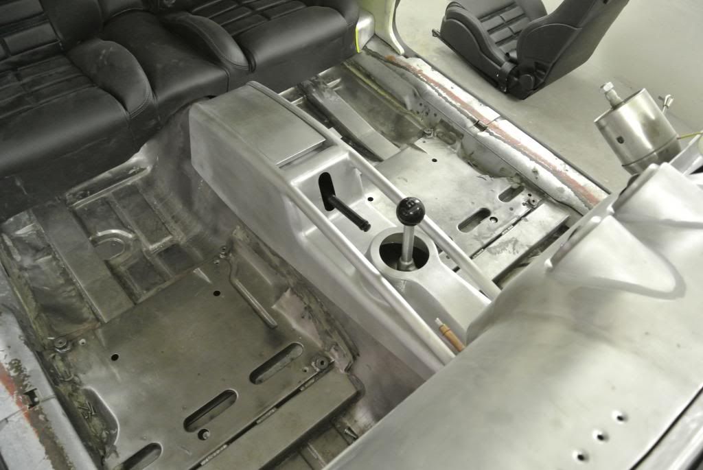

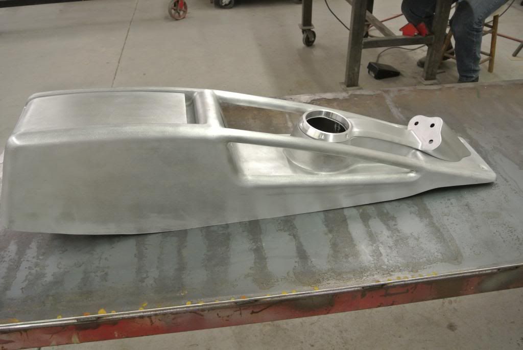

BBT FAB 01-25-2013 07:53 AM
http://i32.photobucket.com/albums/d3...psf7f00658.jpg
http://i32.photobucket.com/albums/d3...ps29c918ef.jpg
http://i32.photobucket.com/albums/d3...psc3ee0a0e.jpg
http://i32.photobucket.com/albums/d3...psb74e236c.jpg
http://i32.photobucket.com/albums/d3...psaf40704c.jpg
http://i32.photobucket.com/albums/d3...pscb35835a.jpg
http://i32.photobucket.com/albums/d3...ps93ee0734.jpg
http://i32.photobucket.com/albums/d3...ps7b6e054a.jpg
-troy
coolwelder62 01-25-2013 08:09 AM
Very nice.I love the grab handle's.:thumbsup:
