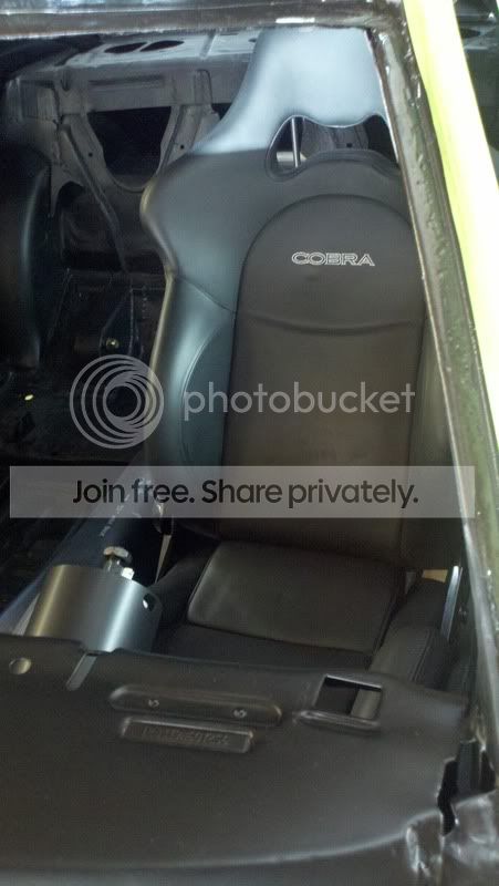

Here's a fun milestone. I actually 'sat' in my car for the first time ever:
http://i885.photobucket.com/albums/a...-25-00_970.jpg
Pics and details soon guys...:cheers:

Sorry Mr. Personality :D , no pics. I've been out on the road and not seen the car in a few days. I know Brett's got some...:yes:
Originally Posted by Rick D (Post 428829)
Yah come on Ron or Brett we need an update!! :cheers:
Ricky D! Here's an update for you...We got the drivetrain together, finally, and in the car. One of those milestone moments where we're not planning on taking it back out again. Harness is getting recovered and coolers/oiling getting micked up. Should have some serious progress and pics this week :cheers:
