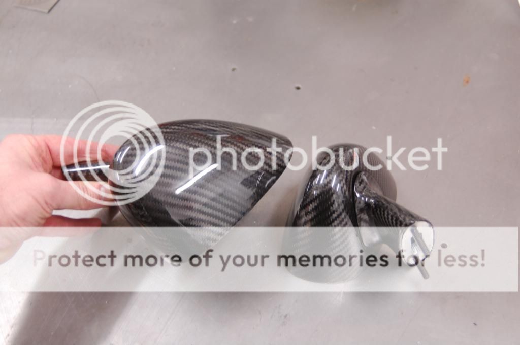

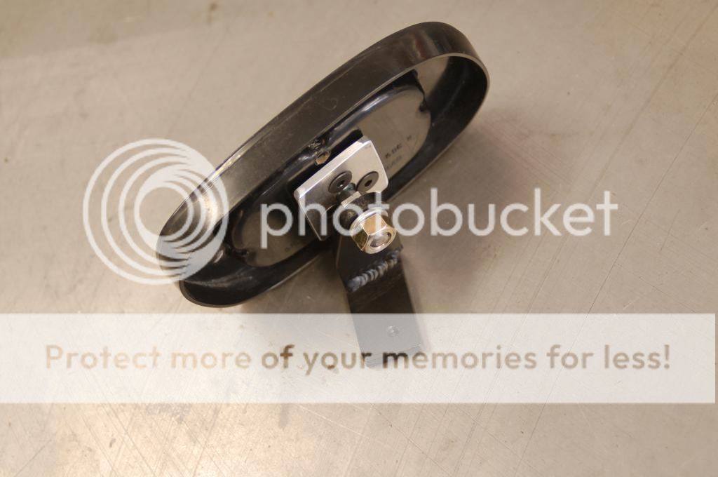

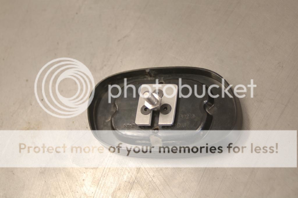

I quick note on how I modified the Anvil mirrors. You need to use the internals from a 2nd Gen Camaro mirrors. I don't like the cable operated drivers side mirror so I make my own mount using a stud ball from McMaster Carr and make a few small parts.
http://i439.photobucket.com/albums/q...ps8a39fc81.jpg
http://i439.photobucket.com/albums/q...ps60694645.jpg
http://i439.photobucket.com/albums/q...ps9a8edec0.jpg
I also had to make mount to bond to the mirrors to mount the mirrors to the doors.

Pretty sure there's a market to have these bit mass produced Mark! I'd love to eliminate the cable on my driver's side mirror! Tight work! :thumbsup:
