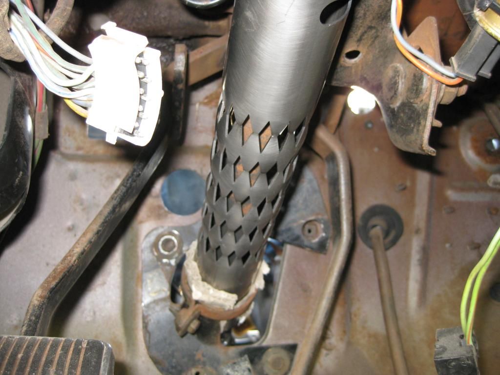

I went outside and was thinking of starting on my lower steering shaft firewall plate. It was only 98 here today but that was hot enough for me to lose motivation for today.
I did take a shot of the lower portion of my column. You notice I ordered my column as a collapsable style. Some may say it is overkill in a rack and pinion steering set up to have a collapsible column but for a few extra $$ I'd say better safe than sorry.:bitchslap:
In the Woodward catalogue they discuss always using a collapsable shaft no matter the steering system set up. I think I'll trust them on that one.
It's not an AN fitting or a Bracket so I believe it is an appropriate picture to post.:rolleyes:
http://i291.photobucket.com/albums/l...ps2643b33c.jpg

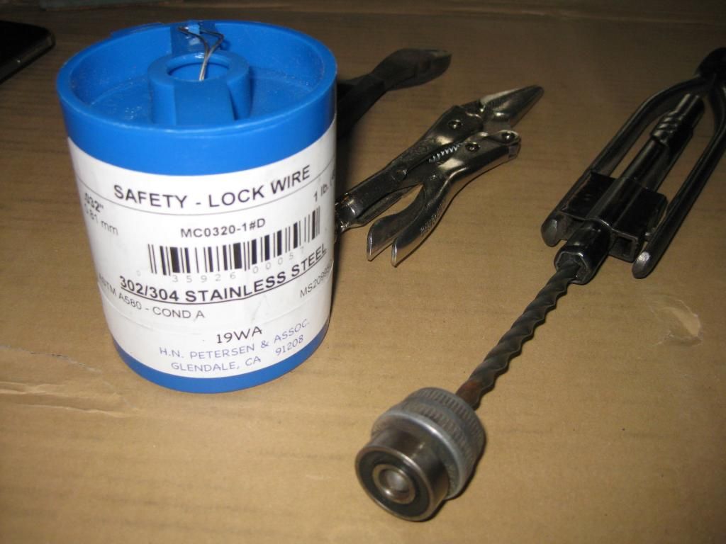

It was still oppressively hot today:fire: so I sat and watched the Rolex 6hr this am and multitasked on a little project I need to finish. :D One down 23 to go.:faint:
http://i291.photobucket.com/albums/l...psb098e86a.jpghttp://i291.photobucket.com/albums/l...psc6f6722d.jpghttp://i291.photobucket.com/albums/l...ps5191415b.jpghttp://i291.photobucket.com/albums/l...ps81e967a6.jpg
http://i291.photobucket.com/albums/l...psb8e2aef1.jpg

Originally Posted by b757jetdr (Post 490500)
Rob,
Nice job on the wiring job! I know 20 yr aircraft mech that can't wire that good!:thumbsup:
I will have to dig up a tool I have here at work that will make that a TON easier, I will see it I can dig it up and post some pics!
Cable ties would be the easy route that I know of. An Aircraft crimping tool Is my guess. I wonder what you are coming up with? :headscratch:
So I knocked out one of the rears. I think I'm going to grab a set of 6" pliers in both lefty and righty. It would make this process way faster. Between my sausage fingers and the old 9" safety wire pliers I have this rotor took me too long.
http://i291.photobucket.com/albums/l...psb60a6c4e.jpg

b757jetdr 06-30-2013 05:48 PM
http://i291.photobucket.com/albums/l...psb60a6c4e.jpg[/QUOTE]
Rob,
Pretty good guess and description. I have the 6" left and right pliers if you need them? I will dig up that tool tomorrow and see about some pics.

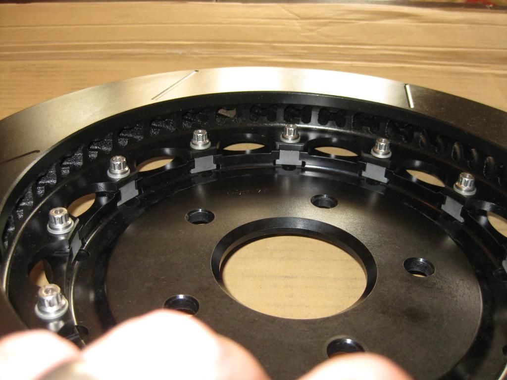

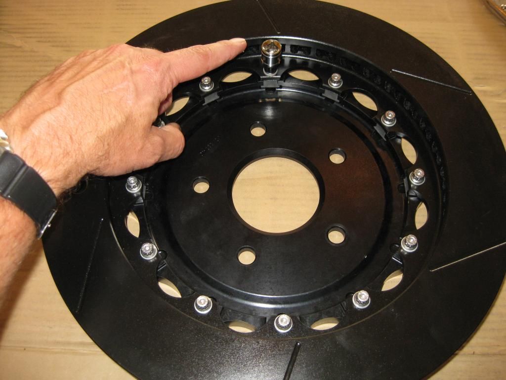

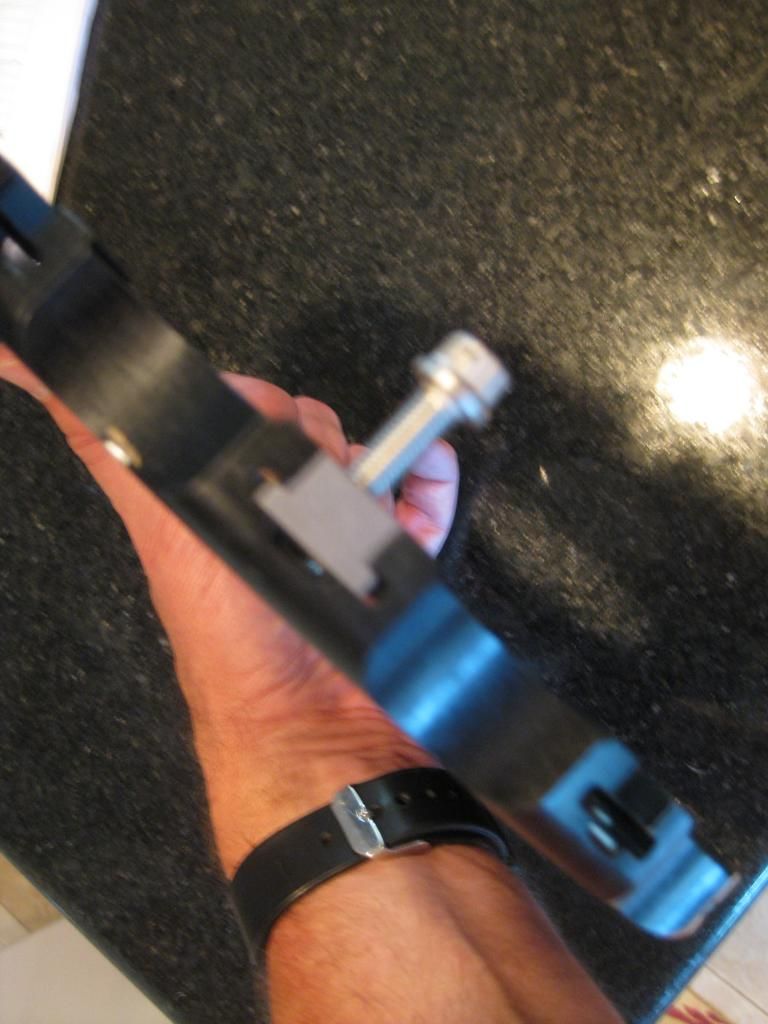

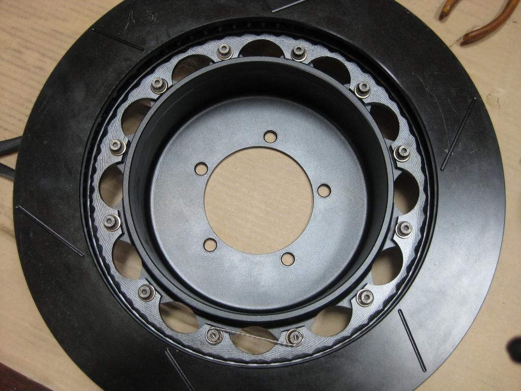

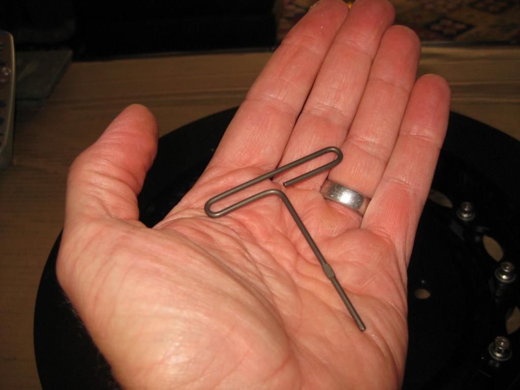

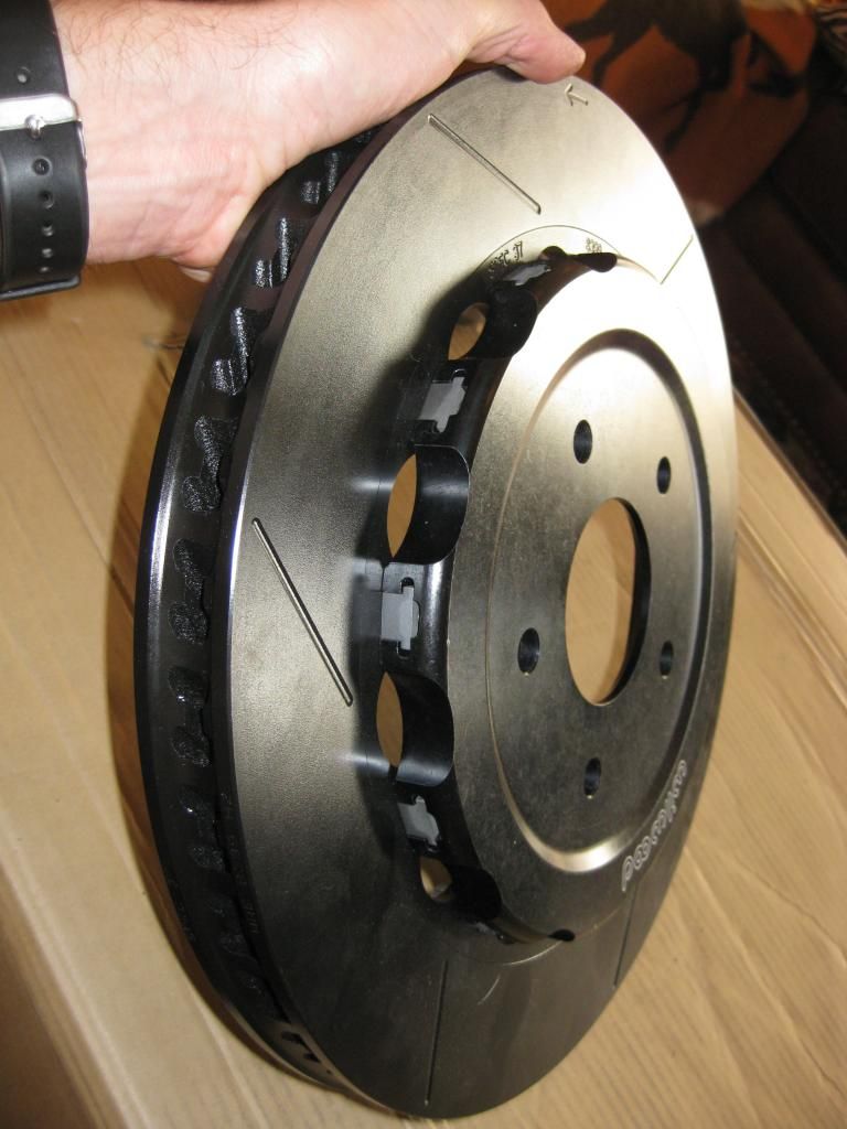

So before I got around to safety wiring the rotors I had to build them up. It is a simple exercise but it took a bit of time to do. Part of this is me being anal about putting them together.
Why worry about assembling brake parts right.:lmao:
http://i291.photobucket.com/albums/l...psc618e490.jpg
I'll run through this quick. It also gives me a chance to show off my Wilwood floating hats.:hapdance:
Here one is.
http://i291.photobucket.com/albums/l...ps7ae7549b.jpg
It's AL like most of the front hats but you'll notice the T slots in it instead of just threaded holes.
Into these you inset these little T nuts.
http://i291.photobucket.com/albums/l...ps209457fa.jpg
http://i291.photobucket.com/albums/l...ps977e9b3b.jpghttp://i291.photobucket.com/albums/l...pse83d7269.jpg
Man that is a crappy picture. I can't wait to hear GWs comment on that one. :rolleyes:
This allows the rotor to "float" on the hat. This really separates the hat and the rotor into two separate pieces. Having two separate sections of the rotor and hat helps to keep heat generated in the rotor off of the hat. By keeping the hat cool you are less likely to have any flex, giving you more feel and braking predictability under extreme braking conditions. A floating rotor also allows for much more contact surface between the rotor and brake pads since the rotor itself follows the path of the pads correcting any imperfection either may have as it floats.
http://i291.photobucket.com/albums/l...psc1ae3024.jpg
Now with anything that requires a definitive torque value I make sure the threads are clean and free of burrs. In most cases that means a quick run of a tap through the threads.
In this case the stainless bolts are nice and hard compared to the T nuts so I just dry fitted them. If any of the bolts had bound as I was assembling the rotors I would have got a tap out for that one. :warning:
With these T nuts you use a small T wire to ensure the nuts don't rotate as you torque the bolts.
http://i291.photobucket.com/albums/l...ps65c2356b.jpghttp://i291.photobucket.com/albums/l...ps761e80e0.jpg
I didn't have any issues with this set. Once the rotors are completely assembled to hand tight it's time to loctite and torque them.
I use two sockets of the same size to make the next step easy. Once I torque a bolt I leave the socket on it and then go to the bolt directly across to torque in a criss cross pattern. the first socket serves as a marker to remind me where I just was.
http://i291.photobucket.com/albums/l...ps2e5321eb.jpg
Once you put a bit of loctite RED on all the bolts bolt and torque them to 125 in lbs (in this case) it's time to get out the safety wire pliers.:hairpullout:
:cheers:

FETorino 06-30-2013 11:18 PM
Originally Posted by b757jetdr (Post 490517)
Rob,
Maybe one of these

I've never seen that safety cable system, very cool and quick! :thumbsup:
You see Sieg my thread isn't all bad after all:mock:
Originally Posted by b757jetdr (Post 490625)
Rob,
That is the gem! We use it when access is limited. I will try and round mine up here at work and if your interested in trying it let me know.:thumbsup:
Chris I wish you were closer I'd take you up on that. Right now I'm justifying adding one to my tool inventory. I mean they are only $:censored: plus about $1.10 per cable. :confused59:

Originally Posted by FETorino (Post 490747)
Nothing in life is free. You pay for everything one way or another. If your rotors came pre assembled to the hats then you paid for it in the cost of the brakes. I'd rather pay for R&D and material or machining costs than for assembly. I feel with Wilwood you get better quality at the same or lower price point than some of their competitors.
It may also have to do with inventory management. For my application I wanted 14" slotted e-coated rotors and floating hats.
Somebody else may substitute standard hats with the same rotors. or smaller rotors or drilled rotors, ect.
By not assembling the complete package you don't need to stock as much inventory and yet can likely have exactly what the customer wants in stock when they order. The customer doesn't get stuck with the choice of get what I have or wait:shakehead: For a smaller company they offer a large product line that is readily available.
I'd say their model works pretty good.:thumbsup:
It's a Brake Buffet Extraordinaire!
All your points are good, though I wonder if liability factors in.
As previously mentioned I really enjoy assembling components like those. :yes:
