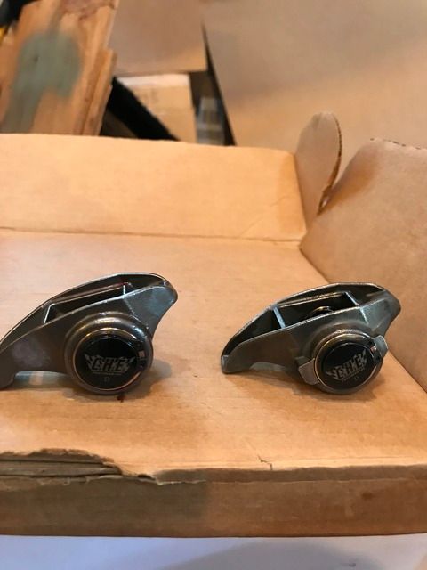

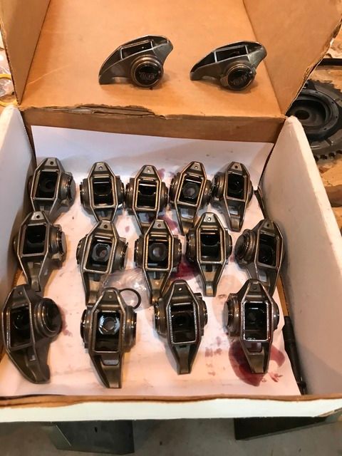

The rocker are all together with the CHE trunnion bushing. I had something to do today, they'll go in Monday.
It took no time at all to do the trunnion swap.

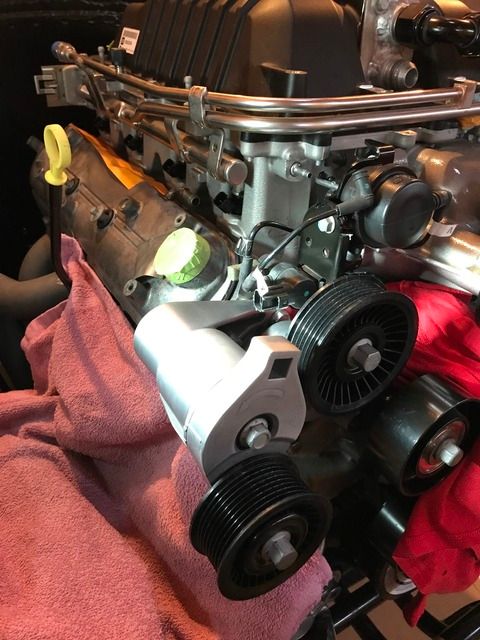

Last week I went on an excursion in the garage. I had been reading to find out if my supercharger had the solid isolator or the problem some spring isolator. All the reading on forums said it's the spring isolator a call to a GM dealer agreed. So to get ahead of it I decided to change it to the solid one since I had it and the water pump and everything was off the motor. Every one was pretty sure the super charger didn't have to be lifted if I could get to the bottom bolt on the snout. We got it. We broke the snout loose and it couldn't make it over the valley cover breather tube. Then we lifted to S/C and the snout came right off SWEET! Wrong! my crate motor shipped with the solid isolator that GM was sure it didn't have.
A whole day wasted and a whole lot of curse words I haven't said in years. At least I'm sure it good to go.

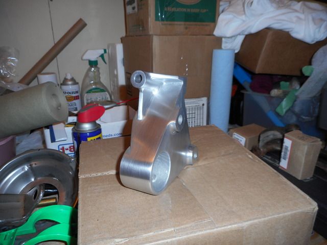

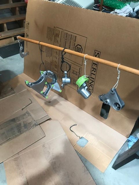

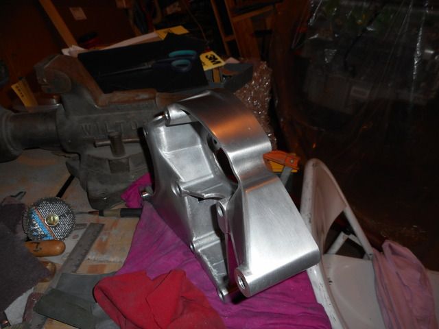

Last winter I started smoothing the factory accessory drive to give it a brushed look. I did most of the flat sides and left the inside pockets alone. I finally got around to finishing them and clear coating them. I used Eastwood's 2K Aero Spray Matte Clear, I think gloss would have been better.
http://i172.photobucket.com/albums/w...ps0pganowr.jpg
http://i172.photobucket.com/albums/w...psnf6cdo4q.jpg
http://i172.photobucket.com/albums/w...pske1sa41s.jpg
here it is painted and installed.
http://i172.photobucket.com/albums/w...psj2hhbz0h.jpg
http://i172.photobucket.com/albums/w...psawiuijmj.jpg
http://i172.photobucket.com/albums/w...psoefkdqbx.jpg

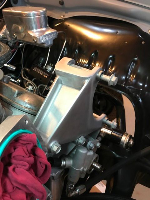

We did a little in the garage today we decided to put the power steering reservoir next to the brake master. So I took the bracket that holds the Alt,and steering pump off and made a hole above the pump so the return hose could come up and over the bracket then between the bracket and the valve cover. From there it will run over to the reservoir mounted on the inner fender.
Here's where I made the hole for the hose to come up over the bracket.
http://i172.photobucket.com/albums/w...psa8cmmh2j.jpg
It will run straight and further away from the header heat.
http://i172.photobucket.com/albums/w...ps3w13yhdx.jpg
We're going to try to fit it between the fender and the brake reservoir.
http://i172.photobucket.com/albums/w...ps7k4u7h1p.jpg
