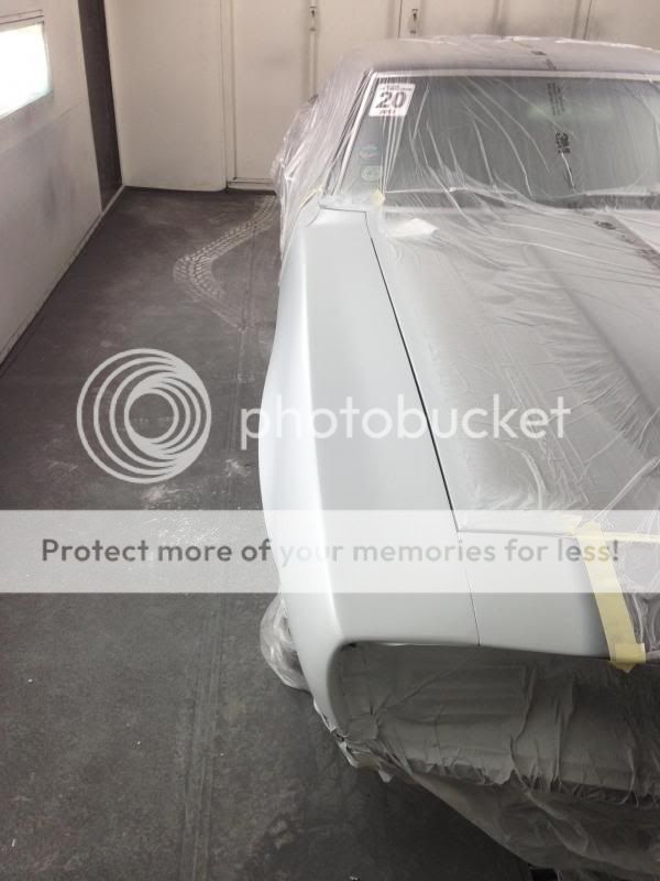

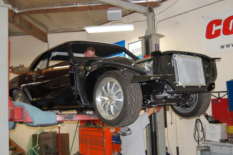

Matt@BOS 07-23-2013 10:05 PM
http://i366.photobucket.com/albums/o...ps800f4d42.jpg
http://i366.photobucket.com/albums/o...ps03dcd8bb.jpg
http://i366.photobucket.com/albums/o...psc580a36c.jpg
Al Moreno 07-24-2013 08:17 AM
SWEEEET, not much longer Matt

We didn't really do anything to the fiberglass fenders other than improving the fit and finish on the door gaps and getting rid of the low spot above the body line, behind the wheel openings. Pretty much all factory and aftermarket sheet metal is shaped that same way.
On the other hand, the work on OLC's fenders were pretty extensive and required both cuts and English wheel work.
They are really two completely different animals. In about a week I can tell you how big a tire you can fit.

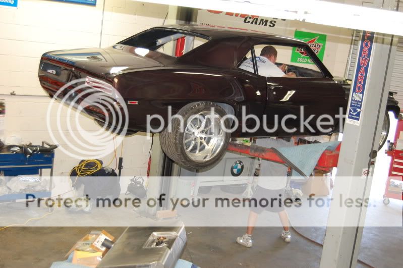

Matt, the look is awesome and I love the new wheels. But, since you got carbon fiber fenders and the wheels are black, you outta get HRE's black carbon fiber center cap. Well, it's not 100% CF, but it's a really nice CF print.

Hate to fool you, but those are just the roller wheels. :lol:
I'm having the Forgelines re-hooped. The car will look almost exactly the same as before, save for a few touches here and there.

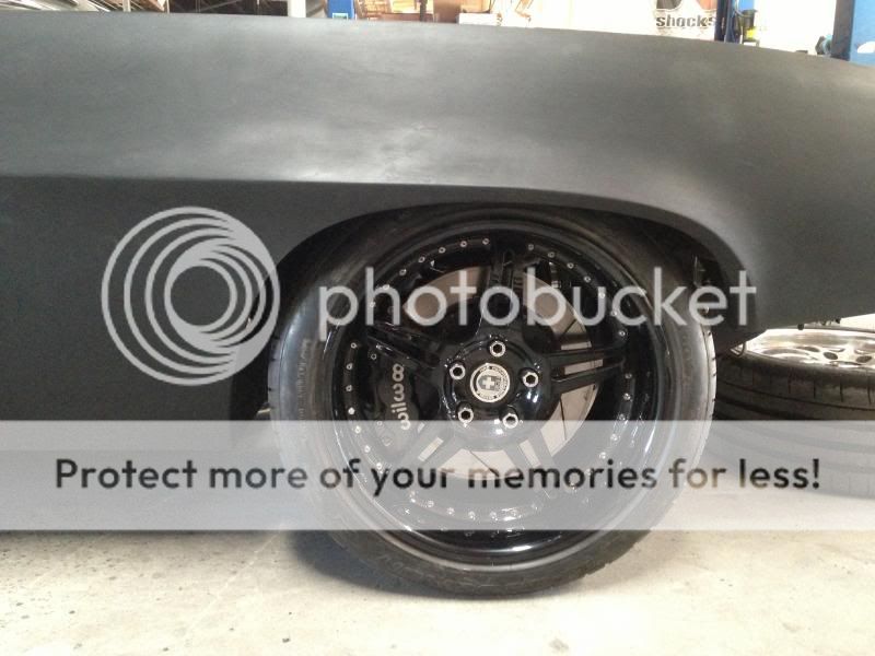

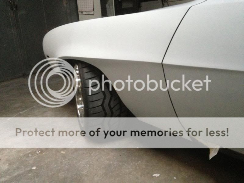

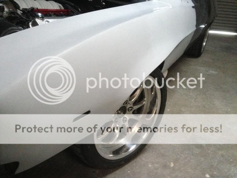

Matt@BOS 08-03-2013 10:49 AM

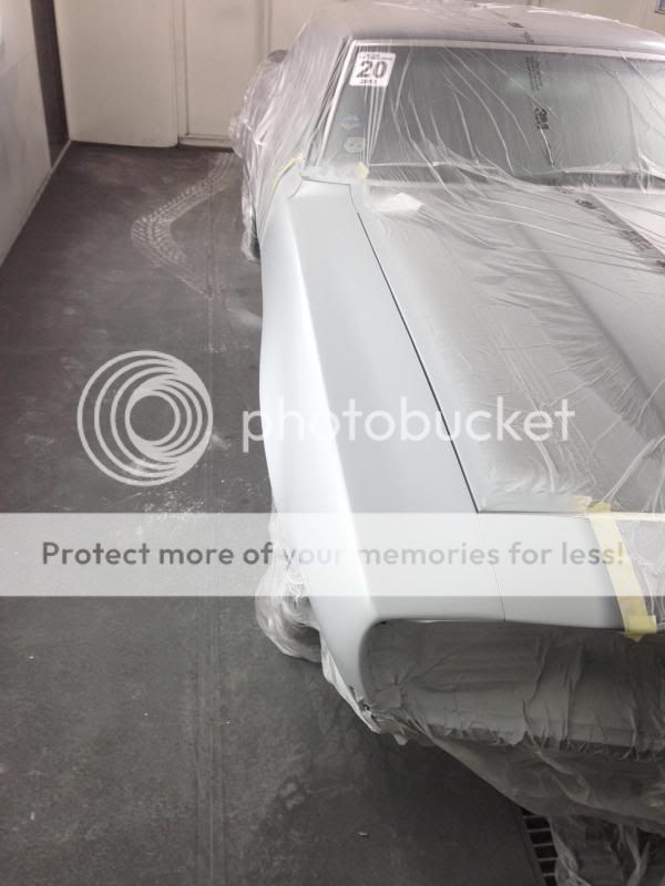

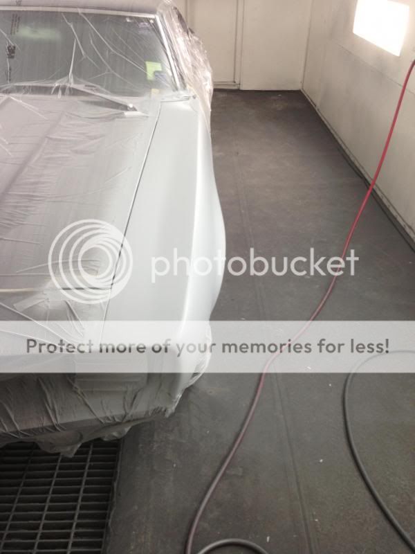

Getting closer. We shot paint on a few of the pieces yesterday. I also got the wheels back. One side rubs a little, the other is fine. I'm going to raise the car a little and throw some additional camber in it. So far things look to be an improvement after a little test drive.
http://i366.photobucket.com/albums/o...pscb81e7af.jpg
http://i366.photobucket.com/albums/o...ps27069a32.jpg
Ron in SoCal 08-03-2013 12:01 PM
:hello: Steamrollers

Jr 08-04-2013 06:19 AM
So... Are we looking at 315's on there right now?
Matt@BOS 08-04-2013 10:55 AM
Yes sir. A 295 or a 305 would fit much better, but don't want to change tire brands at the moment. I may very well drop down in size in the front and try a set of BFG Rivals in the future, but won't know for sure until I put some laps on the new setup and see how well it works within its current constraints.
