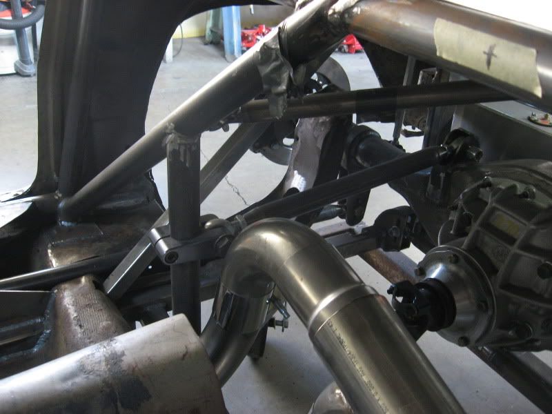

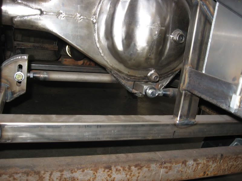

Do you have a source for that slider (on the upper link)? I don't even know the proper name, so I'm having a hard time finding one, but it would great for a project I am working on.
Thanks!
Paul
19,69camaro 12-04-2013 01:35 PM
Paul that looks like an adjustable panhard bar mount. They can be found all over the place.
73CPCAMARO 12-04-2013 04:15 PM
Here you go:
http://www.joesracing.com/index.php?...&product_id=73
Brian

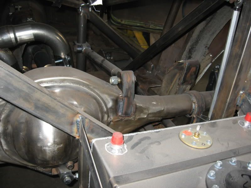

Jr 12-05-2013 10:46 PM
Brian,
The rear suspenion setup is a three link with a horizontal watts link? Is that accurate?
73CPCAMARO 12-06-2013 08:11 AM
Originally Posted by Jr (Post 521049)
Brian,
Here are some photos:
http://i80.photobucket.com/albums/j1...b/IMG_0208.jpg
http://i80.photobucket.com/albums/j1...b/IMG_0209.jpg
http://i80.photobucket.com/albums/j1...b/IMG_0210.jpg
Brian

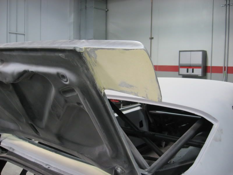

My deck lid is a VFN fiberglass part that was reinforced. I installed nutserts on the back side. The spoiler is 10 inches tall and I have been up to 152 mph with no issues.

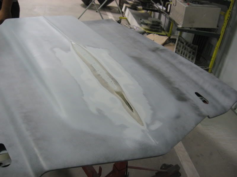

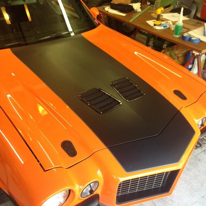

I will be taking the Camaro to the first Optima Ultimate Street Car event at Thunderhill on February 28th. I am making a few changes to the car to get ready for the event.
The light weight hood I have been running does not have vents. At about 125 mph the hood starts to shake from under hood pressure. At 130 is gets worse. At 140 - 155 is it out of control. I just installed some ACP carbon fiber vents to help remove some of the air pressure that builds up. I may need to go bigger, but I will try these to start. Thunderhill top speed on the front straight is in the low 140's for me.

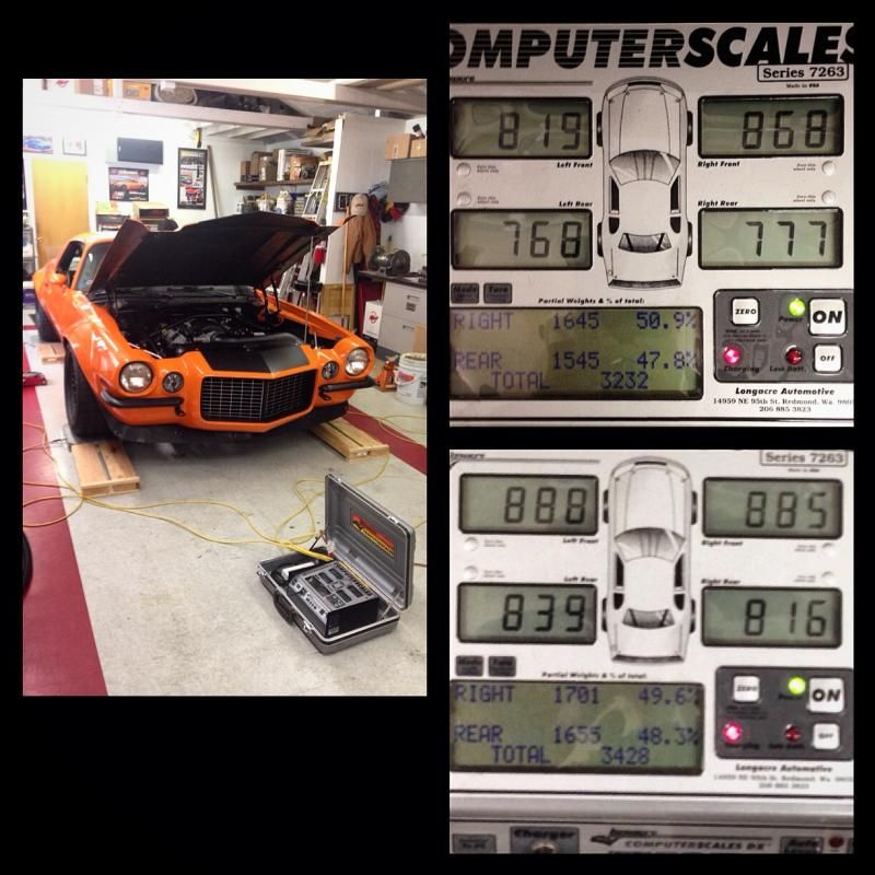

I also corner weighted the car again. I changed the transmission bell house from a stock Corvette aluminum unit to a steel scatter shield. Safety added over 40 lbs to the car. The aluminum bell housing I had on developed a crack.

73CPCAMARO 01-13-2015 01:12 PM
Originally Posted by glassman (Post 589410)
Funny, i was looking for a good pic of your hood latches last nite. I was watching the Portland OUSCI and saw what you were talking about with your hood. Is it Anvil? I'm expecting the same problems, but only 129ish at the front stretch at t-hill and haven't installed the anvil hood yet....
The hood is a VFN fiberglass hood. Our Camaro's need to vent the air out somewhere. I wanted to vent it more on the sides, but the shape of the hood and vents available did not allow me to.

Ron Sutton 01-15-2015 08:40 AM

Hi Brian,
50.4% left side weight & 49.6% right side weight is pretty dang close to 50/50. Sweet !
We achieve that 50/50 L/R balance in scratch built race cars because we can put stuff where ever. But that's often hard to do in production based cars. Good job. :thumbsup:

73CPCAMARO 01-15-2015 12:12 PM
Originally Posted by Ron Sutton (Post 589835)
Hi Brian,
I'll see you at T-hill.
Thanks Ron. We could have got it closer, but we figured the fluctuation in fuel level at this point put us dead on. That is with about 3/4 tank. We run full as much as possible on the autocross. Full gets it even closer.
