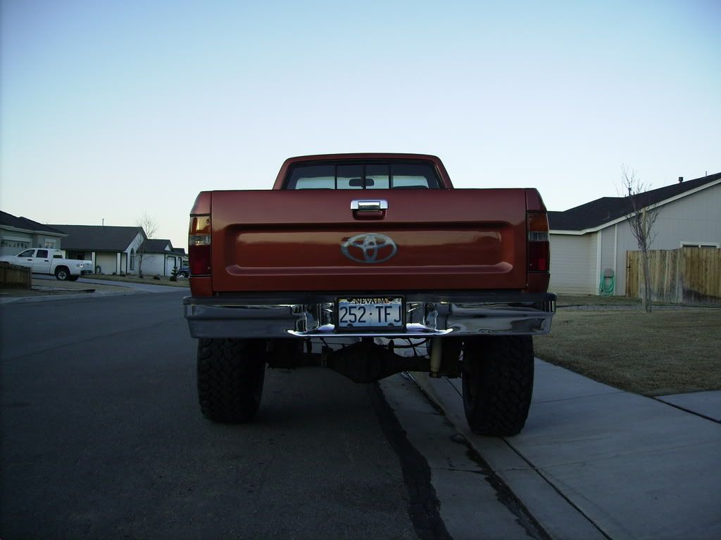

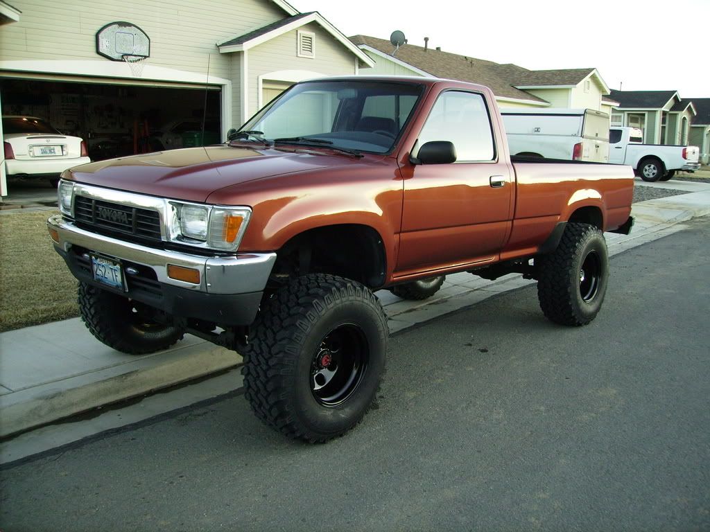

Looks great!! How was it to spray the clear??:thumbsup:
Originally Posted by 70TWO NOVA (Post 145835)
Here are some pics of my first real BC/CC paint job on a friends truck. It is kinda intimidating, but youll never know until you try it for yourself. Granted I did have access to a good paint booth i think my first one turned out pretty good.

Thanks! To be honest i thought spraying the clear was very easy. The entire BC/CC system is much easier to work with, it does take longer than traditional single stage paint jobs since you do have to deal with the flash times between color and clear, plus cleaning the guns multiple times as well, but once its all layed out I liked it much better than single stage. Plus I was able to learn to wet sand which was cool. That turned out good for my fist time I think too.
