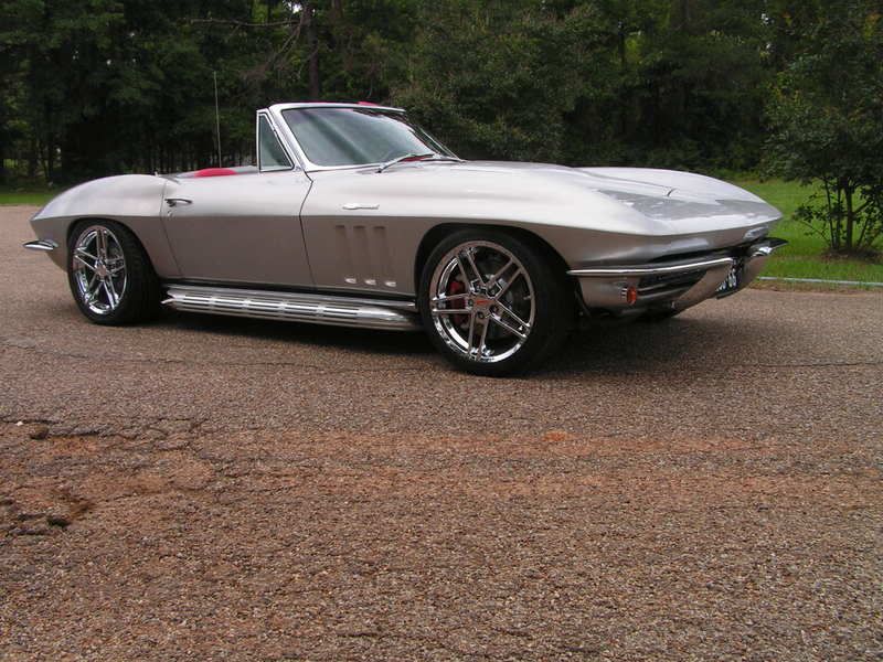

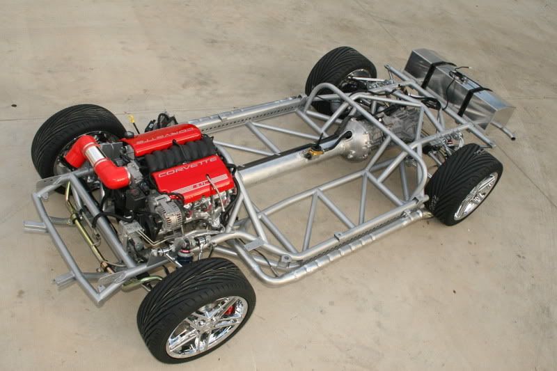

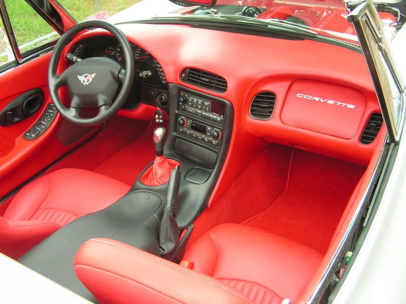

Great project. I understand the difficulty of this project. We did a 66 Convertible with a tube chassis and used everything we could from a 04 Z06. The only things we didn't use were the HUD and airbags.
http://img.photobucket.com/albums/v3...d/PICT2438.jpg
http://img.photobucket.com/albums/v3...d/IMG_1706.jpg
http://img.photobucket.com/albums/v3...d/PICT2437.jpg
:cheers:
vipercuda 12-07-2008 05:57 PM
Cool car... It looks great. How big were the rear tires? Does the soft top still work?
Mike

TonyG 12-09-2008 12:21 PM
Mike
Yes, the softtop is made from the newer cloth. the rear tires are 305/35 I believe. You can see that the rear quarters were widened. rear end was narrowed and the torque tube shortened.
I am not a fan of the wheels, but that is what the customer wanted. lol
Also the ride height is leveled up now. These pics were taken while we were still working out bugs..
It should appear in Corvette Fever sometime soon, if it hasn't already.
