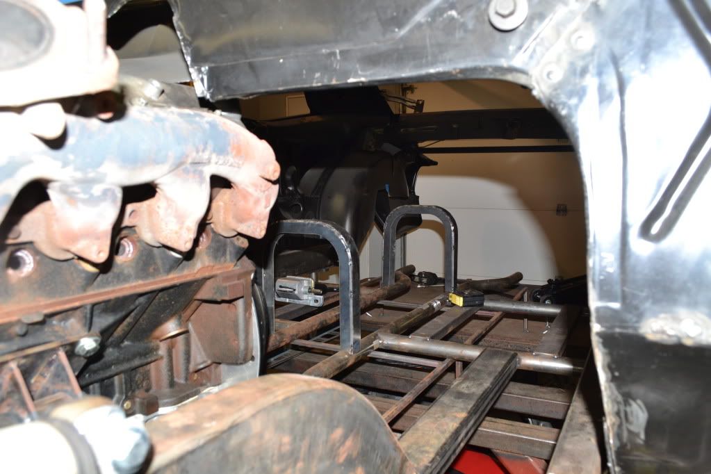

Built the tunnel tubes last week

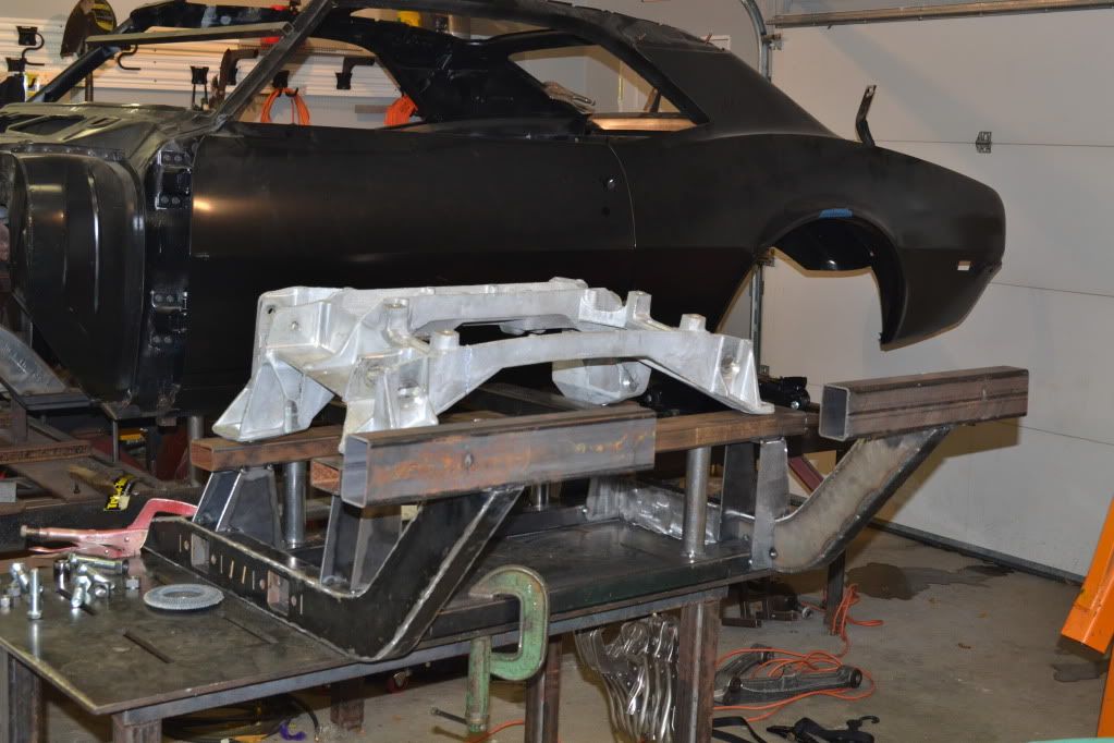

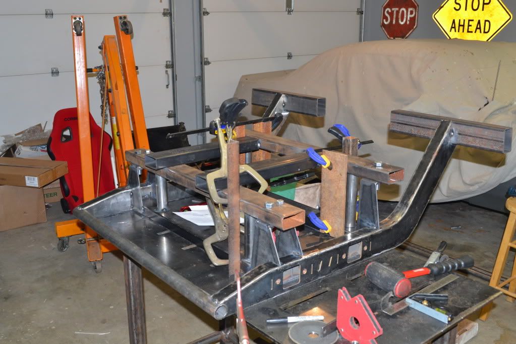

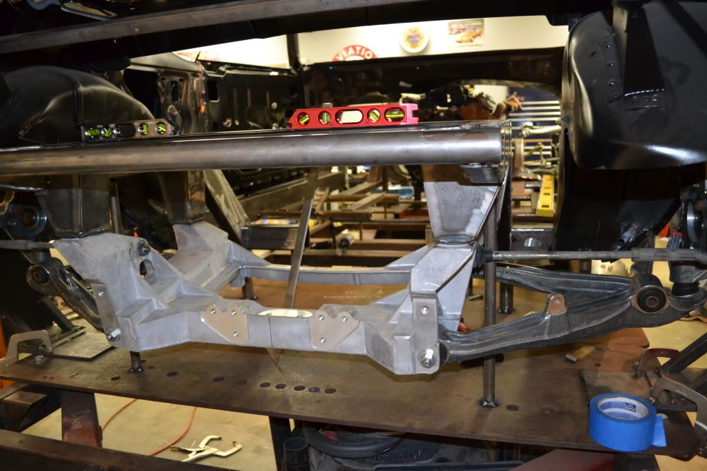

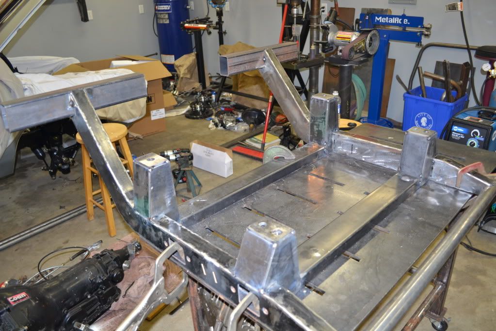

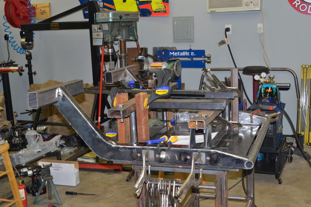

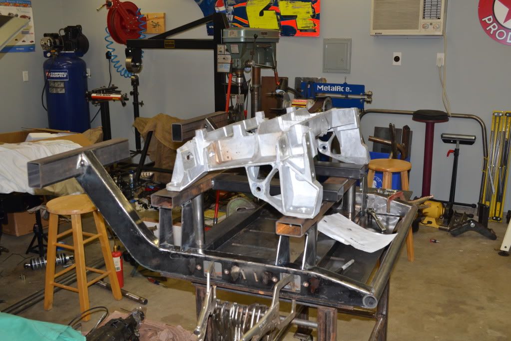

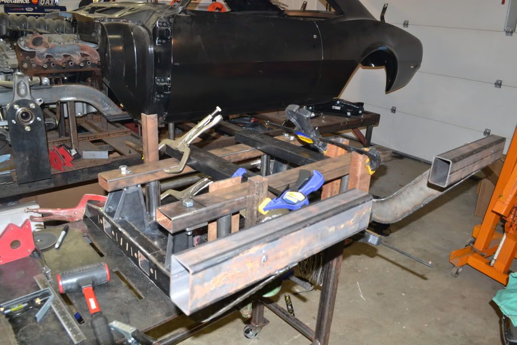

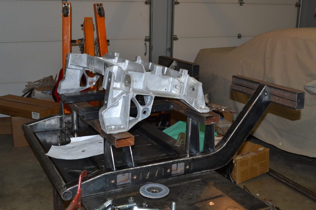

Started to tack up the rear end of the car. Had to make a fixture off of the stock C5 Cradle and put it up on the weld table and transfered the jig to the frame rails.
http://i238.photobucket.com/albums/f...4/DSC_0183.jpg
http://i238.photobucket.com/albums/f...4/DSC_0179.jpg
http://i238.photobucket.com/albums/f...4/DSC_0178.jpg[hr]
http://i238.photobucket.com/albums/f...4/DSC_0177.jpg

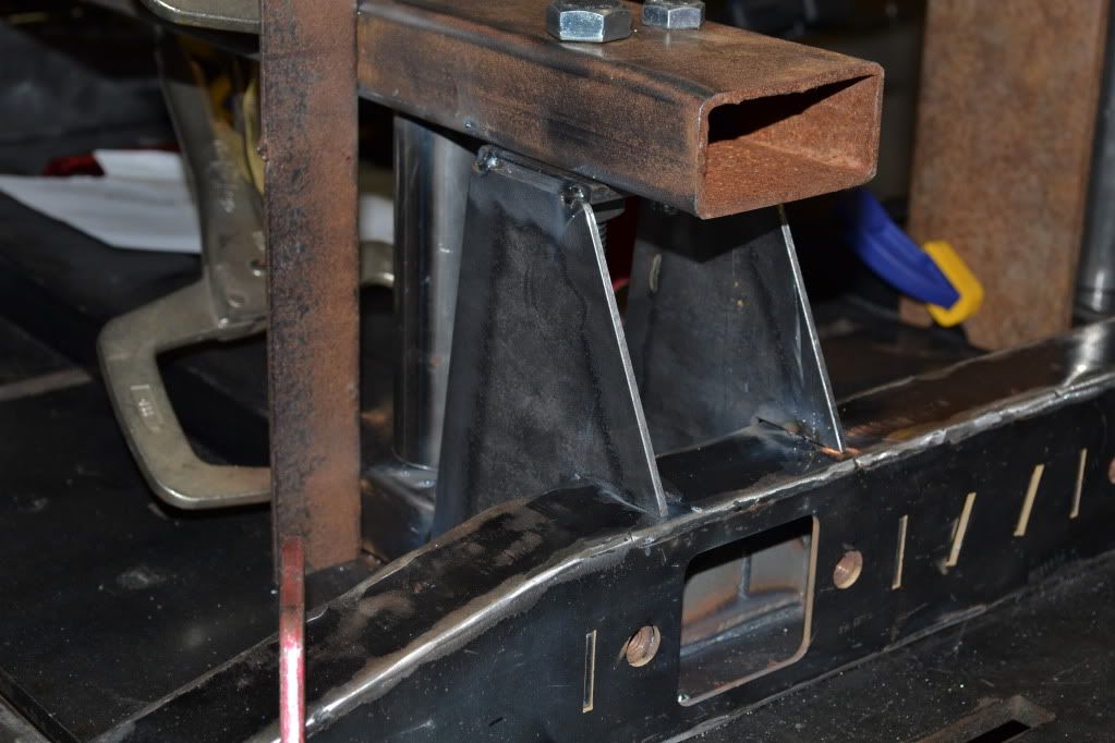

Got all of the mount pads for the cradle tacked up and fit the cradle on the subframe. I need to remove the rectangular tubing and round tube and get the plates cut to box in the pads. Then Ill get it tacked up in the car and get the rear suspension and drivetrain locked in place.

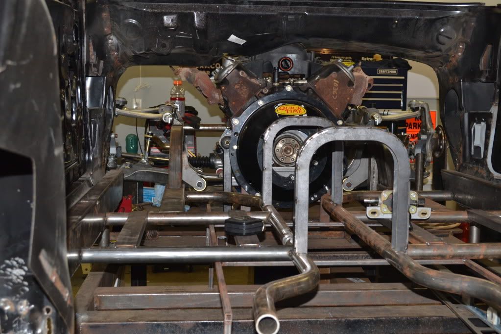

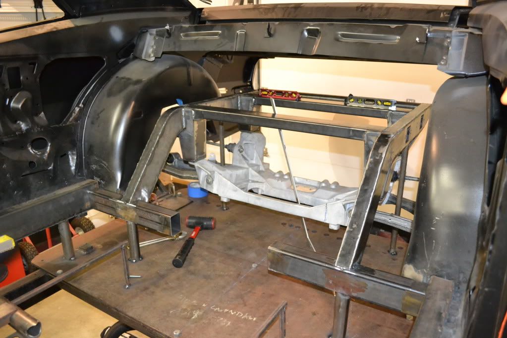

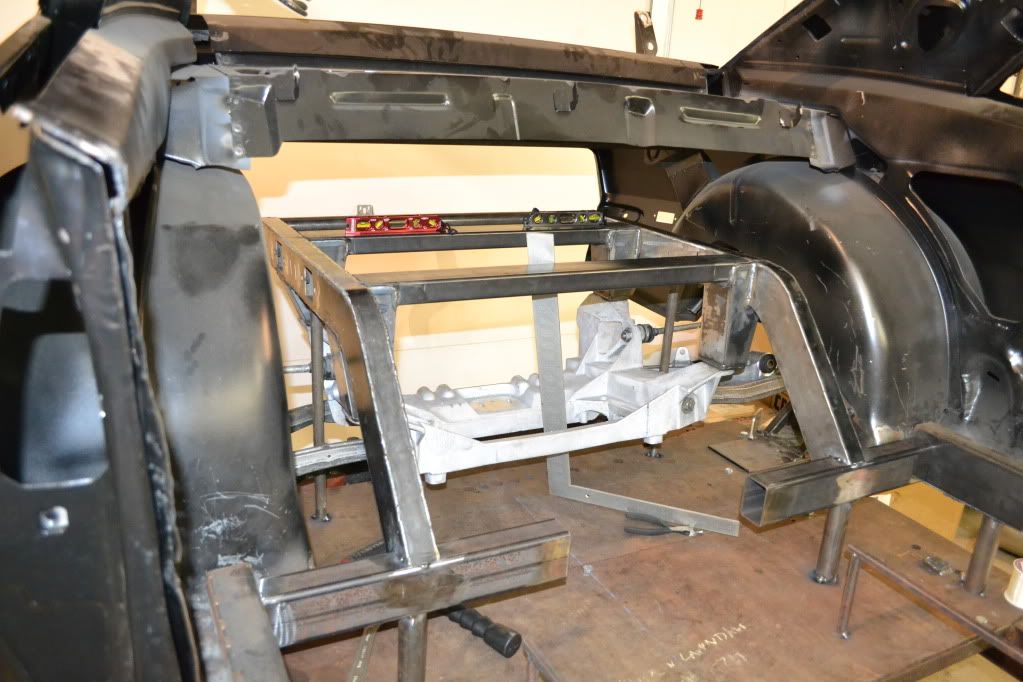

Got the frame tacked together last night. All that is left it get it welded up and put in the car so I can start putting the drivetrain and suspension back in! Enjoy!

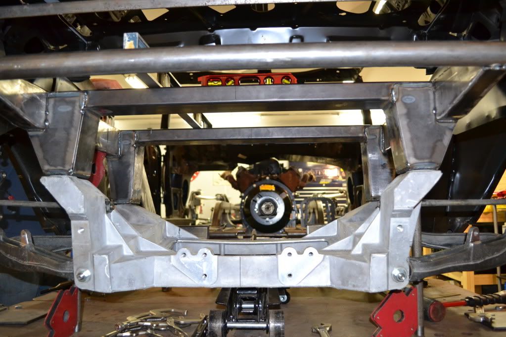

Made even more progess last night. Had a few friends over we got the rear subframe up in the car and centered up. Got tacked before we left and all in all looks awesome and worked out great. Hopefully I can get out in the next day or so and get the driveline back in the car!
