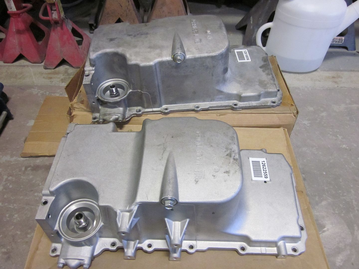

Oil pan on top is Pontiac G8.. dipstick is in oil pan
Oil pan on bottom is Camaro LS3/L99.. Dipstick is in the block

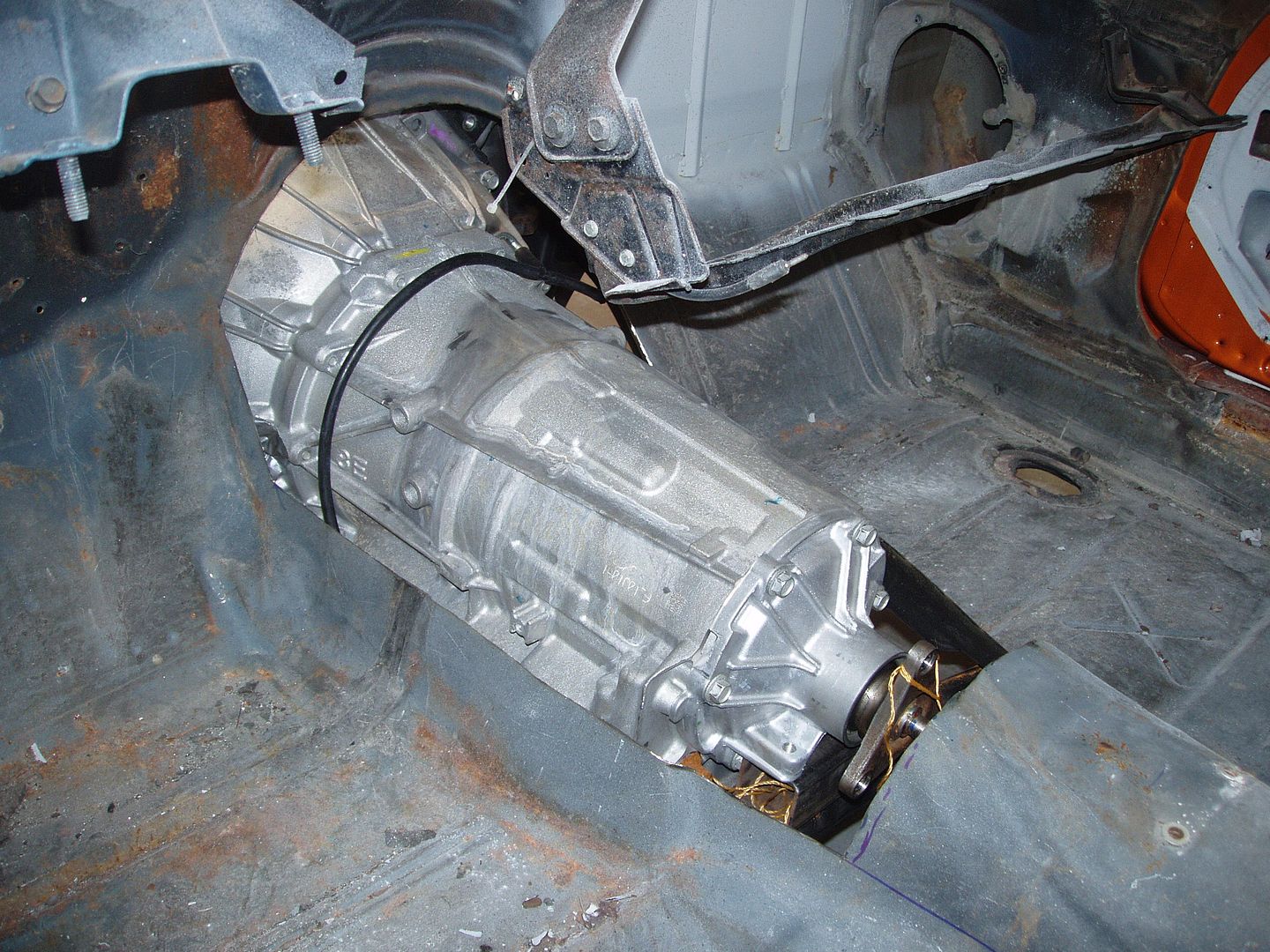

Originally Posted by Gonzo (Post 345110)
Here are some pics of a 71 Camaro we did with 2010 Camaro 6L80 Transmission.. Minor modifiactions required :D
These transmissions are huge! Take into consideration that 2nd gen drivetain sits offset torwards the passenger side about 1/2 an inch..
http://i1015.photobucket.com/albums/...P3080056-1.jpg
Pontiac G8 tansmission pan is shallower.. I am setting that up currently on a first gen..
This is the pic I totally expected. I think 2nd gens may have less tunnel clearance than 1st gens, based on what I have seen online and my own experience installing a T56 in my 77. And every centimeter is moves back the more cutting is needed. The 6L80Es appear to be tall & hang low but not terribly wide.
