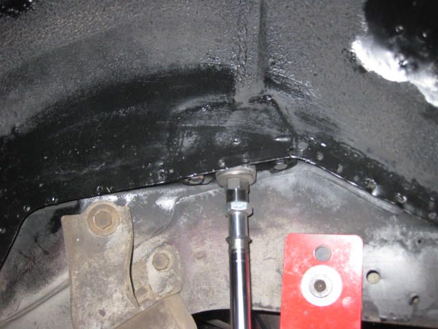

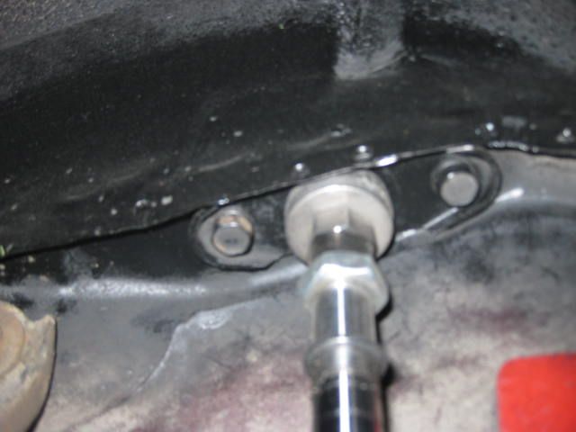

Here are some pics on how the shock is mounted outside of the frame rail. I'm using Global West UPC's and stock lowers. Wheels are 17x9.5 with 5.5" back space. It rubs frame rail loc-to-loc but not enough to be an issue. Front fender lips will also have to be rolled. Depending on how low you go with the front you may have to take a baseball bat and roll a bit more.

minitub?
Thanks for the pics.
How much did you widen the inner tubs? It does not look like a typical mini-tub job.

In order to keep shock mounts outside of frame rails we cut out the existing tub and moved it in 1 9/16" and then filled in the gap.
Hope this helps.
garymac69 05-24-2011 09:00 AM
Thanks, that helps a lot. I had been looking to do something similiar, but was not sure if it was possible. Now you have confirmed my ideas.
