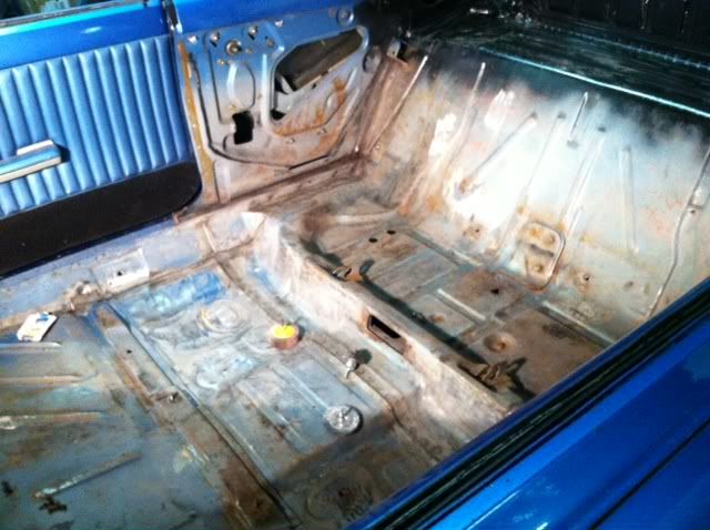

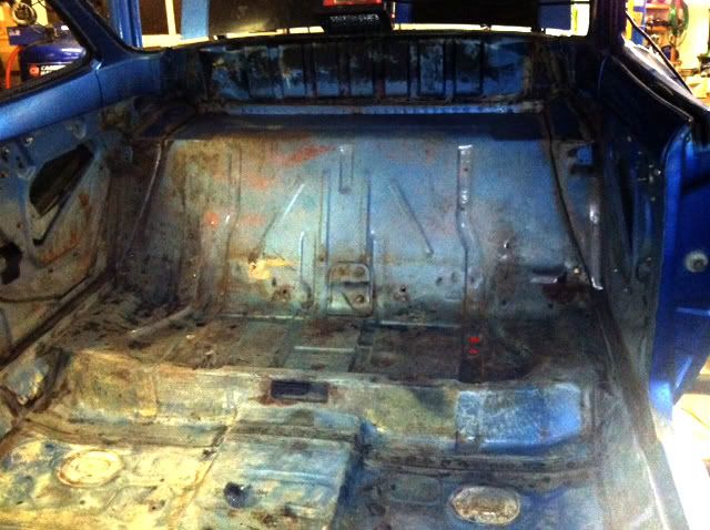

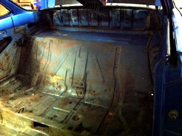

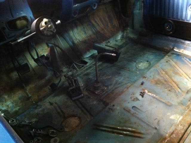

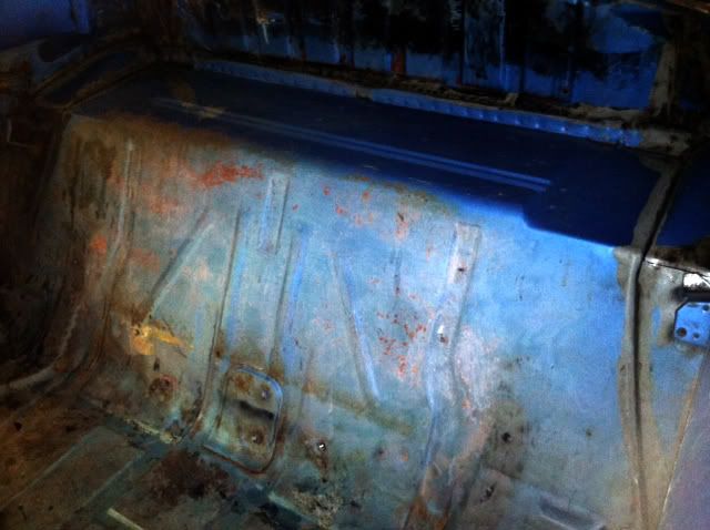

Alright, time for an update. I Unexpectedly had a few hours to work on the car today, couple of buddies came over to help with the floor too. I don't know what sort of adhesive they used in the 60's, but it's stubborn as hell. We spent hours scraping, sanding, and grinding, and got the rear half of the interior cleaned up and ready for paint:
http://i15.photobucket.com/albums/a3.../photo10-1.jpg
http://i15.photobucket.com/albums/a3...2/photo8-1.jpg
http://i15.photobucket.com/albums/a3...2/photo4-1.jpg

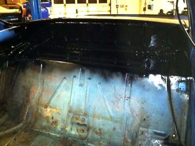

There's only two spots on the rear floors that need attention - one 8"x8" section that I need to cut out and replace, and another small area that just needs some patching. I'm VERY surprised that there's not more rust (knock on wood).

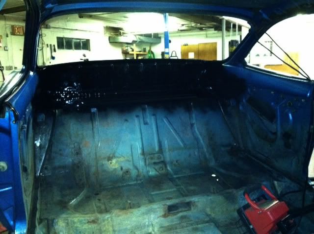

It was killing me to do all of that work and not see what the new paint would look like, so I de-greased a small section in the back and laid down four coats of "Rustoleum Automotive Enamel". If you ever use this stuff, DO IT OUTSIDE. This is not spray paint, this is death in a can. Holy crap. I'll be doing the rest of the painting outside for sure.
http://i15.photobucket.com/albums/a3...2/photo3-1.jpg
http://i15.photobucket.com/albums/a3...2/photo1-1.jpg
That's all for now, next step is to finish off the floors, patch the bad spots, and finish painting the interior. Then it's off to the wheel wells and suspension.

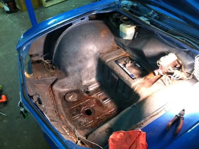

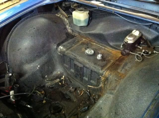

Also started stripping the seam sealer from the trunk. A quart of oil was stored in there and leaked all of the place apparantly, so it'll require some good cleaning:
http://i15.photobucket.com/albums/a3.../photo15-1.jpg
http://i15.photobucket.com/albums/a3.../photo19-1.jpg

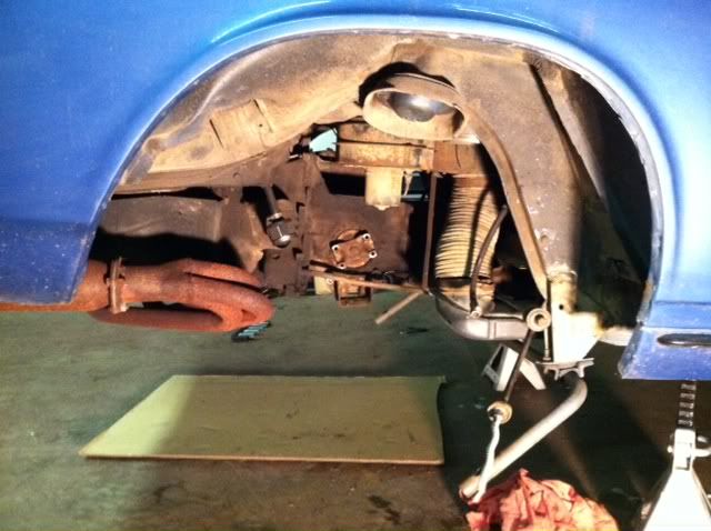

I also took out the headlight buckets to deal with some rust issues around the edges:
http://i15.photobucket.com/albums/a3...2/photo3-4.jpg

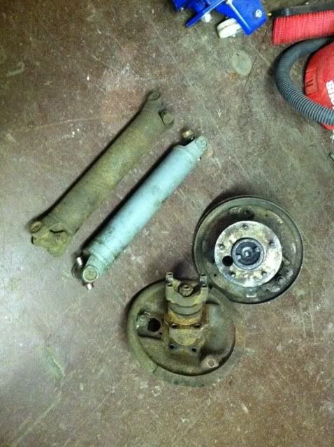

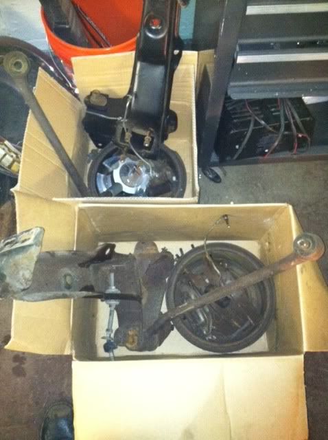

And finally, I took apart the rear suspension for rebuild:
http://i15.photobucket.com/albums/a3...h2/photo22.jpg
I'm going to prep and undercoat the wheel wells before it all goes back together. I'm sending the hubs and axles out to a guy named Steve Goodman who does full rebuilds on them, and I ordered some poly bushings to replace the original worn-out stuff that came out.
Stuff for Steve:
http://i15.photobucket.com/albums/a3.../photo20-1.jpg
Out with the old:
http://i15.photobucket.com/albums/a3...h2/photo23.jpg

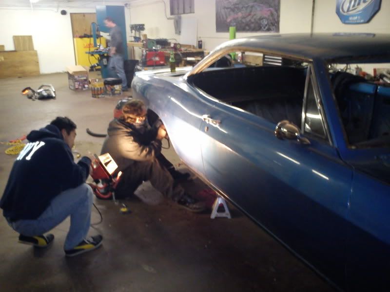

Small progress today. A few buddies were hanging out at the shop tonight so we spent some time on the Vair.

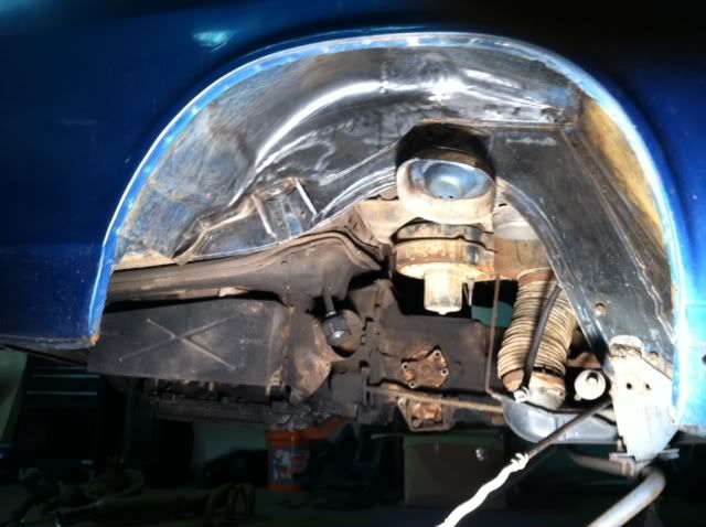

Some of my suspension parts came in today for the rear, so I figured i'd better start sanding down the wheel wells for paint before it goes back together. I used the old standby - wire wheel on a drill:
http://i15.photobucket.com/albums/a3...113_211627.jpg
Might be about time to invest in a real dust mask...
http://i15.photobucket.com/albums/a3...3_211638-1.jpg
I started it off but the guys got tired of watching me work and took over, which I happily agreed to. All this sanding is wearing me out. It turned out pretty damn good.
Before:
After:
http://i15.photobucket.com/albums/a3...h2/photo29.jpg
I'll be painting it with 3M rubberized undercoating. I ran out of cleaner so I need to do a Home Depot run before I can finish and paint it. When it comes time to tear the drivetrain out of the car, I'll do the same for the engine bay and the other side of the frame rails.

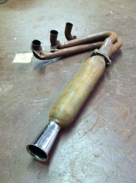

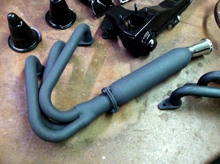

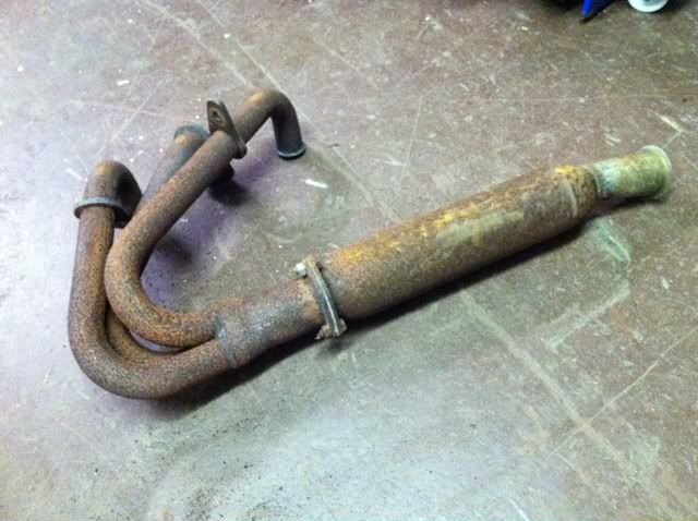

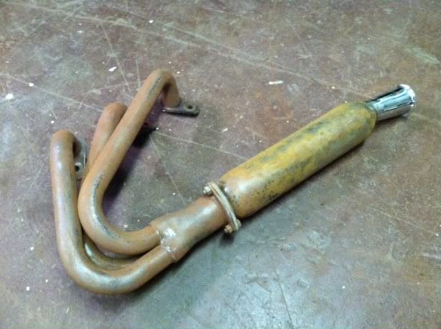

We had to remove the header to get deep inside the wheel well, so I figured I'd see what condition the headers were in. There's fuel AND oil leaking from the motor, so the headers have a thick layer of rust and grease on them. Again, the wire wheel worked wonders. We also used some fine-mesh steel wool to polish the exhaust tips.
Before:
http://i15.photobucket.com/albums/a3...h2/photo28.jpg
After:
http://i15.photobucket.com/albums/a3...h2/photo30.jpg
http://i15.photobucket.com/albums/a3...h2/photo31.jpg

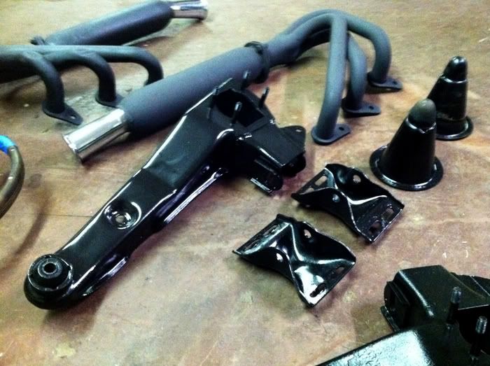

I also started sanding and painting some of the parts that I took out of the car, in the hopes that I can start putting it back together in a couple of weeks:
http://i15.photobucket.com/albums/a3...2/IMG_0307.jpg
I also painted the exhaust with high-temp paint (see previous post for "before" shots):
http://i15.photobucket.com/albums/a3...2/IMG_0304.jpg

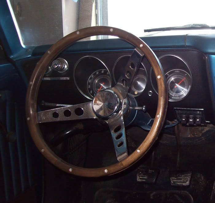

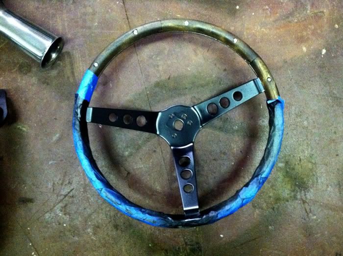

And lastly, I sanded and re-stained the wood steering wheel, and painted the center a satin black instead of the original chrome. Looks good so far, some finishing work needs to be done though.
Before:
http://i15.photobucket.com/albums/a3...100_2241-1.jpg
After (almost done):
http://i15.photobucket.com/albums/a3...2/IMG_0306.jpg

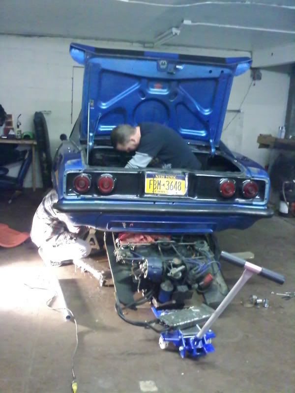

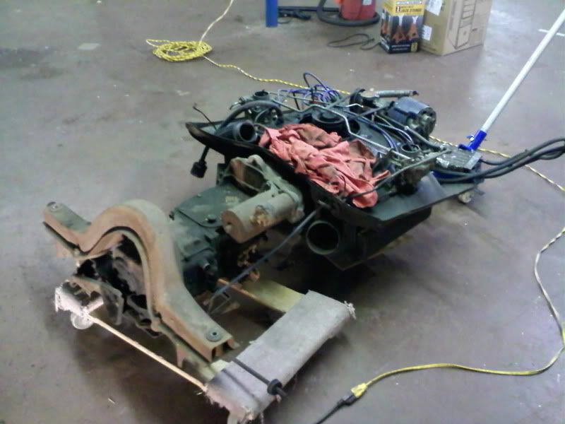

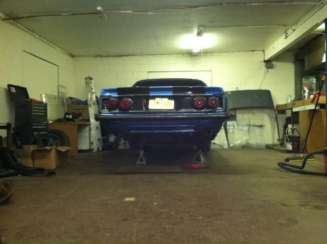

Not many photos today, but I got the drivetrain removed last night. Again, a couple of buddies came by to help out. I'll try to get some better photos next time I'm at the shop, probably later today.
On the way out...you can also see one of the freshly painted wheel wells:
http://i15.photobucket.com/albums/a3...0120022313.jpg
One of the guys helping to position the motor/trans onto a dolly for easy removal:
http://i15.photobucket.com/albums/a3...0120022314.jpg
Almost out!
http://i15.photobucket.com/albums/a3...120022314a.jpg
Aaaand, there it sits:
http://i15.photobucket.com/albums/a3...0120022316.jpg
Next step is to finish sanding and undercoating the rear of the car now that the motor is out, as well as painting the engine bay. After that, I'll do a basic gasket rebuild of the motor and transmission, and put it back in with the new rear suspension.
