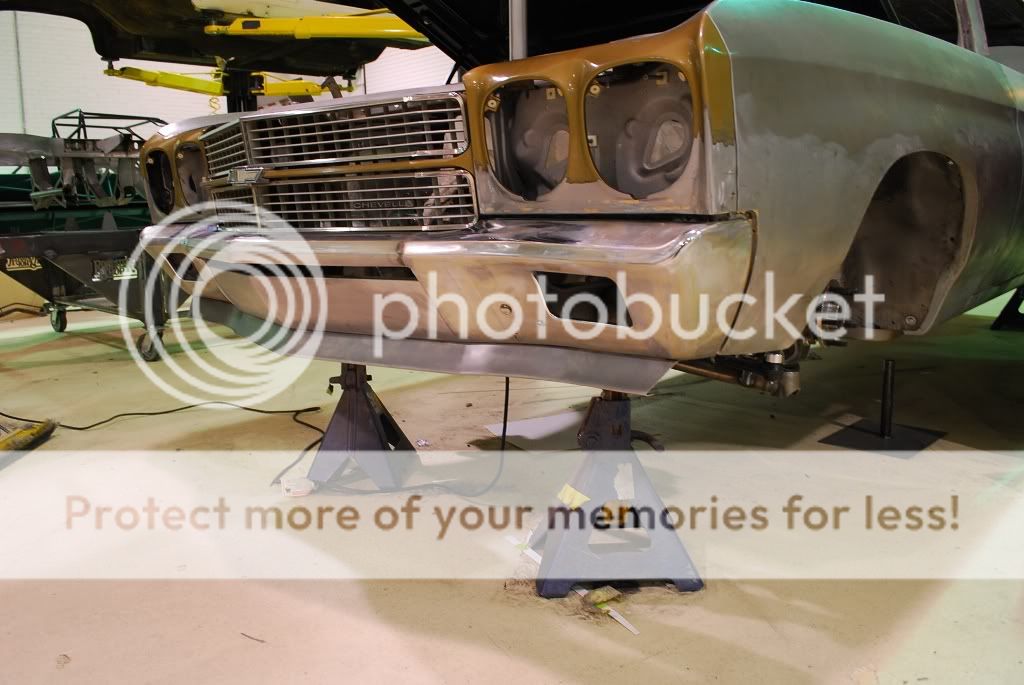

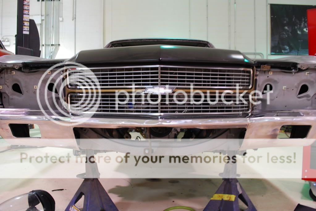

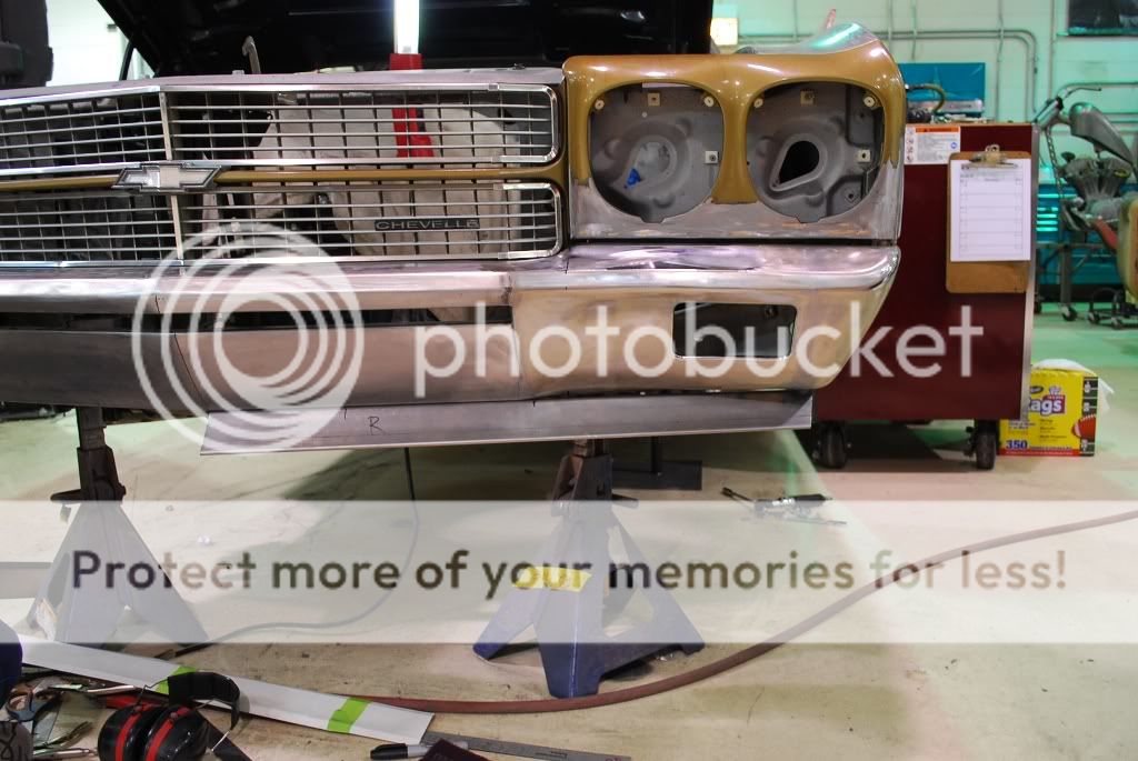

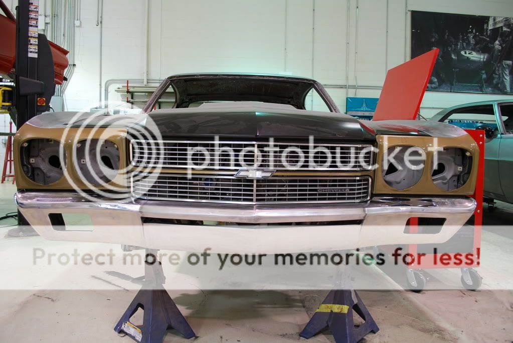

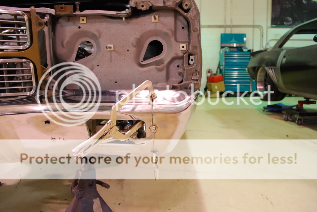

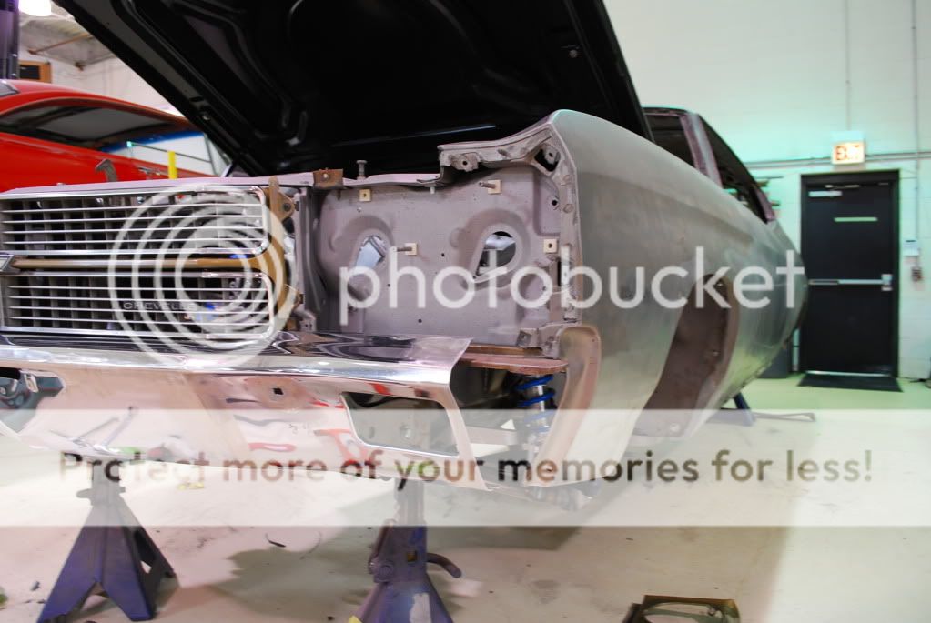

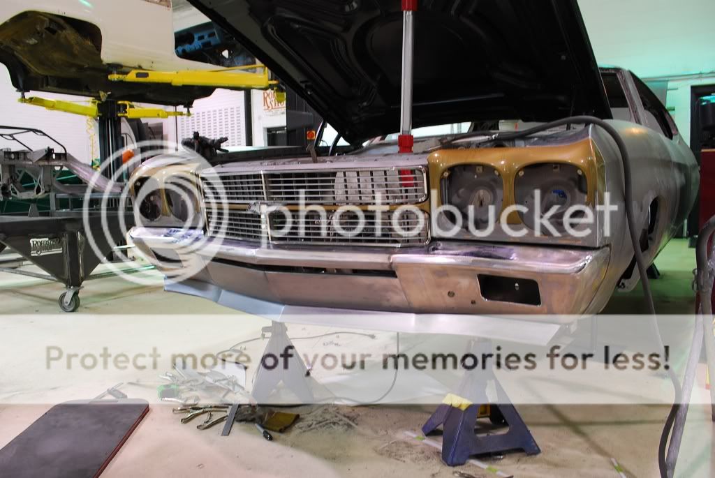

Once all of the sheet metal was fitted and components in place, it was time to start on the bumpers.
The sides of the front bumper were cut off and brought in to tuck them in tighter to the body.
http://i563.photobucket.com/albums/s...ture219641.jpg
http://i563.photobucket.com/albums/s...ture219648.jpg
http://i563.photobucket.com/albums/s...ture219724.jpg
We then cut the center portion of the bumper out to eliminate the license plate recess and create a new style line.
http://i563.photobucket.com/albums/s...ture219734.jpg
http://i563.photobucket.com/albums/s...e/DSC_0023.jpg
http://i563.photobucket.com/albums/s...e/DSC_0022.jpg
http://i563.photobucket.com/albums/s...e/DSC_0025.jpg

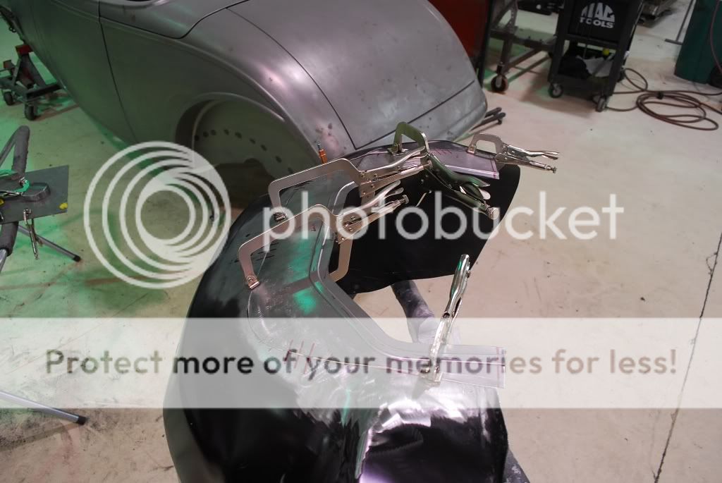

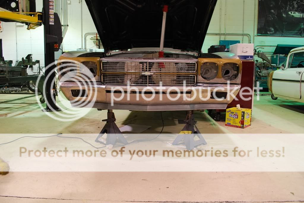

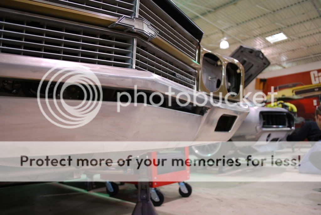

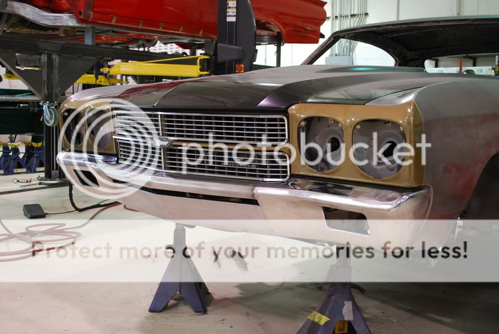

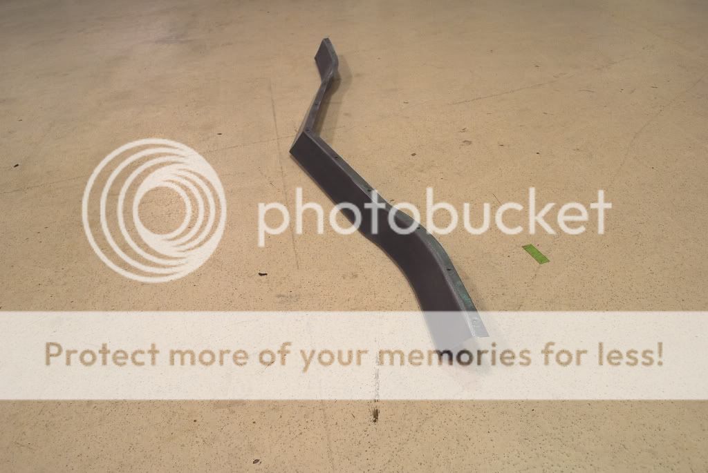

Next, we fabbed up a sheet metal lower spoiler that followed the shape of the bumper.
http://i563.photobucket.com/albums/s...ture220402.jpg
http://i563.photobucket.com/albums/s...ture220466.jpg
http://i563.photobucket.com/albums/s...ture220472.jpg
http://i563.photobucket.com/albums/s...ture220494.jpg
http://i563.photobucket.com/albums/s...ture220492.jpg

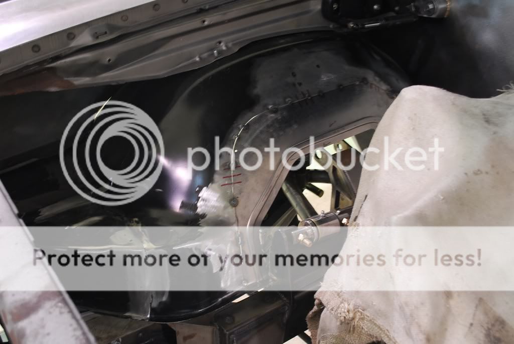

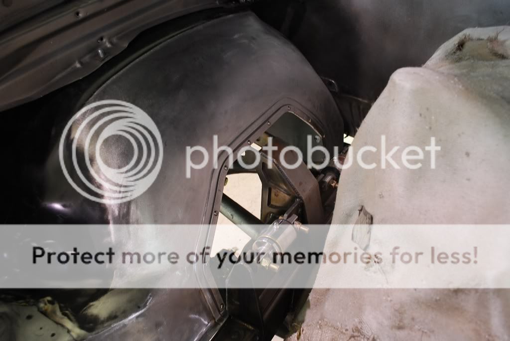

Cleaned up the inner fenders and created a beaded opening around the control arms.
http://i563.photobucket.com/albums/s...ture220394.jpg
http://i563.photobucket.com/albums/s...ture220407.jpg
http://i563.photobucket.com/albums/s...ture220481.jpg
coolwelder62 12-21-2011 06:24 PM
Very nice.The iner fender work is outstanding.Is it OK if I use that idea.:thumbsup:
Kendall Burleson 12-21-2011 06:27 PM
another job well done that work is well done.:hail: :hail: :hail:
214Chevy 12-21-2011 07:37 PM
Roadster Shop quality is second to none!! Definately a cut above the rest.:beavis::beavis:
crazycarguy22 12-21-2011 10:12 PM
I really like that bumper cut out and the chin spoiler. Looks so aggressive.
