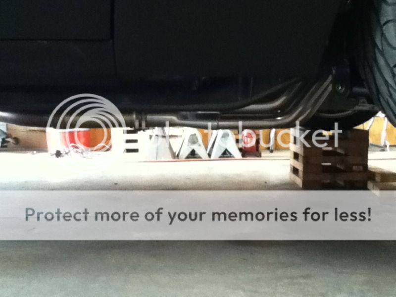

tucks69 05-24-2012 05:21 PM
http://i468.photobucket.com/albums/r...9/d9784247.jpg
http://i468.photobucket.com/albums/r...9/3494ea20.jpg
Musclerodz 05-24-2012 05:38 PM
Is that due to the 3 bolt collector under the floor? That is low.
tucks69 05-24-2012 05:53 PM
It's a 4 bolt collector. There is maybe 2.5 to 3 inches from the top of the collector flange to the floorpan. I do have the half height sub bushings but .5 of an inch won t help that much.I would like to see a Camaro with the stainless works before I order them, I know the DSE headers will work but that is an expesive set of headers. I always tell everybody else not to do things twice. Only good thing is this is one of two things I would change about my build, the other would be higher end shocks! The car ran great at RTOS with the ls2 to only have 10 miles on it! But I guess I have spent the cash on the rest of the DSE suspension I might as well go all the way! You only live once right!lol

The dynatechs will fit the DSE sub with a LS and clear the steering shaft if you use the mounts that set the engine back! BUT they have very little ground clearance with car at a low ride height. I am looking into Stainless Works or DSE headers myself!
I've not seen the Stainless Works LS headers with the DSE sub. Has anyone used this combination?

I have pics of the DSE headers in the DSE sub and can click off a few pics for you if that would help--I can tell you they fit like they should and only slightly hang below the subframe at the collector flange. Ground clearance was a huge item for me---I was thinking shorty headers, but didn't want to give up the HP/TQ. I got mine for 2k---that's quite a grip for a set of headers, i'll be the first to agree.
