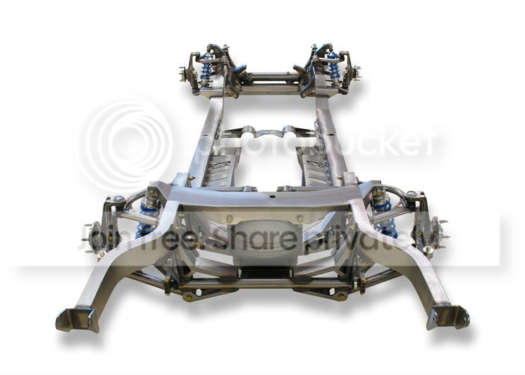

We offer the IRS setup in two flavours: Full chassis or separately
Our setup is based around specific geometry setup for pro-touring sized vehicles and their appropriate track widths so you don't have to run rear wheels with weird offsets or any external flares, bulges etc. It has been engineered from scratch around the weights, sizes and intended use of our pro-touring/performance vehicles and as such it is not based on an antiquated Jag setup or modified street rod platform. The Fast Track IRS also uses conventionally mounted outboard brakes for easy rotor and pad changes and countless brake package options. It is also built to accommodate high horsepower (+600) with drive axle options to withstand hp well into the 4 digit range.:unibrow:
Here is the IRS as a full chassis for a 1st Gen Camaro:
http://i563.photobucket.com/albums/s...f/Untitled.jpg
And a vid on the setup:

Not to take anything away from Heidt's, but that IRS is in no way even comparable to the one RS makes. And they are similar in price. Just my opinion. I'm sure with the forged axles, big 934 CV joint's and thick control arms that the RS IRS trumps that old inboard brake style IRS that Heidt's makes. Furthermore, the Heidt's IRS is suited more for hot rod style cars. The RS IRS is custom CNC'd and the railing on it is just more slick to me.
