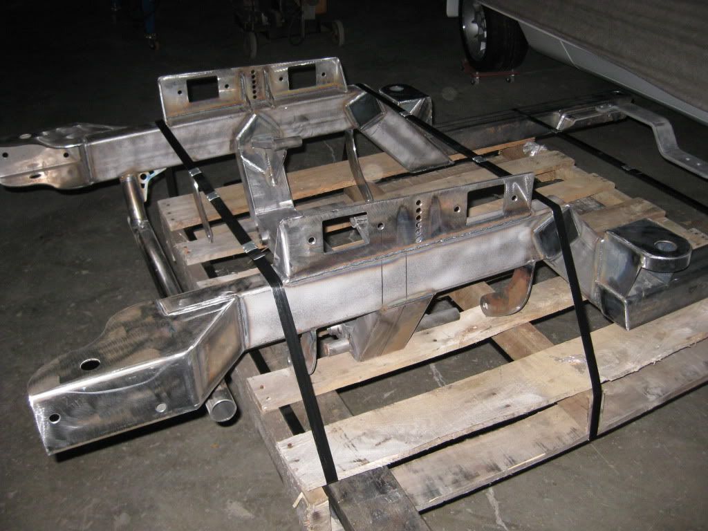

Gandalf 12-03-2012 02:33 PM
I like the design - there's some nice features built-in, especially the upper shock mount (that's Ron on the phone now lol).
A couple quick questions.....I notice you changed the style of engine mount between the initial and current pics. Any reason?
Secondly - I note in the first picture (coated frame) a heavy-duty looking tab on top of the frame in front of the upper control arm mount - what are they for?
Thanks,
G
Thanks,
G
I changed the motor mount design to allow more room for oil cooler lines next to the block.The thick tabs ahead of the UCA mounts are for the bolt on Bay mounts I made for the 72 camaro projects.I changed the upper shock mount alittle to take some fab time out of the frames.I want to keep improving my design all the time.I just want to put out the best product I can.Thank you to everybody who have bought and who have Looked.:thumbsup: :thumbsup:
Gandalf 12-04-2012 12:26 PM
Originally Posted by coolwelder62 (Post 449744)
I changed the motor mount design to allow more room for oil cooler lines next to the block.The thick tabs ahead of the UCA mounts are for the bolt on Bay mounts I made for the 72 camaro projects.I hanged the upper shock mount alittle to take some fab time out of the frames.I want to keep improving my design all the time.I just want to put out the best product I can.Thank you to everybody who have bought and who have Looked.:thumbsup: :thumbsup:
Thanks for the info. I like your change to the engine mounts for the same reasons. Nice design.
