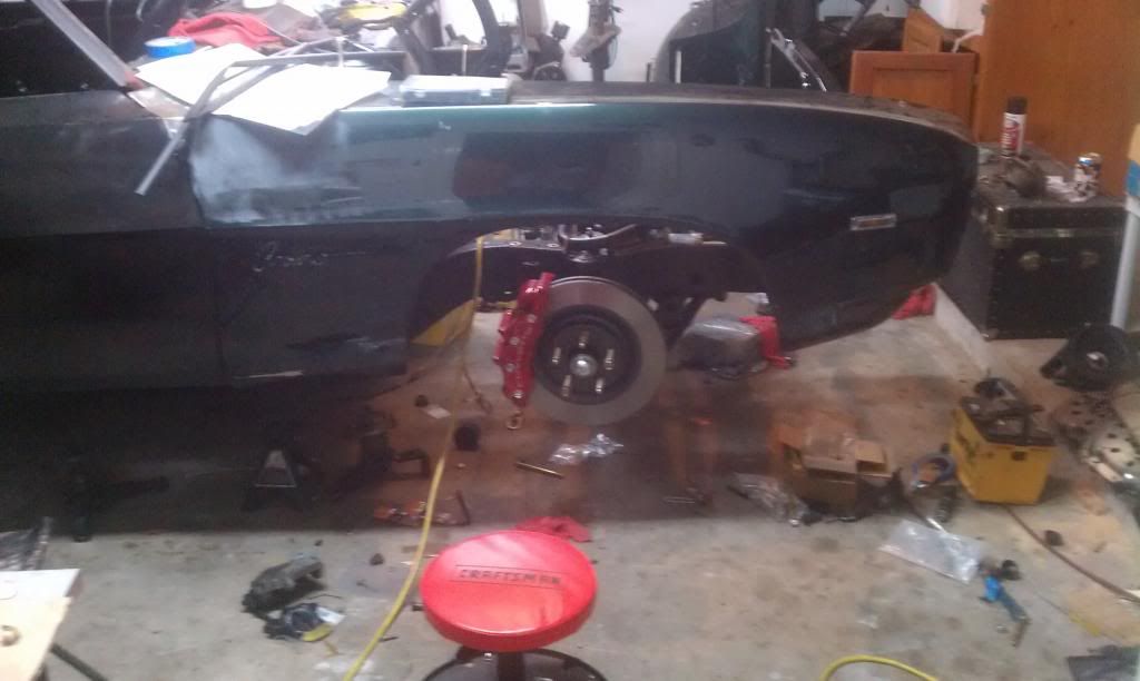

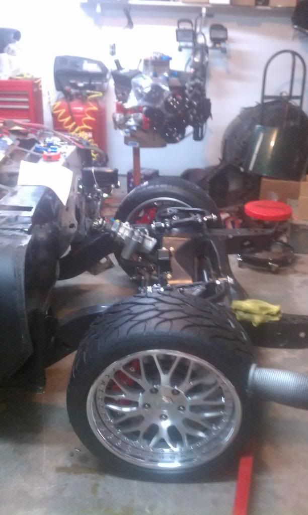

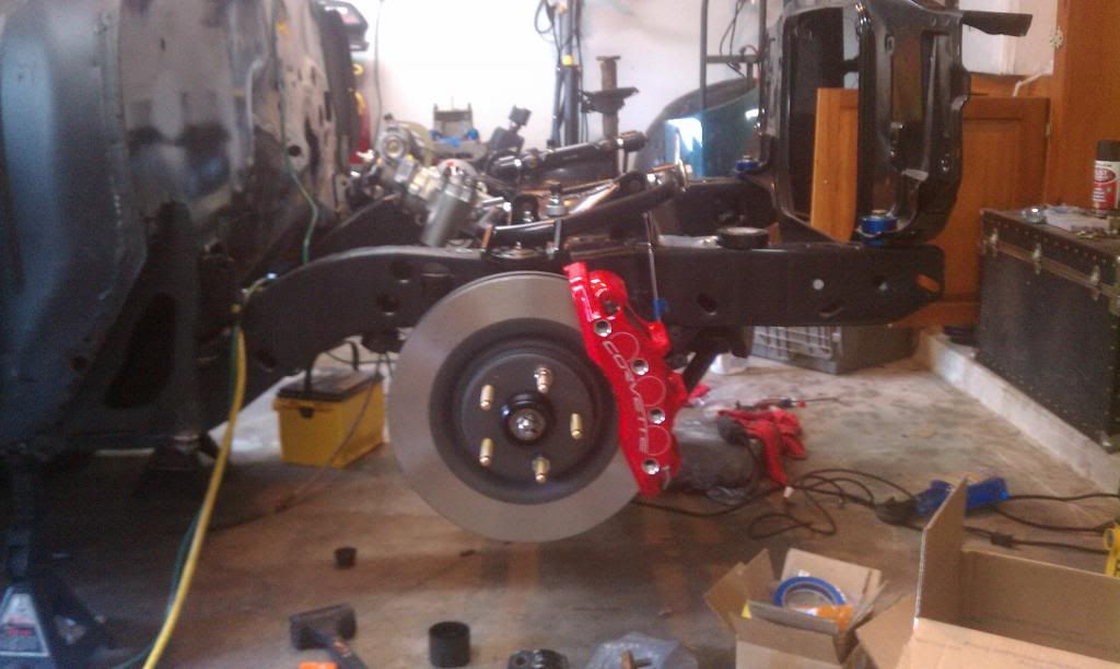

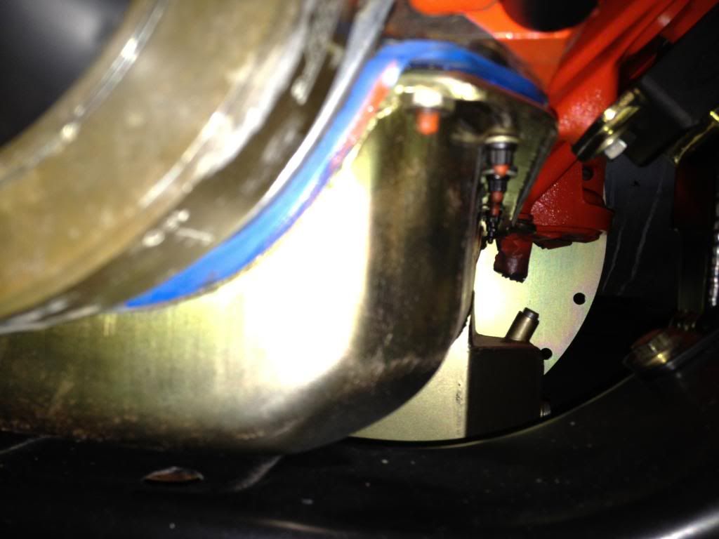

Brakes - Front brakes are from Tobin at Kore3. Can’t say enough good things about this guy. He was available to answer my questions and was more than willing to help me out every way he could.
Nothing really to report. Everything bolted up as expected. The only problem I have is when I got the tires mounted they put a valve stem on the inner hoop which hits the brakes when the wheel rotates.

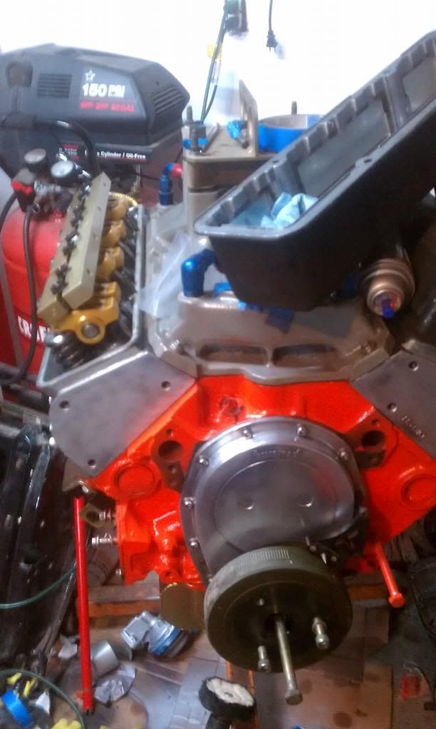

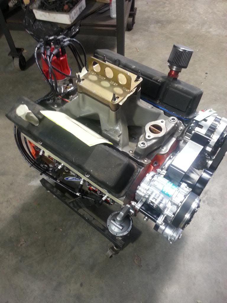

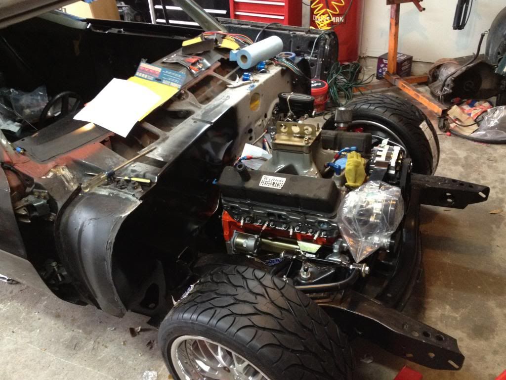

Engine/Trans

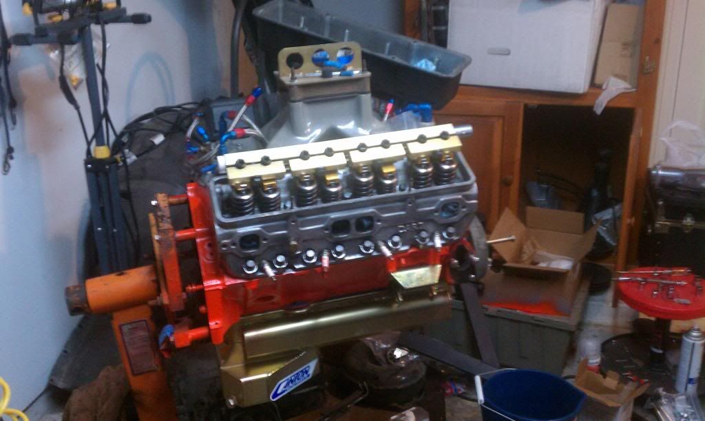

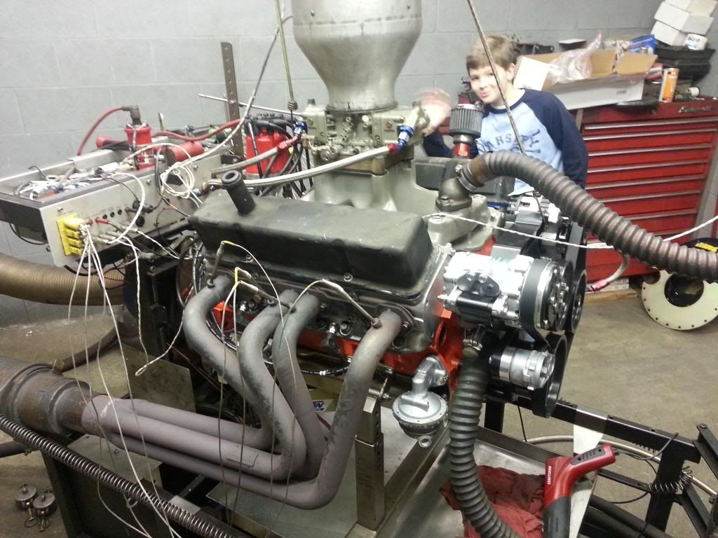

I really wanted an LSX motor but couldn’t justify it since I had already purchased this 350. In my defense, I bought it in 2005 and had no idea the car was going to take another 7 years to make it home. Luckily it still runs well after sitting in storage. I guess 490HP is nothing to sneeze at… but then again its not a 600HP fuel injected motor either.

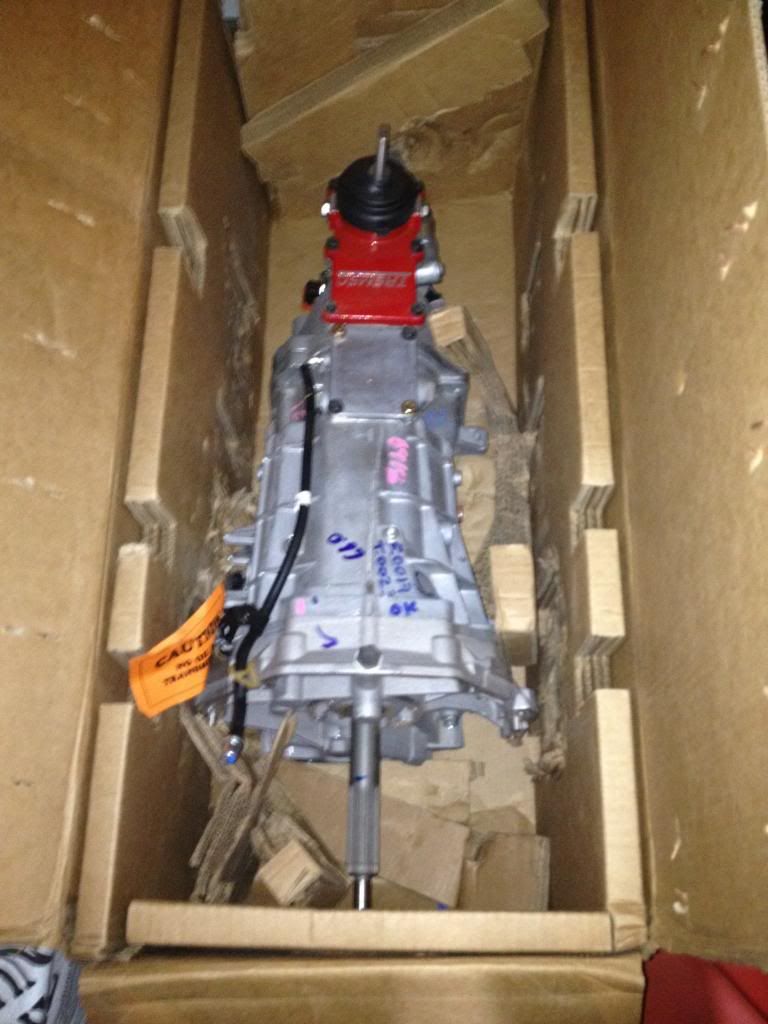

I bought a Magnum trans from American Powertrain. These guys were ok but I’ll probably give hurst a shot on the next go around. Not really a fan of the slave cylinder setup and the idea of pulling the trans to make adjustments after break in (per the instructions). Overall they had decent service, only slight beef I have is that I got the feeling at one point they were trying to scam me on the shifter but they made things right quickly after I called and did the WTF thing.

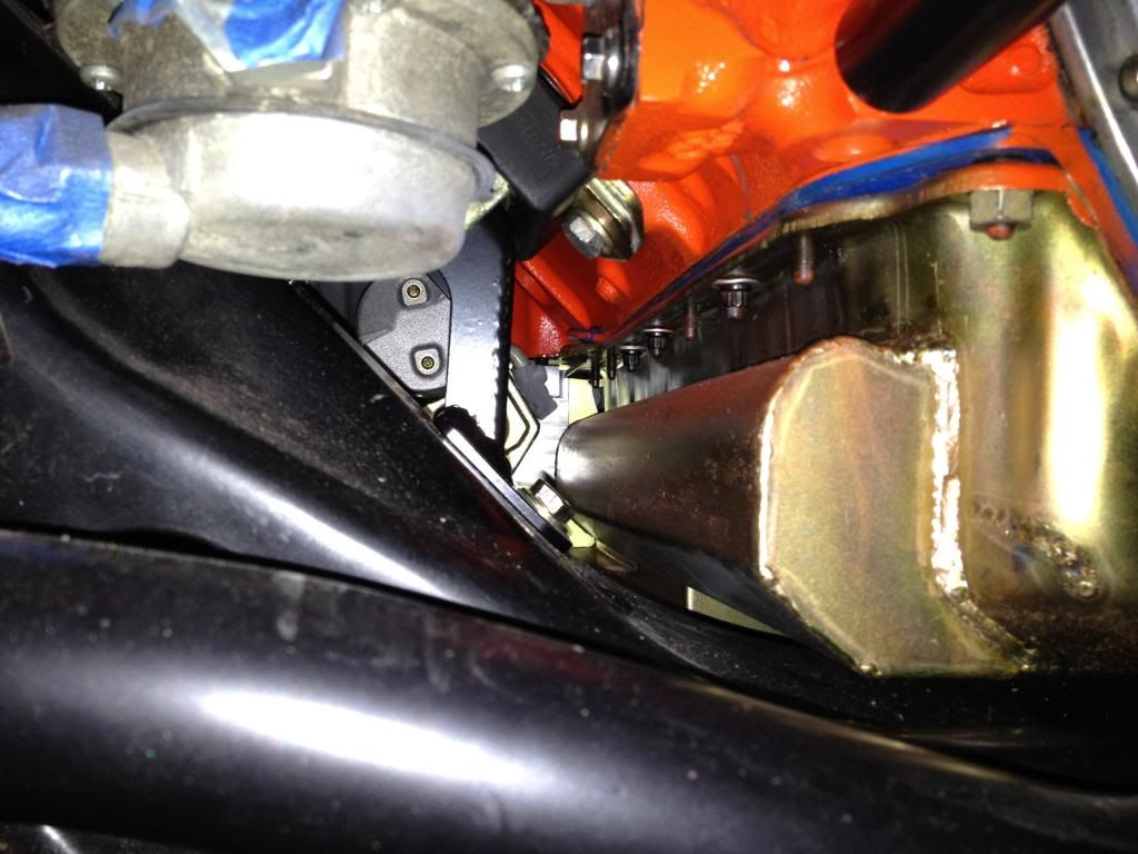

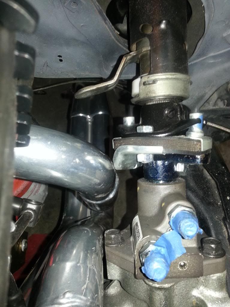

so update on the dynatech headers.
Apparently the headers are made for heads that are 18-1/8" from flange to flange. The dart heads i have are just over 1/2" wider, hence the clearance issues with the gear box. I talked to the dynatech rep and he was helpful. I suggested they move the 7 tube back in around 1/4" we will see what they say.
So that doesn't help me now so it looks like i may end up with a Borgenson steering joint to get the clearance I need.
http://i854.photobucket.com/albums/a...psa9cf1e36.jpg

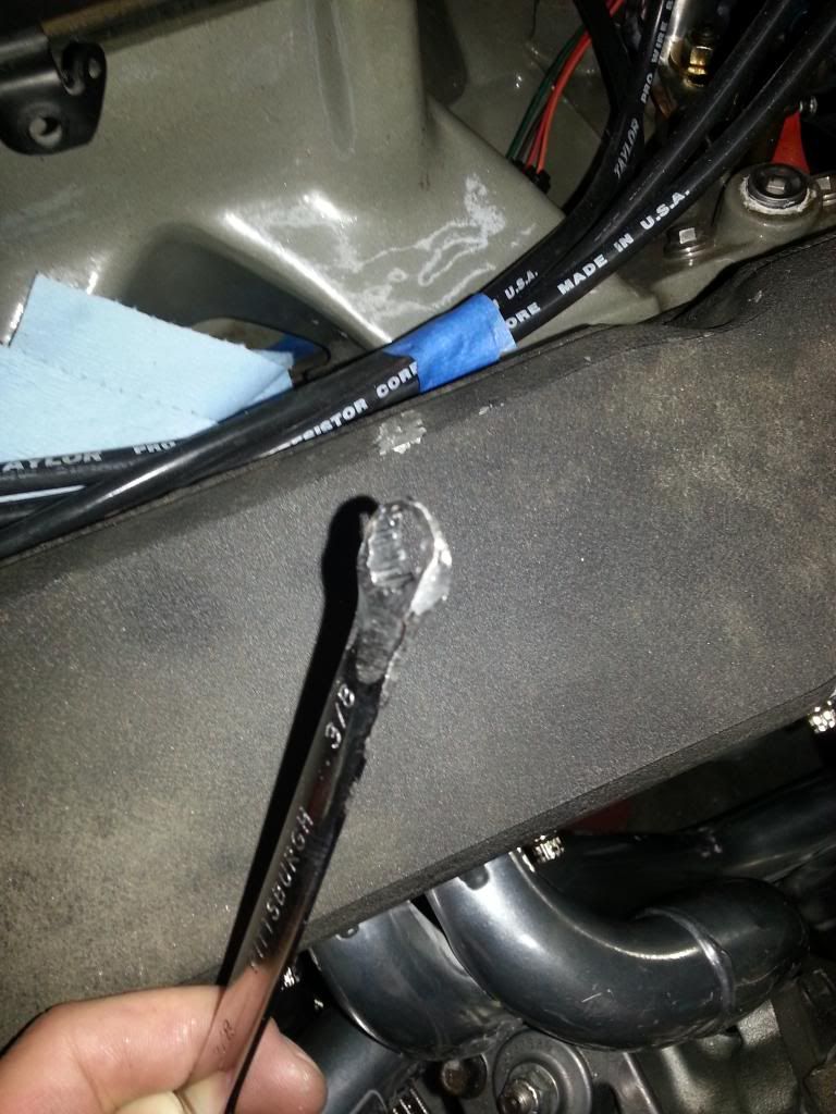

here is the "special" tool i made so I could get to a couple of the bolts
http://i854.photobucket.com/albums/a...ps1768c7d8.jpg
