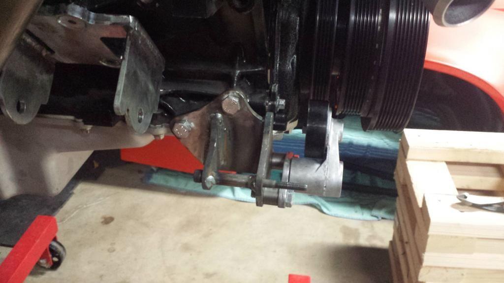

Had to pull the front end back off the car and pull the engine back out to modify the passenger side motor mount to give me enough room for a low mount a/c compressor. I think I found a setup that will work from Street and Performance but there is no telling until it gets here.

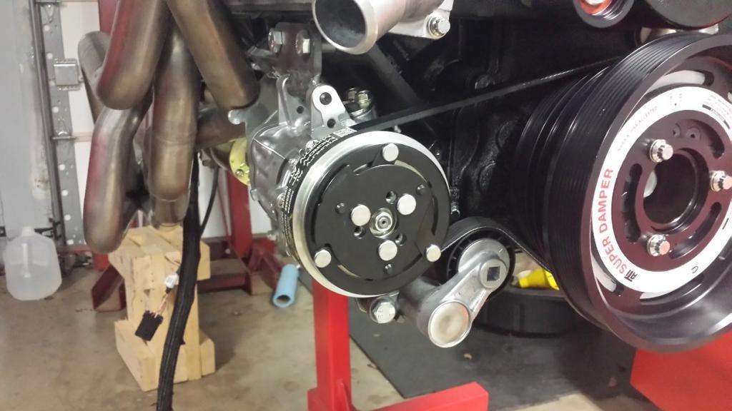

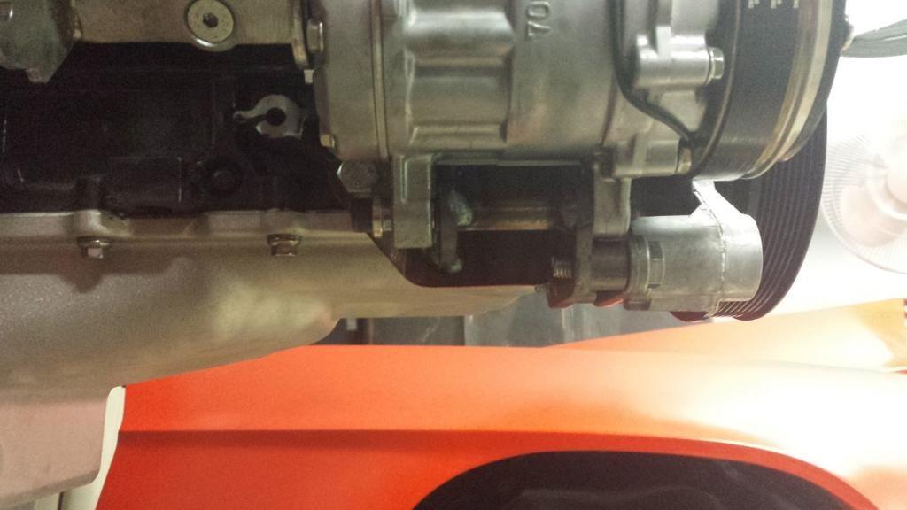

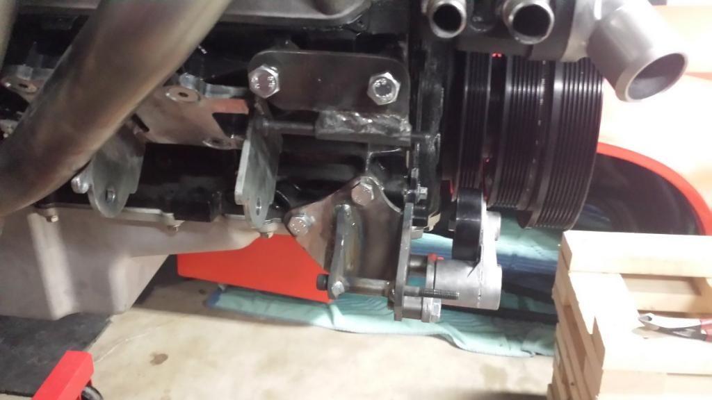

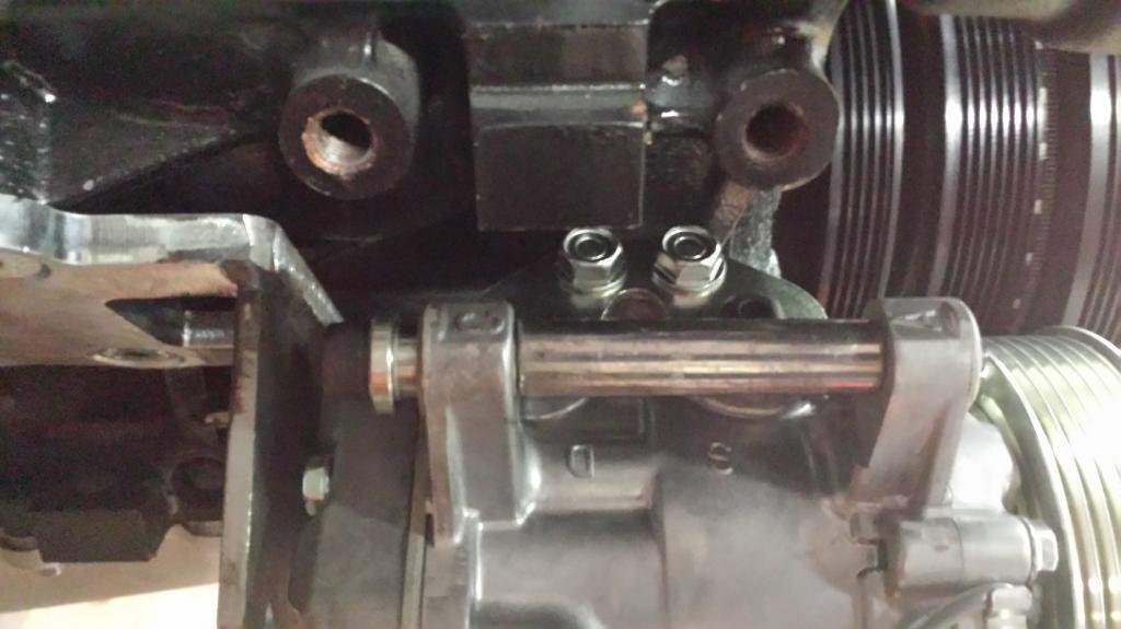

Well after modifying this Alan Grove mount to fit an Sanden SD7 I think I am just going to high mount my a/c compressor after all so its up for sale. I intended to use it with this manifold. I cant see why it would not work. I just had an offer on the rest of the accessory drive setup so I am going to swap it all out for something else. I avoid cutting into my already powdercoated subframe this way.

Yeah its an LSA supercharger. I think I am going to end up with the concept 1 front drive setup. The accessory drive in the pictures is a holley power steering and alternator bracket with an upgraded LSA supercharger drive. It worked great except I could not mount an a/c compressor down low. I fought with it and fought with it. Tried to move the motor mount back which would have given me just depth to fit the compressor but I still would have had to notch the already powdercoated subframe. Someone bought this setup so I going to high mount the a/c compressor and be done with it. I used the entire holley swap kit.
