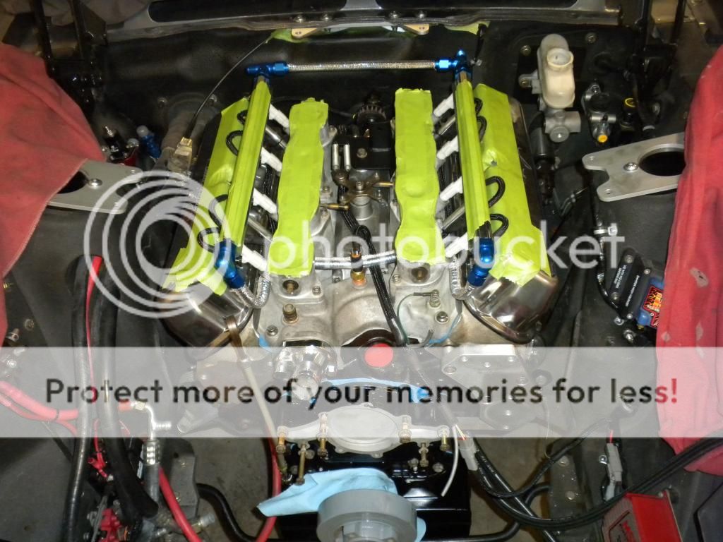

Get in the habit of running your wiring through shrinkwrap. Not only does it help hold the wiring together while running it but you also now have shrinkwrap on your wiring to "finish" whatever sheathing you run... especially good with powerbraid. Comes in handy for injector wiring that is "pull to seat" that you can't just pop the connector off and never seems to be finished cleanly. If you don't run sheathing then now you've got nice shrinkable collars to hold your wiring together.
http://i696.photobucket.com/albums/v...ps98f6e345.jpg

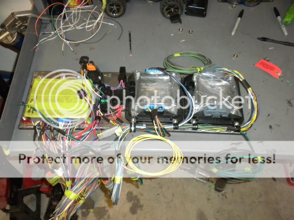

Adding on to that one as well... Make all components and individual harnesses removable. I deal with a lot of vehicles where components like the MSD box are hardwired into the car which is fine if it is never going to go bad... or have to be diagnosed... or have to be removed to access other components. Spend a few minutes to wire in connectors so that every component can be removed without having to take half the dashboard or wiring harness apart. When I wire EFI systems I run connectors to where they meet the vehicle harness so that if there is ever an issue I can remove the EFI system as a whole. I put connectors anywhere there may be a need to disconnect the wiring for any reason... I'd rather build it in now than end up cutting and splicing wires later. You can see in the pic below on this electronics panel for the current build I've even got connectors between the ISIS system and the XFI system in case I ever had to remove one or the other. (See my shrink wrap?!?! :yes: )
http://i696.photobucket.com/albums/v...ps071419fe.jpg
