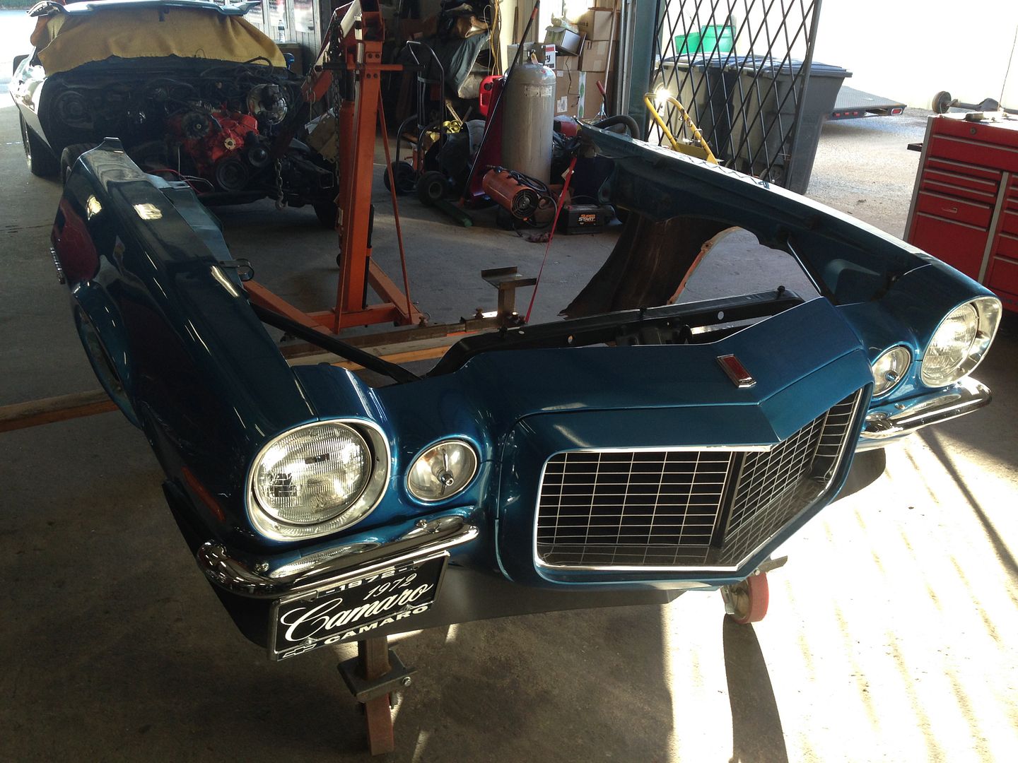

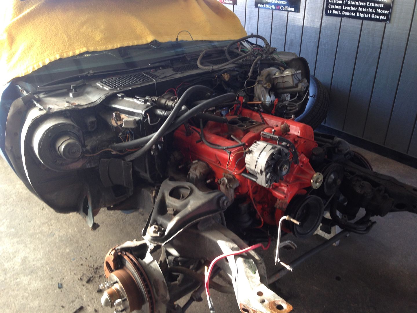

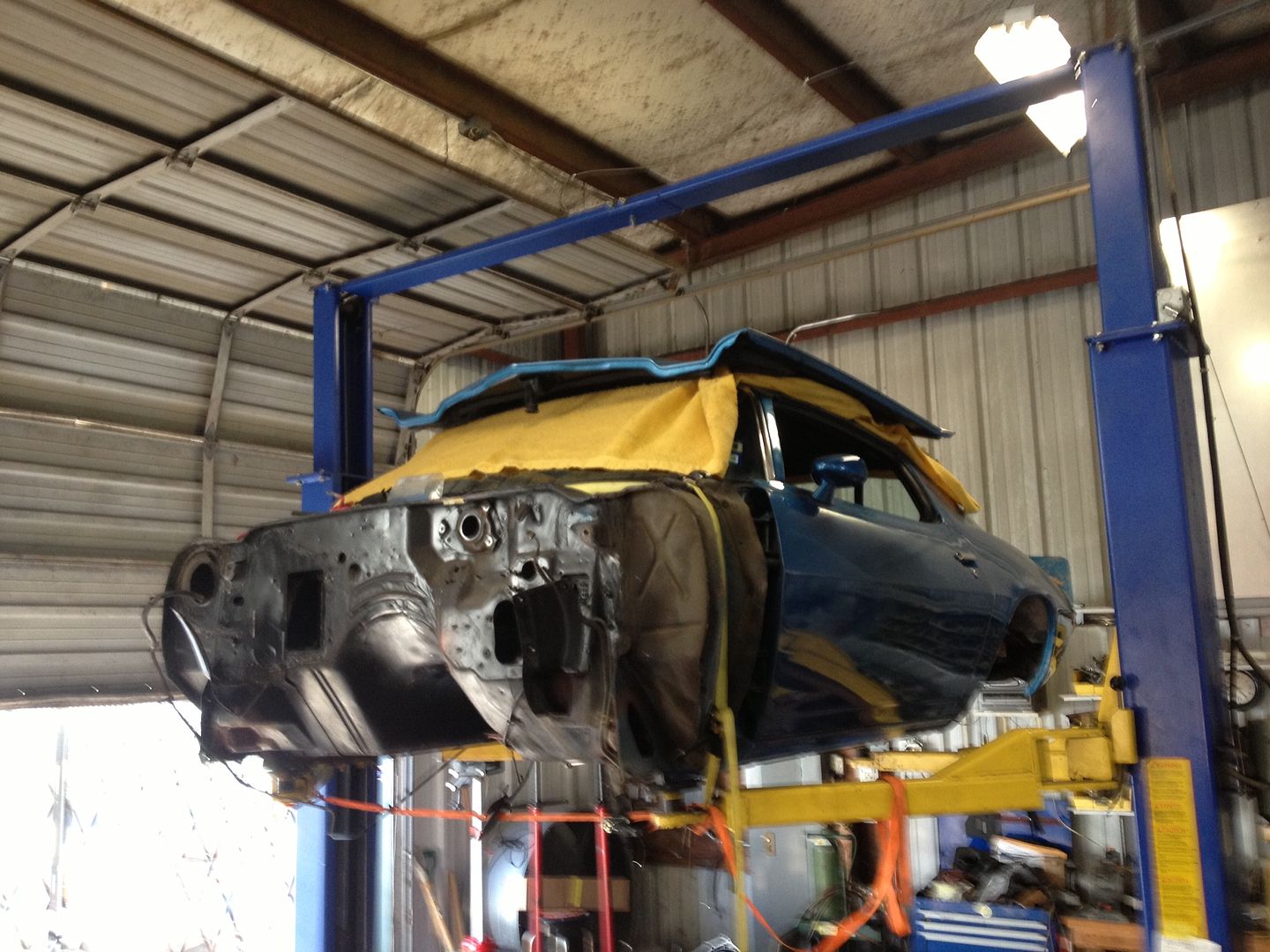

Few more pics from the tear down
http://i1337.photobucket.com/albums/...pswjjnwxll.jpg http://i1337.photobucket.com/albums/...ps3ysggjm6.jpg |

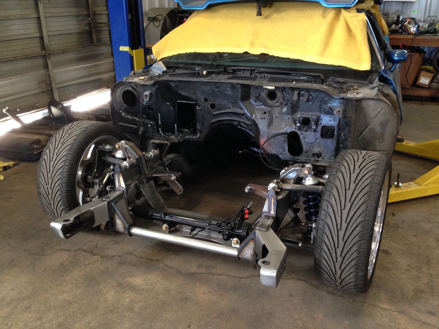

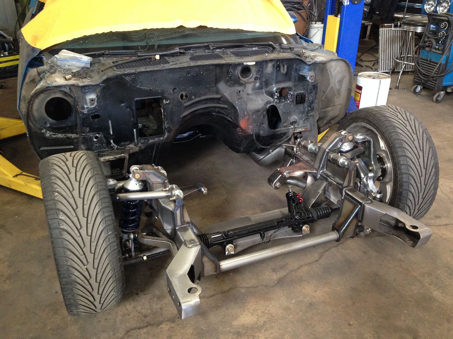

Car is down to an empty shell
http://i1337.photobucket.com/albums/...psq75ttwu5.jpg http://i1337.photobucket.com/albums/...psixvwlwoo.jpg Time to start trimming to fit the chassis and start on some of the custom touches we are doing |

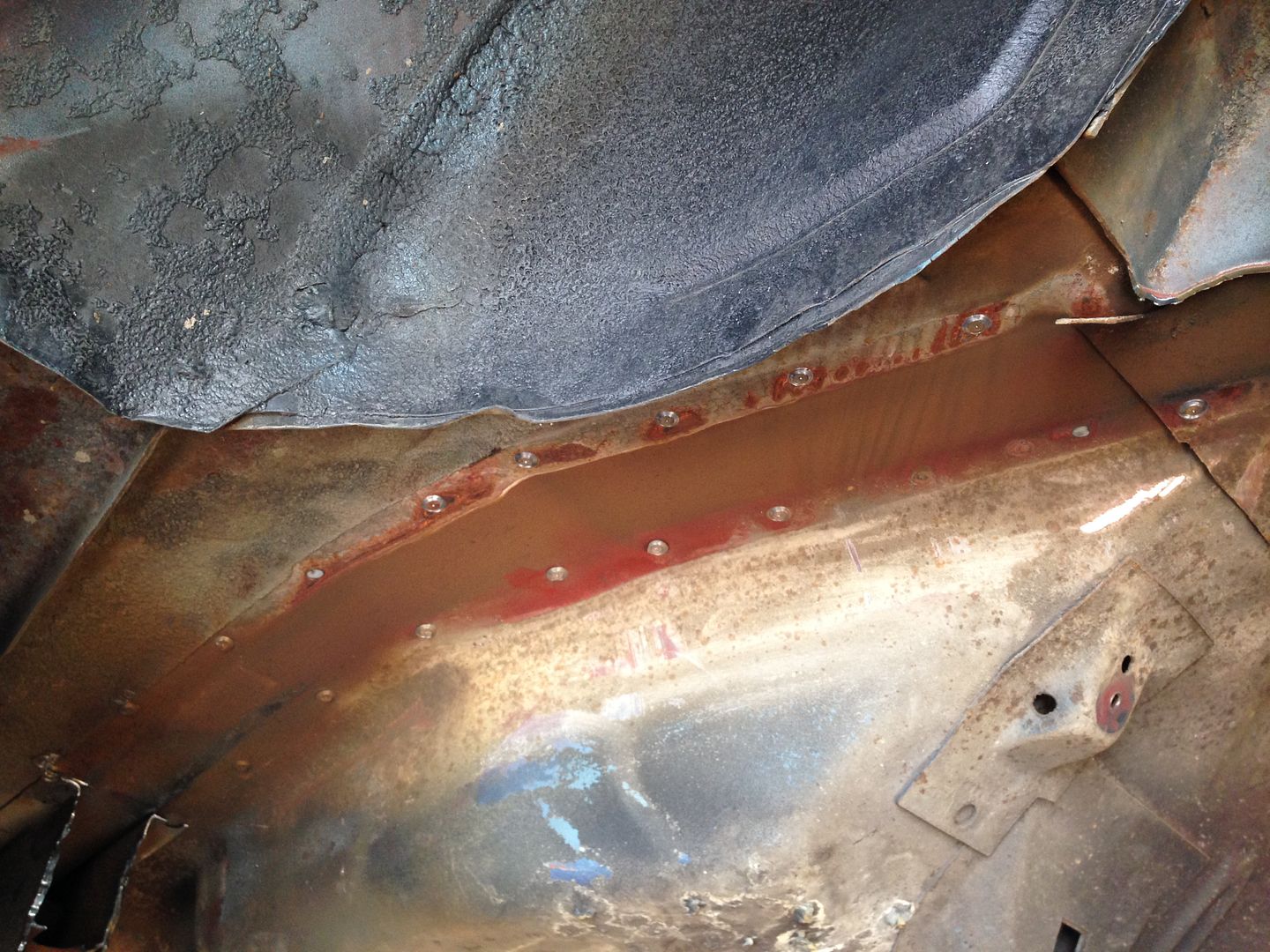

Todays update
http://i1337.photobucket.com/albums/...psltkavksy.jpg Completely removed the factory rear rails http://i1337.photobucket.com/albums/...psfnex7z5o.jpg |

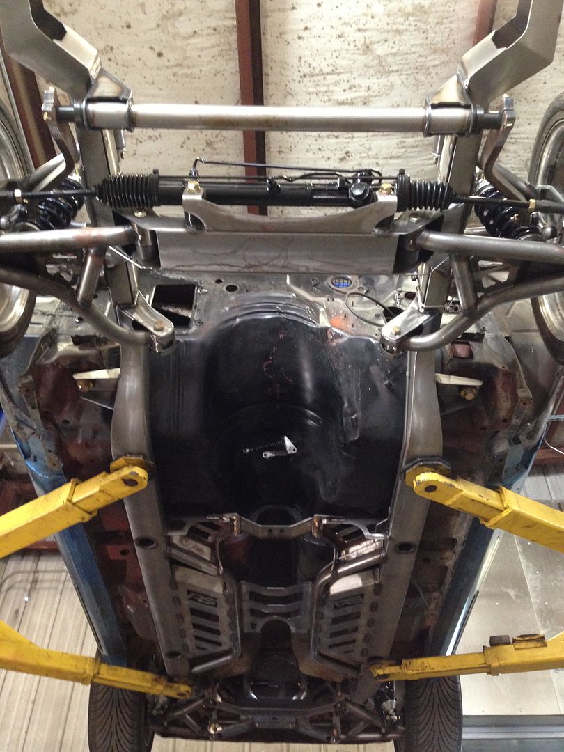

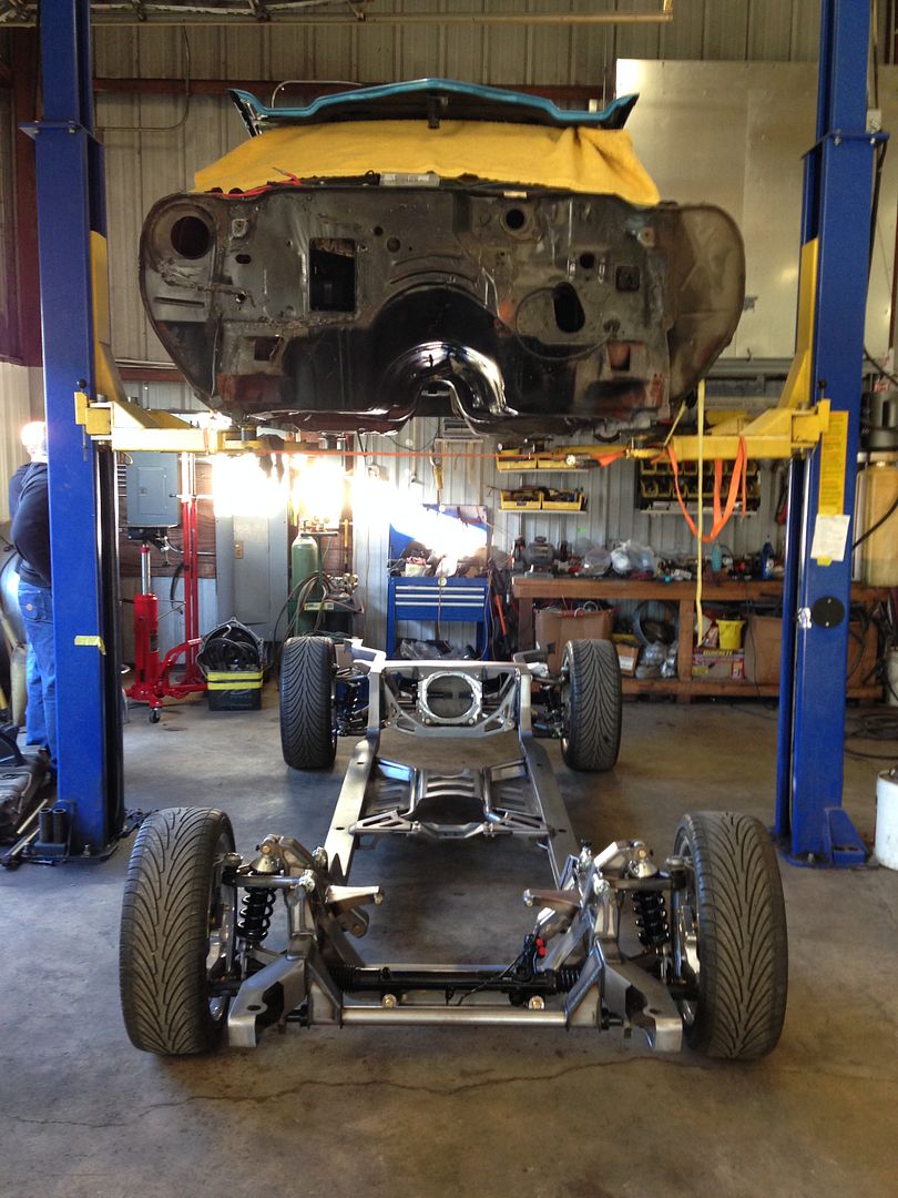

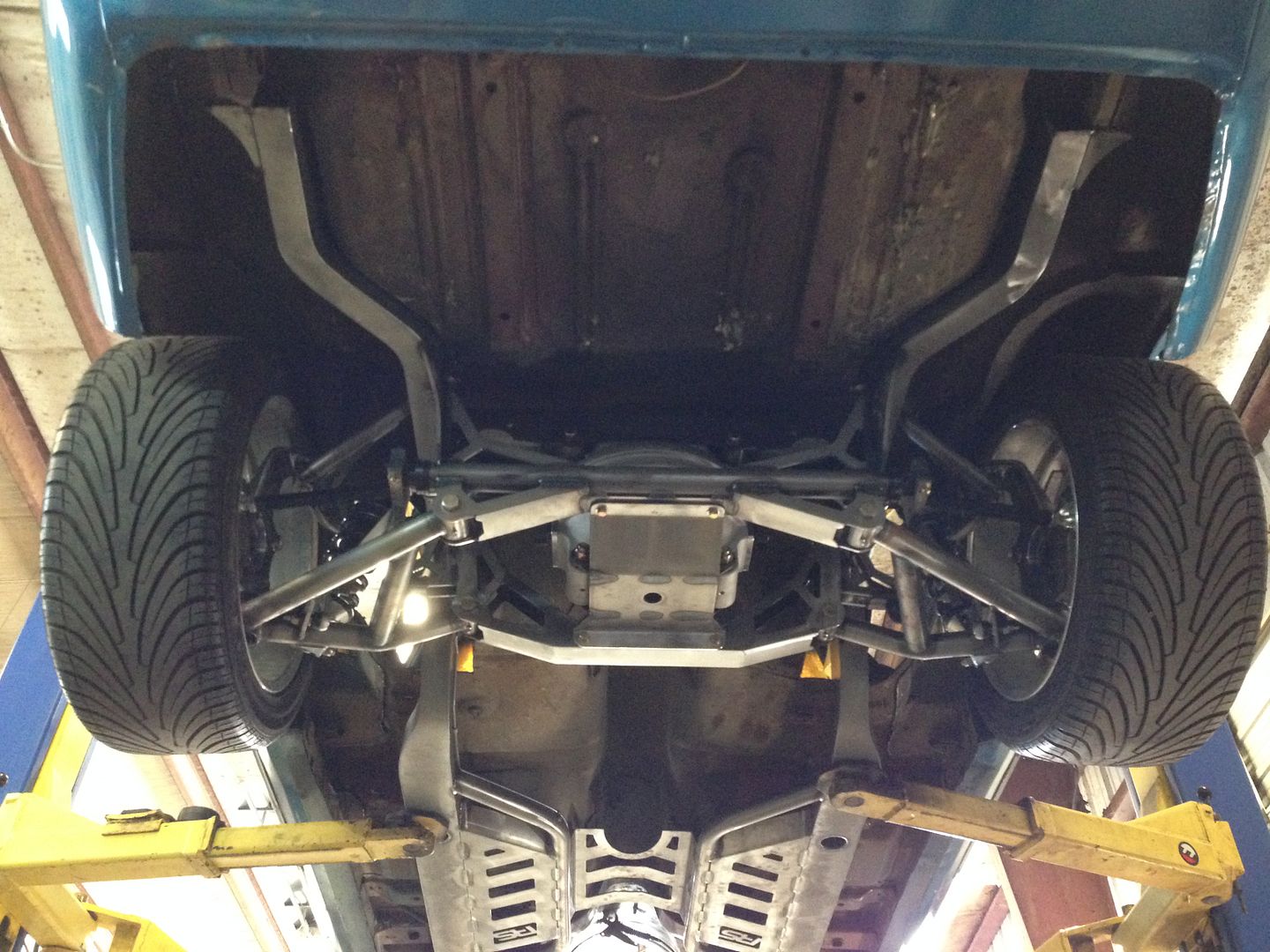

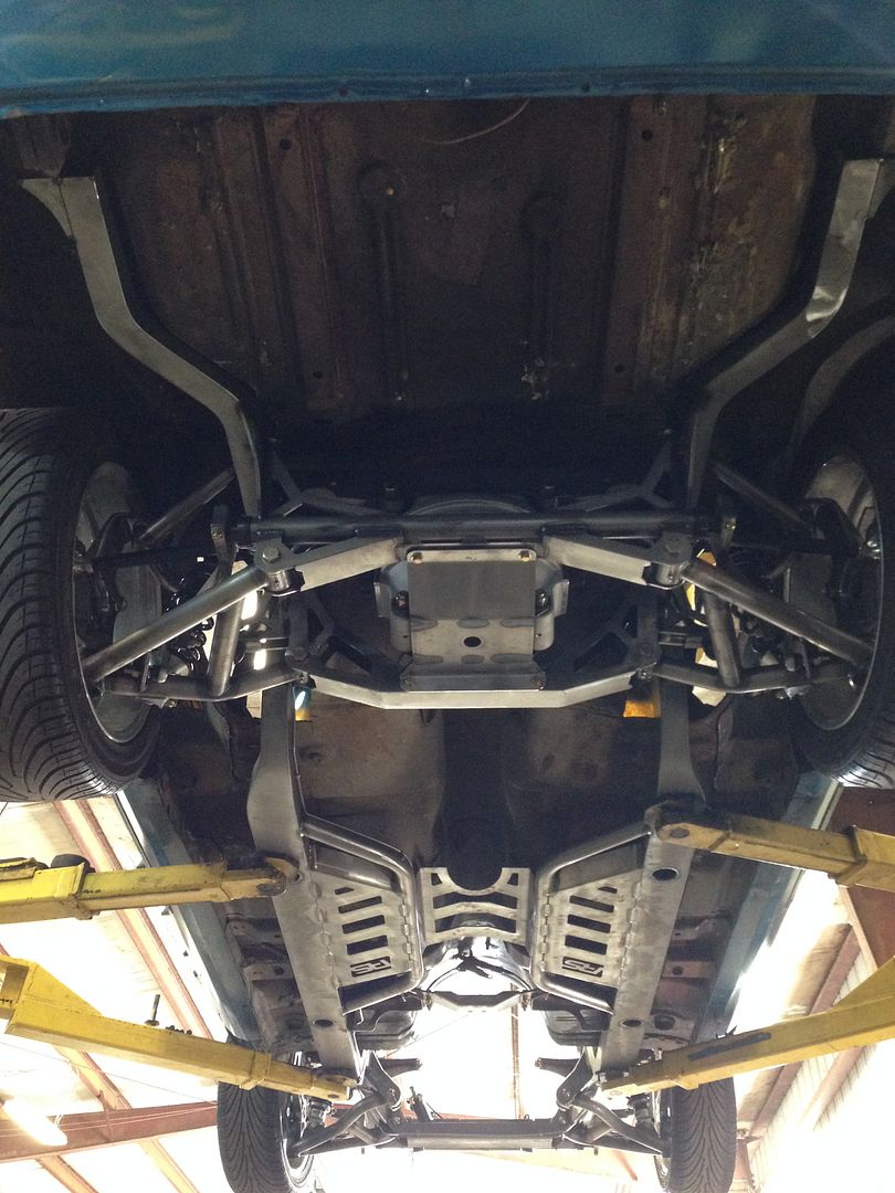

Got the floor trimmed and the body sitting on the chassis. Need to start the mini tubs and sheet metal work now that it bolts up.
http://i1337.photobucket.com/albums/...psoaotqk9z.jpg http://i1337.photobucket.com/albums/...psjhkqfgdh.jpg http://i1337.photobucket.com/albums/...pstp9ixbrf.jpg http://i1337.photobucket.com/albums/...pszbt2tbdx.jpg http://i1337.photobucket.com/albums/...psg8yuvaiv.jpg http://i1337.photobucket.com/albums/...pswwcstuwk.jpg http://i1337.photobucket.com/albums/...ps0lqqecl6.jpg http://i1337.photobucket.com/albums/...pslyoxwwie.jpg http://i1337.photobucket.com/albums/...psxfmpegit.jpg |

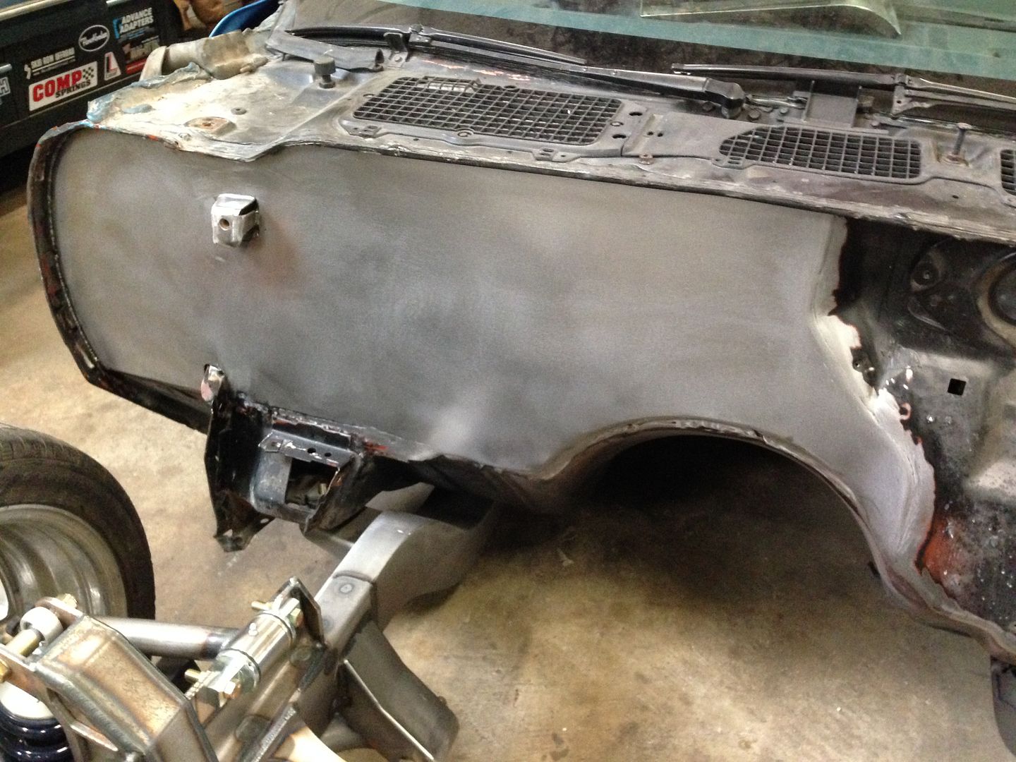

Got the firewall cleaned up !!!
http://i1337.photobucket.com/albums/...psgzf70bcm.jpg Now its time to start on the tubs http://i1337.photobucket.com/albums/...psnaofpoav.jpg |

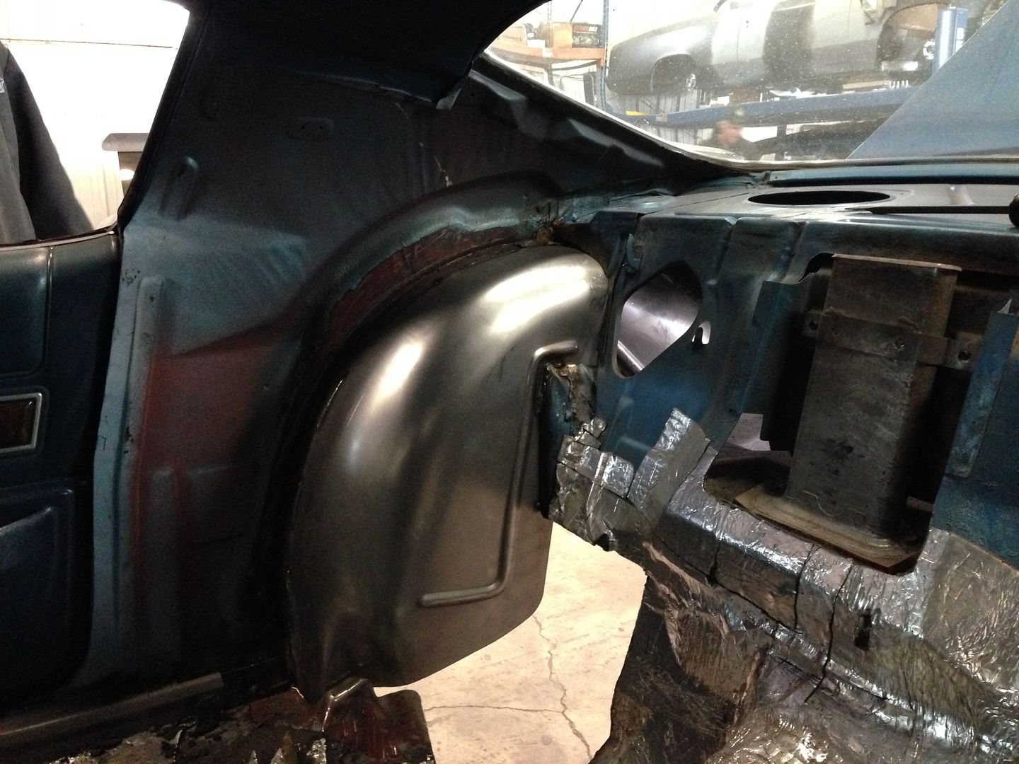

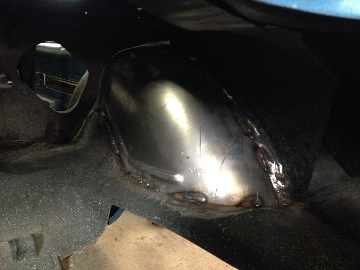

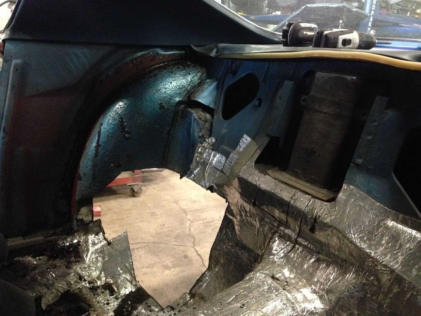

Starting installing the wheel tubs today. We took a DSE tub which will clear a 335 on the second gen, trimmed off the edge and moved it over an additional 1 1/4" to give him plenty of tire clearance for the 345 he wants to run
http://i1337.photobucket.com/albums/...psyans8kah.jpg http://i1337.photobucket.com/albums/...pscw1hrfzd.jpg http://i1337.photobucket.com/albums/...pscupvvne4.jpg |
