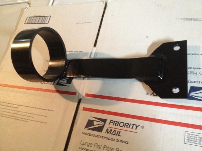

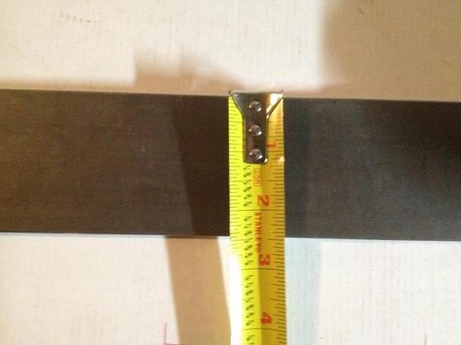

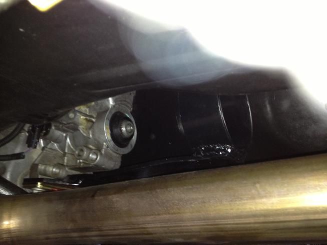

Just an update...I ended up making a driveshaft safety loop out of 1/4"x2-1/2" steel plate. I got the solid loop from Jegs, and the rest is bar stock. I mounted this between the T56 mount and the trans itself. I thought I'd get lucky and make a straight run back, but the loop needed to be about 1" higher than the front mount.

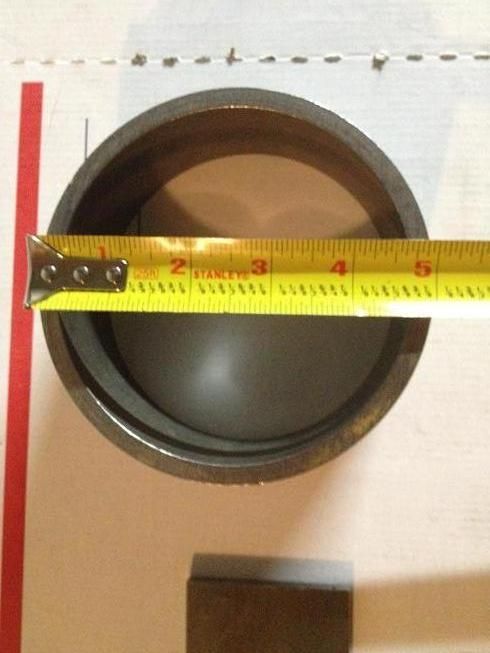

Jegs loop:
http://i228.photobucket.com/albums/e...ps17c841b9.jpg

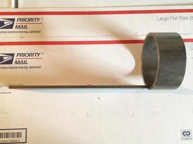

Bar stock:
http://i228.photobucket.com/albums/e...psfa1bd4c6.jpg
http://i228.photobucket.com/albums/e...psbd27e78b.jpg

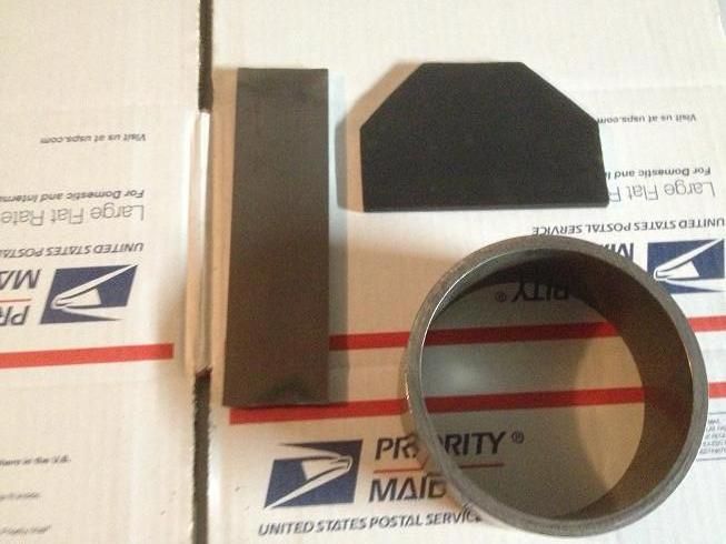

Basic shapes:
http://i228.photobucket.com/albums/e...ps628c3d36.jpg

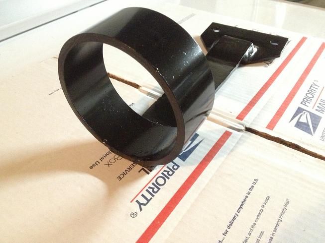

This is what I came up with:
http://i228.photobucket.com/albums/e...ps395a8fa1.jpg
http://i228.photobucket.com/albums/e...ps5343c080.jpg

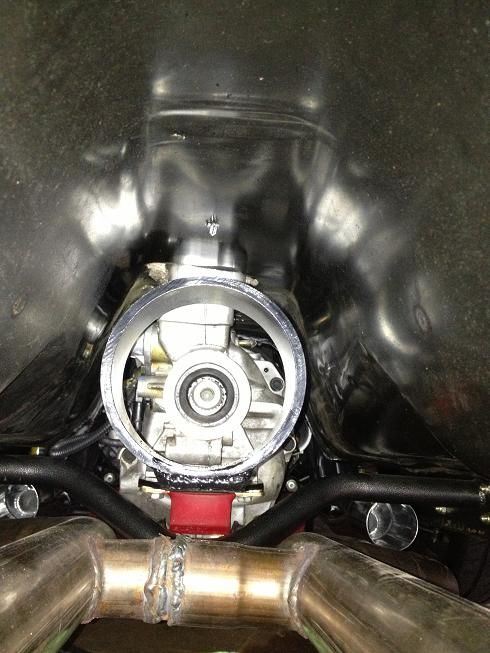

Here it is installed:
http://i228.photobucket.com/albums/e...ps7c057ac8.jpg
http://i228.photobucket.com/albums/e...ps5ab761a3.jpg
Notice the hack job on the exhaust H-Pipe. That's not my work, and yes I paid to have that done. When I get back from Jamaica, it's going to a real exhaust shop and I'm having them install a Magnaflow X-Pipe, with new pipe running from the new headers to the existing Magnaflow mufflers.
