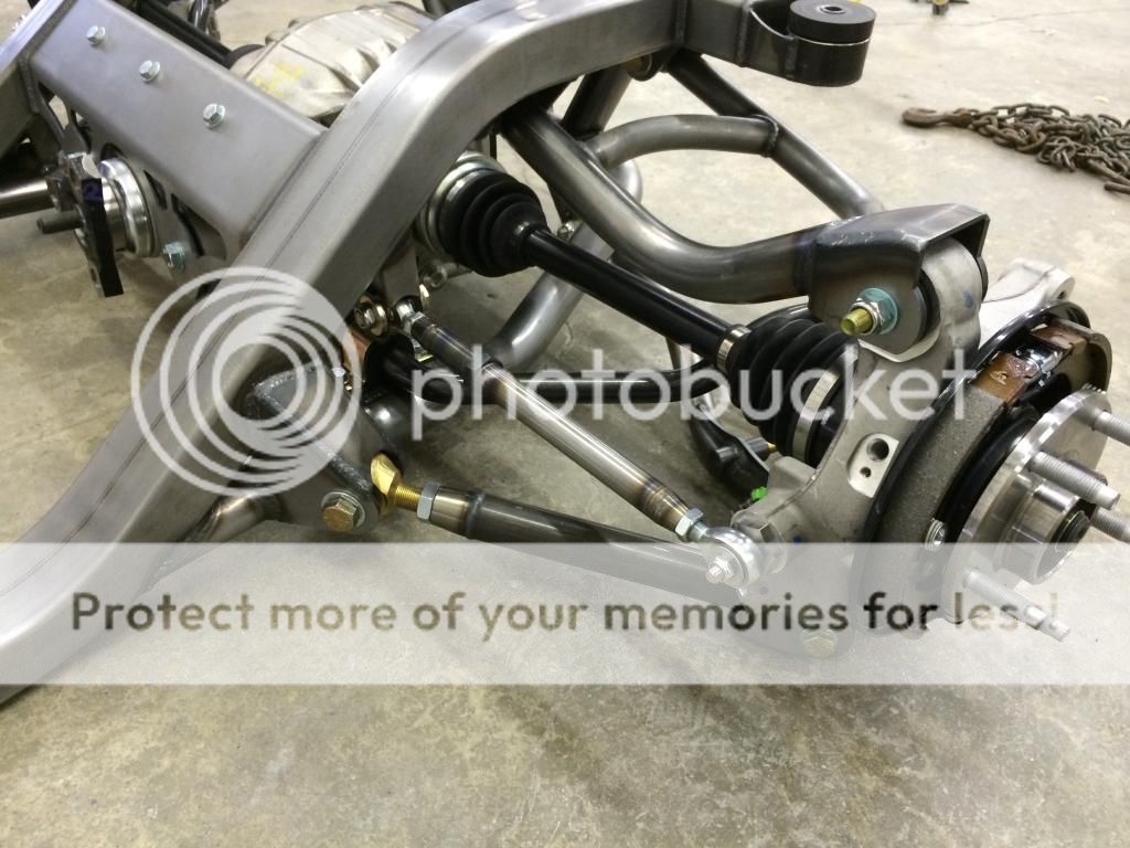

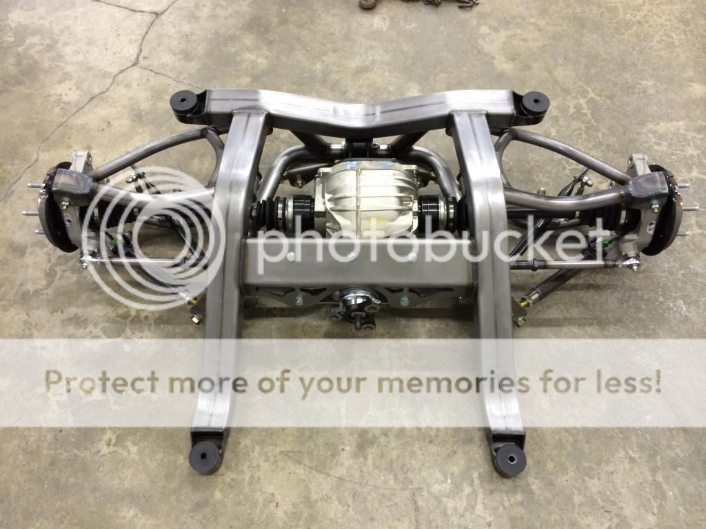

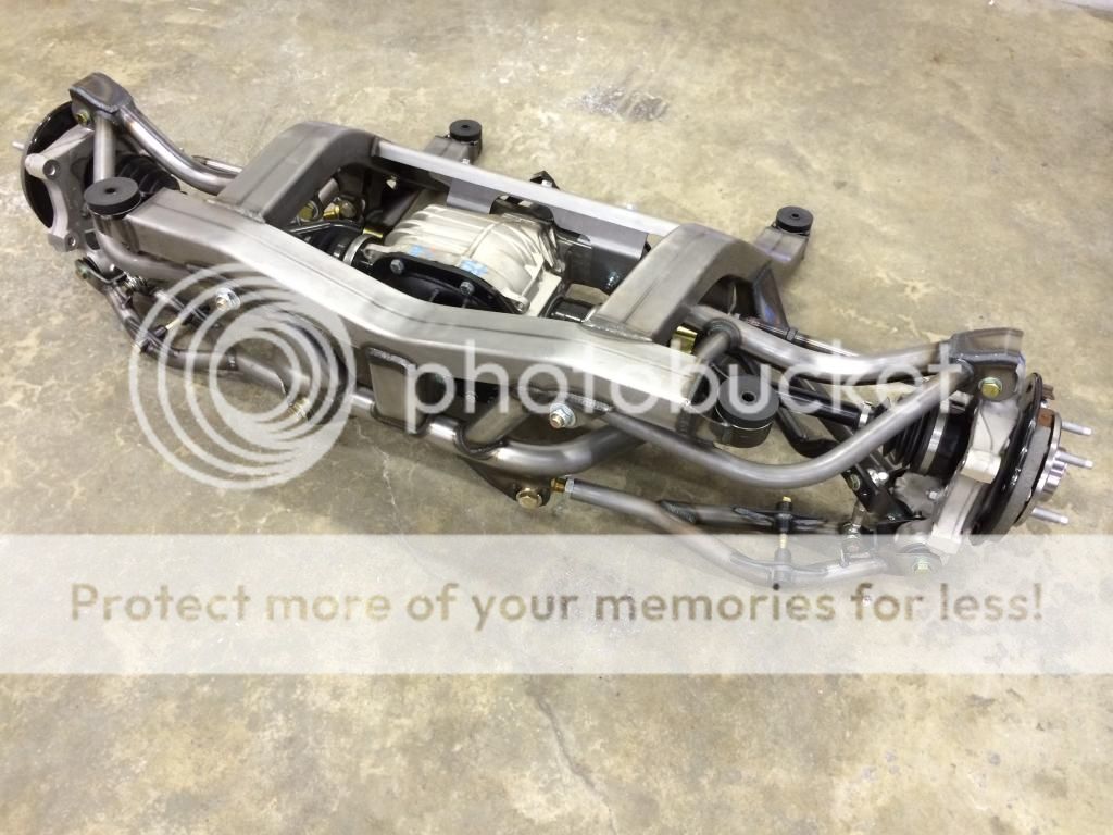

We got the rear suspension! It looks killer!!!
http://i461.photobucket.com/albums/q...2A8CC229D6.jpg
http://i461.photobucket.com/albums/q...E386FE6A15.jpg
http://i461.photobucket.com/albums/q...15DED02ACD.jpg

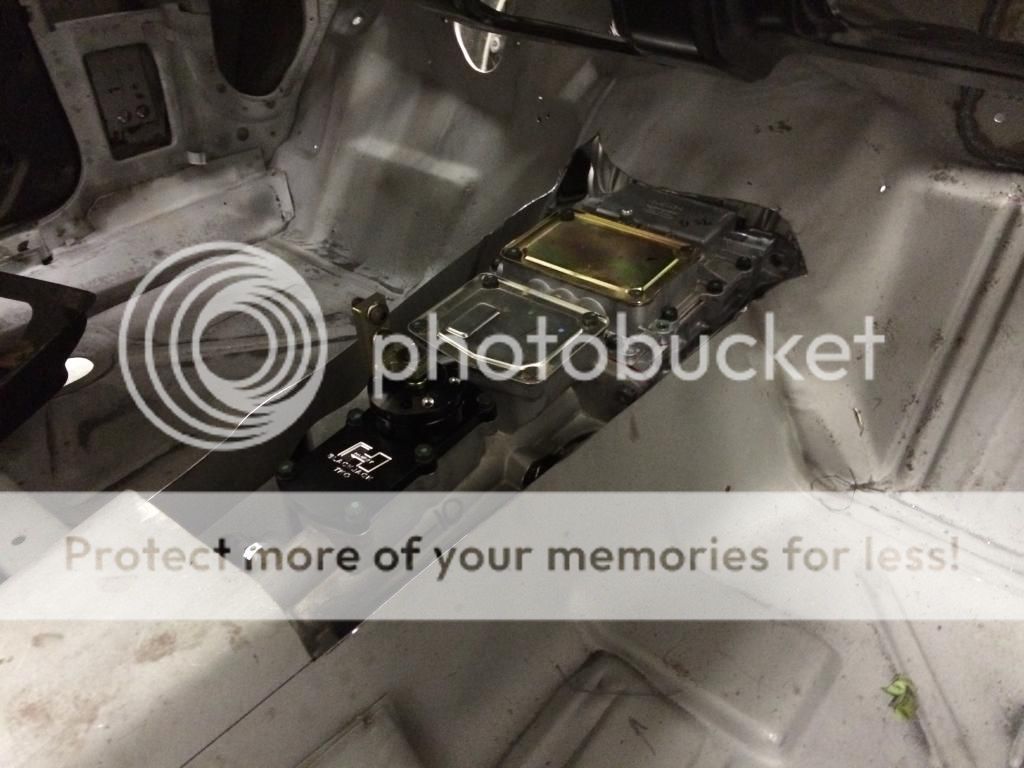

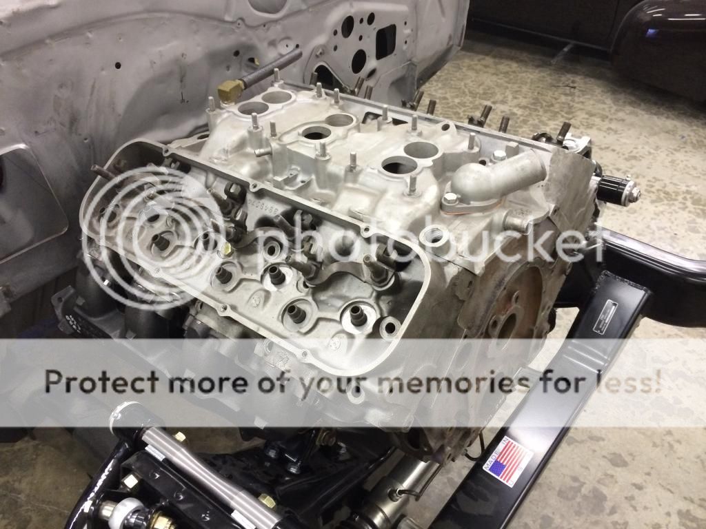

Also getting the engine and trans mocked up!http://i461.photobucket.com/albums/q...7128B0F46D.jpg
We had some slight clearance issues with the half height body mounts and the TKO600. Im raising the tranny tunnel about the trans 3/4".

Looks awesome. That's the art Morrison setup correct?
preston 11-21-2014 10:20 AM
What type of rod end bushings are used in the IRS UCA and LCA ? They look a little like a Spohn joint (large delrin bushed 360 degree rose joint). Is there no rubber or poly in the setup ? (I have come to the conclusion that hard jointing suspension and then soft joining the subframe is the ideal solution to the bushing firmness batle).
