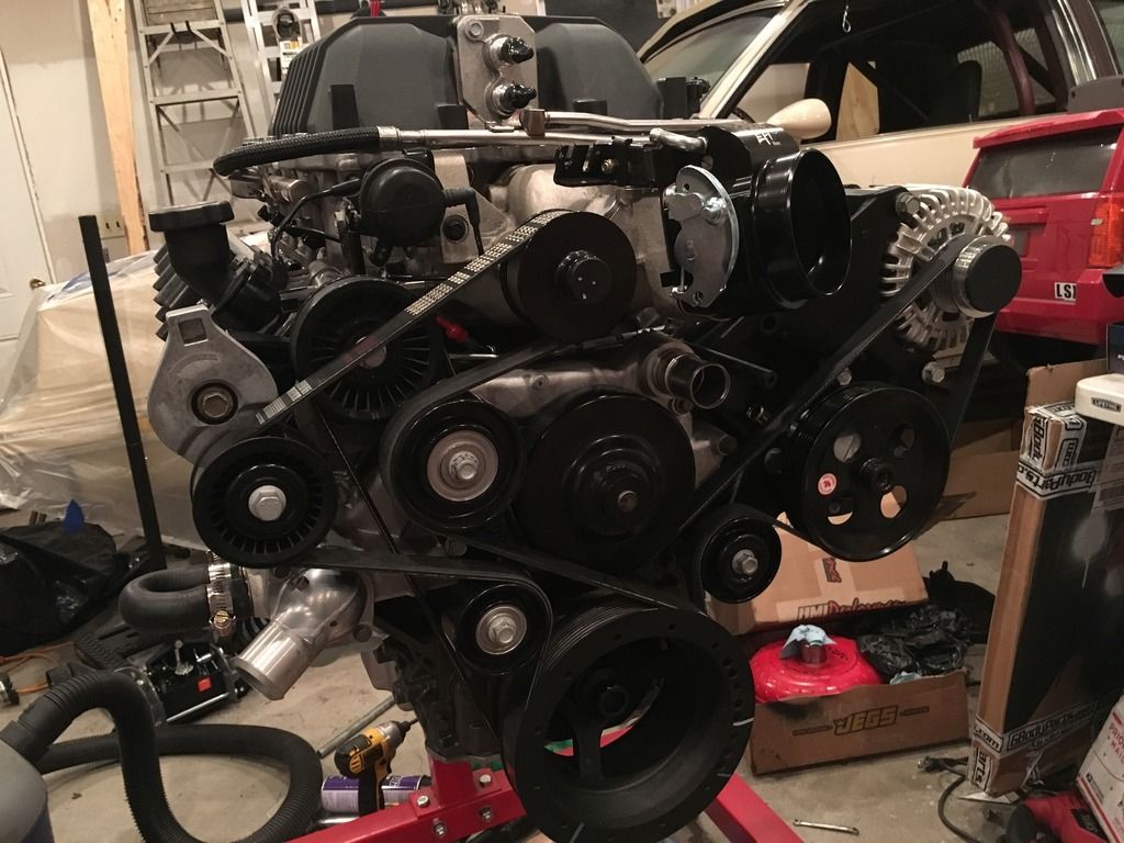

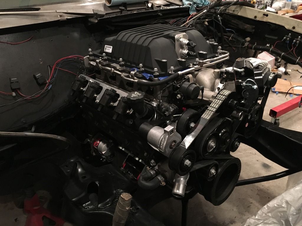

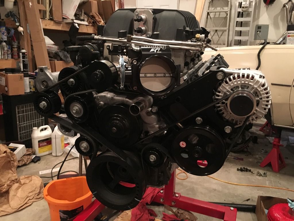

Update as promised!

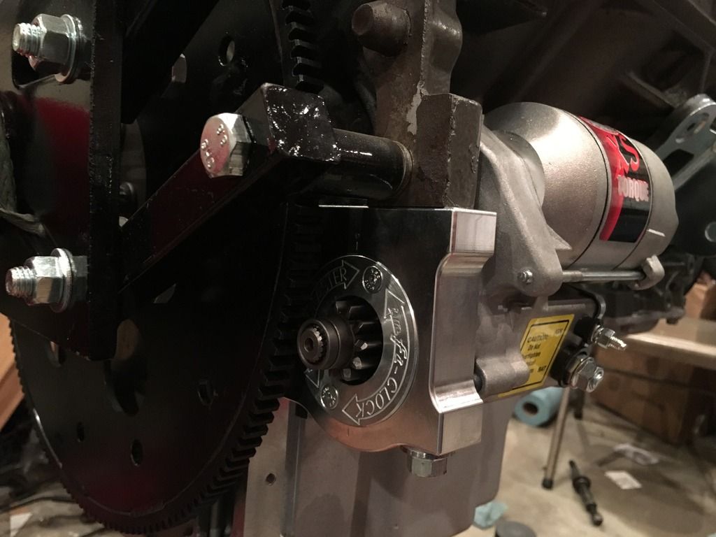

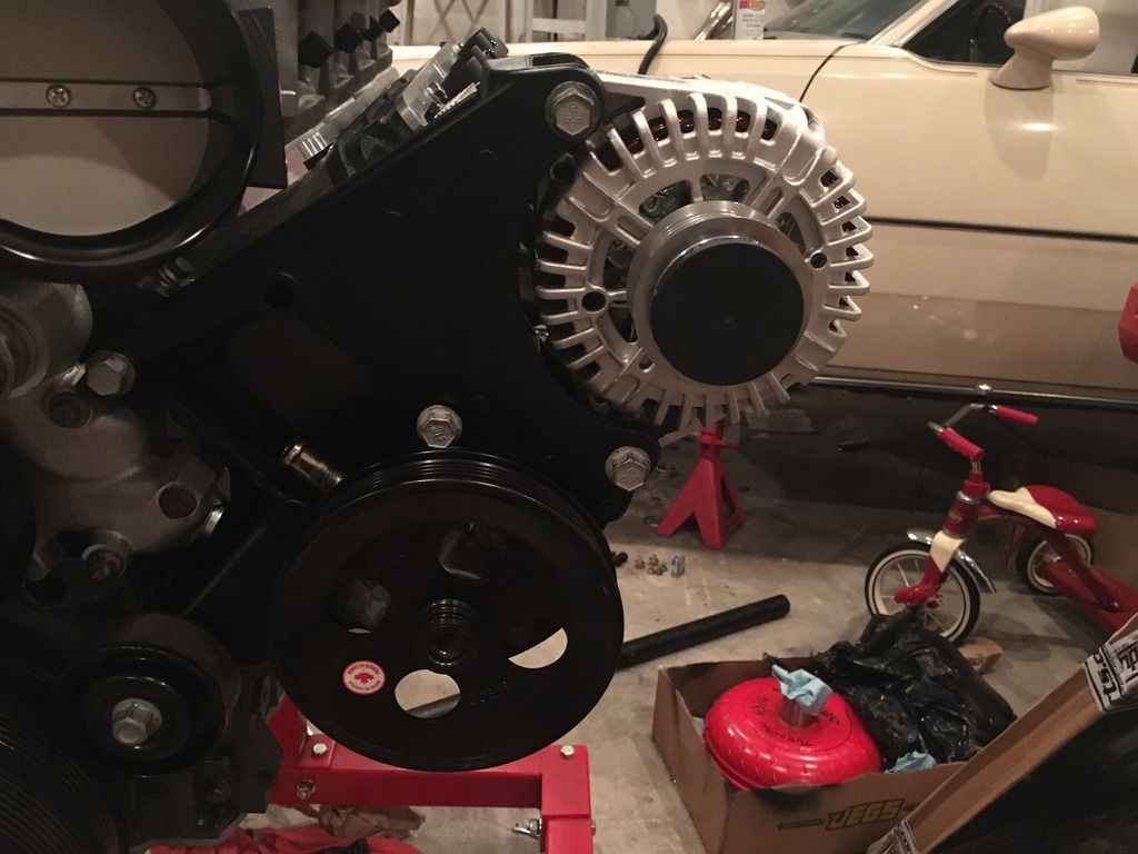

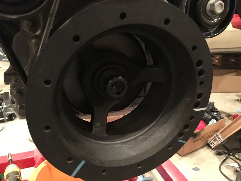

I can say as of tonight (minus supercharger oil) that my engine is complete! Crank was pinned last week and the remaining accessory parts attached. Finalized belt lengths and purchased a small amount of hardware needed to attach things like the steam vent tube, etc...
http://i908.photobucket.com/albums/a...psni68iq12.jpg
http://i908.photobucket.com/albums/a...pscha6ntq2.jpg
http://i908.photobucket.com/albums/a...pstotitxwq.jpg
http://i908.photobucket.com/albums/a...psfsrqb9hm.jpg

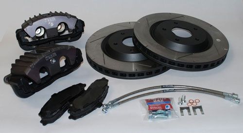

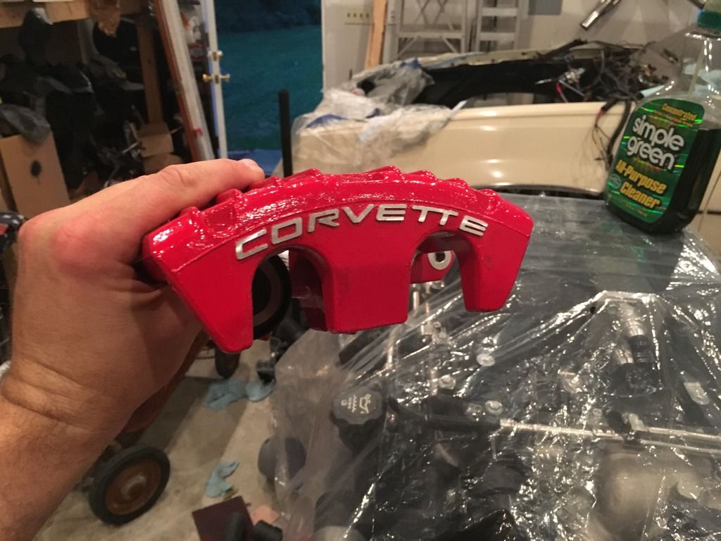

I have also been collecting up all the suspension/brake parts I am adding such as the UMI gbody C5 hubs and bracketry, steering rebuild kit, new stock spindles and Kore3 C5 Z06 brakes! See below!!!
http://i908.photobucket.com/albums/a...psrzm2eedo.jpg
http://i908.photobucket.com/albums/a...pswyh51oms.jpg
http://i908.photobucket.com/albums/a...psjmcxhqjp.jpg
http://i908.photobucket.com/albums/a...pstp3vh9oh.jpg

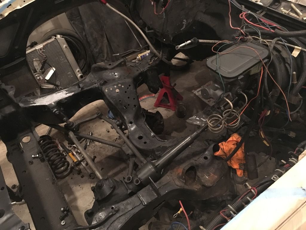

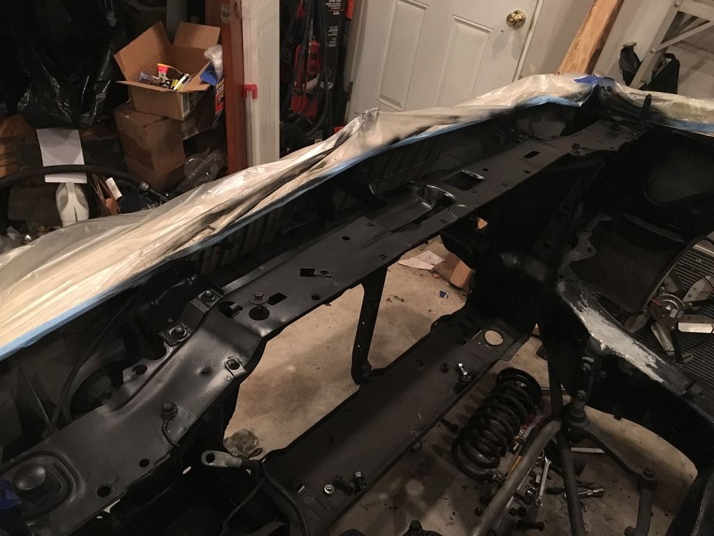

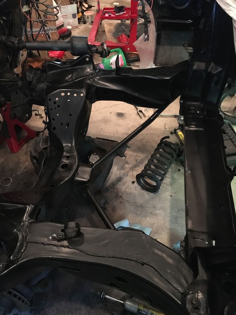

And while this car is definitely a driver I did some fram clean up on her to ,are it more presentable:
http://i908.photobucket.com/albums/a...psdrko0sap.jpg
http://i908.photobucket.com/albums/a...ps1s5aulrl.jpg
http://i908.photobucket.com/albums/a...psgcv8a1wo.jpg

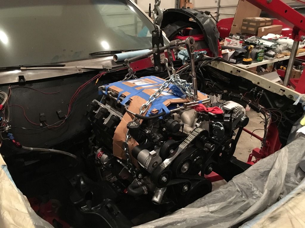

BanditDave 08-08-2016 10:14 PM

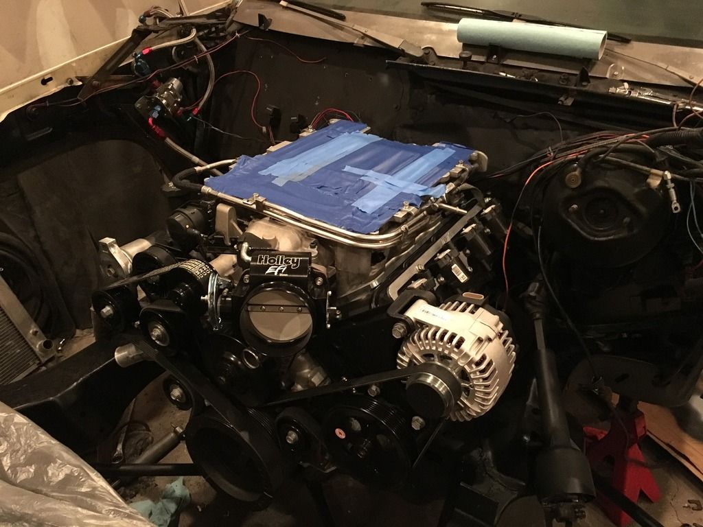

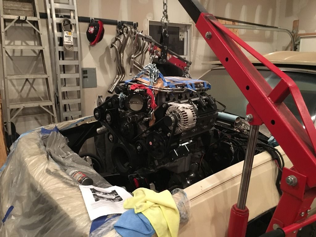

Well, time wasn't on my side this past weekend but tonight officially got the motor back in the car. Had to pull the blower lid and get fancy with some chain but it just barely cleared the fender and fit like a glove.
Got the Trans back last weekend and all my brakes from Kore3 this past weekend so I am swamped with parts!
Again, I have to praise Holley on a great product to mount an LS drivetrain. They science out their product so it is easy to complete the transplant.
So without further adeu, on to the pics!!!

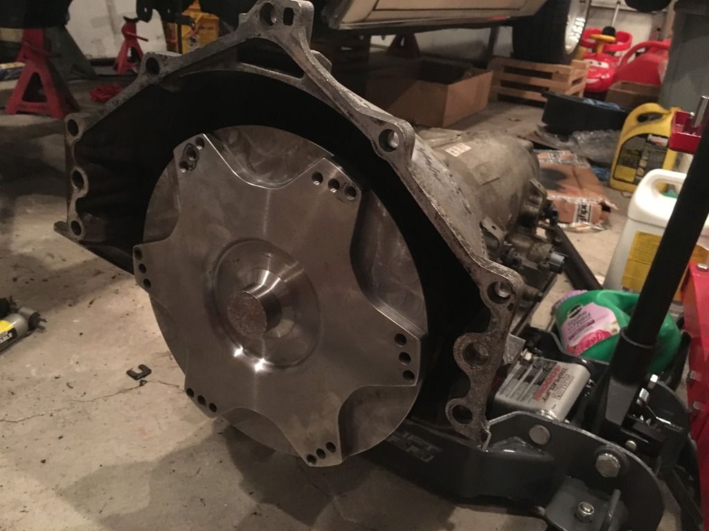

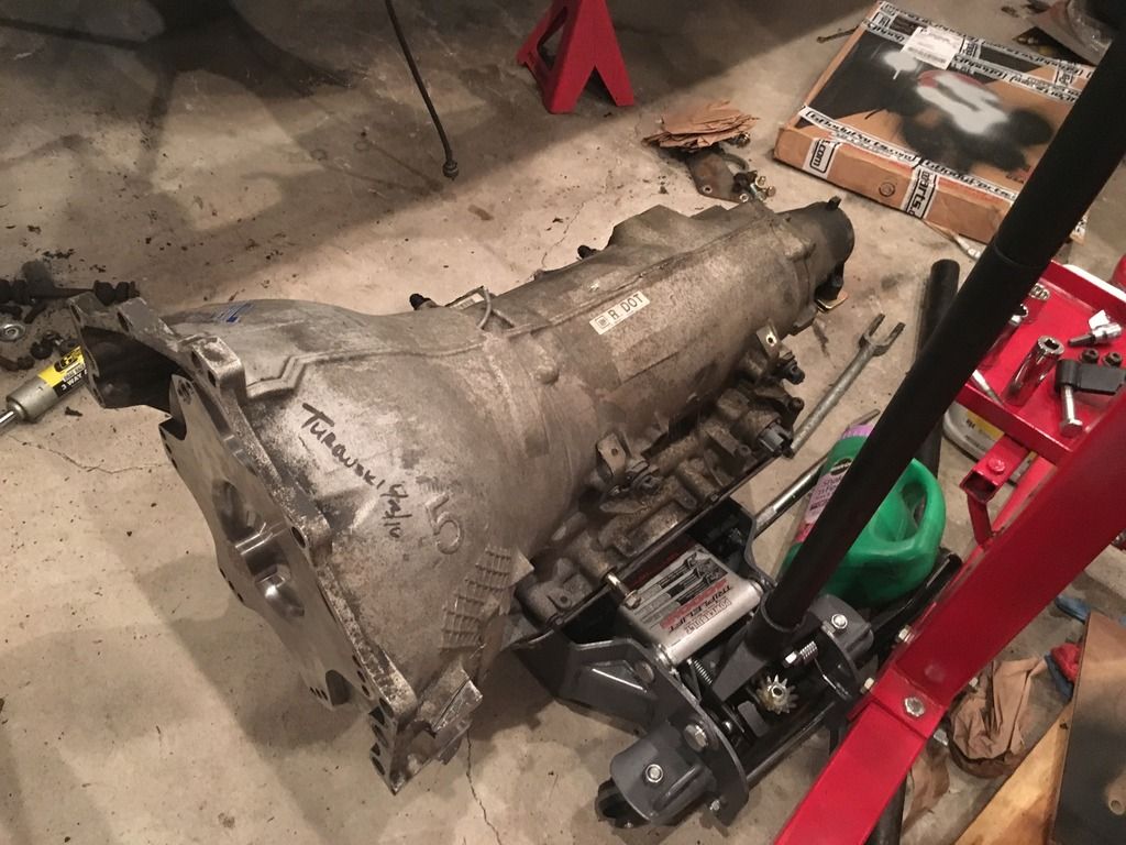

Very built 4l80e from DiabloFormula Racing - great prices and great work. PM me if you have more interest.
http://i908.photobucket.com/albums/a...psgakljems.jpg
http://i908.photobucket.com/albums/a...psp4gfs2ot.jpg
Trans installed this past weekend...very straightforward.

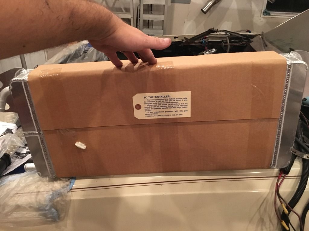

AFCO zl1 upgraded heat exchanger:
http://i908.photobucket.com/albums/a...ps0gnu3n6l.jpg
http://i908.photobucket.com/albums/a...psboyyvp2h.jpg
http://i908.photobucket.com/albums/a...psoeopo3fb.jpg
http://i908.photobucket.com/albums/a...psim2ahtwu.jpg
http://i908.photobucket.com/albums/a...psrggsj78d.jpg
http://i908.photobucket.com/albums/a...pswjtlcsrc.jpg
