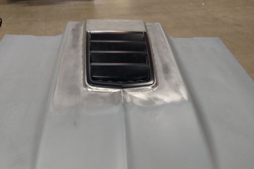

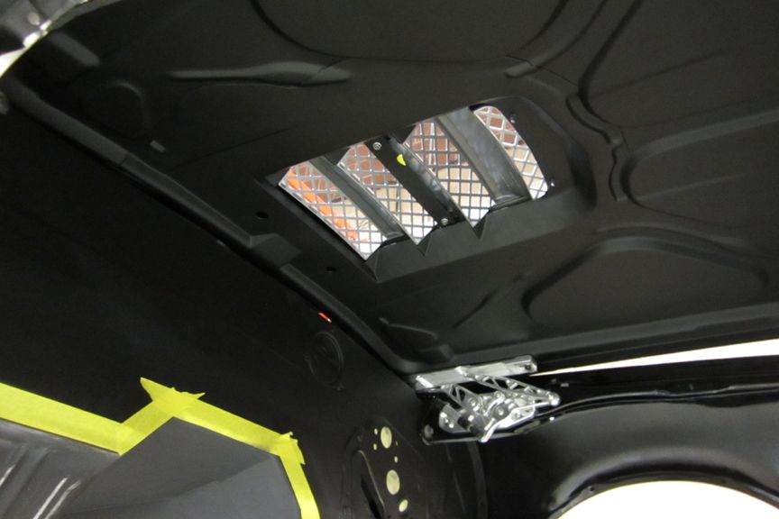

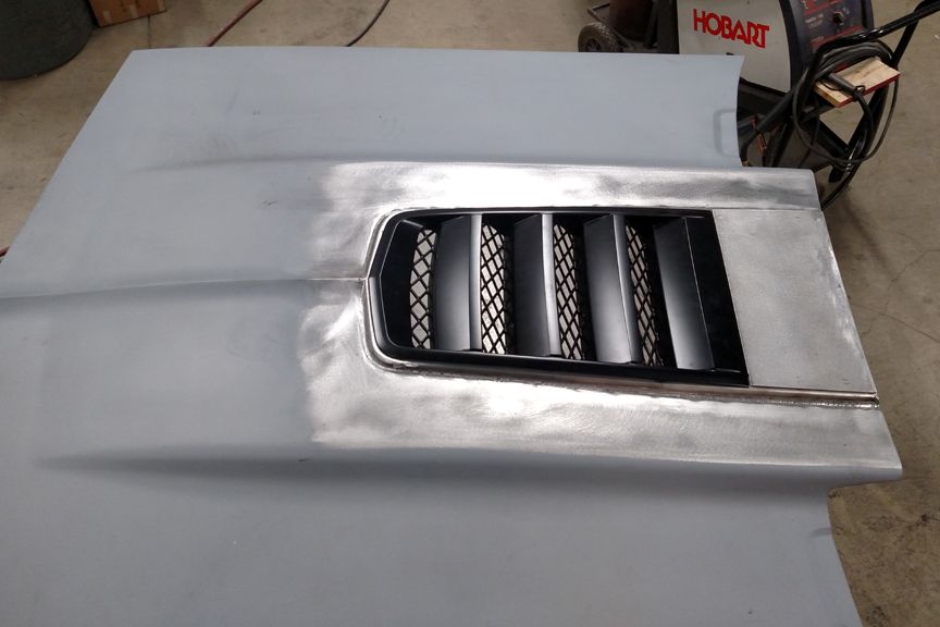

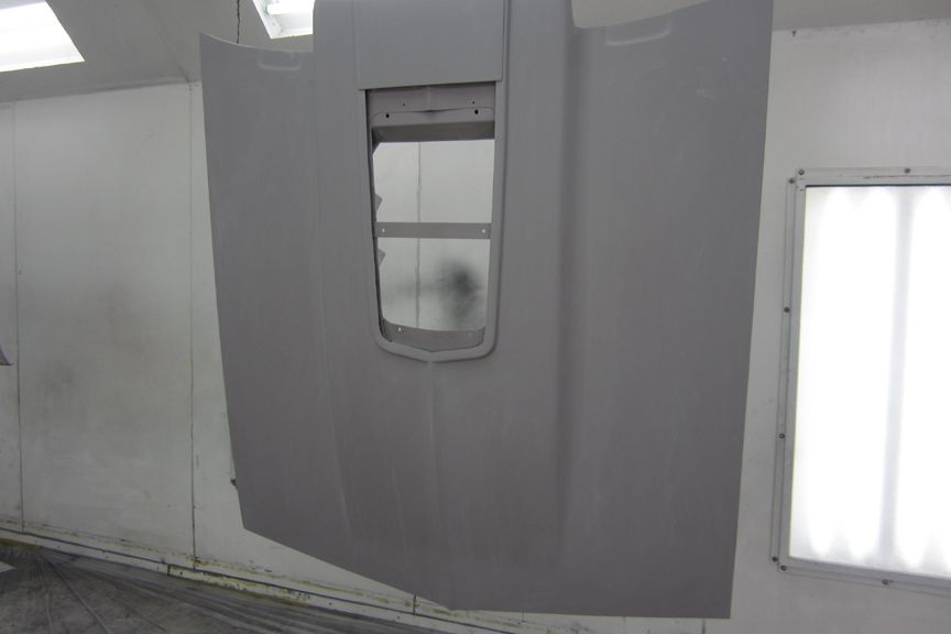

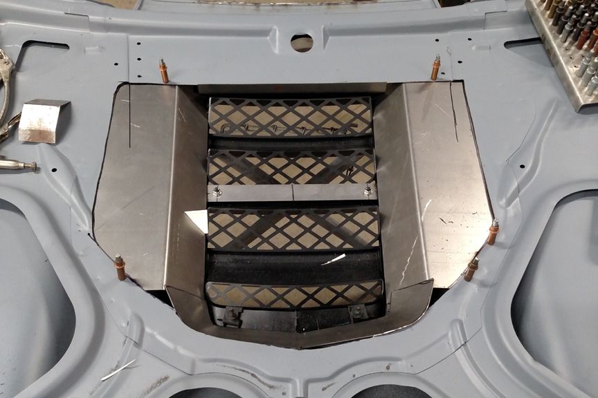

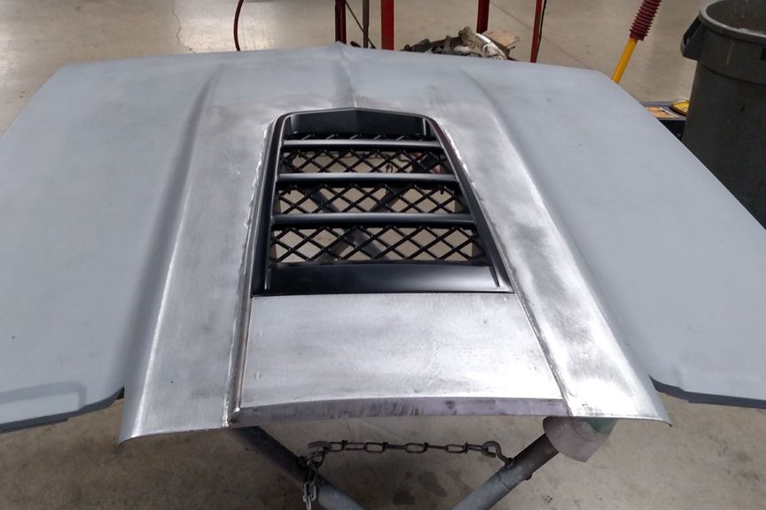

More hood mod pics...
http://i1299.photobucket.com/albums/...ps4og8slo3.jpg
http://i1299.photobucket.com/albums/...psyvbquuft.jpg
http://i1299.photobucket.com/albums/...psjhcvnehr.jpg
http://i1299.photobucket.com/albums/...pscusq3twg.jpg
http://i1299.photobucket.com/albums/...psdcuc4zee.jpg

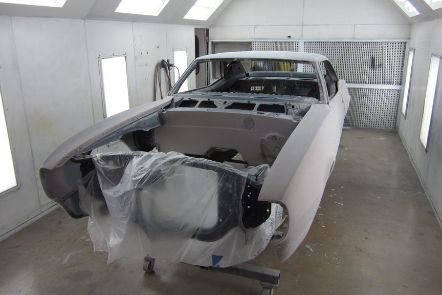

Ben@SpeedTech 01-17-2017 10:30 AM

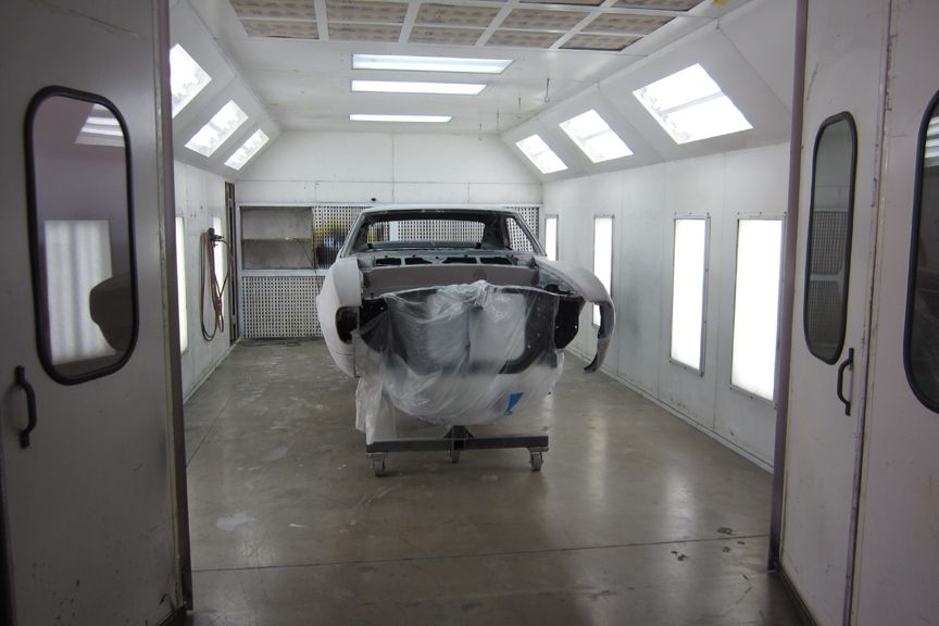

Body worked, Primed and ready to begin the paint process.
http://i1299.photobucket.com/albums/...psu733ahua.jpg
http://i1299.photobucket.com/albums/...pswsgy2z06.jpg
http://i1299.photobucket.com/albums/...psp4gxni7m.jpg

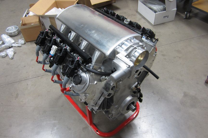

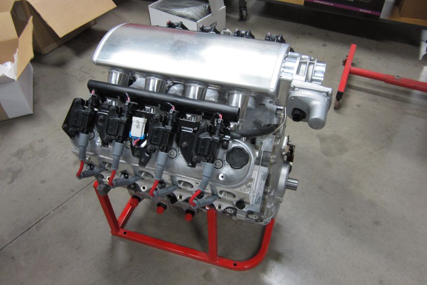

Texas Speed & Performance custom LS3 based engine, made 720 hp @ 7500 on their engine dyno. :RunninDog:
http://i1299.photobucket.com/albums/...psw8airkgw.jpg
http://i1299.photobucket.com/albums/...ps5ejyujkz.jpg

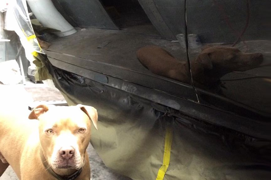

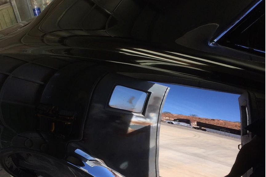

First pics of the paint- (pre cut and buff), along with our "keep yer hands off" guard dog, lol! We like to lay it down in several layers so when we wet sand and buff we have a lot of material to work with to achieve that end mirror finish.
http://i1299.photobucket.com/albums/...psp0fenhzu.jpg
http://i1299.photobucket.com/albums/...psrli45lds.jpg
http://i1299.photobucket.com/albums/...psdllzdg7k.jpg
The right 1/4 after buffing. That reflection is the outside door to our body work booth, and of course our big rig out back.
http://i1299.photobucket.com/albums/...ps75kg72f8.jpg
More coming soon!

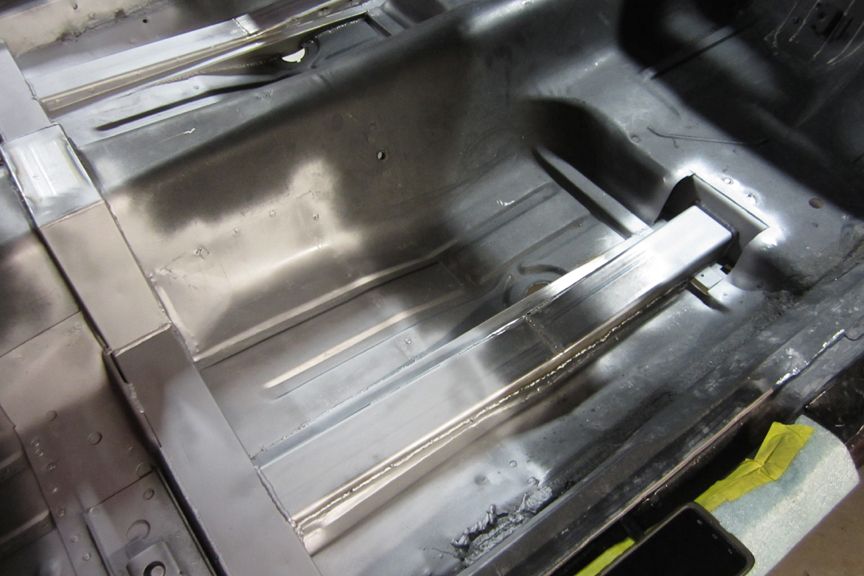

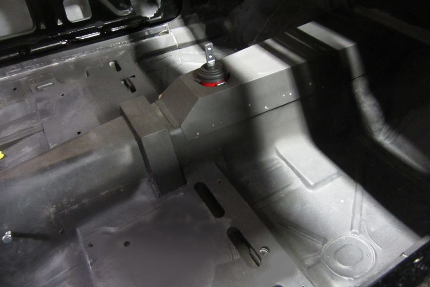

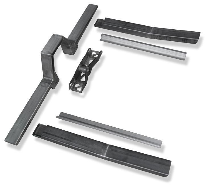

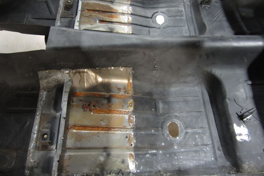

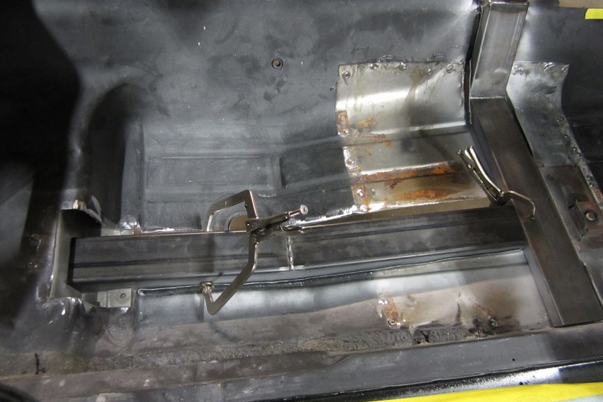

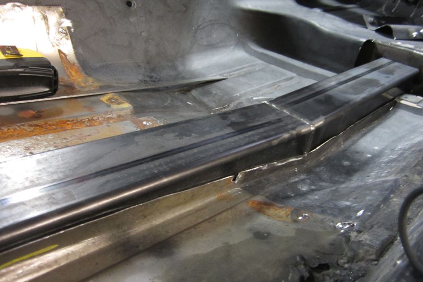

Backing up a little, we'll turn some attention to strengthening the under side of Sicario. First step was to install our new ExtReme crossmember and frame connectors. Superior to other kits these completely weld into the floor and connect the braces for both the front and rear frames, plus they tie into an equally stout crossmember that ties the rockers together. This design not only controls body twist front to back but also strengthens the car side to side. This particular kit is for use with our Torque Arm rear suspension, incorporating a mount for the front TA pin bushing. They do require a little more work than average frame connectors to install, including removing and later replacing the seat mounts plus doing a little surgery to have access to the rear frame bracing structure. In all however, the extra work is definitely worth the additional end result in strengthening the car. Follow along with some pics of the install...
http://i1299.photobucket.com/albums/...pso0i7bl9k.jpg
http://i1299.photobucket.com/albums/...psdl425xdv.jpg
http://i1299.photobucket.com/albums/...pstiy8r2do.jpg
http://i1299.photobucket.com/albums/...psruz1il9q.jpg
http://i1299.photobucket.com/albums/...pse18u09lg.jpg
http://i1299.photobucket.com/albums/...ps4zkthqzr.jpg
