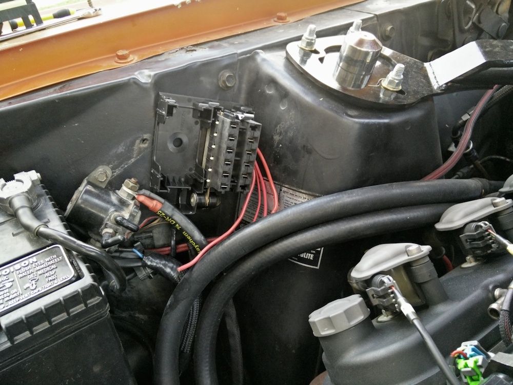

I got my little stash of goodies from Mouser today, so it was time to figure out where to mount my new power distribution box.
Initially I thought I would mount it to the front of the shock tower, something like this:
http://www.pro-touring.com/~andrewb/cougar/713.jpg

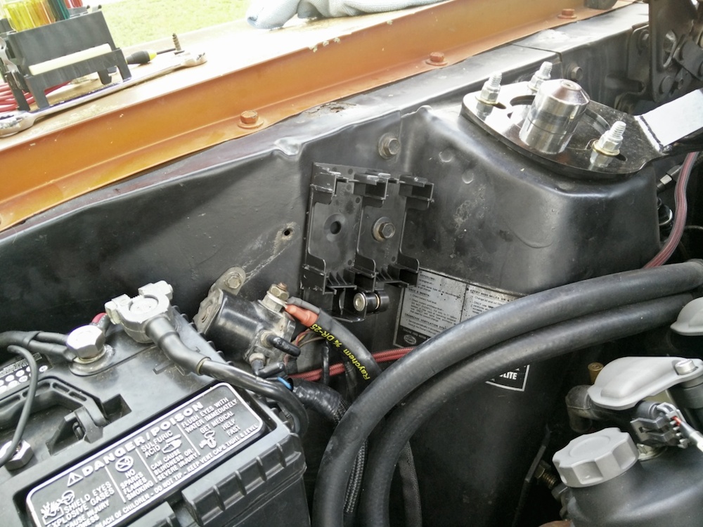

That looked OK but seemed to stick out a little too much and I really didn't want to drill any holes in the shock towers. So I started looking around and I realized that if I moved the starter solenoid a little forward, I will have room between it and the shock tower. Like this...
http://www.pro-touring.com/~andrewb/cougar/714.jpg

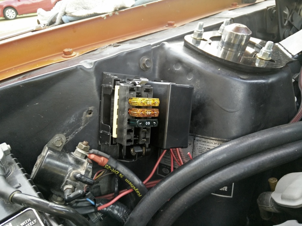

I like that better and I was even able to use one of the existing fasteners for the outside shock tower brace to hold the panel in place. The wires will exit tightly by the shock tower and be loomed along with the other wires that I already have in place.
http://www.pro-touring.com/~andrewb/cougar/715.jpg
The module on the right is functional, while the module on the left is there to hold spare fuses.
http://www.pro-touring.com/~andrewb/cougar/716.jpg
If I need more high draw runs than that, I can always replace the dummy module with one that is functional. I will run a 4 gauge battery cable from the auxiliary post on my battery directly to the bottom post of the power module. I plan to run 5 10 gauge leads from the box to under the dash. This will fix all my current issues and also give me a couple of spare runs for anything else that may need power down the line, like maybe electronic power steering. :-)

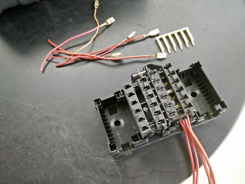

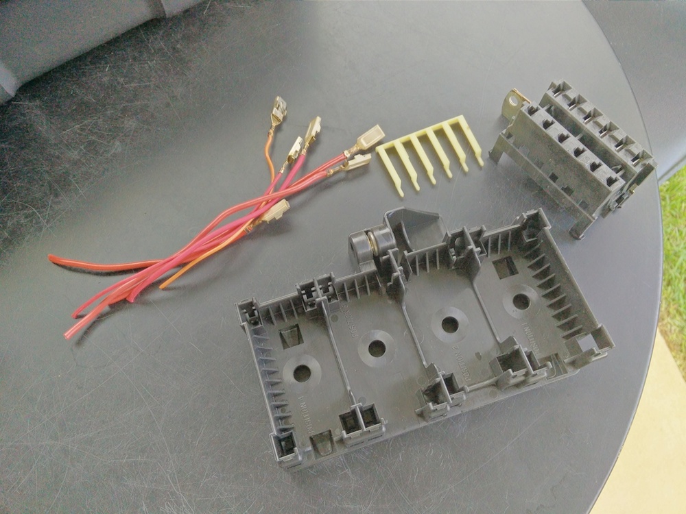

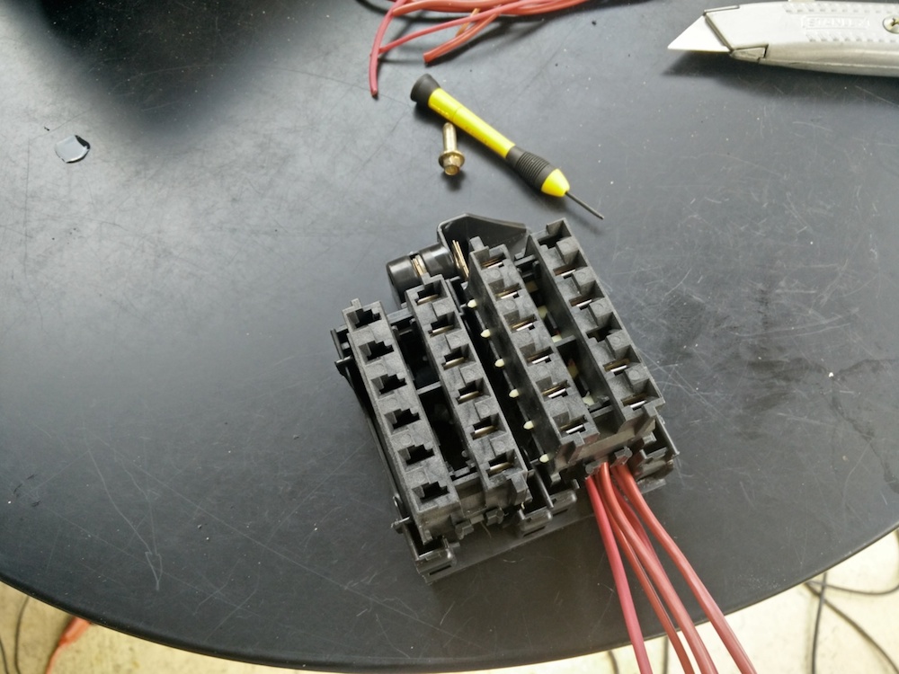

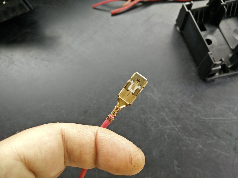

Decided to really clean some of this stuff today and see what I got here. I also downloaded the Delphi catalog (section 7) which really helped with sourcing the various parts that I need. These modules and parts are all available through Mouser.
Here is a 4 position base with the battery post connection.
http://www.pro-touring.com/~andrewb/cougar/708.jpg
The terminals are easily removable and have a secondary retaining clip (the white thing in the above photo). These are Delphi MetriPack 800 terminals and are rated at 60 amps.
http://www.pro-touring.com/~andrewb/cougar/709.jpg
The individual modules just pop in place and are retained by clips to the base.
http://www.pro-touring.com/~andrewb/cougar/710.jpg

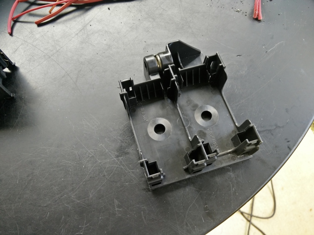

I really don't have room for a 4 position box under the hood, so with a little creative trimming, I have a 2 position base with the battery lug (Delphi doesn't make such a beast).
http://www.pro-touring.com/~andrewb/cougar/711.jpg
Presto...
http://www.pro-touring.com/~andrewb/cougar/712.jpg
In the Delphi catalog they have a 6 Maxi fuse module, but as I said, there is no appropriate base for it. Delphi does make a 8 fuse holder and a single position base with a battery lug, but it's longer than the 6 fuse module, so I like this better.
Andrew
the pn on those modules wouldnt happen to be 12110129 would it?
also, think you could get teh base and cover pn's? Should be on them somewhere.
andrewb70 07-25-2016 07:46 AM
PN 12110129 is the module on the left with the bus bar on the right side. PN 12077569 is the module on the right with the bus bar on the left side.
There are numerous bases available, but as I said before, there is no single module base with the battery lug that accepts the 6 MaxiFuse module. Since there is no single module base, there is no single cover, however, I ordered cover PN 12160897 and it works well.
Andrew
HellPhish89 07-25-2016 03:00 PM
Andrew
i can trim like you did. No bigggy :)
thanks for the info andrew.
andrewb70 07-25-2016 03:12 PM
The 4 module base is PN 12129121....Looks like it's about 18 bucks from Mouser. If you want some of the parts I am not using, shoot me a PM.
