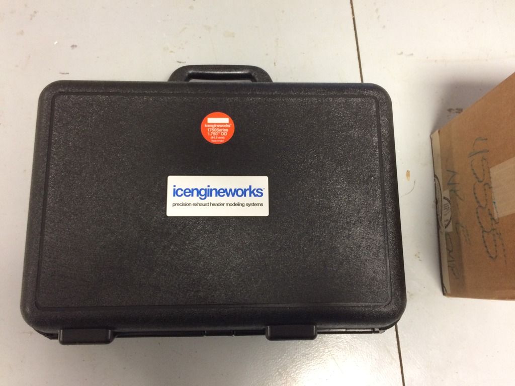

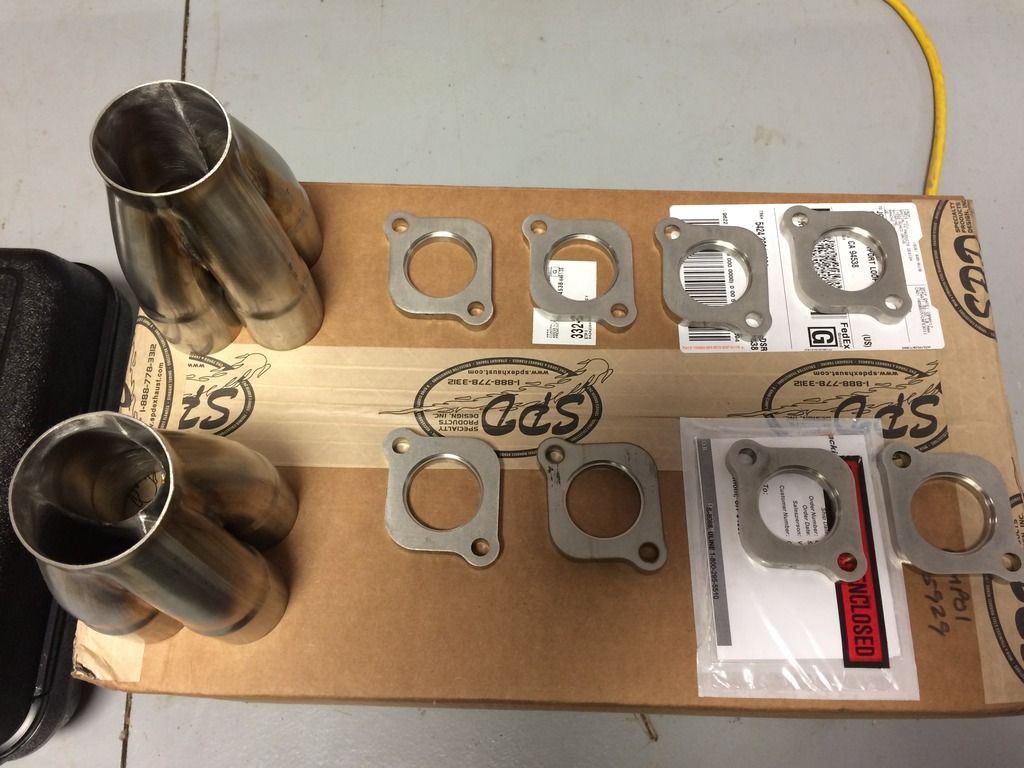

Getting started on the headers. 1.75" primaries to SPD merged collectors.
And this Icengineworks kit is way too cool to work with.
