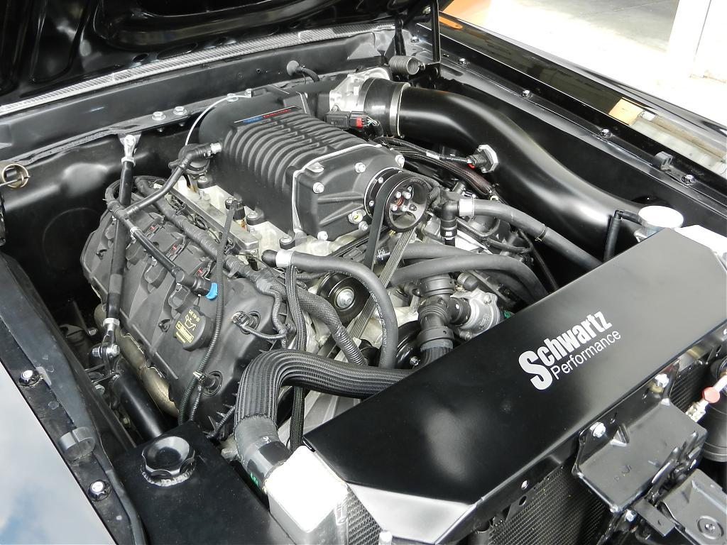

rtwind 03-31-2013 12:15 AM
1 Attachment(s)
I love the coyote that is in my 69 Fastback.
Attachment 38936
