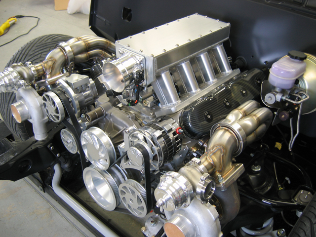

ok, windows are in, many thanks to Frank and Lisa at GP Superstore for the great pricing and service.
http://www.camcojb.com/temp/malitude%20307.jpg
I order a classic update wiring harness from American Autowire (again through Frank!) which will be here Friday. It will be much easier to start from scratch than try to splice all my new systems into the other harness that's currently in the car. So in the mean time, I mounted my BigStuff 3 ecu in the glove box along with the trans controller (switching trans controllers in a couple weeks, but I'll fill you in on that when it happens).
http://www.camcojb.com/temp/malitude%20298.jpg

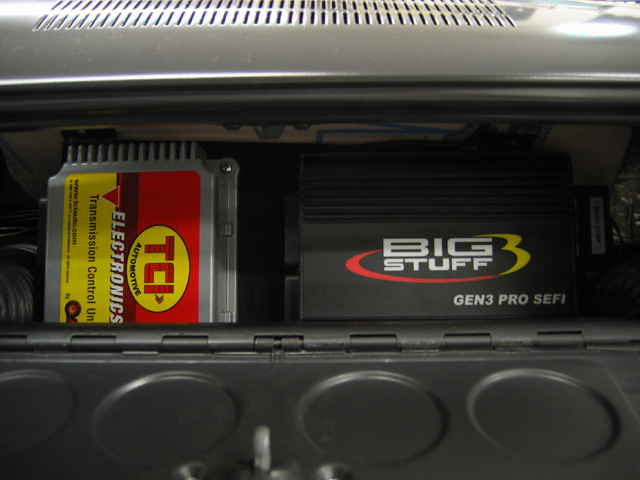

I ran the BS3 harness through the firewall and have cut to length and terminated all the sensors. Am in the process now of trying to hide the wiring as much as is reasonably possible for a clean look.
http://www.camcojb.com/temp/malitude%20309.jpg

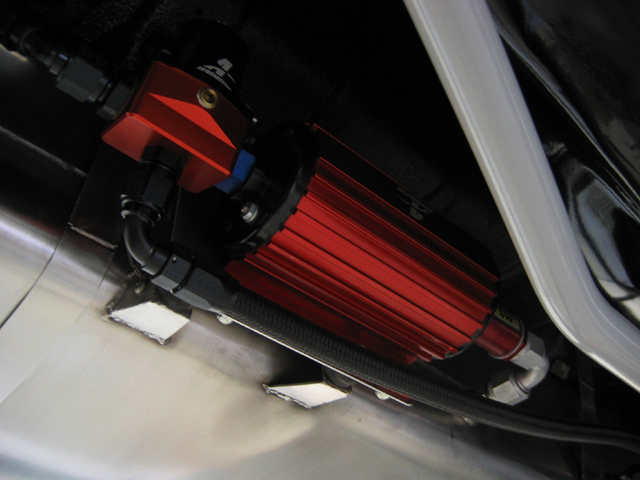

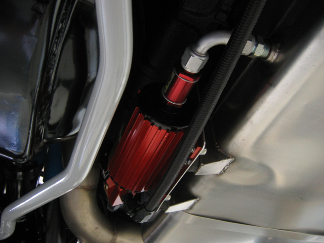

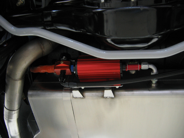

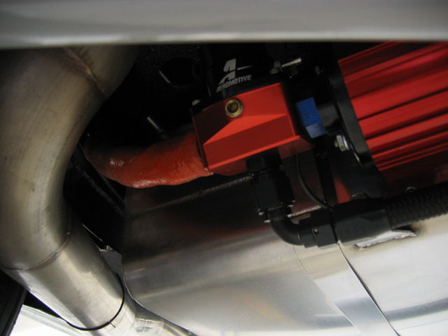

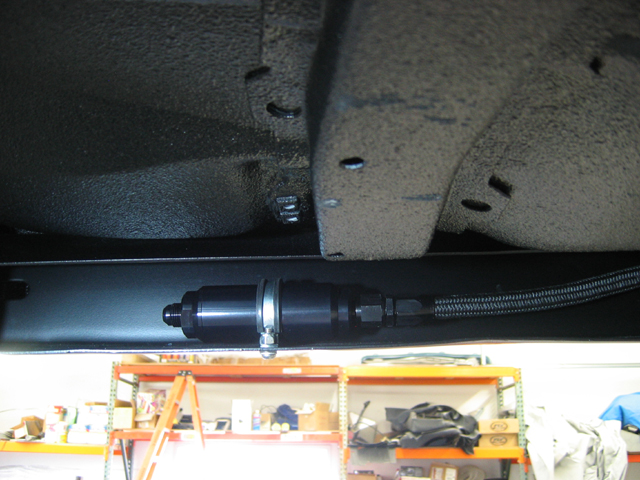

I also ditched the dual Bosch fuel pumps. I love the idea of them, running one all the time with the second coming on with boost, but there's just no way to neatly plumb them in the limited room under the car. No matter how I tried there were too many loops, etc. in the system to fit in the required width I had to work with. So I had a new Aeromotive pump, regulator, and pump controller in my shop, and decided to go this way. I regulate the fuel at the back of the car to keep the hot fuel from being bypassed to the tank. Running the fuel through the rails before being bypassed to the tank has caused many issues on long drives like Power Tour, and being that this car is going this year I do not want any issues. And their pump controller slows the pump down during idle and cruise areas, so that further keeps the fuel temps down, and increases the pump life.
http://www.camcojb.com/temp/malitude%20302.jpg
http://www.camcojb.com/temp/malitude%20303.jpg
camcojb 03-12-2008 03:53 PM
http://www.camcojb.com/temp/malitude%20304.jpg
http://www.camcojb.com/temp/malitude%20305.jpg
http://www.camcojb.com/temp/malitude%20306.jpg

67ragtp 03-12-2008 04:45 PM
Jody,
The car looks awesome!!! The wrap you used around the fuel supply line on the outboard side of the regulator, is it a heat shield and who's is it? Almost looks like huge shrink tubing in the pic, if its heat resistant I could use some, my fuel line runs kind of close to the tail pipe as well. Amazing car- Rich
zbugger 03-12-2008 04:52 PM
Looks great Jody. Do you think you'll be done in time? It looks like it's already pretty close.
camcojb 03-12-2008 05:01 PM
Originally Posted by 67ragtp
Jody,
It's Earls, flame guard is what they call it. Slides over the hose, and pretty much burn-proof.

syborg tt 03-12-2008 08:27 PM
Originally Posted by camcojb
I know there is an awesome thread on this fuel set up your doing.
Can you please add details to this thread.
re: regulator at the tank instead of at the motor.
I've been running the regulator at the tank for several years. Not my idea, actually GM has been doing it for years on cars like the Vette.
The main reason(s) I like it is because it simplifies the fuel lines, only one to run up into the engine compartment. Secondly, it stops the heated fuel from the engine compartment and rails from going back to the tank. Not an issue in around-town driving, but you get out on the road for 200-300 miles and you would be amazed how hot the fuel in the tank gets. The gas is very hot coming back and the fuel level in the tank is dropping, making it even worse. This then causes the pump to cavitate, and eventually you're stuck on the side of the road waiting for stuff to cool off. Ask me how I know............ ;)
Power Tour 05 saw many cars have this issue.

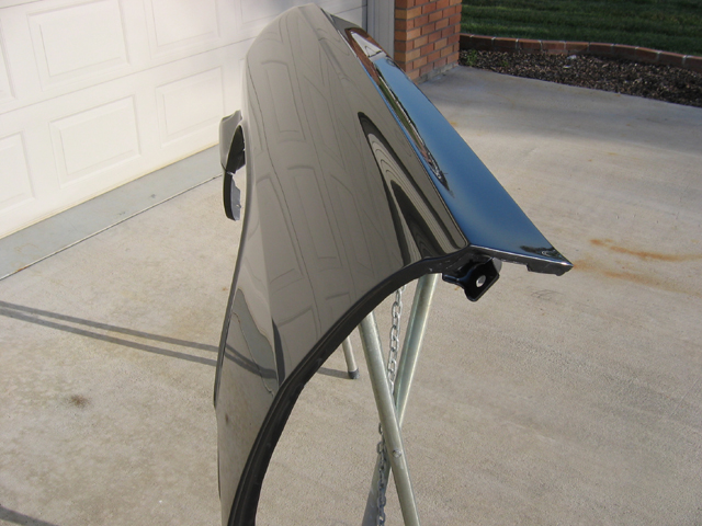

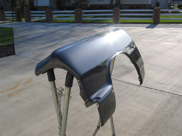

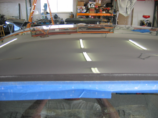

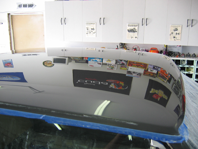

camcojb 03-21-2008 06:02 PM
Well, Jim (the painter) and I are rubbing the paint out. He did the roof last night.
http://www.camcojb.com/temp/malitude%20324.jpg
http://www.camcojb.com/temp/malitude%20325.jpg
http://www.camcojb.com/temp/malitude%20326.jpg
I finalized the front fender a few minutes ago.
http://www.camcojb.com/temp/malitude%20318.jpg
http://www.camcojb.com/temp/malitude%20322.jpg
He's gonna be here in a couple minutes and we'll keep at it.
