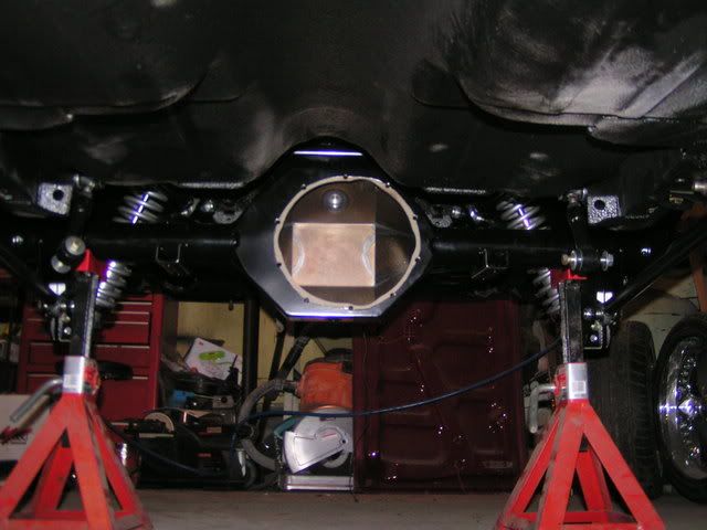

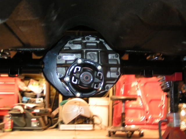

I was able to get the center section of the rear end in today. The one I'm using is a Strange pro nodular case with 3.70 gears. It has a half billet posi unit and I've upgraded to the black aluminum (nodular) pinion support with a 1350 yoke. I know I've gone overkill with this, but better not to have any weak links. I got the Moroso race anodized blue ujoint caps to go along with it.
http://i222.photobucket.com/albums/d.../PICT00344.jpg

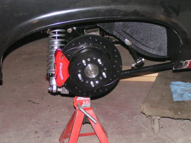

I also got the rear brakes and axles in. I sure like how easy Wilwood makes it to change the brake pads. Pull out a cotter pin and the pads come out. The brakes have a drum brake parking brake. Once I figured out how to install the safety wire with the safety wire pliers, it all went together quite nicely. Tomorrow I hope to get the rear sway bar back in and I'll do some more grinding on the firewall so I can get the subframe back on.
http://i222.photobucket.com/albums/d.../PICT00364.jpg

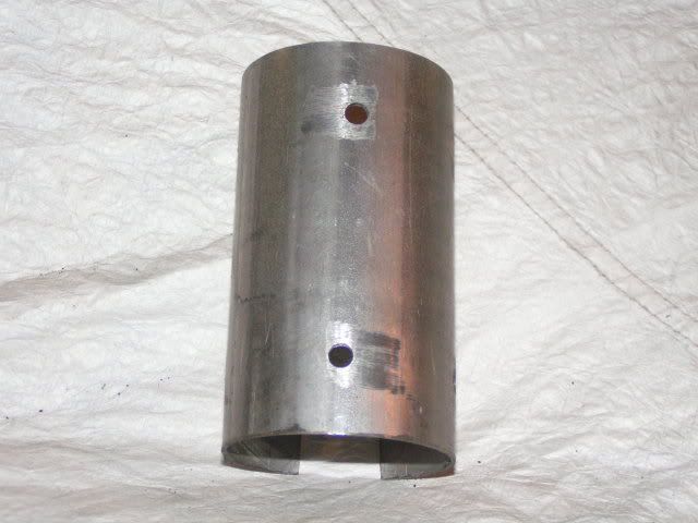

Where the steering column fits
http://i222.photobucket.com/albums/d...columngoes.jpg
Bracket that came in the installation kit that doesn't come close to fitting, oh well now I have a nice piece of billet aluminum to do something with
http://i222.photobucket.com/albums/d...verbracket.jpg

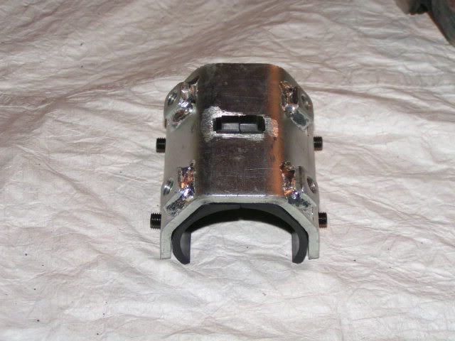

Bracket that I needed off stock steering column. I had to drill out all the plug welds to get it off. With the 69 and up is nice cause they bolt on.
http://i222.photobucket.com/albums/d...ithbracket.jpg
http://i222.photobucket.com/albums/d...toffcolumn.jpg

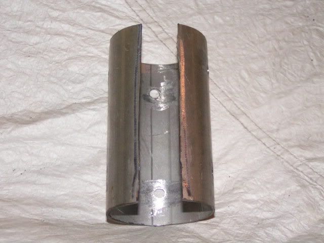

Bracket I got from Flaming River that doesn't work with a 68
http://i222.photobucket.com/albums/d.../PICT00404.jpg

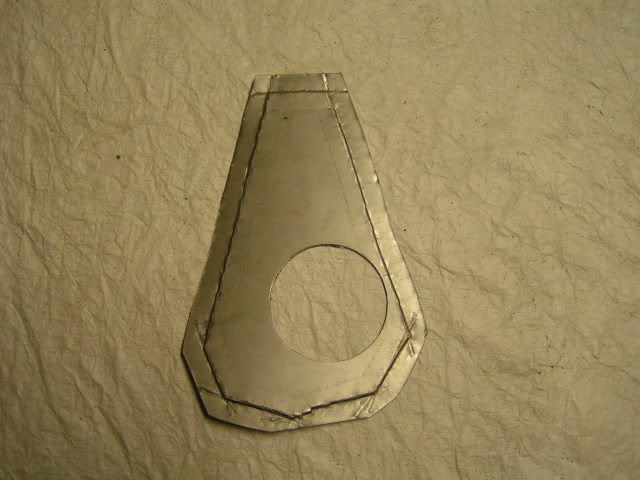

Bracket I made to be welded onto the new column. I'm going to weld one more of these on top of the one already there and it will fit in the stock bracket nicely
http://i222.photobucket.com/albums/d.../PICT00412.jpg
http://i222.photobucket.com/albums/d.../PICT00423.jpg

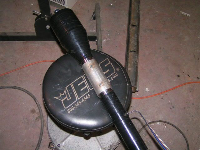

On the column (it's a polished stainless steel column, I just have electrical tape on it to protect it)
http://i222.photobucket.com/albums/d.../PICT00444.jpg

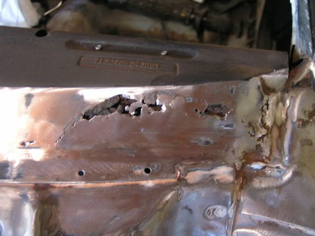

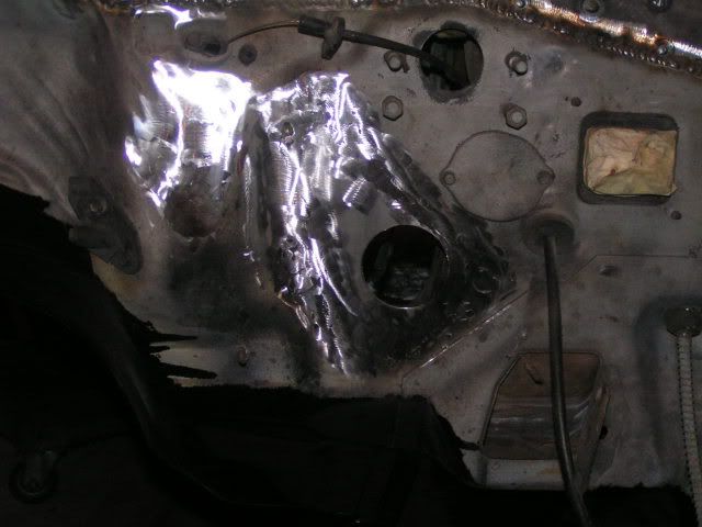

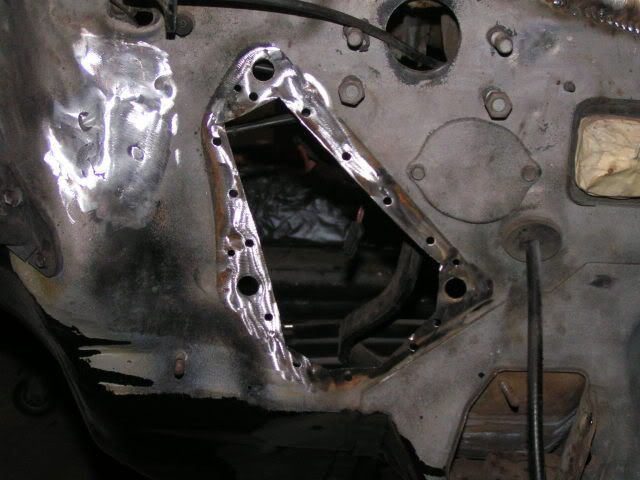

Area of the firewall I wanted smoothed
http://i222.photobucket.com/albums/d.../PICT00206.jpg
Out with the old
http://i222.photobucket.com/albums/d.../PICT00464.jpg
And in with the new
http://i222.photobucket.com/albums/d.../PICT00453.jpg

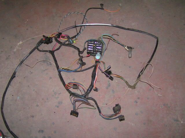

Well time for another update. Not a whole lot done, but it's getting there. The other day I was feeling a little destructive so I ripped out the rest of the dash. It really ticked me off, once I had the gauge cluster out, I put it on top of a cabinet for safe keeping. When I went into the shop this morning, everything that was on top of the cabinet was lying on the floor, including the gauge cluster. Unfortunately it has 3 big cracks in it and the radio area broke right off. As most of you know, the 68 gauge cluster is rare as it is one year only. I was thinking about getting a Covan's, I guess I'm committed to that now. Here's some pics:
http://i222.photobucket.com/albums/d.../PICT00615.jpg
Wiring harness out

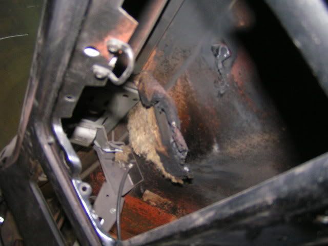

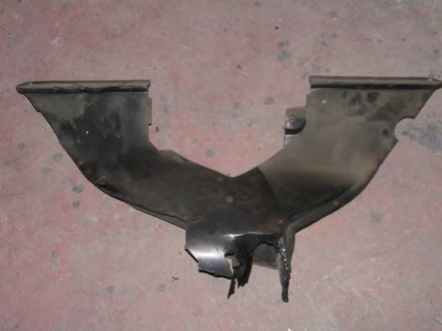

If you've read the rest of my thread, you'll know that I had a little fire when I was welding the firewall. Here's the inside of the dash where the fire was
http://i222.photobucket.com/albums/d.../PICT00683.jpg
What ended up on fire....my defrost ducting. Guess I need to find a new one of those now too

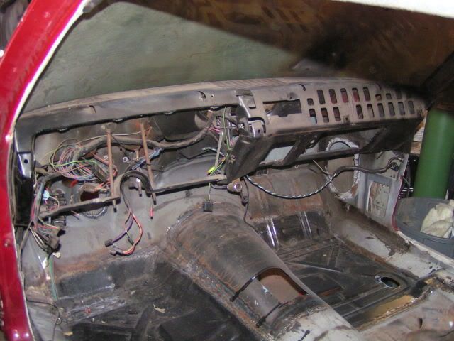

As I was taking the dash apart, I found this. Add this to the list of strange things found in a car
http://i222.photobucket.com/albums/d.../PICT00743.jpg

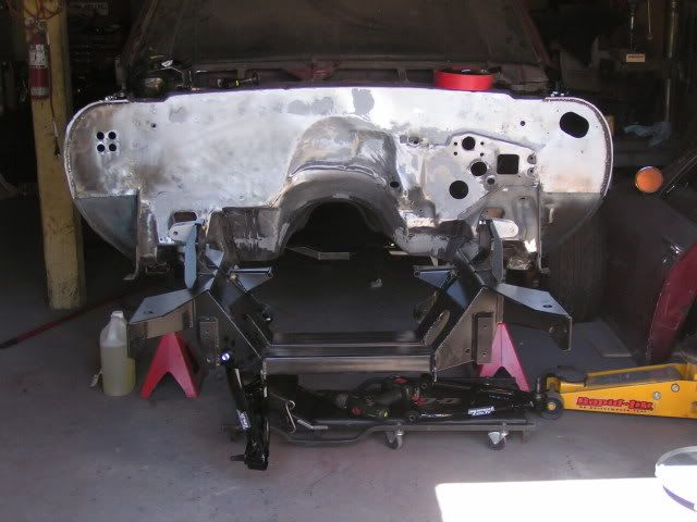

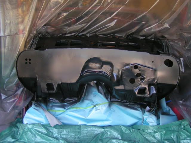

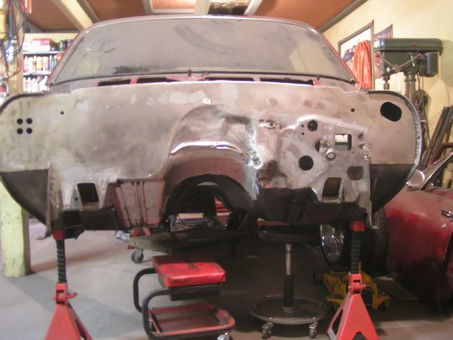

I did some more work on the firewall and since I used sheet metal that I had laying around, it had some surface rust on it. I found some of these 3M pads that fit into a die grinder backing plate and they work great for taking off surface rust, paint and even POR15. They are not cheap, but well worth the money.
http://i222.photobucket.com/albums/d.../PICT00554.jpg
Here's how the firewall's looking. I'm getting almost to the point of putting primer on it, but then I got thinking. I want to put in a Vintage Air kit and I don't want to weld studs on the back of my firewall and ruin the primer/paint so will be ordering a kit from Frank at www.gpsuperstore.com and get it mocked up before I spray any primer. I've also decided to paint the firewall the same color as the car. I think I've decided on Viper Red for the car. It still needs work, but here's where I'm at:
http://i222.photobucket.com/albums/d.../PICT00703.jpg
Area around steering column
http://i222.photobucket.com/albums/d.../PICT00732.jpg

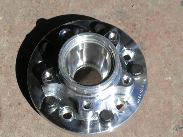

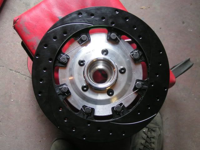

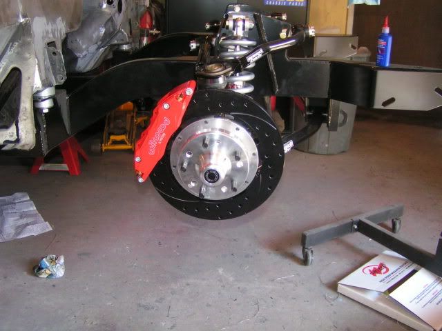

I finally got going on the front brakes. Not without issue though. I started putting them on last week when I found that Wilwood sent me too many of the bolts that attach the hub to the rotor and none of the bolts to attach the rotor to the adapter plate. I called them and after spending a few minutes convincing him that I knew what I was talking about, he agreed to send me the bolts. They were to me in Canada in about 4 days. Very impressed. So now that I had the bolts I was able to start attaching every thing. When I got to putting the entire hub assembly on I realized that when I bought new spindles, I never bothered to get new spindle nuts. Thankfully I called one of the local GM places and they were able to over night it. I went and got the nuts this morning and was able to get the passenger side finished. Here's some pics.
Rotor with adapter plate on and showing the safety wire. At this point I still needed to run safety wire around the bolts holding the hub on.
http://i222.photobucket.com/albums/d...ackofrotor.jpg
The aluminum hub. Very nice piece of work.
http://i222.photobucket.com/albums/d...herp69/hub.jpg
The brakes are on :D
http://i222.photobucket.com/albums/d...p69/brakes.jpg
Close up
http://i222.photobucket.com/albums/d...kescloseup.jpg

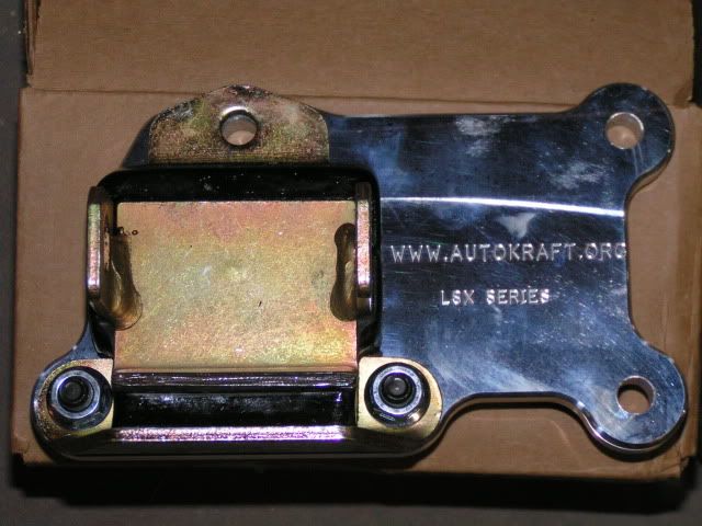

I already bought the Autokraft oil pan and motor mounts. For some reason though the motor mounts were in the package. Need to make a phone call this morning. Amazing work though on this oil pan.
http://i222.photobucket.com/albums/d.../PICT00335.jpg
http://i222.photobucket.com/albums/d.../PICT00347.jpg

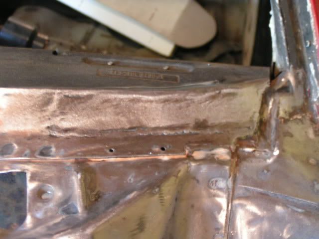

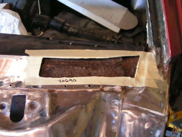

I posted this in the Body section also, but since this is my thread, I thought I'd post it here also. I know there are lots of great fabricators and body guys on this site, none of which would ever need any advice from a guy like me, but I thought I would share a tip a discovered today,all because I was lazy the other day.
This is for anyone who had a hole in a panel that they needed to fill in with more sheet metal. I'm sure a lot of us have sat there cutting and testing, cutting and testing until finally the filler piece is the right size. Sometimes it may take several attempts, but eventually we make it. Today I was doing some more work on smoothing my firewall now that I now I will be using a drive by wire throttle. I cut out the area I wanted to smooth and started looking at the hole I had to fill trying to figure out the best way to make a template. I happened to look over on the floor and saw a roll of masking tape that I was too lazy to pick up the other day and it gave me this idea.
I thought of taking pics after I had the tape on, but you'll get the point.
The area I wanted to fill in was the pedal holes to the left of the steering column hole.
http://i222.photobucket.com/albums/d.../PICT00424.jpg
Once you have the hole cut, cover the entire hole with masking tape.
http://i222.photobucket.com/albums/d.../PICT00445.jpg
I used an exacto knife to cut along the sides of the hole
http://i222.photobucket.com/albums/d.../PICT00454.jpg
I then stuck the newly cut piece of tape to some sheet metal giving me my template
http://i222.photobucket.com/albums/d.../PICT00465.jpg
If you cut it along the side of the tape, it will be the about the same size of the hole. Since I wanted to butt weld it, I cut a little smaller than the tape
http://i222.photobucket.com/albums/d.../PICT00474.jpg
Take the tape off and you have your patch
http://i222.photobucket.com/albums/d.../PICT00484.jpg
Tack it into place. The nice thing about trimming a bit smaller than the tape was it left me nice gap to fill in with weld
http://i222.photobucket.com/albums/d.../PICT00493.jpg
Finish your welding
http://i222.photobucket.com/albums/d.../PICT00503.jpg

I'm also going to smooth out the two mounting holes for the emergency brake. I'm going to fab something up to mount the new Lokar unit when I get it. I had smoothed it out, but forgot to take my camera back to the shop with me so will post pics later.
These will be filled in
http://i222.photobucket.com/albums/d.../PICT00523.jpg

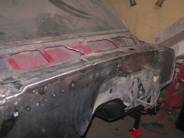

When I was stripping the windshield channel, I found some rust
http://i222.photobucket.com/albums/d.../PICT00348.jpg
Out with the rust
http://i222.photobucket.com/albums/d.../PICT00356.jpg
In with the new
http://i222.photobucket.com/albums/d.../PICT00435.jpg

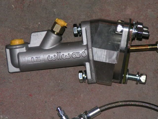

Other than that, I've just been getting the firewall ready for primer and paint. But did get new stuff
Autokraft motor mounts
http://i222.photobucket.com/albums/d.../PICT00485.jpg
http://i222.photobucket.com/albums/d.../PICT00494.jpg

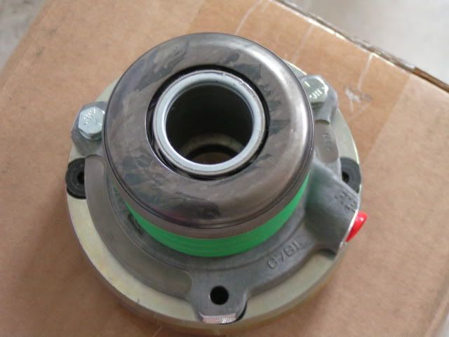

Keisler hydraulic actuator kit. I went with this kit as I don't have to modify the firewall to mount the master
http://i222.photobucket.com/albums/d.../PICT00504.jpg
http://i222.photobucket.com/albums/d...9/PICT0107.jpg
http://i222.photobucket.com/albums/d.../PICT00516.jpg

So I finally got some primer on the firewall. I did it in black to see how my body work would look and was told it would make a good base under red. Guess I need to do a bit more on it before I lay the paint. Thankfully I'm not painting the car black and the red paint should hide some of the blemishes. I also need to fix the orange peel look to it. Anyone have any suggestions. To be honest I'm a complete idiot when it comes to body work, especially using the spray guns so any advice would be great. I'm using these guns from DiVilbiss: http://www.eastwood.com/paint-equipm...ng-system.html
Here's a pic:
http://i222.photobucket.com/albums/d...9/PICT0108.jpg
