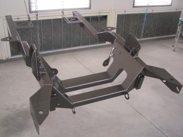

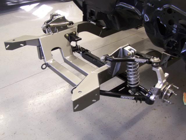

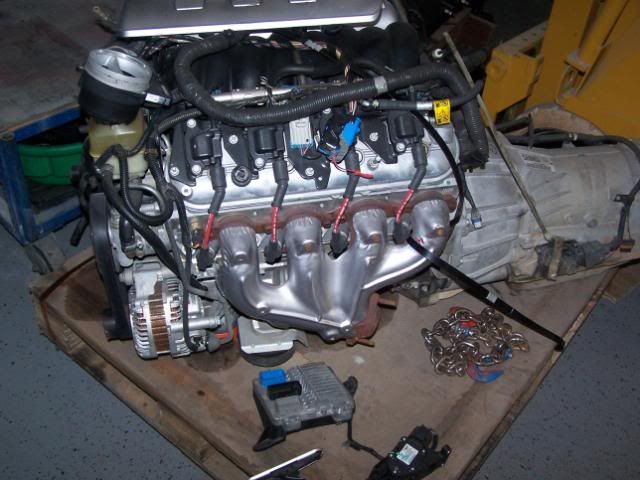

Here is the update:
I have the engine...06' GTO LS2
I will have to get accessory drive kit for it to clear frame.
Also, frame painted and back on car with suspension installed waiting engine.
http://i267.photobucket.com/albums/i...irebird8-1.jpg
http://i267.photobucket.com/albums/i...firebird10.jpg
http://i267.photobucket.com/albums/i...rebird12-1.jpg
http://i267.photobucket.com/albums/i...firebird17.jpg

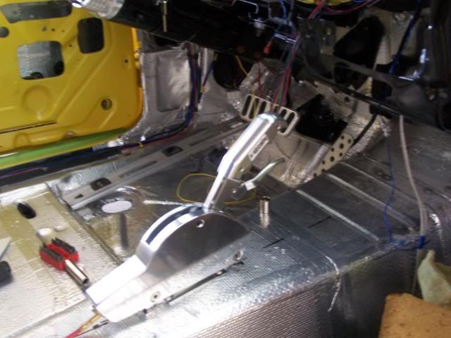

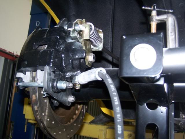

Inside in all dynomatted, power window regulators in, wired up door and trunk poppers. Bulkhead for a/c fitted, starting the brake and engine details.
We are using a hydra booster from astrovan for power. All stock calipers for the front: corvette, back 85 cady. Lines are all polished stainless.
Here are the pics.

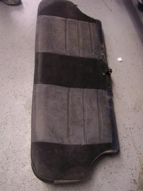

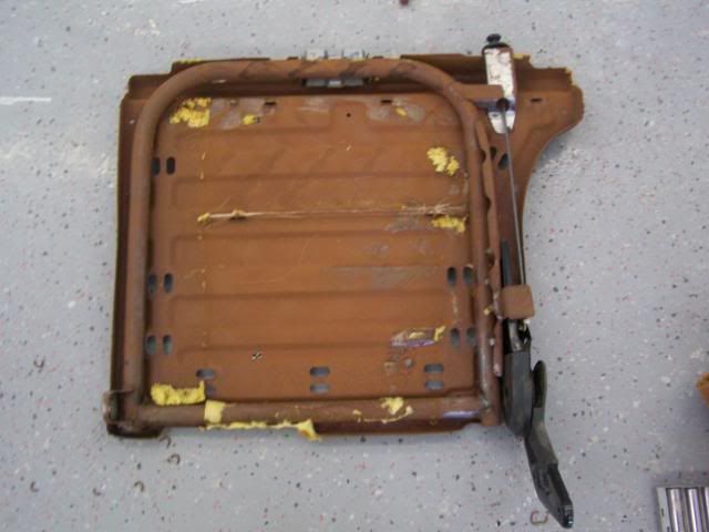

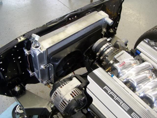

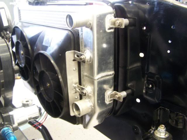

some updates: We got our radiator, had to mod it a bit to mount and work with what we have, Also not pictured, we modified the gas tank.

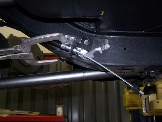

We installed the parking brake cable, modified the mounts on the frame so we can use all stock parts and they work with the cady calipers.

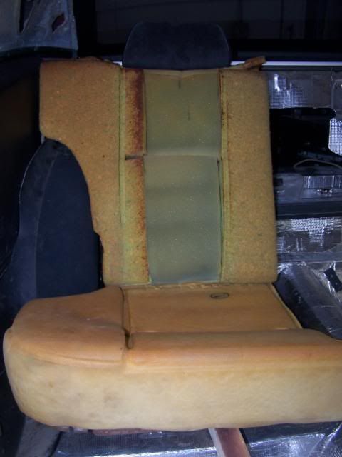

Also, I started on the interior...the seats are out of a 2001 camaro. Funny thing was the rear seat wasn't working out the way I hoped cause of the detroit speed 4 link bar mounts, I was planning on using the bottoms of the 01 camaro but they are just foam...anyway, my brother was turning his junker in for scrap and I had a last minute thought to check his back seat. Crazy thing that this 87 honda civic could have almost the exact measurement across the rear seat as the Firebird....like an inch shorter, 1/2 inch on each side, actually perfect..and the height sitting on the link pockets was perfect with the back tray....Also since I have to move the seat forward to clear the 4 link pockets I grabbed the wheel well covers out of the honda and cut the part I needed out. We cut the seat in half and shortened each half by 5 inches to make two seats with room for a waterfall console in the middle, we can use the foam, just cut the middle out and they both fold down leaving room behind for our amps to mount. I also really like the look of the headrests. anyway the pics tell the story.

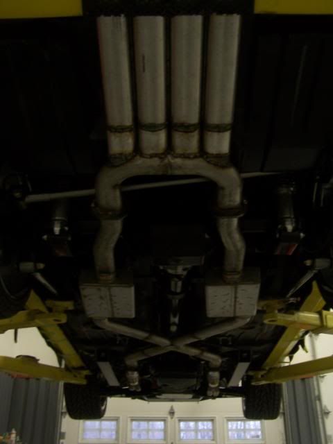

Small update for now, just finished the tail pipe section, it will get black ceramic powder coat like the headers.... we used oval pipe with x-pipe and spintech mufflers. we cut out the gas tank for the pipes to go where I wanted them to...crazy its been like 5 years since I designed this part in my head and it turned out just the way I wanted it to. I have to clean up the welds but you actually won't see them. I am making a two piece heat shield out of aluminum that goes up between the tank and pipes and then under with a nice water jet finish piece with a vented look that will be an extra detail for the rear view of the car. The heat shield and the ceramic coat should keep the exhaust pretty cool to the tank. Also only the middle two pipes are actually functioning as tail pipes, I welded nice curved baffles in right where they attach to keep them seperated and the flow smooth. That way the outside pipes won't blacken the yellow too much.
