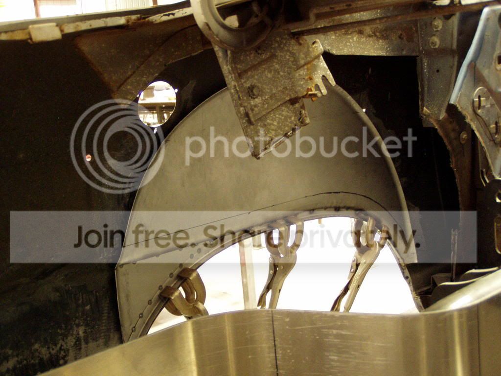

HWY Nova 10-21-2008 12:51 PM
Tubs......
The tubs are taking shape!
Here are a few shots of a tub on the bench being fabbed:
http://i338.photobucket.com/albums/n...ynova/3003.jpg
http://i338.photobucket.com/albums/n...ynova/3004.jpg
Here are a few shots of one of the tubs being fitted in the car:
http://i338.photobucket.com/albums/n...ynova/3011.jpg
http://i338.photobucket.com/albums/n...ynova/3014.jpg
The original contertible top mounting points were kept intact during this stage.
--Eric
wiedemab 10-21-2008 01:02 PM
I'd love to see some more pics of the fabrication of the wheel tubs if you have any. Those are very nice. I'd like to see where the weld seams are etc. You can barely tell that's for sure.
HWY Nova 10-21-2008 01:59 PM
I'll see if Rodger at IRONWORKS has any of the fab photos...... If so, we'll post them.
Wait till you see the trunk shots. I'll post them soon.
--Eric

HWY Nova 10-24-2008 03:18 PM
There has been interest on the fabrication of the tubs, so here is another photo.
This photo shows where the weld seam is from the inside:
http://i338.photobucket.com/albums/n...ynova/3002.jpg
--Eric

HWY Nova 10-29-2008 10:11 AM
Tub-fabrication Photo
I found an early tub-fabrication photo for you:
http://i338.photobucket.com/albums/n...a/P1010098.jpg
--Eric

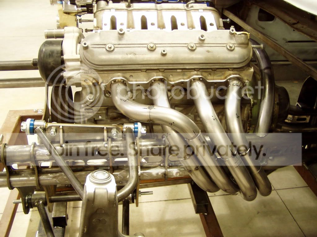

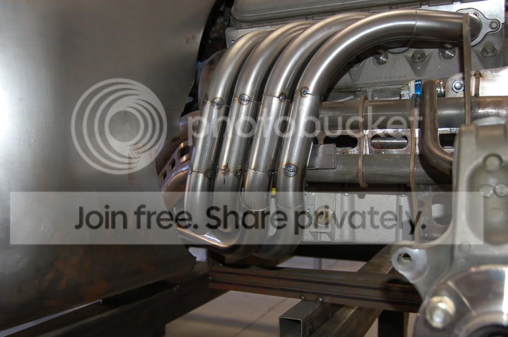

HWY Nova 11-21-2008 09:01 AM
New Headers.............
This first photo is of the original headers Ironworks made for the Nova.
http://i338.photobucket.com/albums/n...9-13-08001.jpg
They looked great....... but I had to open my mouth and say "What if.......". My "what if" ended up being: What if the four tubes were all at the same angle, and all in a row..... How would that look?
Well, IRONWORKS, being the masters of fabrication, literally created another set of headers based on my (minimal) input.
I just love how Rodger and I connect on things!.... and how his crew can execute ideas into reality.
So here is a series of photos showing the construction of the new headers:
http://i338.photobucket.com/albums/n...hoppics002.jpg
http://i338.photobucket.com/albums/n...hoppics003.jpg
http://i338.photobucket.com/albums/n...hoppics001.jpg
--Eric

HWY Nova 11-21-2008 09:31 AM
Right Side.........
I'll post the right-side header photos soon!
--Eric

HWY Nova 11-21-2008 01:57 PM
The Other-side...................
Here are a few photos of the right-side headers:
http://i338.photobucket.com/albums/n...hoppics004.jpg
http://i338.photobucket.com/albums/n...hoppics006.jpg
http://i338.photobucket.com/albums/n...hoppics005.jpg
--Eric

brian mc 11-22-2008 07:08 AM
WOW....those are too sick, great idea Eric. looks alot more organized with the bends all the same angles.
Brian
G-Body 11-22-2008 07:14 AM
Beautiful Bends and sexy curves That thing should flow reallll well.:cool:
rich-allen 11-22-2008 08:16 AM
Holy Crap those pipes are badd ass!
What size tubes are those?
