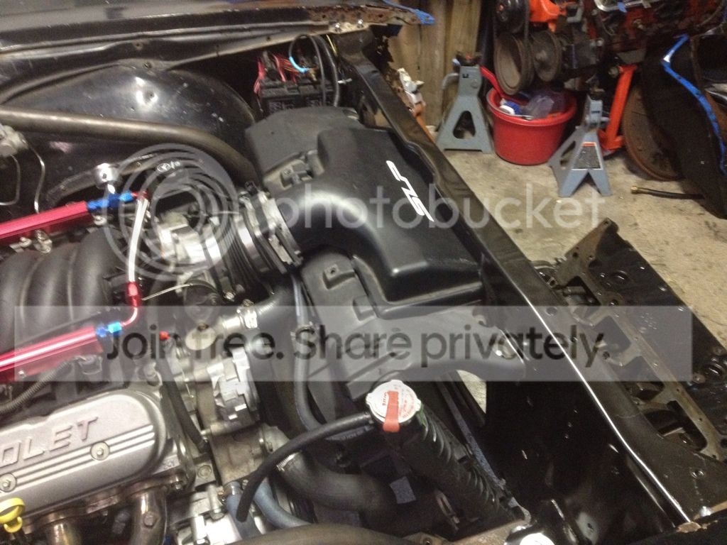

radiator mounting and air box
Originally Posted by Beach Cruiser (Post 452268)
got some new sheetmetal yesterday to try and get the radiator support figured out. More parts on the way from the brown truck Santa, but heres the start of the Christmas break rush.
Who knew? buying a part for an American car, that was built in Asia would take some American engineering to make American made parts to fit it into an American car?
http://i539.photobucket.com/albums/f...77B2E7145A.jpg
Installed and ready to mock up the intake ducting,
http://i539.photobucket.com/albums/f...255E1D9037.jpg
picked up a radiator support from the junkyard that I think might work, it's from a 6 cyl Camaro.
http://i539.photobucket.com/albums/f...77BFB191CB.jpg
Raditor support with my SLP lid installed, getting closer. I need to drop the Radiator about an Inch to make it perfect but I'm getting closer!
http://i539.photobucket.com/albums/f...77C70FA6ED.jpg
I'm wrestling with the same set up for my intake set up for my 69. I had resigned myself to mounting the 4th Gen F-body LS1 radiator without using the SLP air box, however if you have an elegant solution, I'd consider using it.
When I was planning to somehow make the 1st gen/4th gen work, I was going to cut the lower radiator cradle sheet metal out of the 4th gen, and attach it to the 1st gen, then rework the sheet metal on the upper core support to mount the lower air box and make it work with the radiator canted. Hope that makes sense, after thinking about it, I just figured it was a ton of work and unnecessary extra weight, so I decided to take another route.
Current plan is to mount the radiator with no angle, and mount it flush against the 1st gen core support. I have aluminum brackets and will hold the radiator at the 4 points where the core/tank seams meet. Unfortunately that means I have to ditch the SLP air box set up, and buy something else.

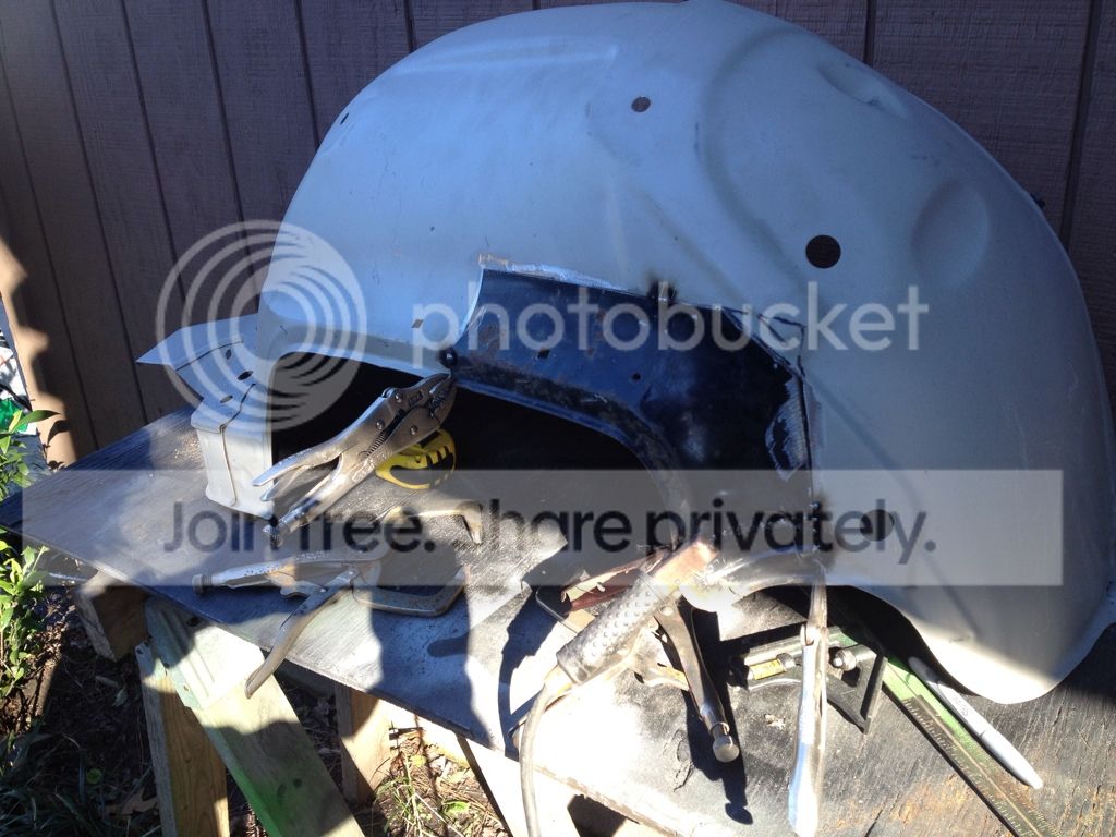

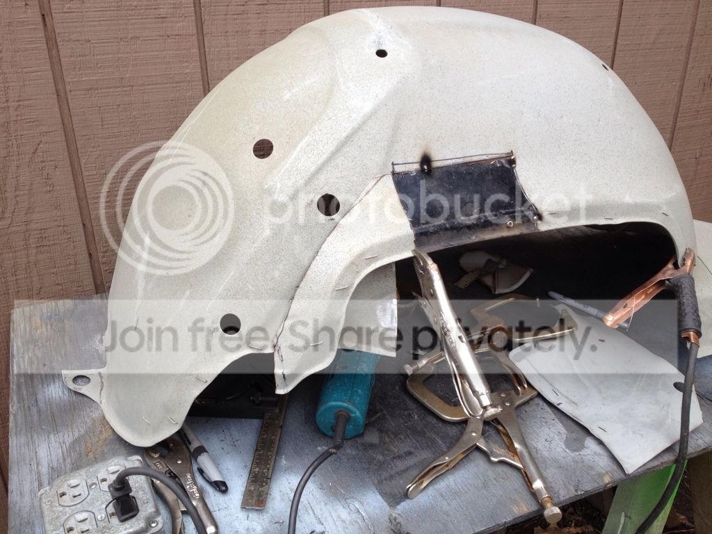

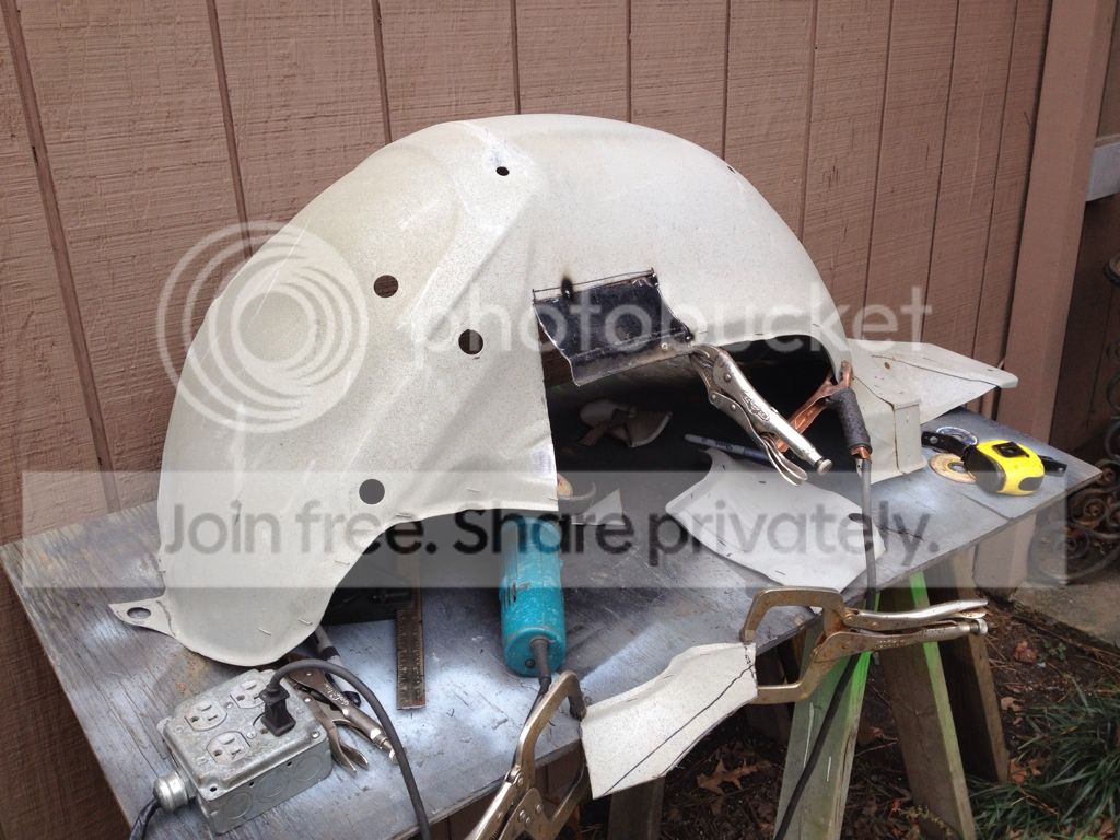

ok since it's nice outside, I decided to switch gears and work on some sheet metal to get ready for the new front sheet metal to arrive, also have the day off tomorrow to finish up some of this stuff. I also spent the weekend fixing stuff that was already broken on a car I have yet to drive other than around the block! Water pump replaced, check. Rear seal on the transmission replaced, check. Removed Driver side head to get the flange milled to get rid of massive header leak, Check. Exhaust all mocked up and built, check.
Here's some pics of the sheetmetal work today. I had to enlarge the inner fender openings to clear the corvette a arms with the new frame design. Tomorrow, I'll do the other side.

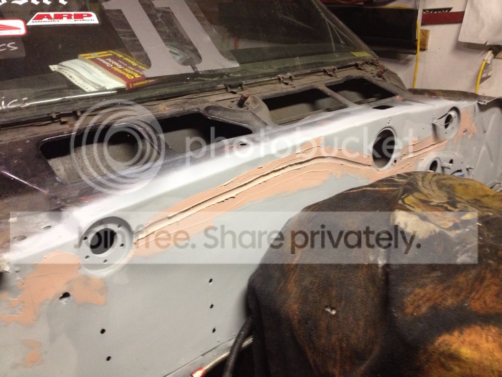

Since I had the fender off, I decided to finish up the mocked up front downbars and get it ready for the new front sheet metal.
http://i539.photobucket.com/albums/f...9685642CE0.jpg
after some welding time and more grinding time this is where I ended up.
http://i539.photobucket.com/albums/f...A31A1AC594.jpg

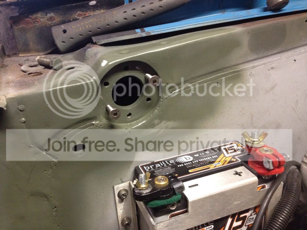

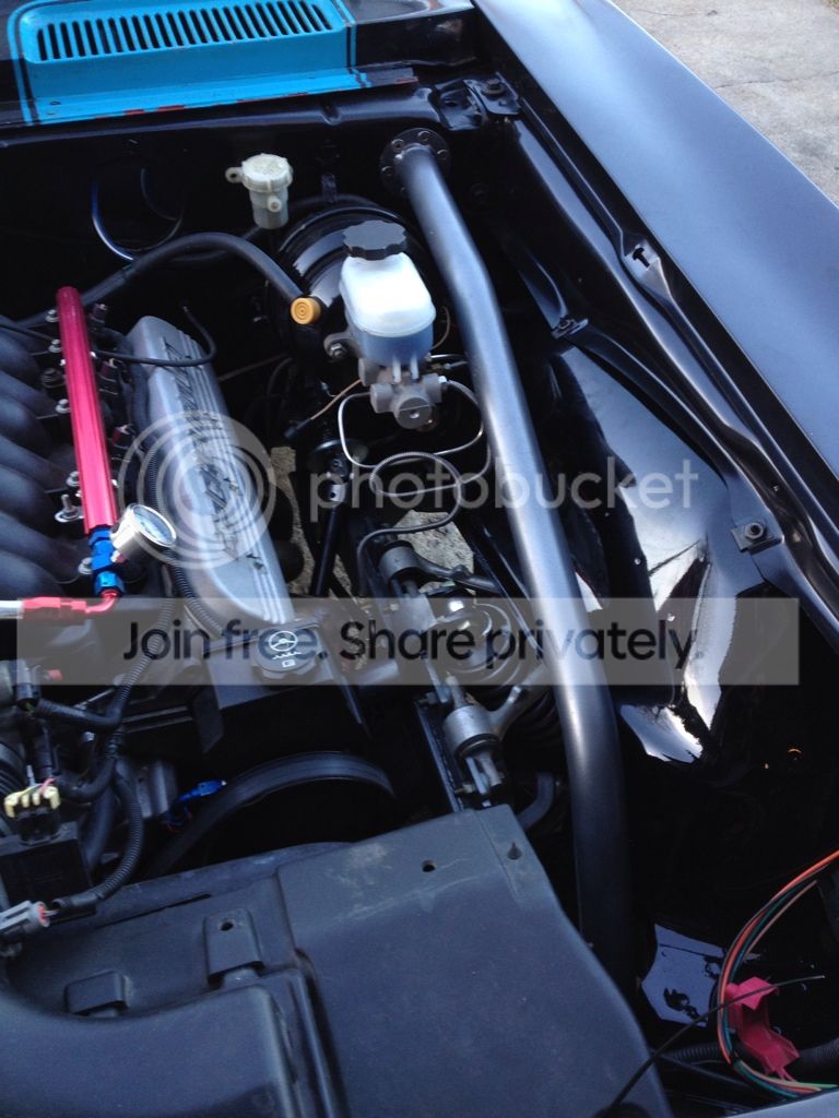

Beach Cruiser 01-28-2013 06:40 AM
It Ain't perfect, but it's good enough for now till I pull the front clip next winter. Cleaned up the frame too, gonna shoot some rattle can paint on it and call it a day. Also added some brake ducts in the frame that will use the frame rails for the ducting from the front end. Way more work than what it looks like in the pictures!
http://i539.photobucket.com/albums/f...A3DCA28E1D.jpg
http://i539.photobucket.com/albums/f...C820296D82.jpg
http://i539.photobucket.com/albums/f...C823EEB323.jpg
http://i539.photobucket.com/albums/f...A3D5FF055D.jpg
Track Junky 01-28-2013 06:54 AM
Hey, does Braille sell that mount or did you make it?
WSSix 01-28-2013 06:59 AM
Coming along nicely! Good luck getting it ready for spring.
Beach Cruiser 01-28-2013 07:05 AM
Braille sells it, they have a mount to fit each size of thier Batterys. So far this little batt has been good, lots of cold cranking on it and it's never waivered.
Track Junky 01-28-2013 07:09 AM
Cool, thanks......hope it lasts trying to crank 14:1.

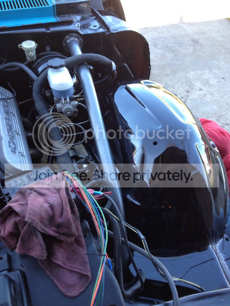

Todays progress, a little rattle can paint goes a long way!

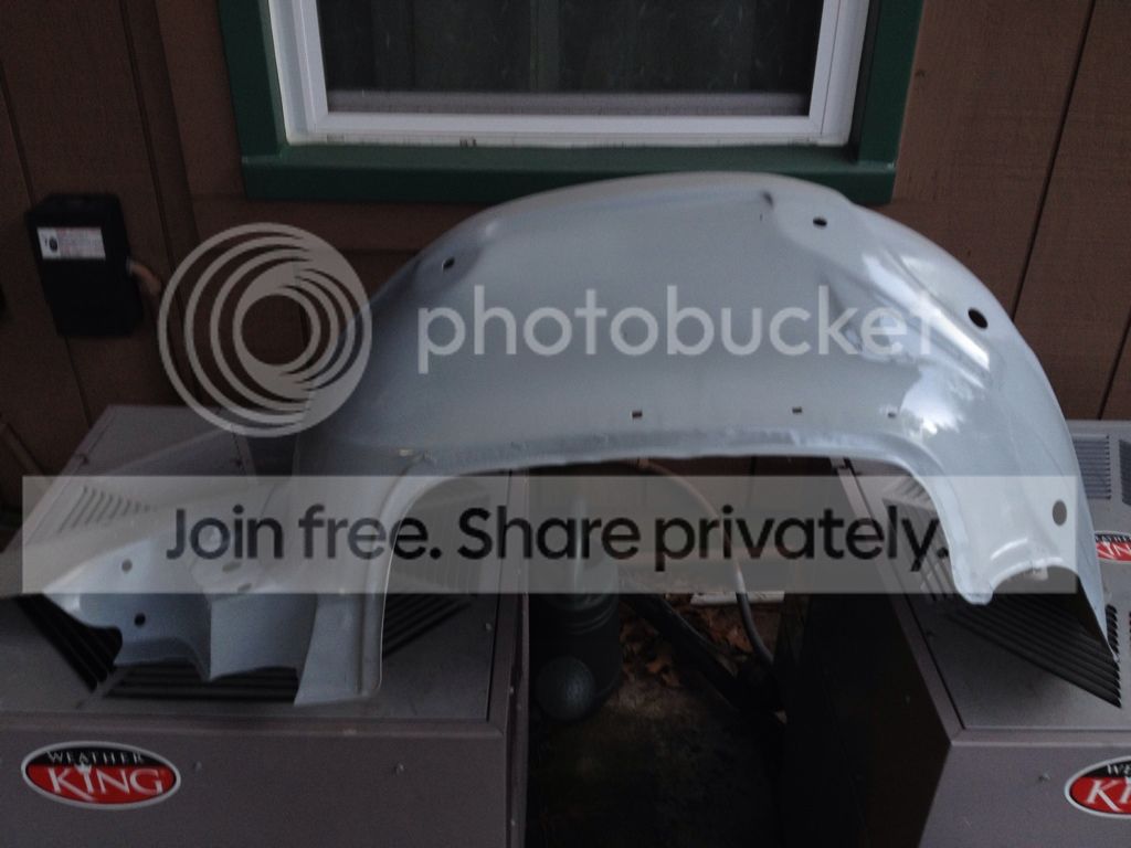

finished up the other inner fender over the weekend
http://i539.photobucket.com/albums/f...ps48c0d8f1.jpg
http://i539.photobucket.com/albums/f...psbba803ed.jpg
http://i539.photobucket.com/albums/f...ps84cccdcb.jpg

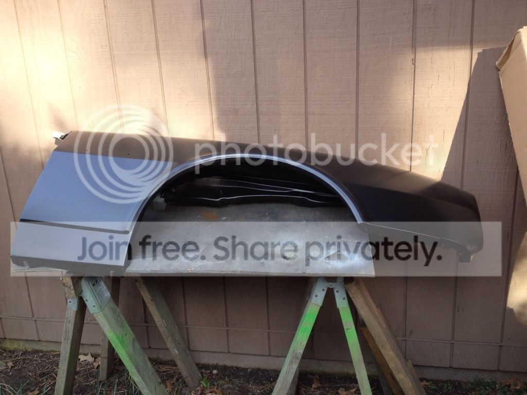

Picked up the new sheet metal today! SO nice to be able to bolt on something that I don't need to sand/fix/make/alter ect...

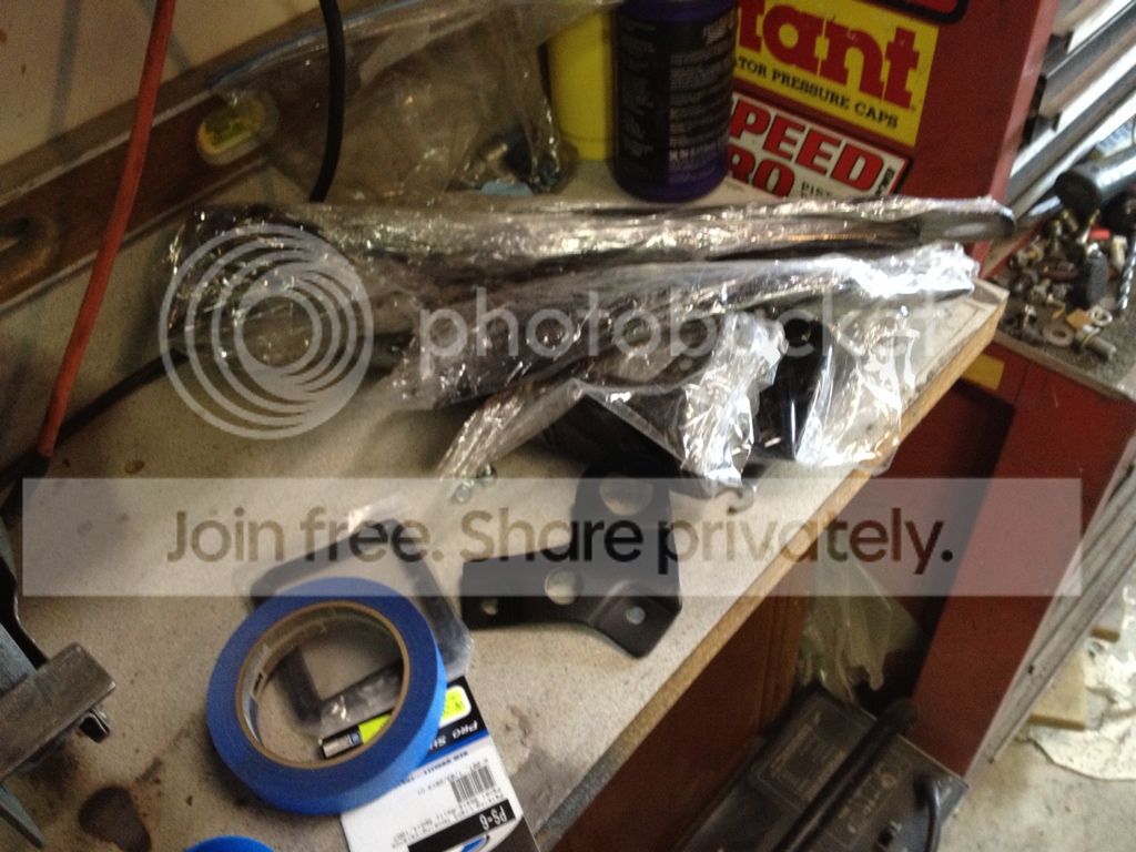

Beach Cruiser 02-14-2013 03:23 PM

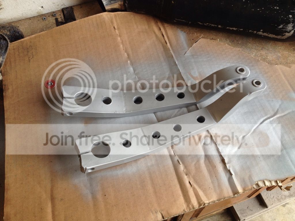

Picked up some of the stuff I had Painted and Powdercoated today! Ready for a big assembly weekend and the Dyno day on Wed!
http://i539.photobucket.com/albums/f...psd7184cf3.jpg
http://i539.photobucket.com/albums/f...ps39d489d6.jpg
http://i539.photobucket.com/albums/f...ps74541eb0.jpg
painted the under side of the wheel wells with Undercoating
http://i539.photobucket.com/albums/f...ps3bd3305f.jpg
Got the sway bar mounts drilled and painted ready to go back on the carhttp://i539.photobucket.com/albums/f...ps57ba8c48.jpg

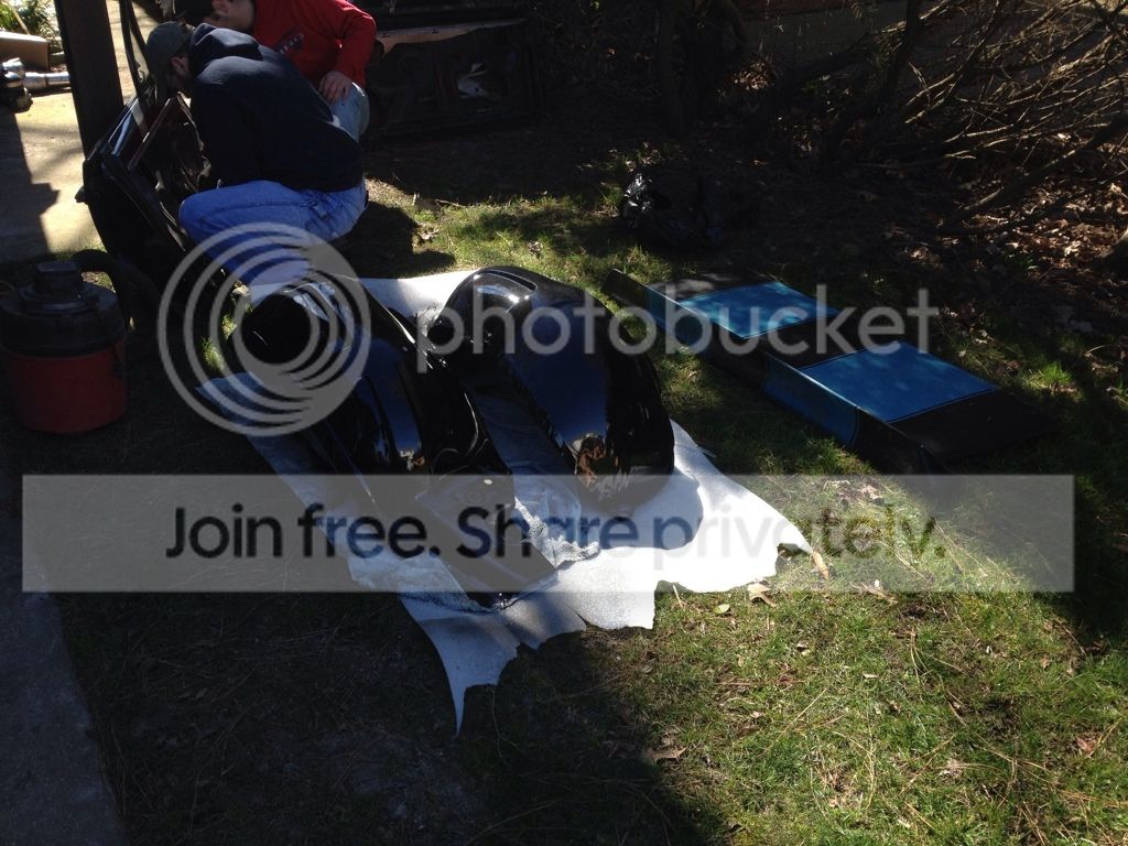

Beach Cruiser 02-18-2013 04:08 PM
Man it was nice to finally have some help! Several of my local F-body friends came over today to help with the assembley. Without them, there is no way I would have gotten this much work done!
Pulled all the extra body parts out of my shed and discovered a family of squirels have been living inside my doors!
http://i539.photobucket.com/albums/f...ps48795b67.jpg
parts layed out and ready
http://i539.photobucket.com/albums/f...ps7e657cb1.jpg
hanging the door
http://i539.photobucket.com/albums/f...psdb4f921a.jpg
Inner fender on!
http://i539.photobucket.com/albums/f...ps565c26ae.jpg
Mostly done
http://i539.photobucket.com/albums/f...ps8f709d09.jpg
looks like a car again!
