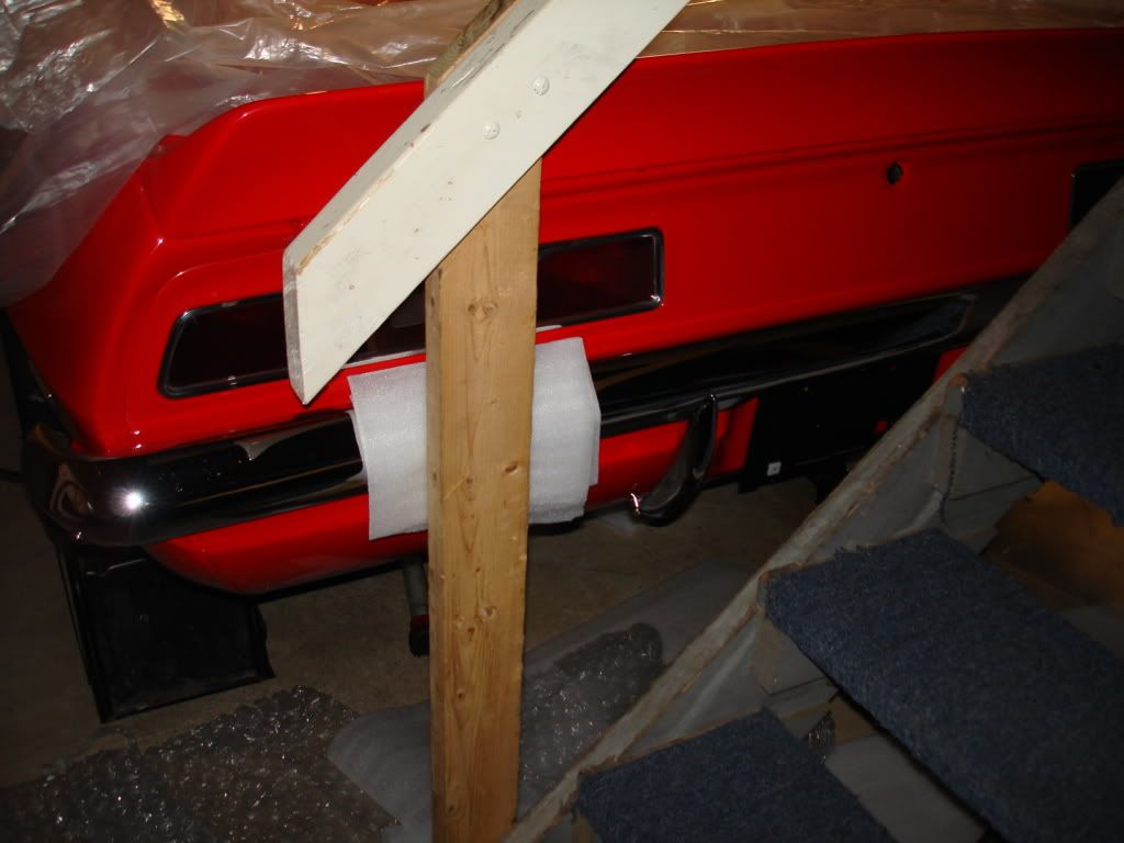

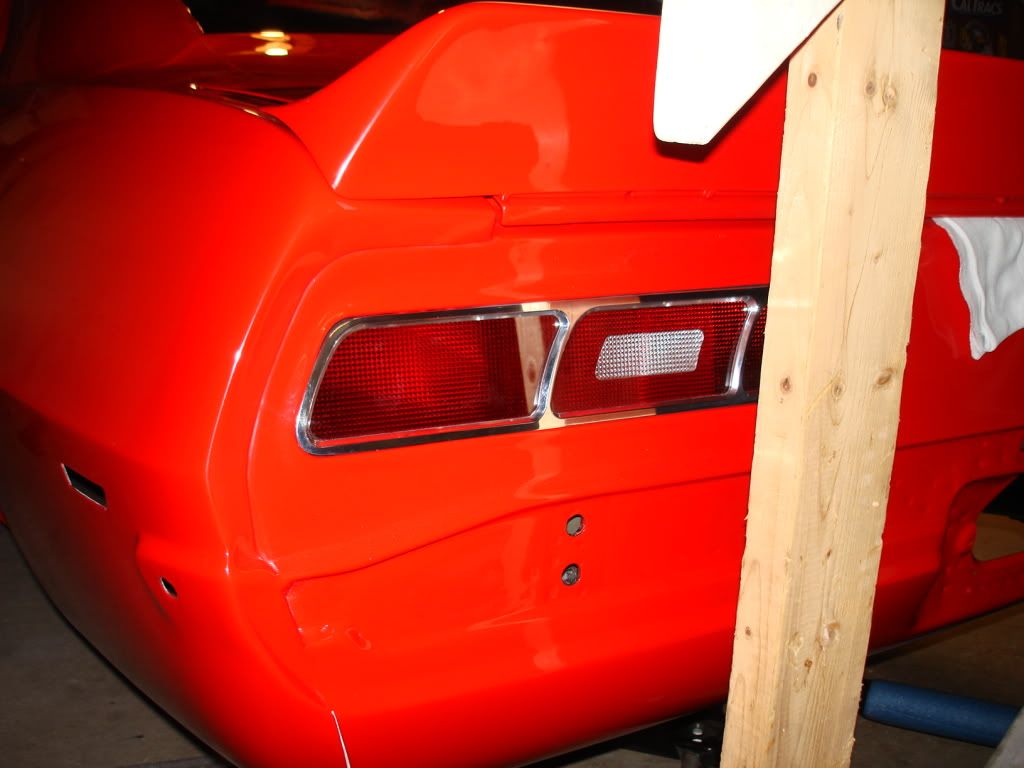

And Installed the Marquez tail light housings, of course being the amateur that I am, I never gave these housings to Mike to fit in the repro tail pan. They were off by a full millimeter to fit in the holes. Luckily my work gives me access to some nice computor controlled mills/bridgeports. The radius's in those things are tougher than you think, but we got it done. I always do things the hard way.

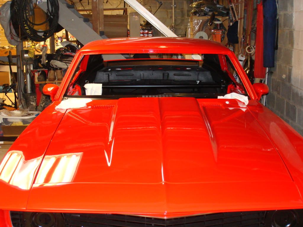

67ragtp 06-07-2010 10:19 AM
Got a chance to assemble the headlight buckets, DSE lamps, and trim. The parking lights are Marquez, and installed the endura bumper, which I might add was a brutal install. I almost sailed it out in to the street a few times. They fit like crap. I had to cut and modify every bracket. Im not crazy with the fit but I think I will live with it. I dont have to many alternatives, Im trying to get some info on the smoothed bumper from year one but getting no responses. The endura on the car fits low in the center and high on the ends, I guess its not to bad.

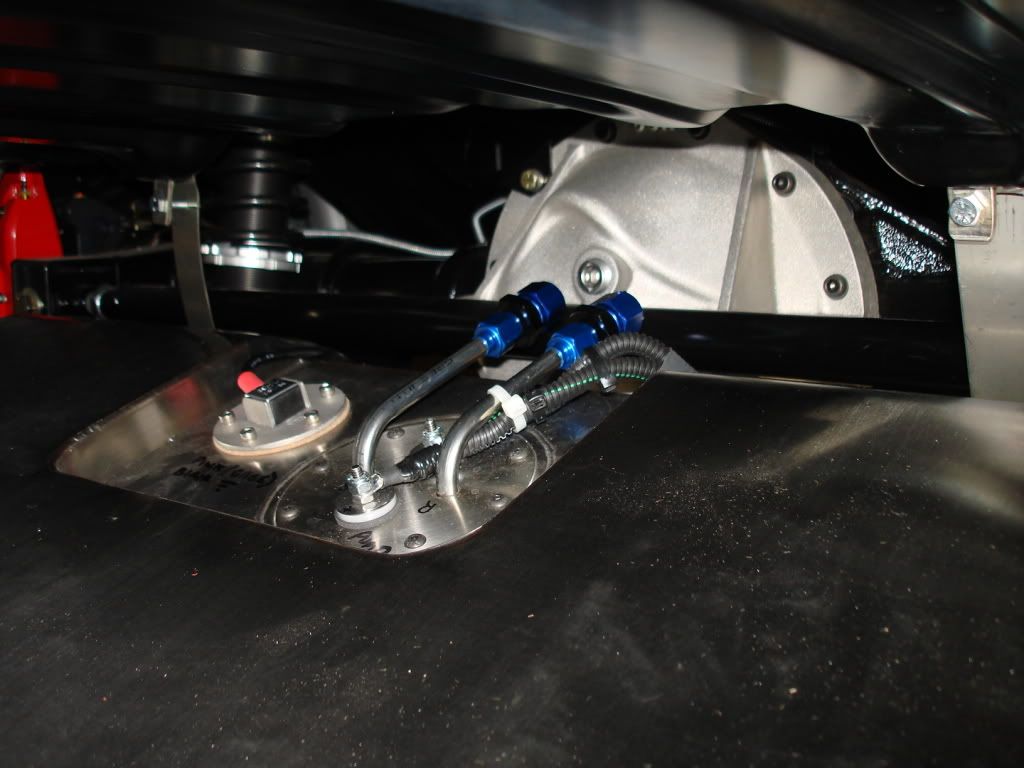

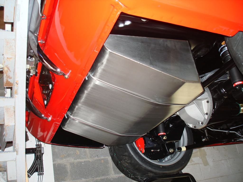

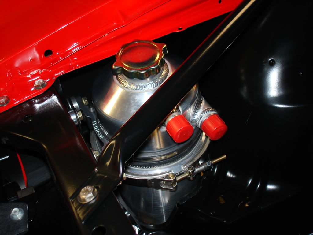

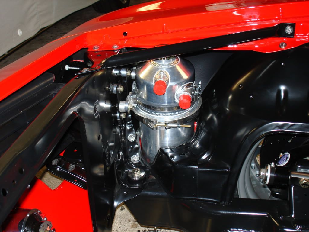

I finally got to install this humongus tank, had to cut a huge hole in the inner fender well. I did it with a dremel and composite blades, believe it or not, three blades did the job. Easy to cut curves with out having to take out the monster air tools. here's a few pics.
Ive been trying to find out which port on the ls7 oil pan is the supply(front or rear) and which one is the return. If any of you guys know please let me in on it, I must have searched four different sites and couldn't find anythng. I beilieve the top port on the resivoir is the catch can the next one down is the oil return and the bottom goes to the supply. Just need to know what each one is at the pan.

67ragtp 07-17-2010 04:27 PM

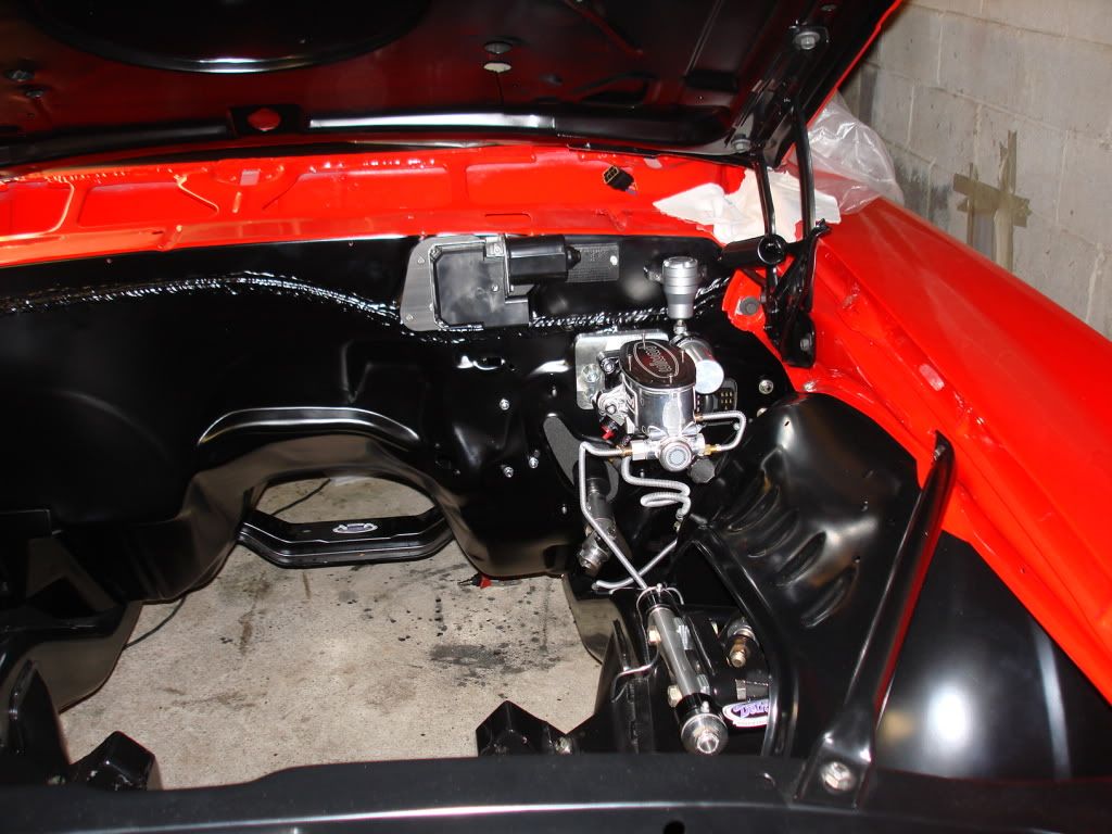

I made a little more progress, takes forever to do things when you can barely walk around the car. I need my head examined for doing this in these conditions. Ok enough bitch'n. Got the rear bumper bolted up, installed the column, pedal assy and electronic gas pedal , parking brake, installed the rear brake line and had inline tube make me a few lines from some templates I bent up. Im not very good with the flaring tool, so I just bend the lines and send them over to inline, BTW very nice people to work with. Hydratech hydroboost and clutch slave and resivoir are in. I used the autowire classic update harness.
http://i168.photobucket.com/albums/u...Picture275.jpg
http://i168.photobucket.com/albums/u...Picture270.jpg
http://i168.photobucket.com/albums/u...Picture274.jpg
Gas tank went in with no suprises, I talked with Hector last night from Ricks, what a nice guy, couldn't be more helpful.

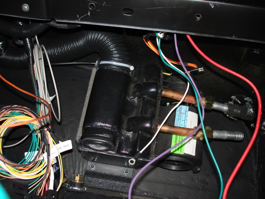

67ragtp 08-29-2010 05:56 AM

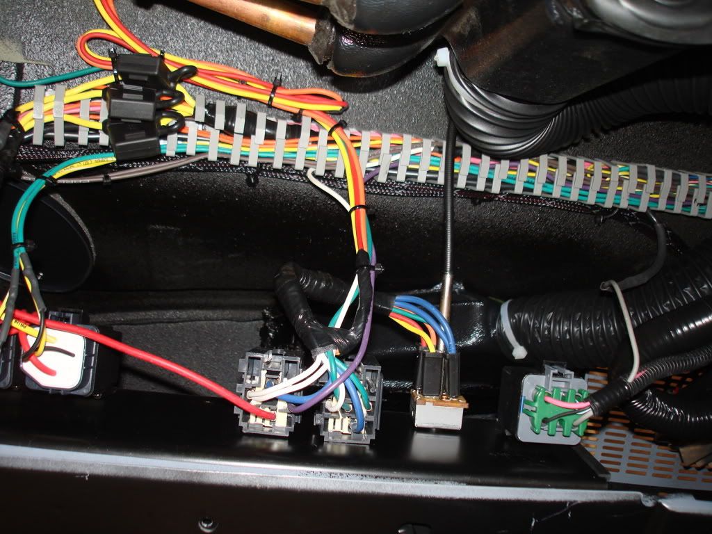

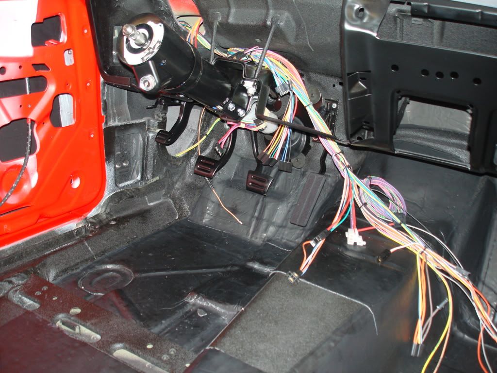

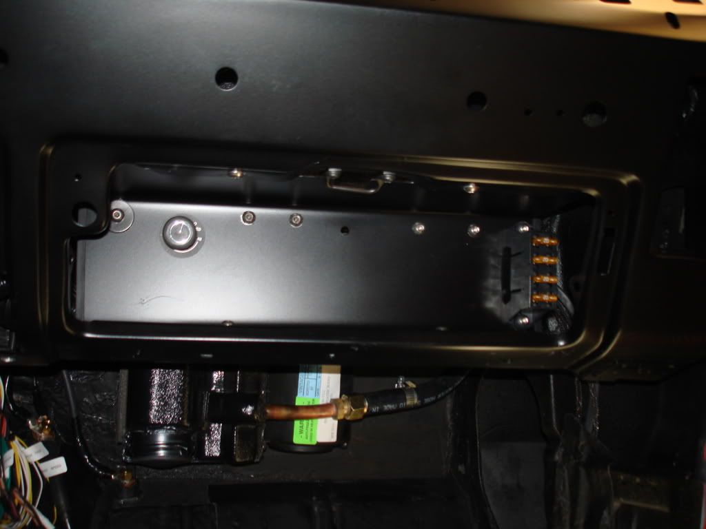

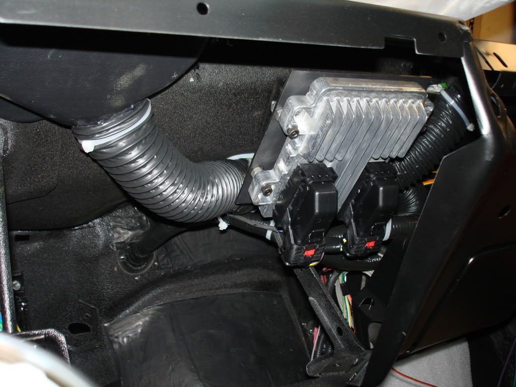

This is the part where things seem to move in slow motion. Im not sure whats worse, wiring a car or hanging a headliner :willy: I found a spot to mount the ECU and bent up a piece of stainless for the inside of the glove box where the back side serves a relay mounting platform. Big thanks to Scott G., the way he did his car has been a real inspiration for how I want mine to look, the glove box and bi level heater/defrost is pretty close to the way he did his. Maybe down the road Ill convert it over to air, not a big fan of AC. Wiring is tough for me, Im trying to keep it neat so Im giving these wire chases a try there pretty nice to work with, self adhesive backing but I used some super weatherstrip adhesive to make sure it doesn't come down. It probably looks amateurish but its an improvement for me. I still have to wire the back of the guage cluster and just relized last night that theres 3 more relays for the ididit column ignition to mount. I got a chance to use my green leaf hole punches for the battery bulk head fittings and the big one for the ecu harness, awesome tools to work with, perfect punched hole and little effort. An old machinest gave me a bunch of them, there pretty old.

Oh yeah so sweet. Nice and neat. Rich whats the knob in the glove box for? Wiring and head liner, great two things to look forward to!
