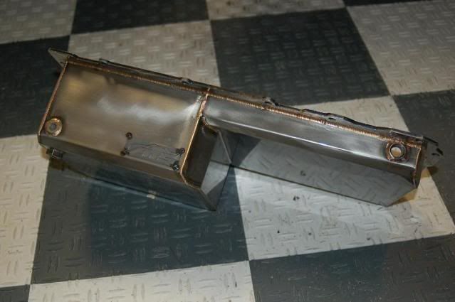

Parts update, I got the ATS Spindles and oil pan today. The Ididit is coming tomorrow along with the axles and center section. I also placed a order for the AutoKraft engine mounts for the LS2. Parts are coming in slower them a turtle! I made a change on the brakes to the greatest and latest,lol.
I started to put the speedtech together when I noticed that the last owner didnt include any nuts or bolts. So tomorrow Ill go pick some up. Ill have a updated picture tomorrow. :woot:

Tyler got me back on the list because of what happened. :hail: The pan is pretty killer also but the gasket and AN fittings had to come from someone else. I hope to see them by next week. With the baby on the way at the end of the month I just feel the need to get done as much as I can now. I would like to have the car on the ground by then.

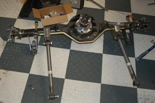

Ok took off a hour early to get the Subframe together. Turns out Im missing a couple key bolts for the sway bar. But all in all its very close.
http://img.photobucket.com/albums/v1...v/DSC_0359.jpg
http://img.photobucket.com/albums/v1...v/DSC_0360.jpg

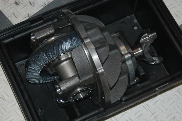

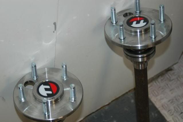

Got home to find my Detroit tru trac came today along with the axles. Just got finished putting it in. Now Im just waiting for my brakes so I can put the wheels on this bad boy!

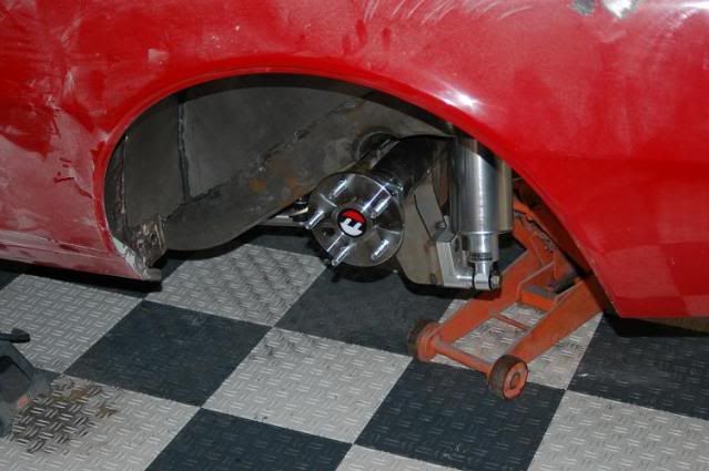

Well back in the garage! The baby has been napping so I sneak away to do some work.
Im still waiting for all my other parts to roll in. Willwood sent me the rears but Im still waiting on the fronts. These are the W4A, from what Frank told me these are the first to go on a rear or a car. They are BIG! The rotors are 14in and calipers are 11in long. I picked black because I want them to match the car color. So they will be painted to match. The fronts are W6A with a 14.25 rotor. Ill post them once I get em.
http://img.photobucket.com/albums/v1...v/DSC_0591.jpg
I have to do more work to get the rear wheels on. Seems the bore size is off by a hair! Its very close, I might just do some sanding to get them to go on.

Nice.....do yourself a favor and make sure you don't have a brake pad knock back issue on the rear end. You will need a dial indicator and must remove the brake pads. I don't know if the issue has been resolved with the axle retainer that wilwood provides yet or not? Now is the time to deal with it if there is a problem.
Hmm should I just use the one Morrison sent? Its thicker. Nothing is set as of yet. This is just mock up.
Are they specifically for a wilwood setup? I tweaked one of my wilwood retainers a hair. I ended up with a set of currie retainers that go all the way around the bearing. On mine you could see the bearing move away from the retaining clip with your bare eyes! I had over .020 on both sides. I was able to get it down to .005 and .006 with the currie plates. Do yourself a favor an measure it now while it's mocked up. Wilwood was working on a new design when I talked to them 2 months ago. The new design was shimmable.
