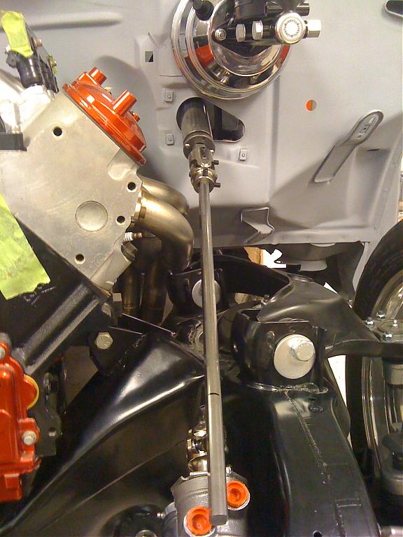

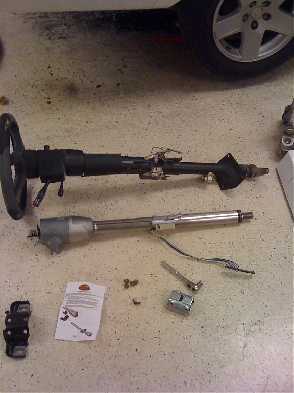

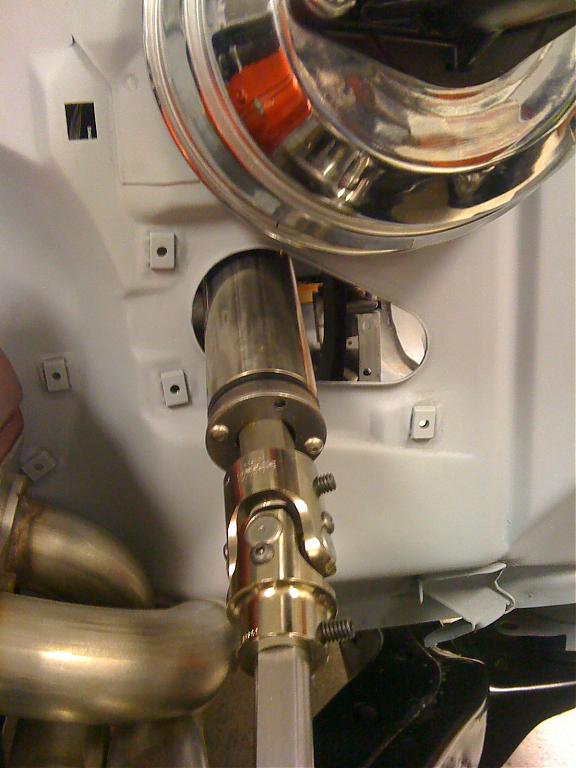

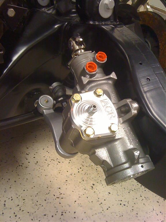

Comin along on some steering stuff.
Attachment 28753
Attachment 28754
Attachment 28755
tobenk 02-13-2011 07:50 PM
3 Attachment(s)
Attachment 28756
Attachment 28757
Attachment 28758
PASD U 05-29-2011 11:26 AM
I missed your last couple posts. Details on the steering components? I like that Budnik wheel too.
Any more updates?
tobenk 05-30-2011 07:50 AM
1 Attachment(s)

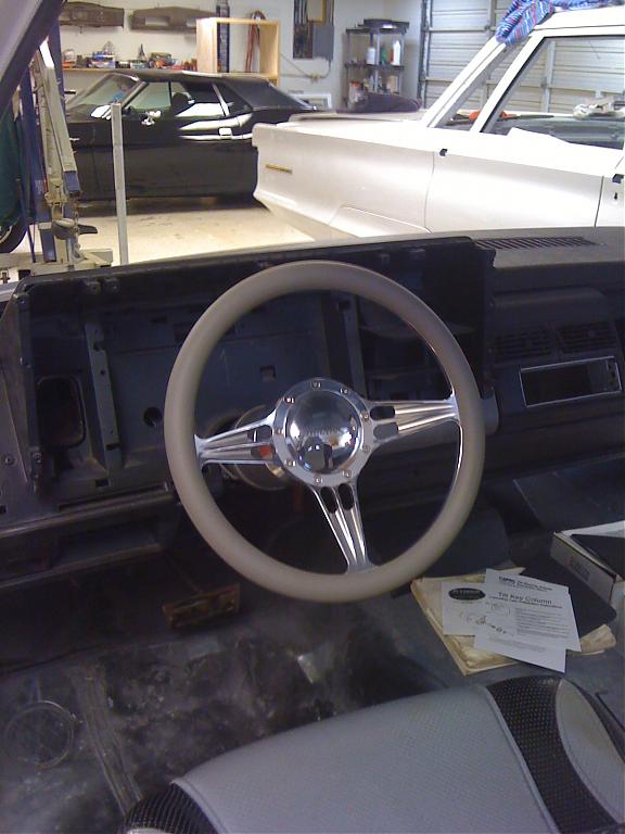

The column, shaft and u joints are Flaming River. The box is a AGR. I have been working my butt off so havnt time to work on truck but guess making money for it. :D Thks i bought the steering wheel to match my wheels.
Attachment 30404 At ShowFest a couple weeks ago.

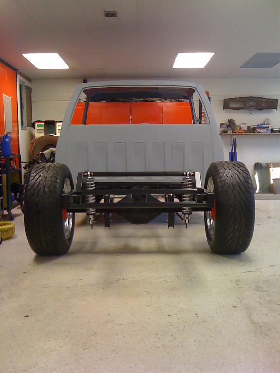

I got get front end down some how.....
Attachment 30822

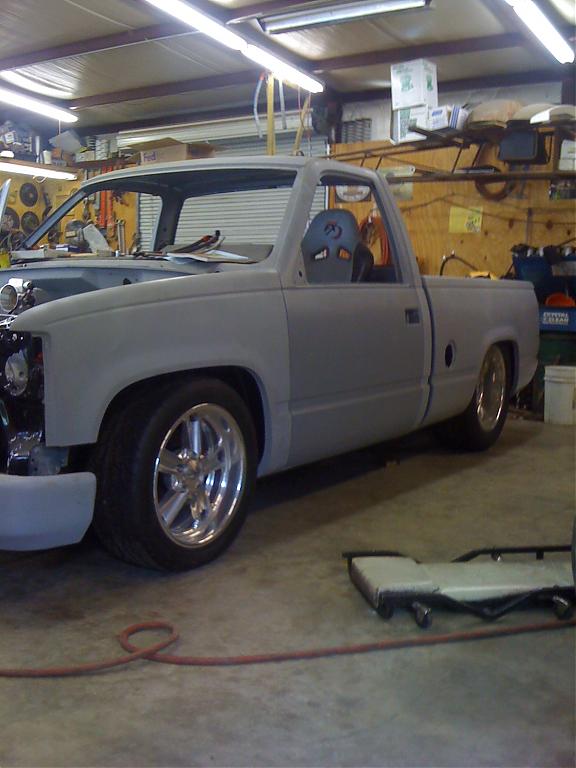

tobenk 06-22-2011 05:59 PM
Any suggestions for gettin the front end down another 2 to 3 inches. I already have lower spindles and springs. I prefer not to bag it. Thks :D
street3285 06-23-2011 08:55 AM
On those trucks, the only way to do it is with spindles and springs. WHat drop springs do you have in there now? 2" or 3"? I think DJM makes dropped control arms. Other than that, the only other option is bagging it.
Question: What size tire are you running in the rear? Thats a 20" wheel, right?
tobenk 06-23-2011 10:32 AM

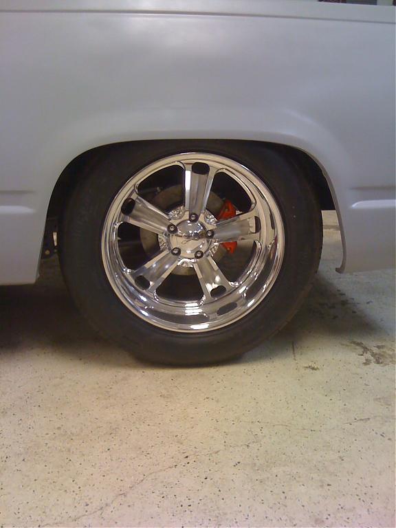

I have 2" drop springs on it now and I looked into the DJM control arms but was told they won't work with drop spindles...the rear tires are 20s. 305/50/20s on a 20&10. 255/45/18s on front on a 18&8. I was thinking about bagging it but have coilovers on back with 4 link.
street3285 06-23-2011 01:30 PM
I would think with a 2" spring up front, , with a 2" drop spindle, it should be lower. Whenever I lowered that body style 4" in the front, it seemed to sit lower.
You can always try a 3" spring. Bagging it is an option, and fairly simple with the cups. But then, you will have to get all the air management. Valves, compressors, tanks, etc...
tobenk 06-23-2011 02:23 PM
I wonder if u could use the DJM control arms with 3" springs. I don't want bag it cause I plan to drag race it alittle. I will have to try a few things and see if it changes anything. A 4" drop does seem like it would sit lower thou. Idk
street3285 06-23-2011 03:20 PM
How close are the arms to hitting the bump stops? Having the spindle would be better, for a better ride and stuff. If your willing, you can always cut those springs down some and see where it sits. Especially if you have some room before the control arm hits the bump stop.
Now you have me really wondering why your truck seems to sit high for a 4" drop. Either way, it is a very nice truck and the rear tires look sweet! :thumbsup:

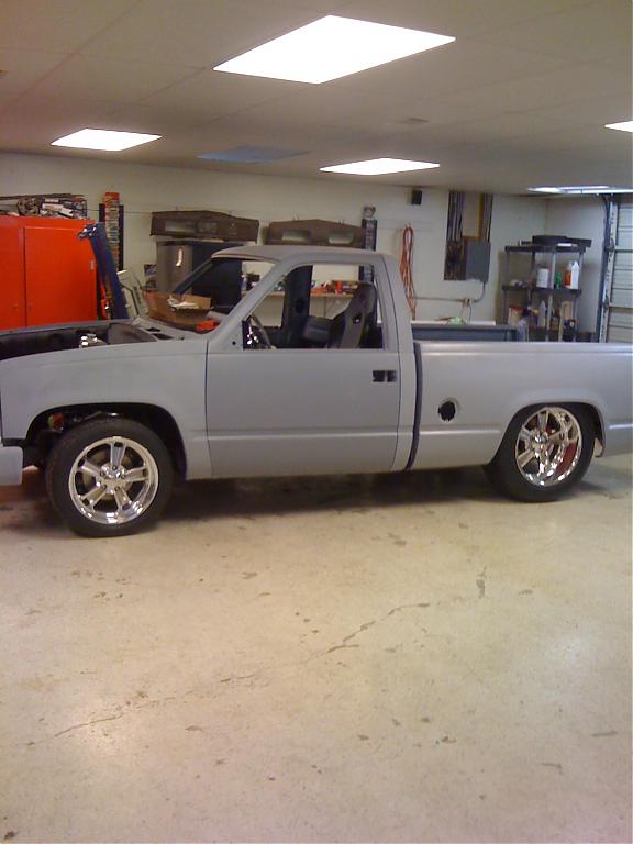

tobenk 06-23-2011 06:27 PM
3 Attachment(s)

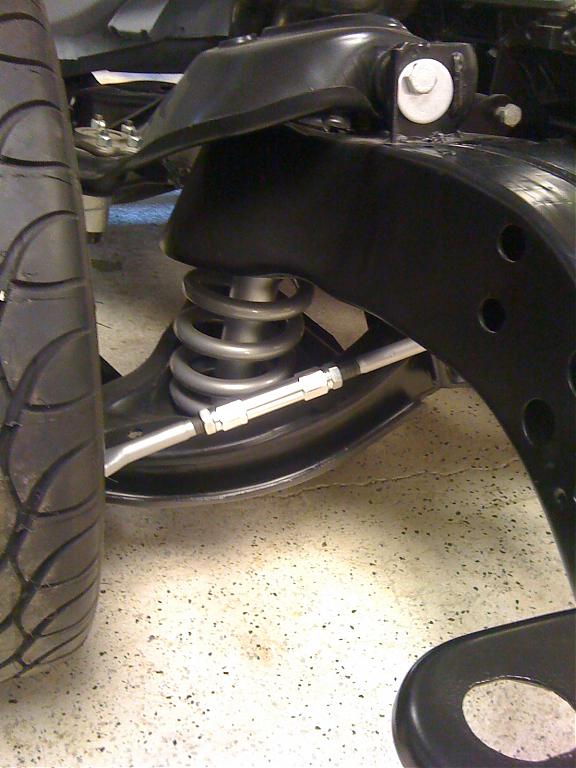

I am thinking about tryin the 3" springs and go from there.
Attachment 30838
Attachment 30839
Attachment 30840

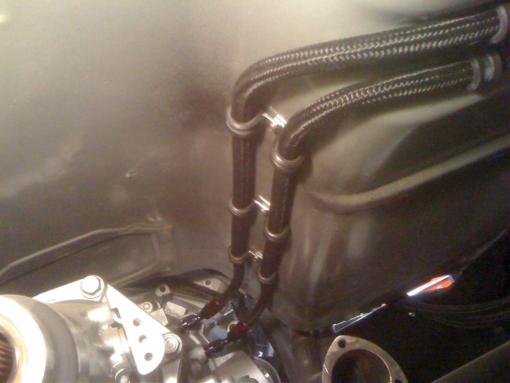

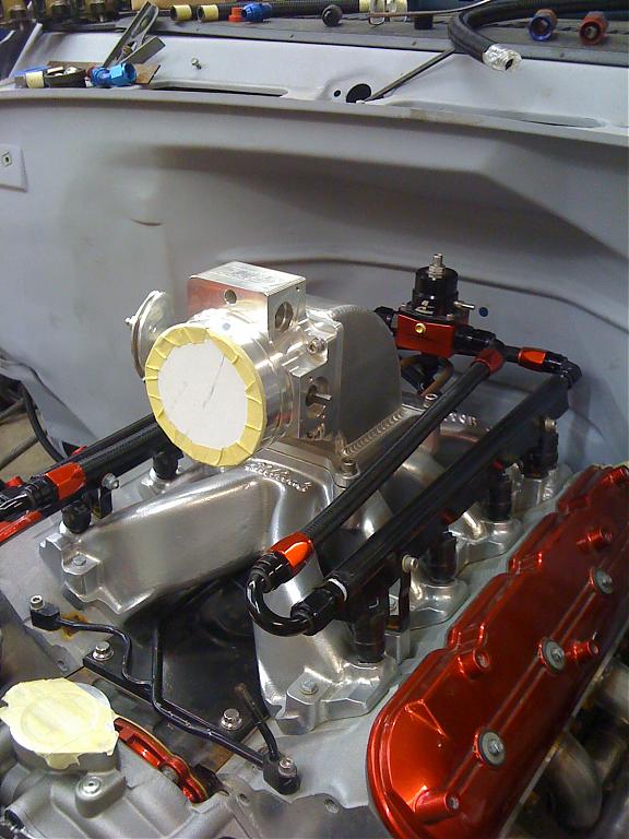

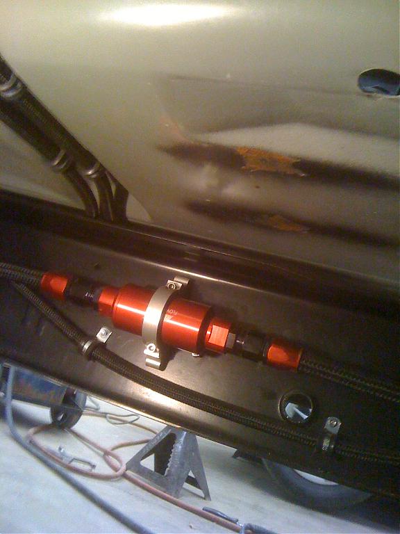

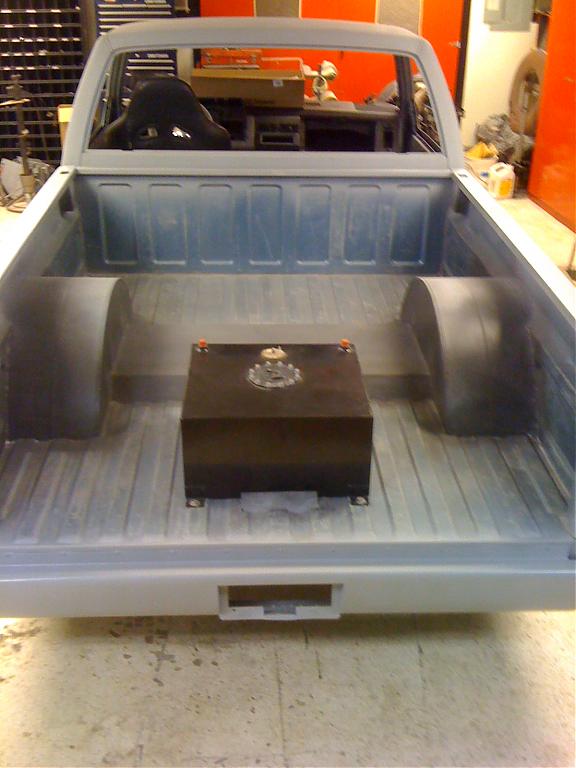

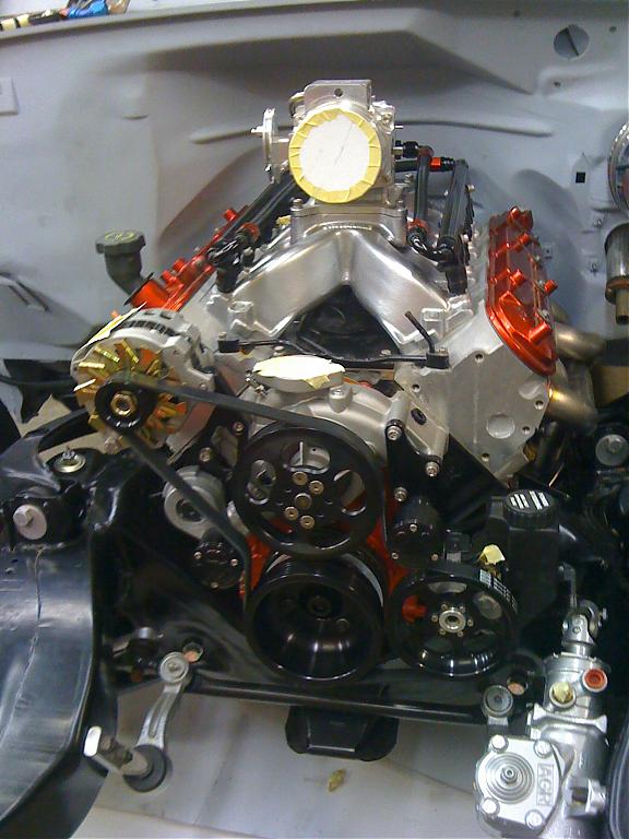

Finally working on truck again. I ordered a Wegner Motorsports front drive system awhile back and got it on. Got just about all fuel lines done except from pump to fuel cell. Got order a few more fittings.
Attachment 33674
Attachment 33675
tobenk 01-24-2012 08:03 AM
4 Attachment(s)

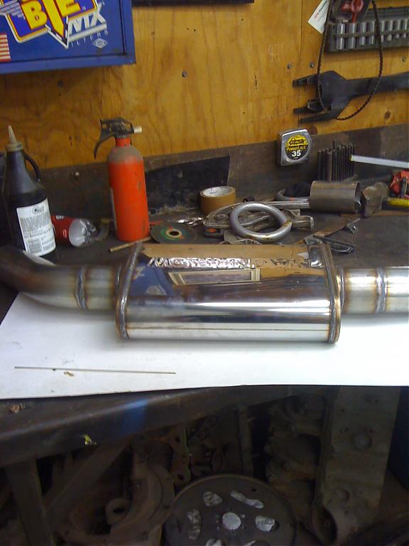

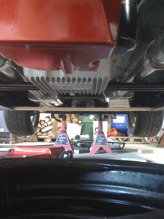

Workin on exhaust.
Attachment 33745
Attachment 33746
Attachment 33747
Attachment 33748

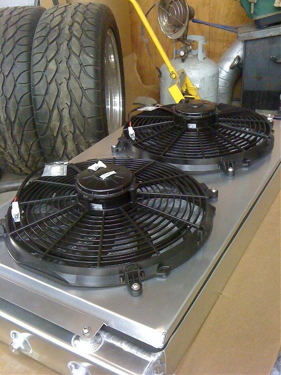

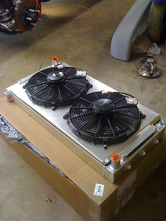

tobenk 02-16-2012 07:44 PM
3 Attachment(s)

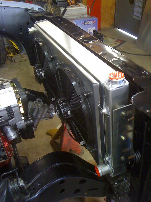

Got my radiator in the other day! :thumbsup:
Attachment 34038
Attachment 34043
Attachment 34044

tobenk 02-17-2012 07:10 AM
1 Attachment(s)

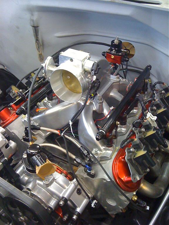

I got the front end down just took springs out and cut them off about a full round on spring. Now it sits like i want it. I will post pics when i get it back on the ground. Im gettin there on everything just takes time cause i do something then have to order parts. I got some of my Holley Dominator EFI stuff in too just waiting on ecu and trans harness.

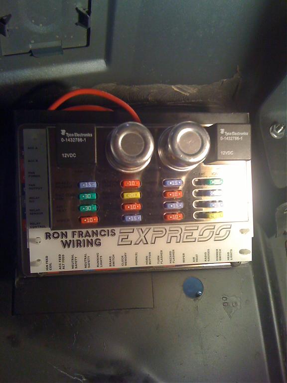

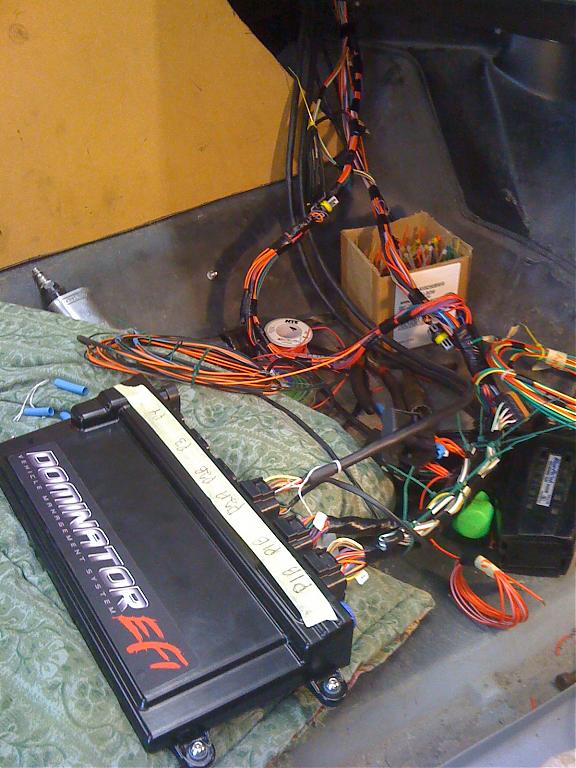

Starting to lay out some of this wiring. Man this is a mess rite now but have to start somewhere.
Attachment 34651
Attachment 34652
Attachment 34653
PASD U 04-11-2012 04:04 PM
The wiring definitely looks intimidating. Keep at it. :thumbsup:
tobenk 04-12-2012 08:37 AM
The wiring does look scary at first but Holley really doesnt put the plugs where i needed them so i had to tear it all apart and lay everything out where i need it. I ordered my main wire harness for the truck last week from Ron Francis. I am getting more wire loom from them so i can start rapping all of it back up. :D

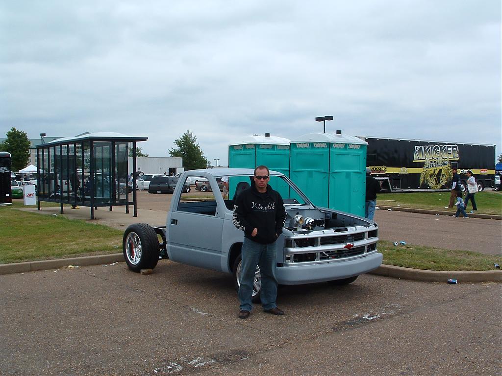

Thanks!!! It drives better than I thought it would being 4 linked!! Drove great on Power Tour this year!!! This is in Memphis!! http://images.tapatalk-cdn.com/15/11...fd953be509.jpghttp://images.tapatalk-cdn.com/15/11...fe666a8852.jpg
