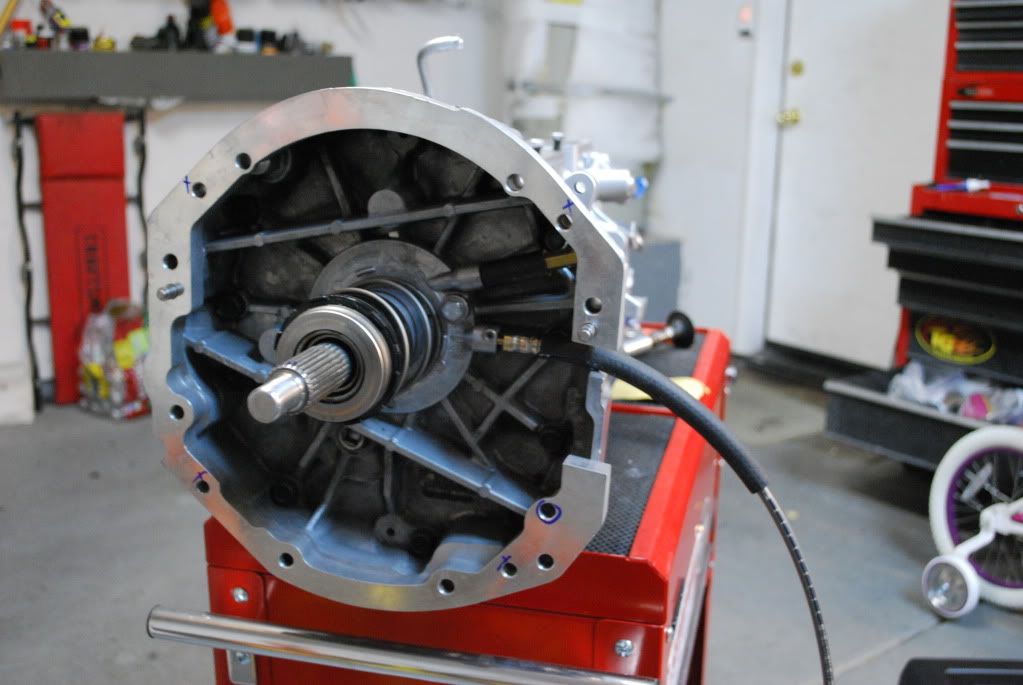

I'm almost ready to mate the Pontiac Motor to the Viper T56, pics soon. I'm trying to figure out what to do with the hydraulic setup. I want to use the Viper CSC and the Camaro T56 master and lines. The problem is that the connection on the Viper CSC is slightly different and won't connect to the Camaro hydraulic line. I know that the fitting is removeable, but can't find a source other than buying a Camaro CSC and removing that fitting.
Does anyone know where I can get just the fitting? Or better yet, a used Camaro t56 CSC that I can buy cheap to remove the fitting?
GregWeld 11-16-2011 02:58 PM
Take your line --- and the fitting that is slightly different - to a hydraulic shop -- show them what you need and they'll make you one. It isn't that expensive and most will do it while you wait.
Some of the fittings are JIC.... don't ask me what that is - but they're basically AN- stuff but used in the hydraulic industry.

67rstbkt 11-17-2011 12:03 AM
Awesome, thanks for the suggestion. I guess I need to pick up the Camaro hydraulic line so I can bring that in along with the Viper CSC. I know that there are at least one or two hydraulic shops around here I can try :thumbsup:
67rstbkt 11-28-2011 01:14 PM
Minor update:
I went to a hydraulic shop and they were able to make me a hose. I lose the quick disconnect, but that's not a big deal for me. I also just got the bellhousing and spacer from Mcleod to mount the transmission to my motor. Pics will follow soon.
Thanks :D

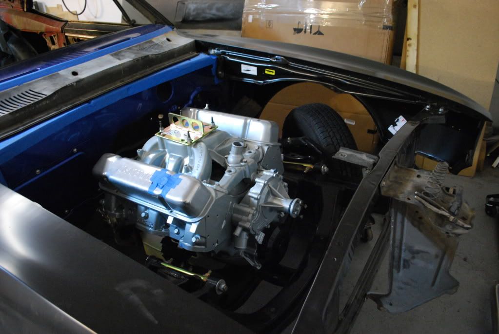

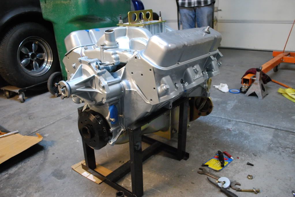

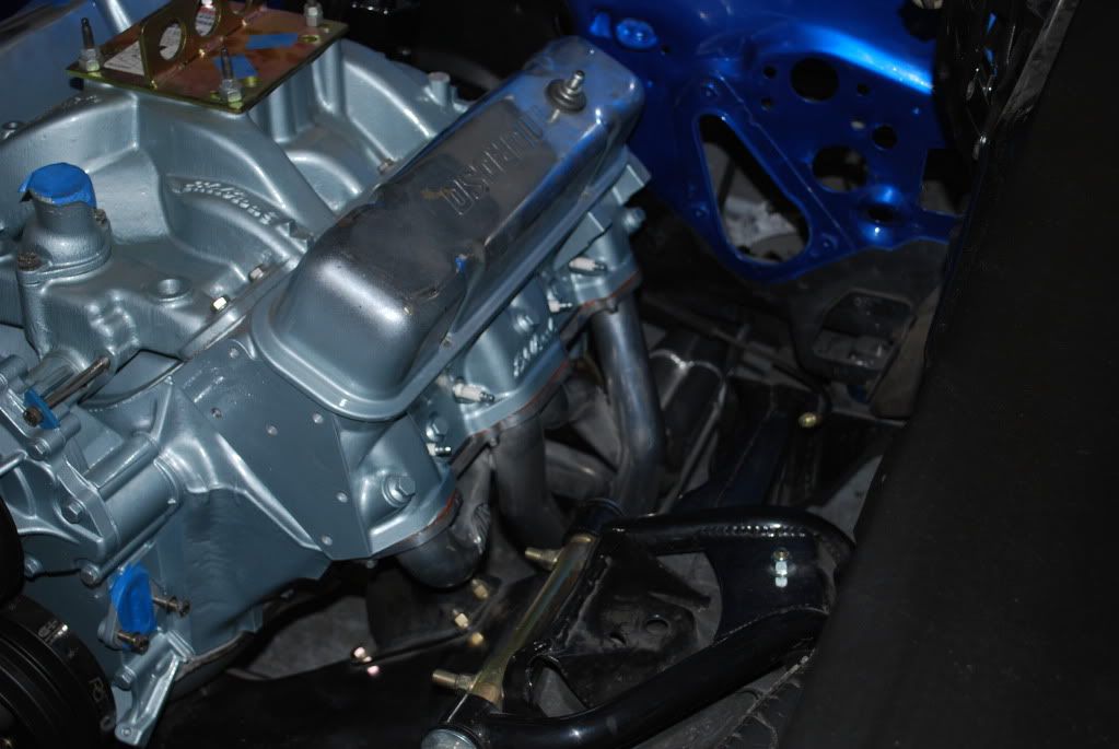

67rstbkt 02-05-2012 02:47 PM

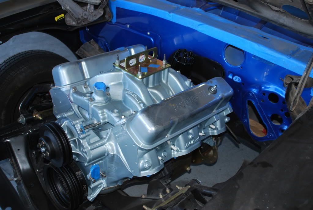

Long overdue updates. The motor and trans are now in the car. I've started getting the front sheet metal bolted up, sandblasted and painted all the little brackets that are needed for that. I used Eastwood underhood black for the parts. Well, here are the pics.......

67rstbkt 02-05-2012 02:48 PM
A few more:

67rstbkt 02-07-2012 11:05 AM
Originally Posted by FETorino (Post 394082)
Great build.
Back in 1980 to 92 I had a 69 FB. Love the Poncho powerplant HO racing used to build some great 400ci stump pullers back in the day. I didn't see in your thread is it a 400 or a 455?
Thanks for the comments :thumbsup:
To answer your question, it's a 400 stroked to 461. I used a forged rotating assembly and 87cc Edelbrock heads with some mild porting. I also switched out the springs and running a Tomahawk solid cam @ about .525 lift

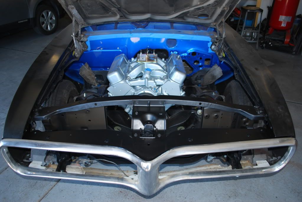

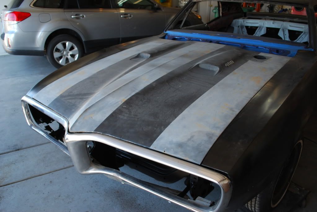

67rstbkt 02-10-2012 08:47 AM
Thanks for the comments :hail:

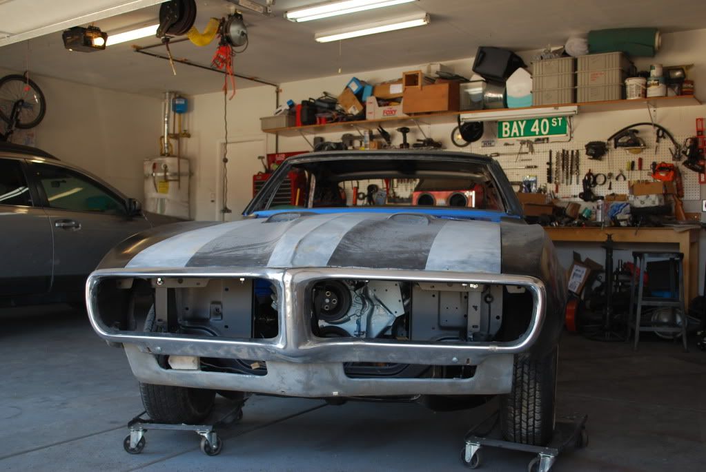

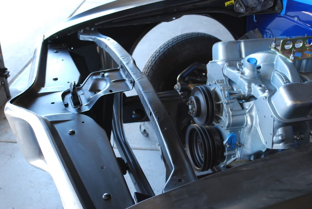

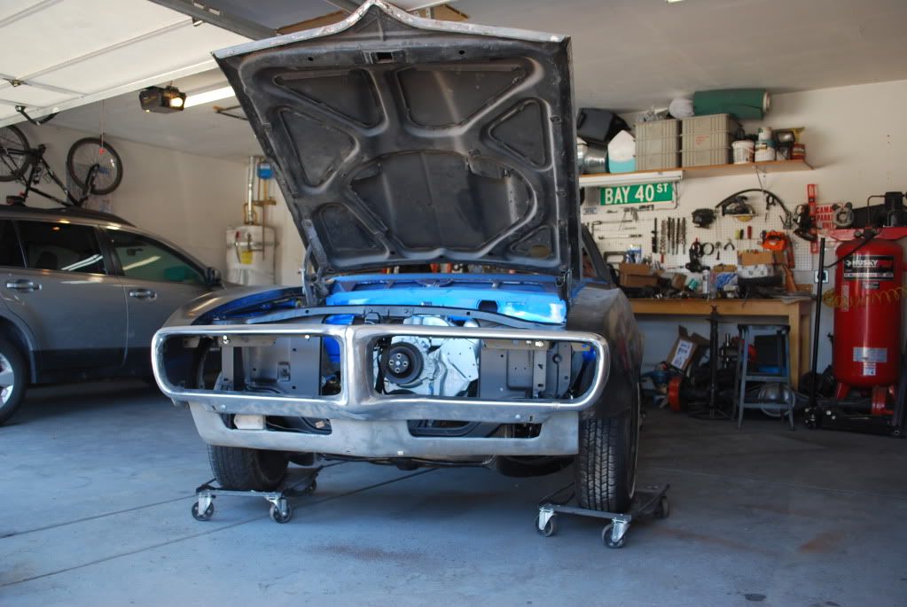

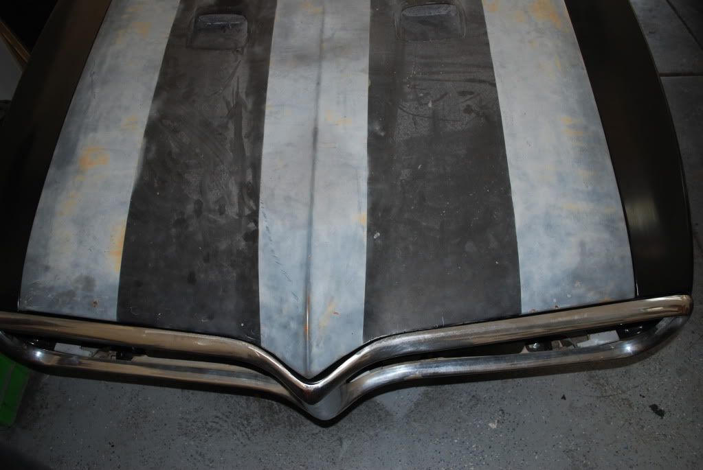

I've been working on the gap between the bumper and front-end. I know that from the factory, this gap was pretty large. I'm trying to get a uniform and closer gap here. Right now if you look from the top down, the gap is tighter towards the center of the hood and wider as it goes out to the fenders. Can anyone offer any tips or advice on getting this as close and as uniform as possible?
I've also been thinking of buying a new fiberglass bumper. My reasoning here is that it may be easier to work with and fit the fiberglass bumper. If I keep the metal bumper, I was planning on painting it body color anyway, so the fiberglass would work out in my plans. Any thoughts on this or experience with the fiberglass bumpers for this car? I found a company named UP22 that sells them. Anyone deal with them?
Thanks

Please keep me/ us posted on the front bumper update. I too will eventually be dealing with this same issue, so I'd like to see what you find out. Thanks!
67rstbkt 02-14-2012 10:08 AM
I worked on it some more this past weekend and got it much closer. I had to tweak my bumper a little, basically just bent in the outsides a little. I don't think this is the original bumper because there are no holes in it for the pontiac emblem. From what I can tell, the 400 cars had this on the bumper. Also, who knows what happened to this bumper over the years.
Currently, the gaps are much more consistent. The only issue is that the gap is a little closer towards the middle (center of the hood) and gets slightly larger as it gets towards the fenders. I'm still trying to decide if I can live with it. I'll try and take some pictures this weekend.
Tuske427 02-14-2012 03:58 PM
Cool, thanks for the update. Yeah, the original 400 bumpers had two stamped (5/8" ??) holes on the middle for the emblem. Most people just drill out the non 400 bumpers to attach the emblem. I have an original 400 bumper if you need a template. I can make one for you- just let me know.

67rstbkt 02-15-2012 07:45 AM
I'm still undecided on this bumper; it's been through a lot and will need some work to get it to look good. Thanks for the template offer, I'll definitely let you know if I need that. :thumbsup:

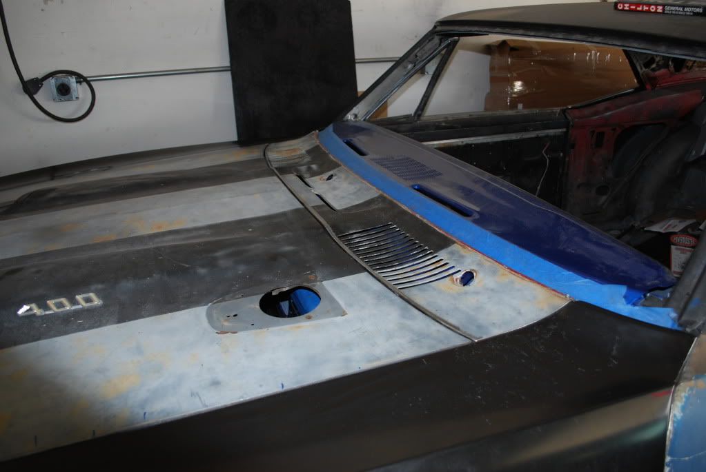

67rstbkt 03-18-2012 05:23 PM

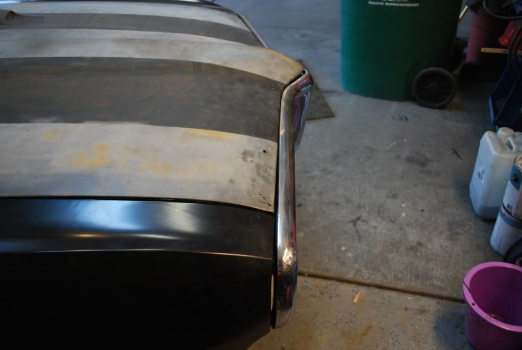

Sorry for the delay on these, been busy with a new job. Here are the pics after I messed around with the gaps. It's not perfect, but it is much better than it was. The sides use some sort of urethane filler pieces that cover that gap. Ames has them listed in their catalog. I also picked up some doug's headers since Classic was having a sale. I am very pleased with how well they fit.
Anyway, here are the pics:
http://i223.photobucket.com/albums/d...8/DSC_0049.jpg
http://i223.photobucket.com/albums/d...DSC_0003-2.jpg
http://i223.photobucket.com/albums/d...DSC_0002-2.jpg
http://i223.photobucket.com/albums/d...DSC_0046-1.jpg
http://i223.photobucket.com/albums/d...DSC_0045-2.jpg
and here's one of the cowl panel that I cut apart and welded back together because it was sitting too high:
http://i223.photobucket.com/albums/d...DSC_0047-1.jpg
And the after fitment:
http://i223.photobucket.com/albums/d...8/DSC_0048.jpg

Tuske427 03-18-2012 09:02 PM
Cool, thank you for posting these pics! This looks good. I'll definitely have to go this route. Of course, it looks like it's a lot of work... :)

1: I will need to rethink the fuel pump setup, maybe reposition or cut and weld in a small sump section for the bottom of it. With 4 gallons of gas, it started cutting out on me, so I put in another 5 gallons and it was good to go.
2: Little oil leak that I need to investigate. It looks like it's either the rear main or the oil pan. I'm kind of pissed about this because I used the high-dollar BOP seal and followed the instructions exactly (if that's the cause). The other possibility is the oil pan. It's the Canton pan and it was way off out of the box, so I had to massage it into shape. I thought about exchanging it after I got it, but at the time, my machine shop was using the same pan on a Pontiac and it fit exactly like mine did. It's like it got warped a little when they welded to bottom portion onto it.
Anyways, here's a video of it running. This is after I ran it for about 20 minutes at around 2000 rpm. It's idling at about 1000 in this video

Thanks! Still a lot of work to do before it sees the road. I'm going to be removing the front sheetmetal for paint. I wanted to make sure that everything is ok with the motor before I get to paint and re-assembly. Depending on where that little oil leak is, I may have to get the motor back out.
