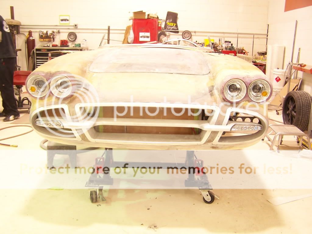

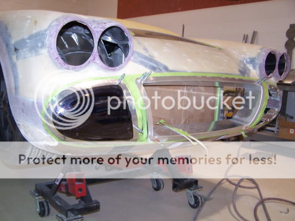

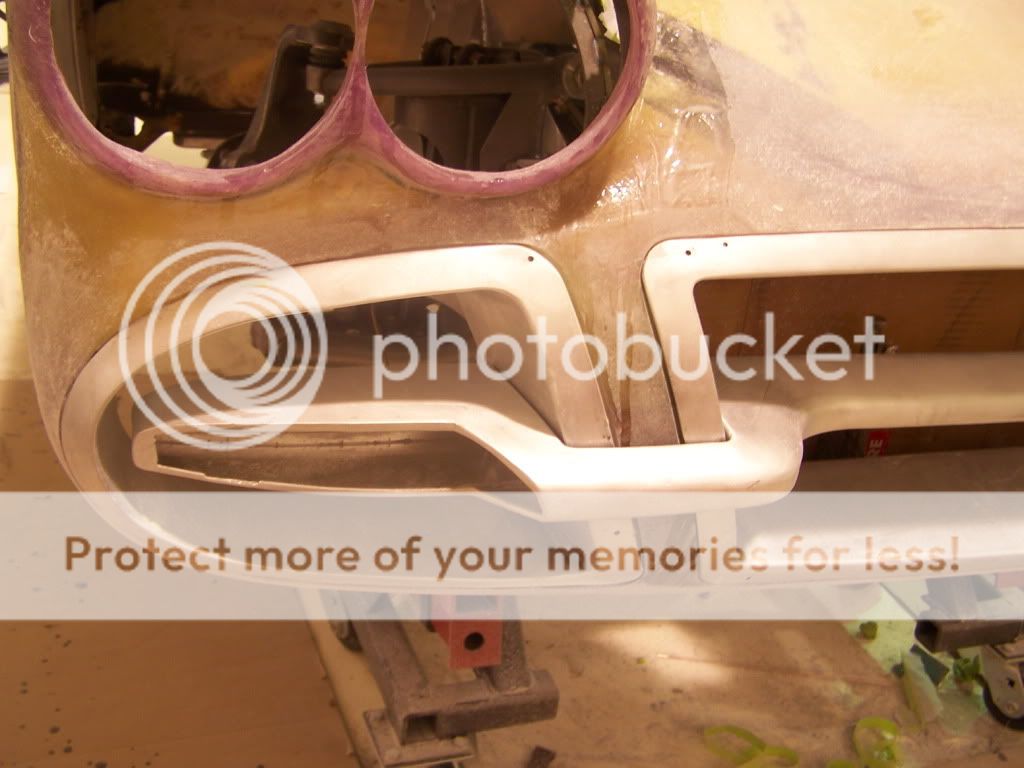

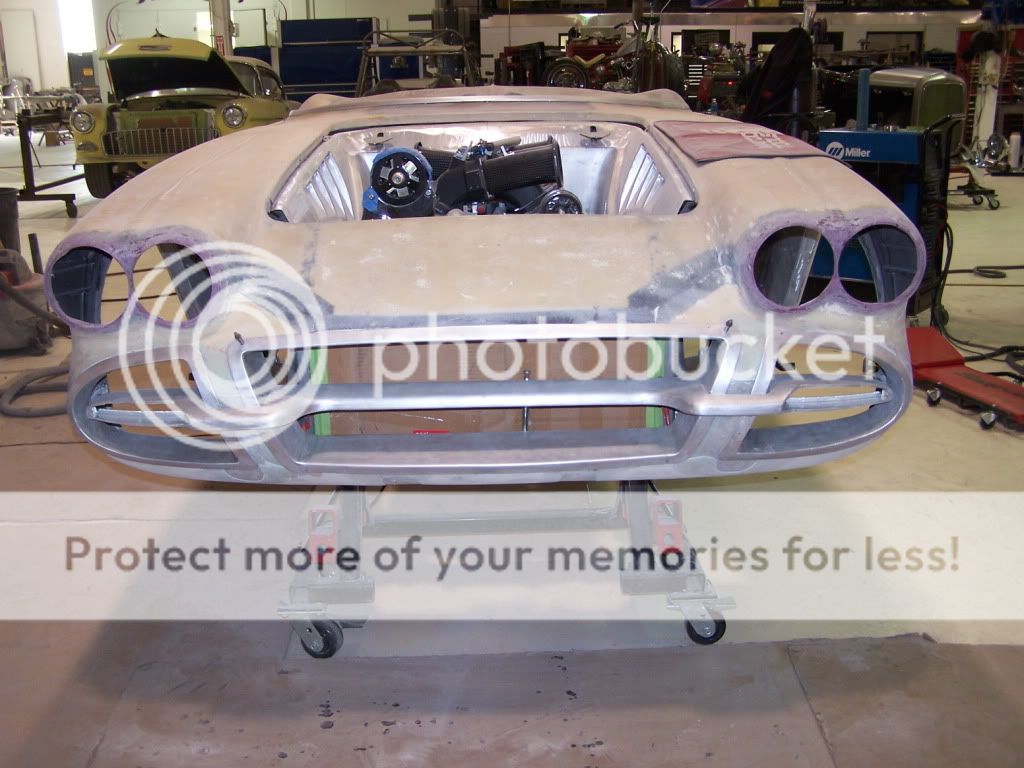

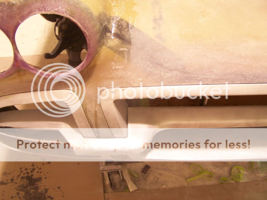

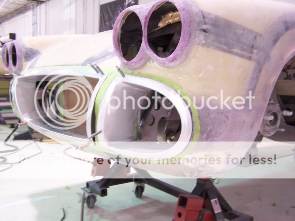

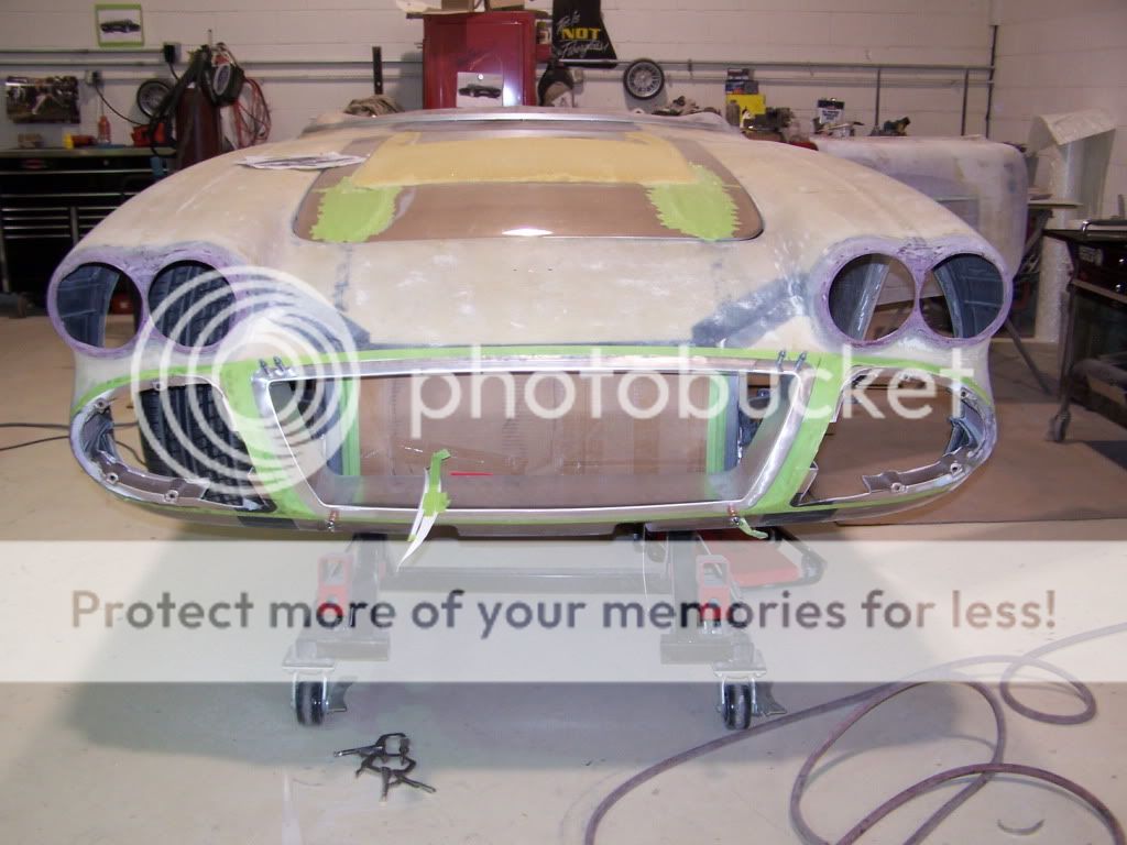

Here ae a few more pics of the re-worked front end. We tossed all of the stock trim and grilles. complete new units were fabricated from aluminum to change the shape of the openings and give it a more modern, aggressive look.
Center grille opening
http://i563.photobucket.com/albums/ss79/RS-Perf/66.jpg
Here, the center opening has already been fabbed. The passenger side blank was hammered out as a solid piece. The center was blacked out to show where it will be trimmed away for the opening.
http://i563.photobucket.com/albums/ss79/RS-Perf/67.jpg
http://i563.photobucket.com/albums/ss79/RS-Perf/68.jpg

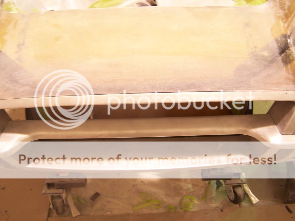

Starting to mock up center grille bar.
http://i563.photobucket.com/albums/ss79/RS-Perf/69.jpg

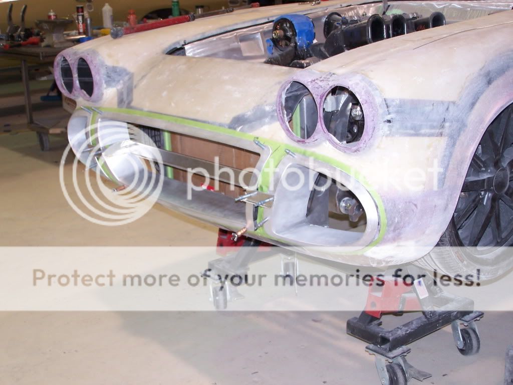

Roadster Shop 06-24-2009 08:34 AM

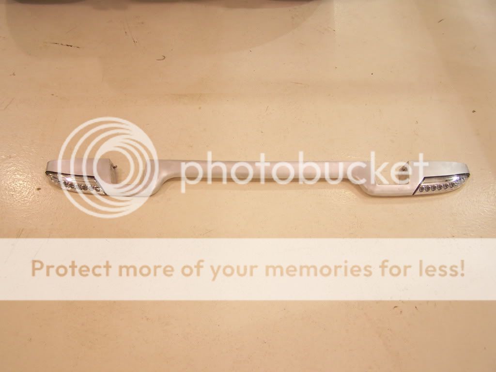

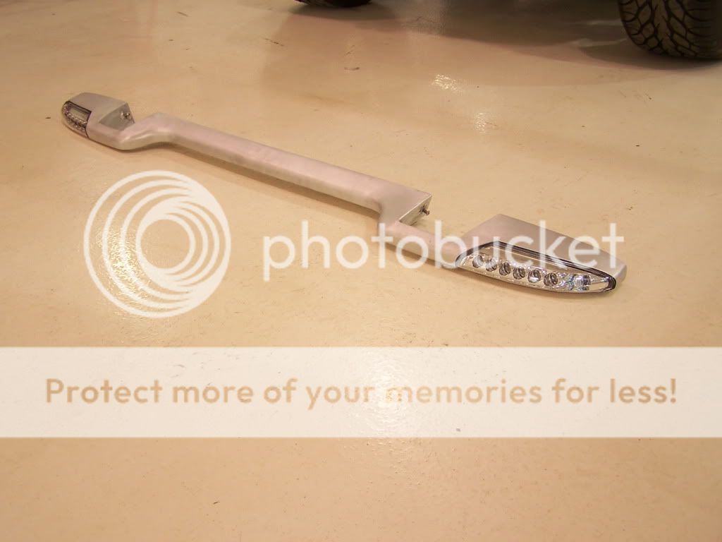

Aluminum grille bar
http://i563.photobucket.com/albums/ss79/RS-Perf/70.jpg
http://i563.photobucket.com/albums/ss79/RS-Perf/71.jpg
http://i563.photobucket.com/albums/ss79/RS-Perf/72.jpg
http://i563.photobucket.com/albums/ss79/RS-Perf/76.jpg
http://i563.photobucket.com/albums/ss79/RS-Perf/77.jpg
http://i563.photobucket.com/albums/ss79/RS-Perf/78.jpg
http://i563.photobucket.com/albums/ss79/RS-Perf/73.jpg

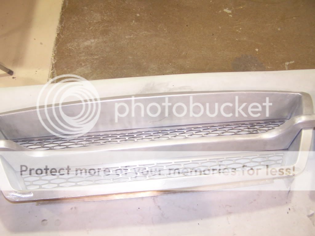

Roadster Shop 06-24-2009 08:38 AM
Laser cut a new grille pattern for it as well.
http://i563.photobucket.com/albums/ss79/RS-Perf/75.jpg

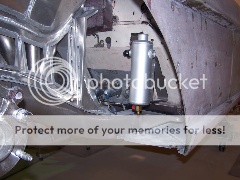

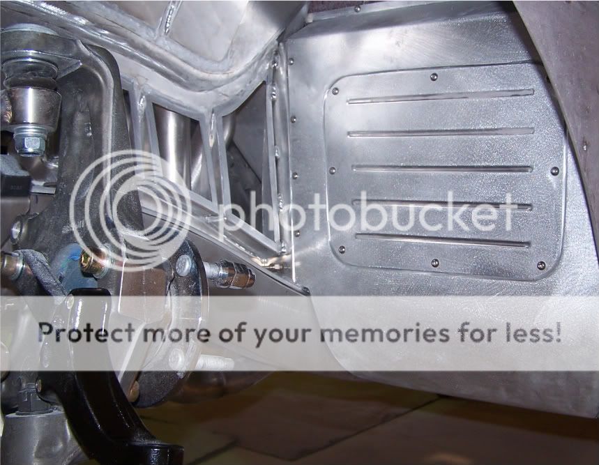

Roadster Shop 06-25-2009 07:30 AM

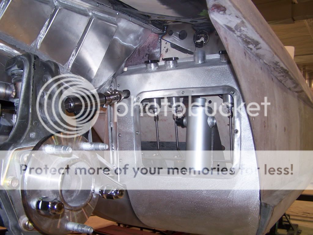

Here are a few underside shots of the car and details that most will not know about until you see the pictures.
This is behind the front wheels in the inner fender / cowl area. There was a lot of extra room to hide components like master cylinders, breathers, etc...
Before the close out panels were made.
http://i563.photobucket.com/albums/ss79/RS-Perf/91.jpg
Close out panel with out access door.
http://i563.photobucket.com/albums/ss79/RS-Perf/90.jpg
Completed unit (The order is off. The picture above was taken later when the remote reservoirs and breather tube were installed into the panel)
http://i563.photobucket.com/albums/ss79/RS-Perf/89.jpg

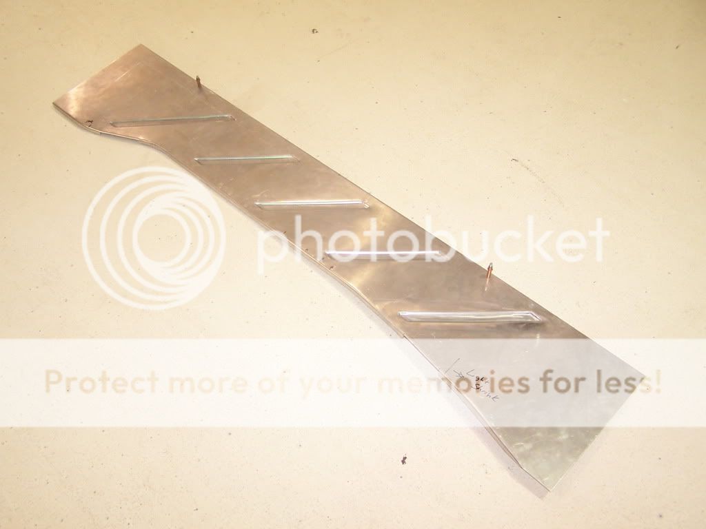

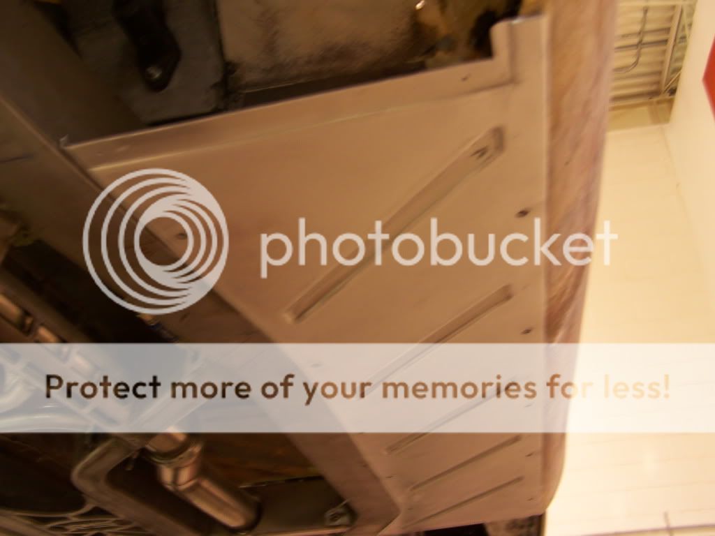

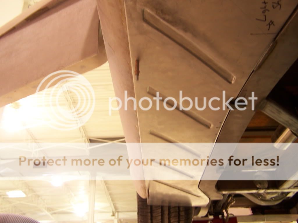

Roadster Shop 06-25-2009 07:34 AM
Aluminum belly pans built to close off the area from the rocker panel to the frame rail.
http://i563.photobucket.com/albums/ss79/RS-Perf/87.jpg
http://i563.photobucket.com/albums/ss79/RS-Perf/88.jpg
http://i563.photobucket.com/albums/ss79/RS-Perf/86.jpg

Rear close out panel behind tire
http://i563.photobucket.com/albums/ss79/RS-Perf/94.jpg
Front close out panel infront of tire. There is a lot going on here. The headlights are mounted infront of this panel. THe cut out section where the cardboard is houses a power steering cooler on one side and an oil cooler on the other side of the car. there is a perferated screen to match the front grille that goes in here when completed. There is also a radiator overflow tank built into the panel. It is the ribbed section with the two AN fittings.
http://i563.photobucket.com/albums/ss79/RS-Perf/92.jpg
Here is a close up. We made a tank out of aluminum to follow the shape of the inner fender panel and welded it all together for a clean look.
http://i563.photobucket.com/albums/ss79/RS-Perf/93.jpg

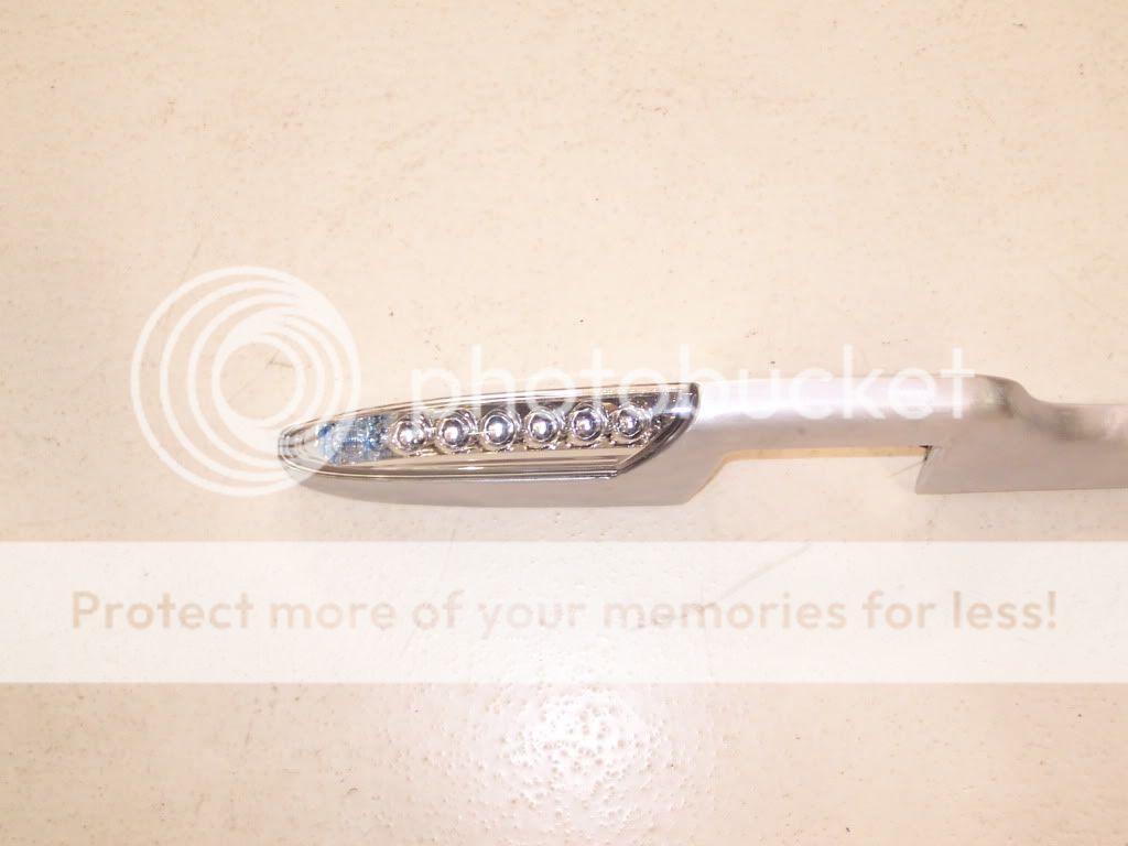

Pop up fuel filler in the side of the arch.
Machined a trim ring to match the headlights and a few other parts still to come on the car.
http://i563.photobucket.com/albums/ss79/RS-Perf/121.jpg
Then sunk that into the aluminum arch.
http://i563.photobucket.com/albums/ss79/RS-Perf/122.jpg
Push and twist to remove the center cap
http://i563.photobucket.com/albums/ss79/RS-Perf/123.jpg
http://i563.photobucket.com/albums/ss79/RS-Perf/124.jpg

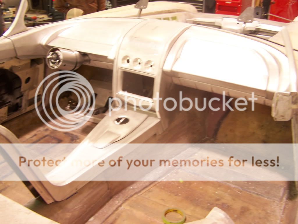

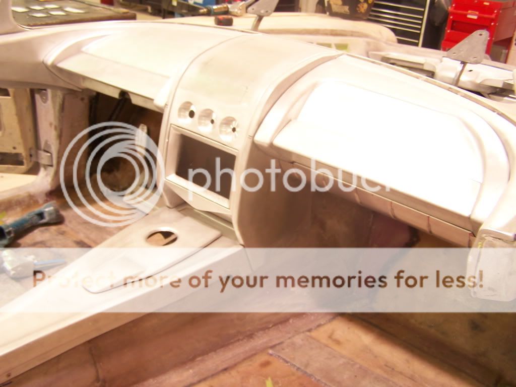

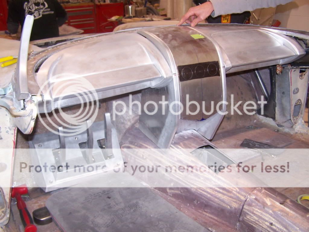

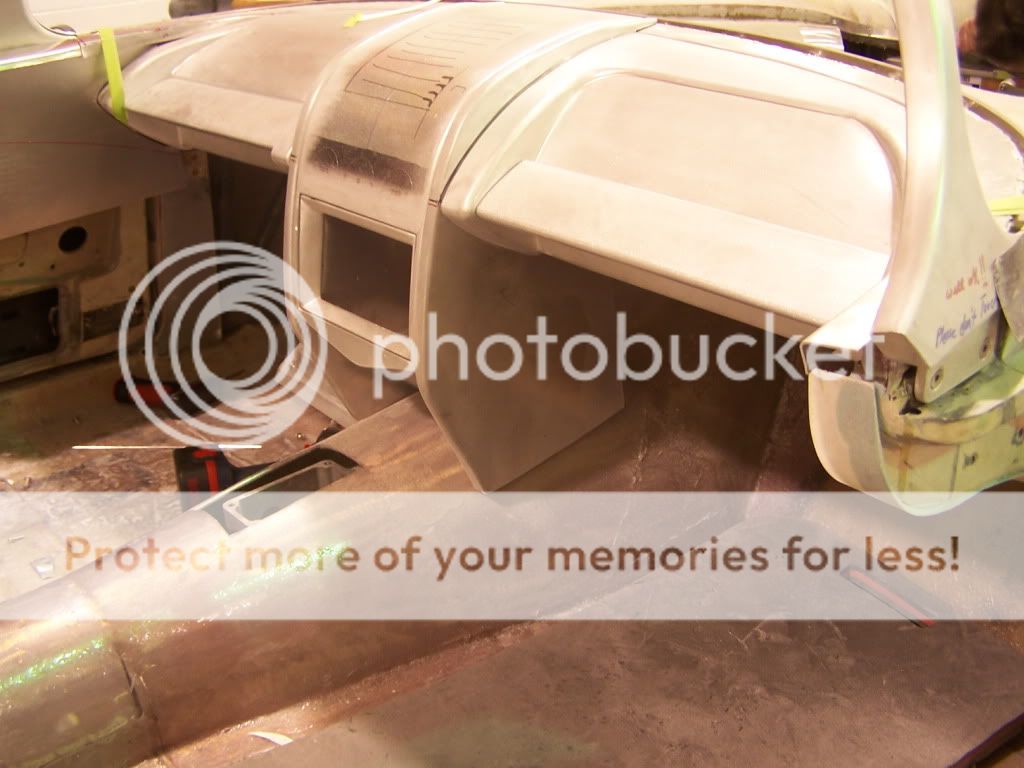

Roadster Shop 06-29-2009 09:22 AM

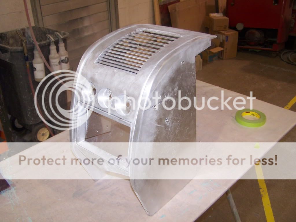

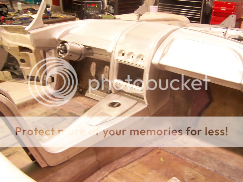

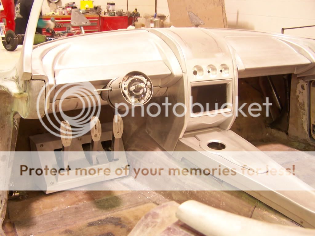

Complete aluminum dash and center console fabbed for the car.
http://i563.photobucket.com/albums/ss79/RS-Perf/100.jpg
http://i563.photobucket.com/albums/ss79/RS-Perf/101.jpg

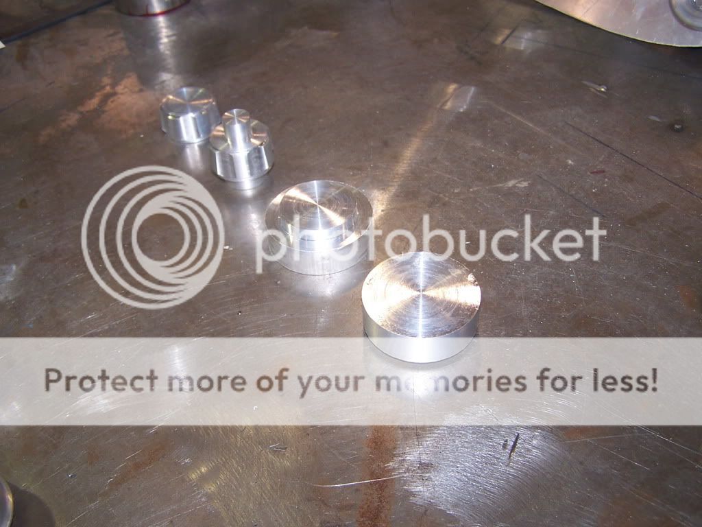

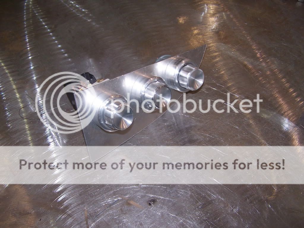

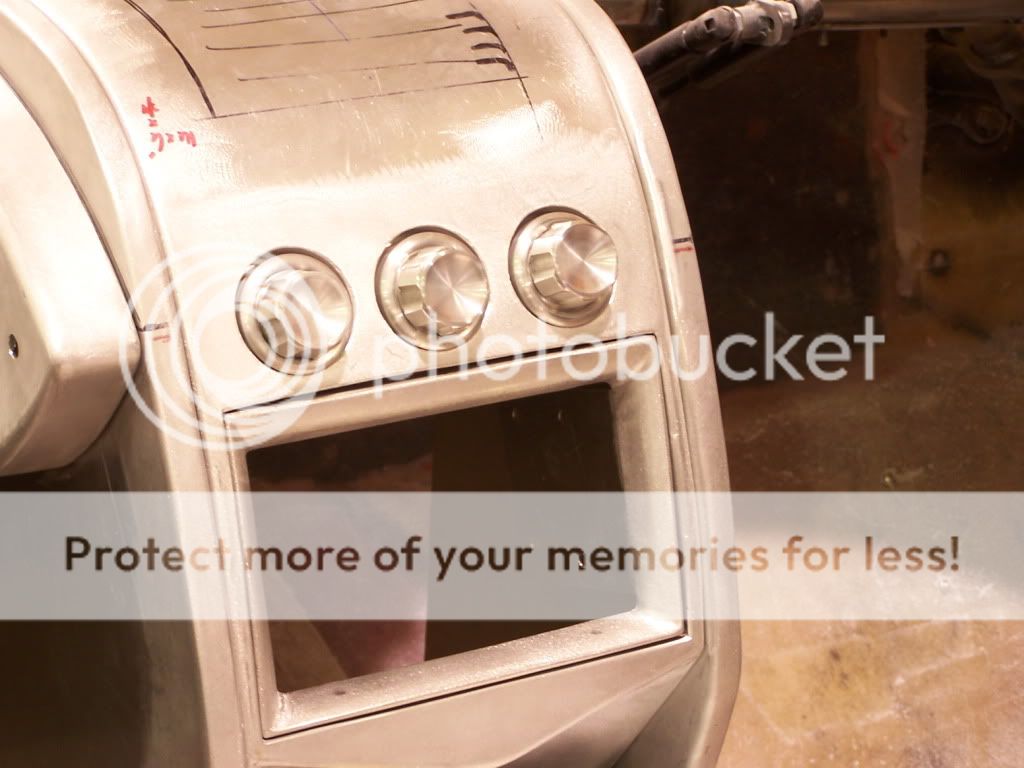

Machined aluminum knobs for dash to match headlight and gas cap trim ring design.
http://i563.photobucket.com/albums/ss79/RS-Perf/102.jpg
Completed knobs shown in a scrap peice of sheet metal for mock up.
http://i563.photobucket.com/albums/ss79/RS-Perf/103.jpg

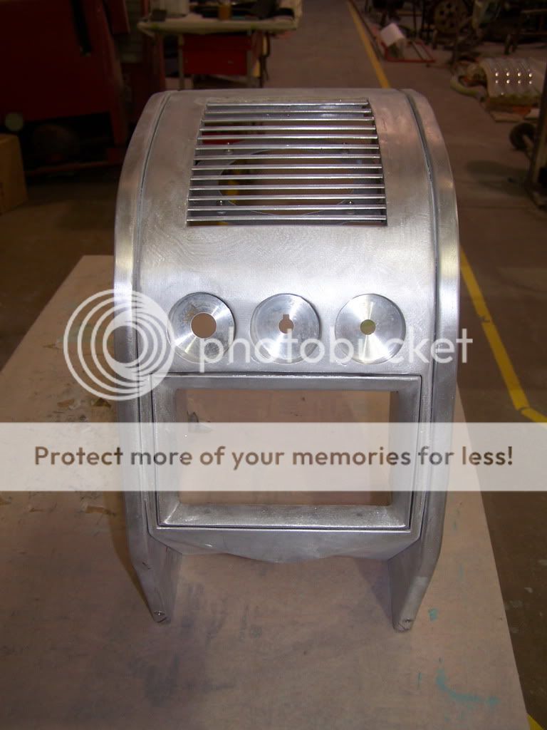

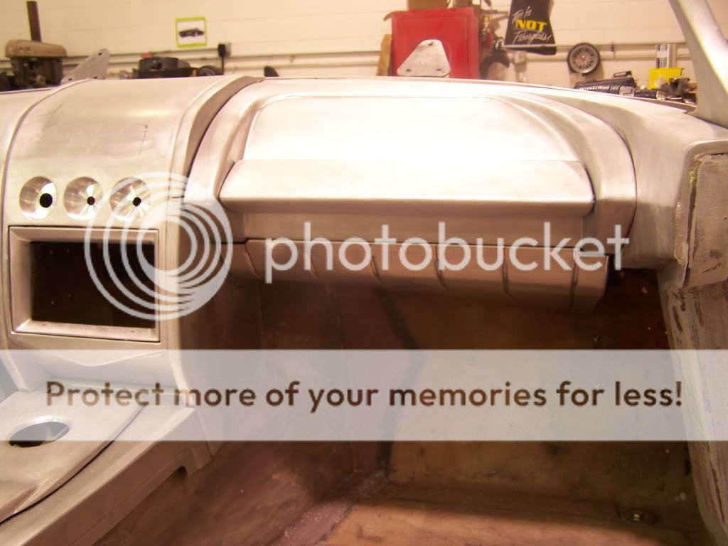

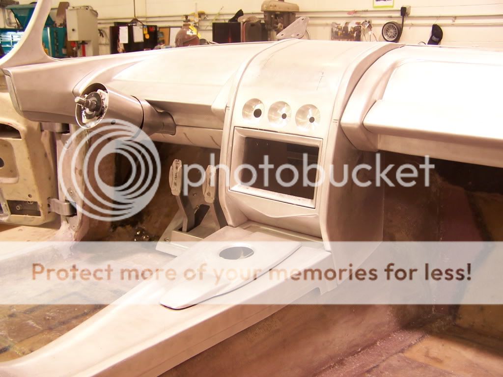

Roadster Shop 06-29-2009 09:26 AM
Knobs recessed into dash with trim bezels.
http://i563.photobucket.com/albums/ss79/RS-Perf/104.jpg
Center console starting to take shape.
http://i563.photobucket.com/albums/ss79/RS-Perf/107.jpg
http://i563.photobucket.com/albums/ss79/RS-Perf/108.jpg
Ribbed "belly pan" under the dash to finish it off.
http://i563.photobucket.com/albums/ss79/RS-Perf/109.jpg
Roadster Shop 06-29-2009 09:29 AM
A few more pictures of the dash in various stages of completion. (no particular order)
http://i563.photobucket.com/albums/ss79/RS-Perf/110.jpg
http://i563.photobucket.com/albums/ss79/RS-Perf/111.jpg
http://i563.photobucket.com/albums/ss79/RS-Perf/112.jpg
http://i563.photobucket.com/albums/ss79/RS-Perf/113.jpg
Roadster Shop 06-29-2009 09:31 AM
Fabbed an aluminum slotted screen for the center section of the dash. A speaker will go behind this when completed.
http://i563.photobucket.com/albums/ss79/RS-Perf/114.jpg
http://i563.photobucket.com/albums/ss79/RS-Perf/115.jpg
