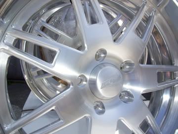

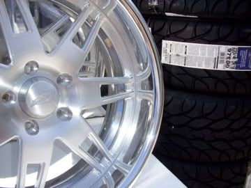

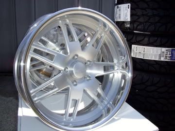

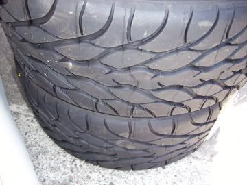

Look what the UPS man dropped off to wrap around the wheels! BF Goodrich G-Force T/A KDWs! in 235/40/18 for the front and 245/40/19s for the rear. I know the widths are a little conservative compared to some of the monster tires a lot of guys are running but mini-tubbing would require moving the framerails and it just wasn't in the summer time-frame and these will hold plenty of gs!
http://i256.photobucket.com/albums/h...s/100_0667.jpg
http://i256.photobucket.com/albums/h...s/100_0665.jpg
There's no mistaking that tread pattern on the BF/Gs! Love the snakeskin/flame pattern on these tires that just adds to the whole style of the car!

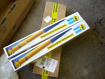

Did I mention the Hotchkis kit is COMPLETE! It even come with Bilstein shocks made to their specs to perfectly compliment the suspension.
If you know shock technology, you know Bilsteins set up specifically for your car are about as good as it gets!

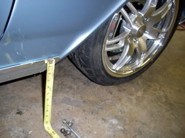

Got it on the ground with all the new parts and took some careful measurements all the way around to determine what it would take to nail the stance.
http://i256.photobucket.com/albums/h...100_0730-1.jpg
http://i256.photobucket.com/albums/h...23_face0-1.jpg
http://i256.photobucket.com/albums/h...100_0725-1.jpg

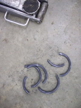

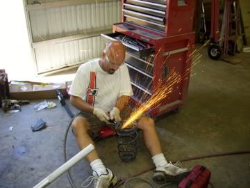

Once we determined how much I wanted it to come down, we pulled the springs and started carefully cutting a little at a time using Hotchkis' formula; one inch of spring height equals two inches of drop.
http://i256.photobucket.com/albums/h...100_0727-1.jpg
After cutting and reinstalling them a few times, this is what ended up on the floor. 1.25" coils.
http://i256.photobucket.com/albums/h...100_0731-1.jpg

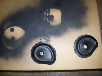

I dig these little stamped factory spring holders. A quick coat of semi-gloss black and some new hardware and they're right back where they were placed 45 years ago.

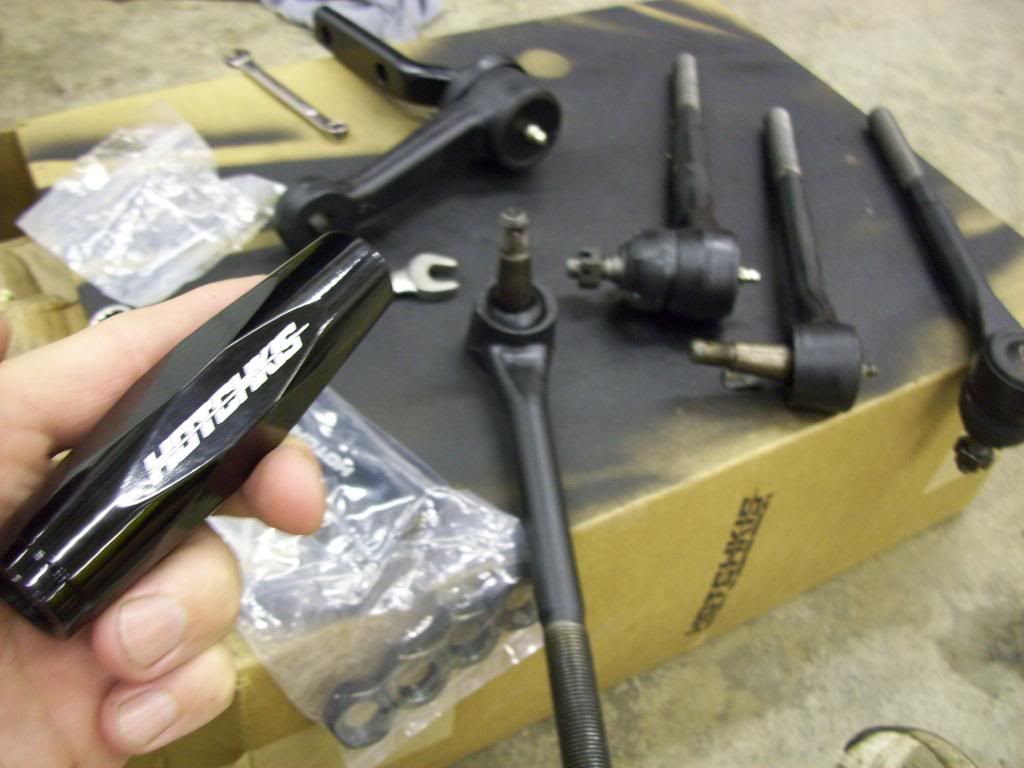

Check the cool tie-rod connectors that come with the kit. These are a little more confidence inspiring than the crappy originals!

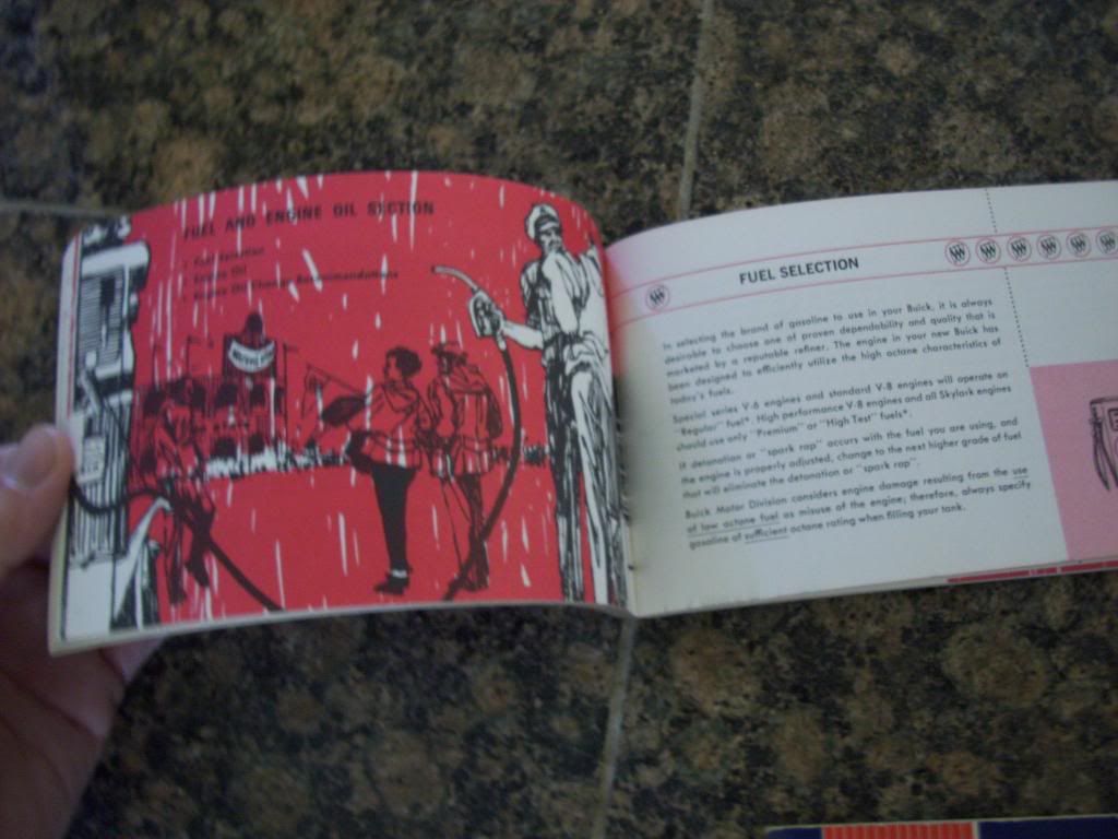

Remember how original this car was when I bought it a few months ago?
Look what came with it! The original Owner's Manual and "Owner's Protection Plan" booklet complete with the Protect-O-Plate still in it with the original owner's name and address still there and they lived about a half mile from my front door!
http://i256.photobucket.com/albums/h...s/100_0737.jpg
http://i256.photobucket.com/albums/h...s/100_0738.jpg
Dig the cool artwork in the Owner's Manual
http://i256.photobucket.com/albums/h...s/100_0739.jpg

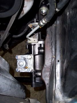

In all the thrashing, I almost forgot to photograph and mention the Lee quick-ratio steering box from Mark at SC&C. I would be a bit numb to all the suspension upgrades done without this key part!
http://i256.photobucket.com/albums/h...100_0733-1.jpg

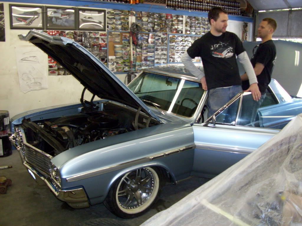

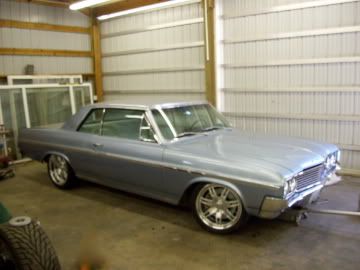

JayR 07-31-2009 09:35 AM

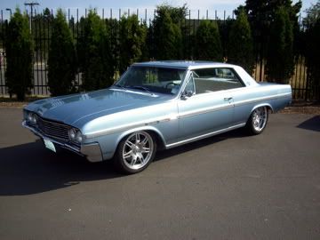

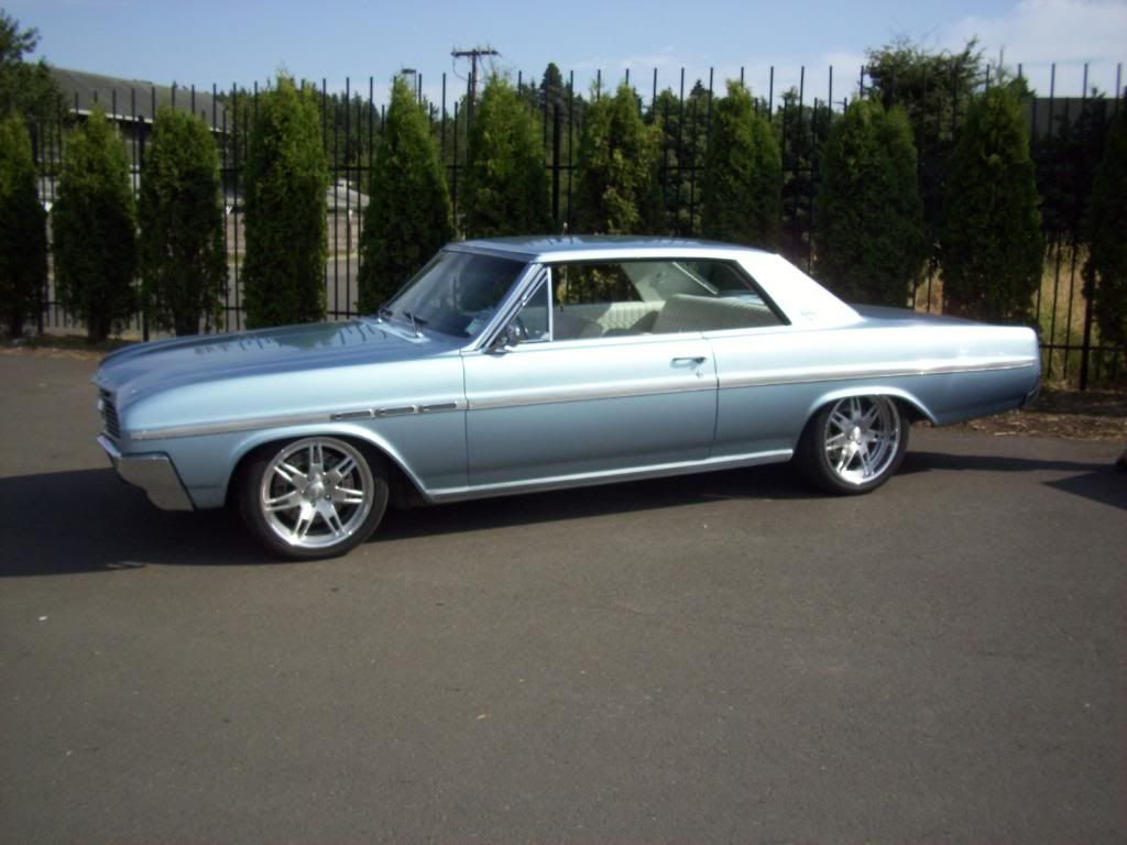

And one month later with the help from my friends, Jared, Howard, Chris and Dave in our spare time with basic tools, here's what you can do with a clean craigslist find and parts available from the amazing aftermarket we have at our fingertips.
http://i256.photobucket.com/albums/h...100_0683-1.jpg
The target completion date of this exercise was last weekend to have a cool car to drive at the local Good Guys show in Puyallup that I've gone to every year on foot because my cars were too new for the cut off year that used to be 64 and then recently bumped to 72. That all changed this year and I rocked the Buick all weekend!

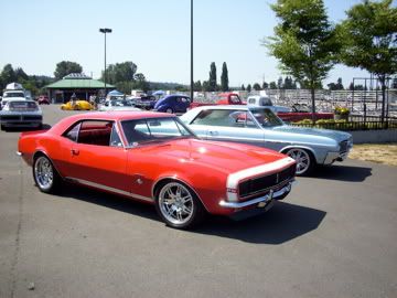

tones2SS 07-31-2009 01:25 PM
1 Attachment(s)
Very cool Jason.:thumbsup:
We need a high res pic of your car with Wade's GTO and what looks like Speed-Tech's '69 Camaro!!:cheers:
