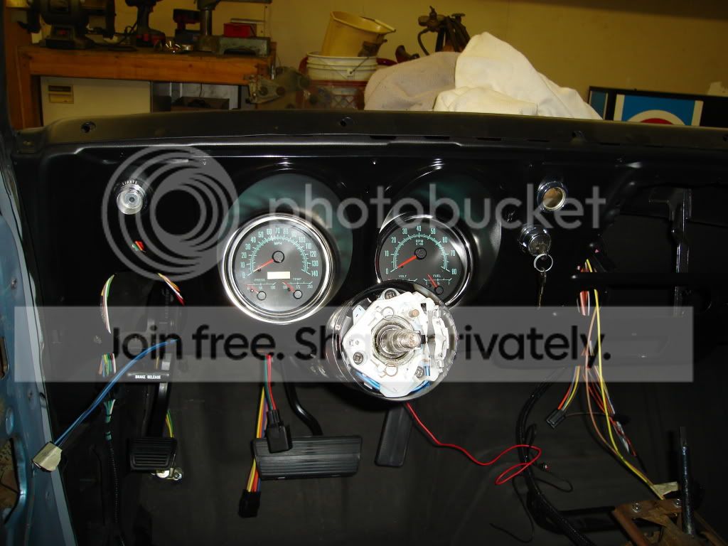

American Auto Wire was nice enough to mail me some wire connectors so I could wire my guage plug ends directly into their bulk head.
http://i319.photobucket.com/albums/m...DSC07274-1.jpg
Wiring almost complete.
http://i319.photobucket.com/albums/m...DSC07273-1.jpg

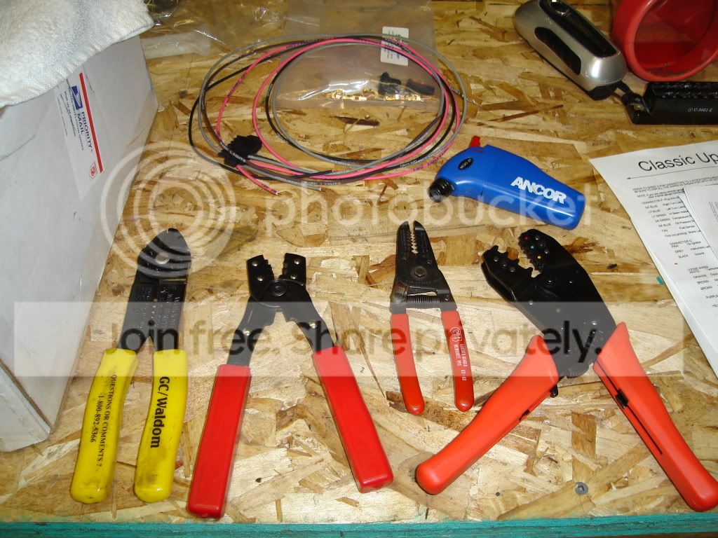

These are most of the tools that I needed to complete the job.
http://i319.photobucket.com/albums/m...DSC07275-1.jpg

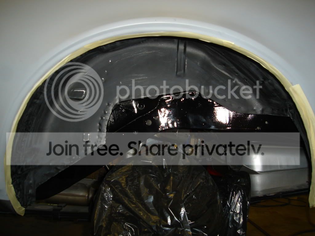

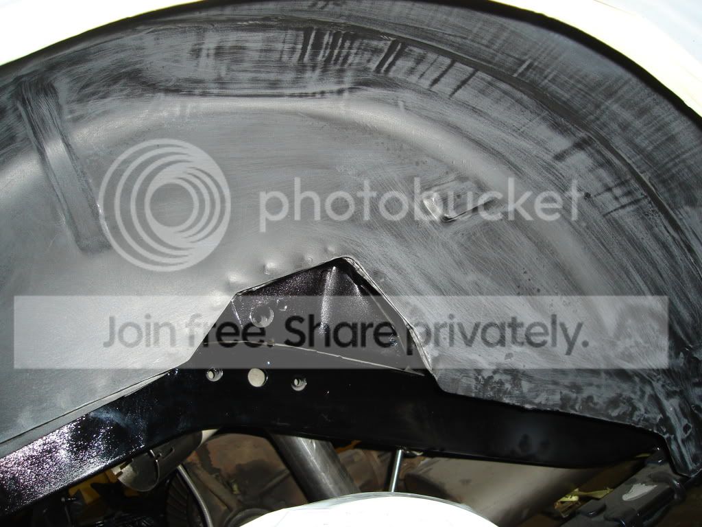

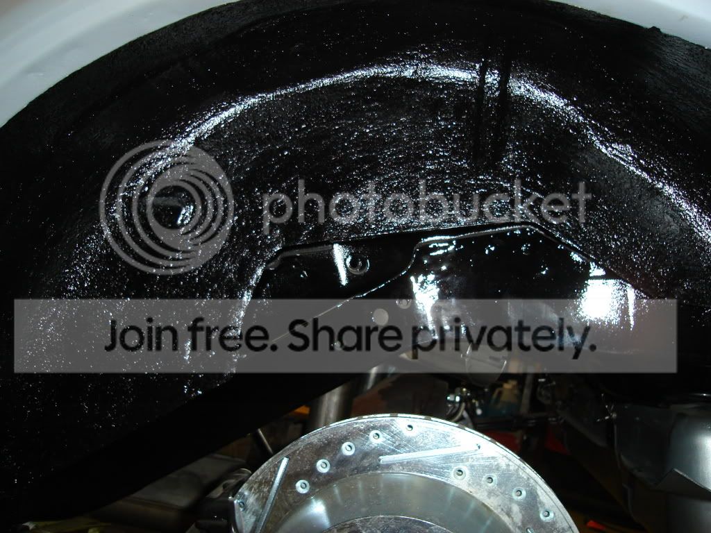

Sanded down my rear inner wheel wells and rolled on three coats of a Eastwood bedliner/undercoating product.
http://i319.photobucket.com/albums/m...y/DSC07286.jpg
http://i319.photobucket.com/albums/m...y/DSC07285.jpg
http://i319.photobucket.com/albums/m...y/DSC07291.jpg

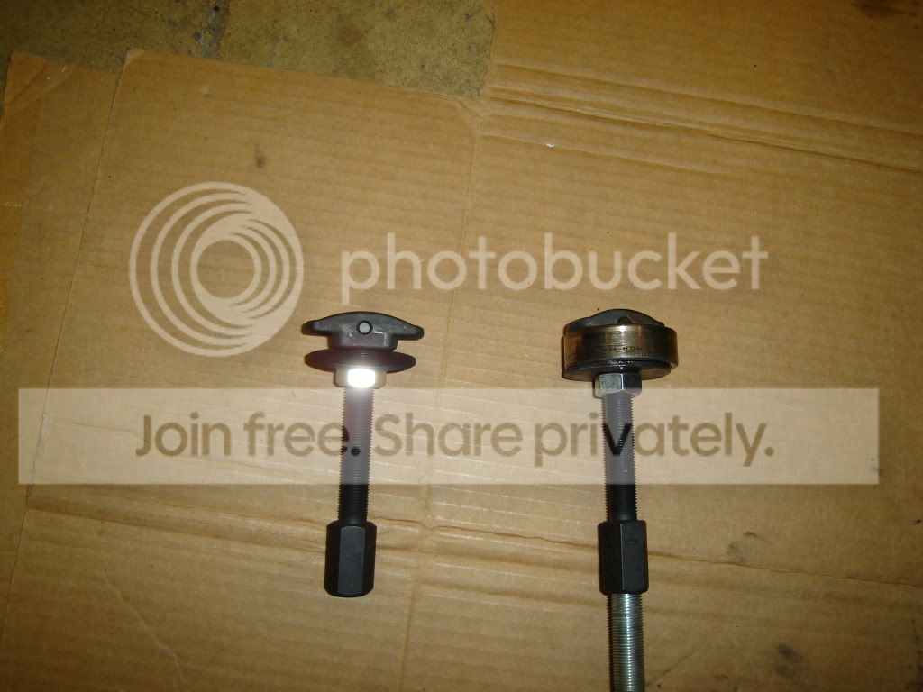

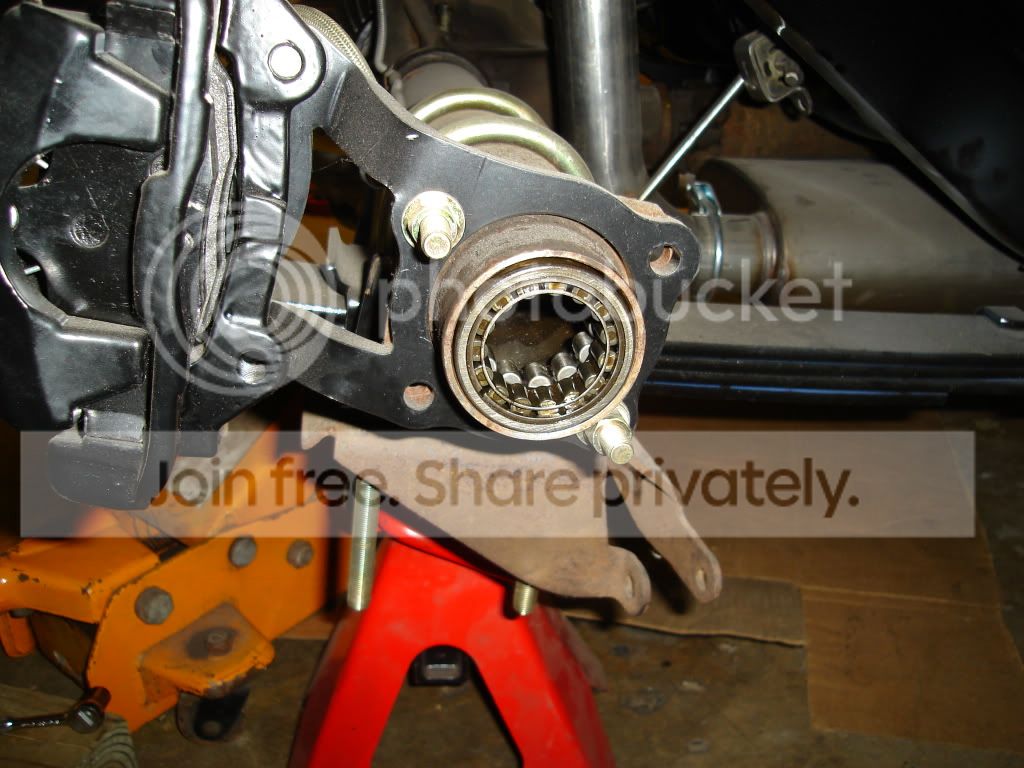

I replaced my 12 bolt axles a while ago after noticing that the bearing surface contact area was in pretty bad shape. I finally had time to install the new bearings and seals.
Old bearing and bearing puller.
http://i319.photobucket.com/albums/m...y/DSC07300.jpg
I used the old bearing to help install the new bearings.
http://i319.photobucket.com/albums/m...y/DSC07298.jpg
New bearing
http://i319.photobucket.com/albums/m...y/DSC07297.jpg
New seal
http://i319.photobucket.com/albums/m...y/DSC07299.jpg]
Guages are installed for what I hope will be the last time.
http://i319.photobucket.com/albums/m...y/DSC07287.jpg

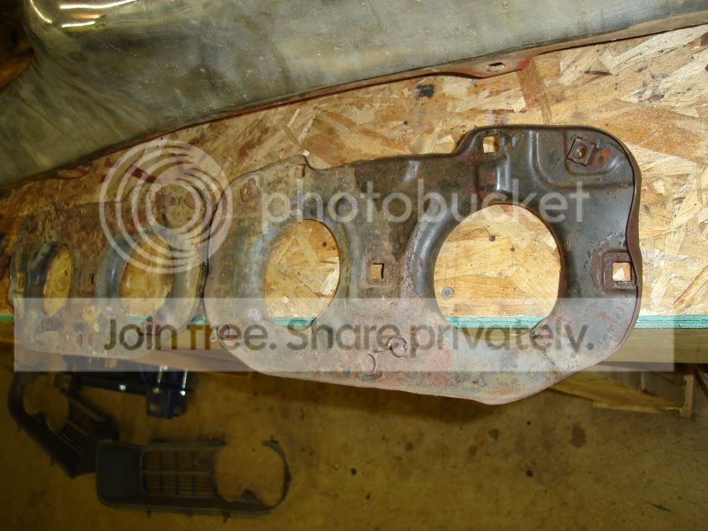

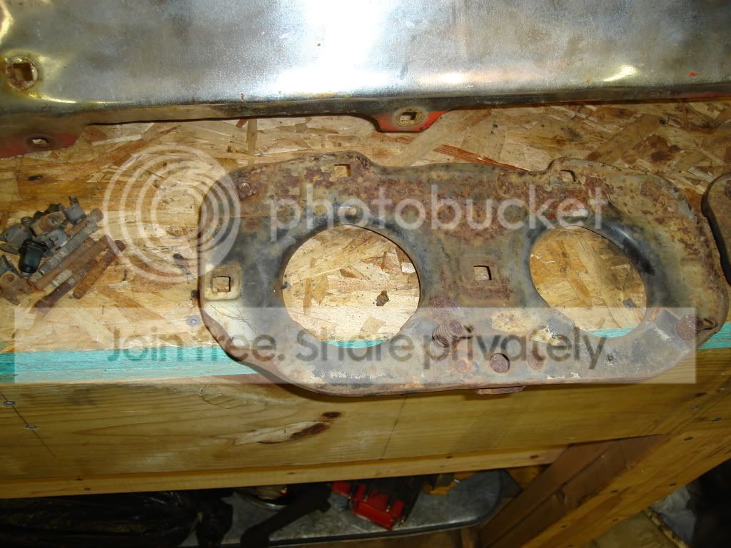

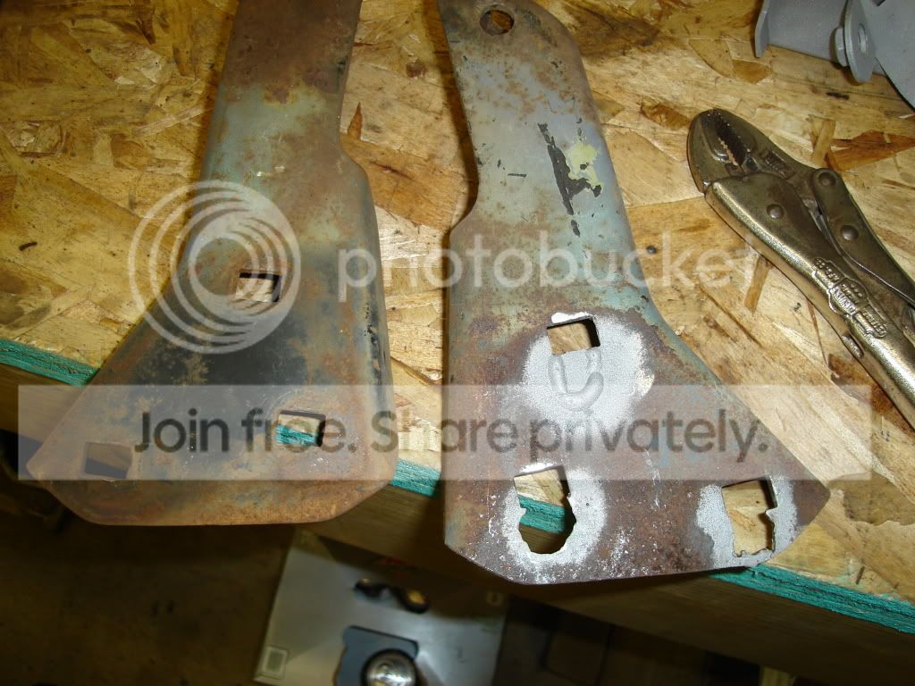

I spent a fair amount of time fixing my old rear seat frames. I had to weld in a lot of new supports.
Here's a nice rusty picture before clean up.
http://i319.photobucket.com/albums/m...y/DSC07312.jpg
Another one. I had to rebuild a good portion of this side.
http://i319.photobucket.com/albums/m...y/DSC07313.jpg
Here's a portion of what I cut out and had to weld back in.
http://i319.photobucket.com/albums/m...y/DSC07314.jpg

I started working on the front end brackets. I don't think there was one bracket that did not need some kind of tweaking or welding to make them fit correctly. I started with the head light buckets and brackets. I had one headlight that was mounted funny. I found out that all four headlight buckets are different. I was not sure which one I needed. But, after sandblasting them I noticed that they were all labeled with L1,L2,R1,R2. I had to come up with one to have a complete correct set. After that was achieved I moved onto the headlight bucket brackets. These were very bent up and needed about four hours to get them complately straight.
http://i319.photobucket.com/albums/m...y/DSC07343.jpg
http://i319.photobucket.com/albums/m...y/DSC07342.jpg
Fixed, now just need to media blast them.
http://i319.photobucket.com/albums/m...y/DSC07346.jpg
I guess the PO did not like how the front end lined up and needed more adjustment. All three of these holes were made with a torch.
http://i319.photobucket.com/albums/m...y/DSC07350.jpg
I started with cutting out little pieces of metal and welding them in from both sides.
http://i319.photobucket.com/albums/m...y/DSC07349.jpg
http://i319.photobucket.com/albums/m...y/DSC07351.jpg
All welded in and ground down flat.
http://i319.photobucket.com/albums/m...y/DSC07352.jpg
